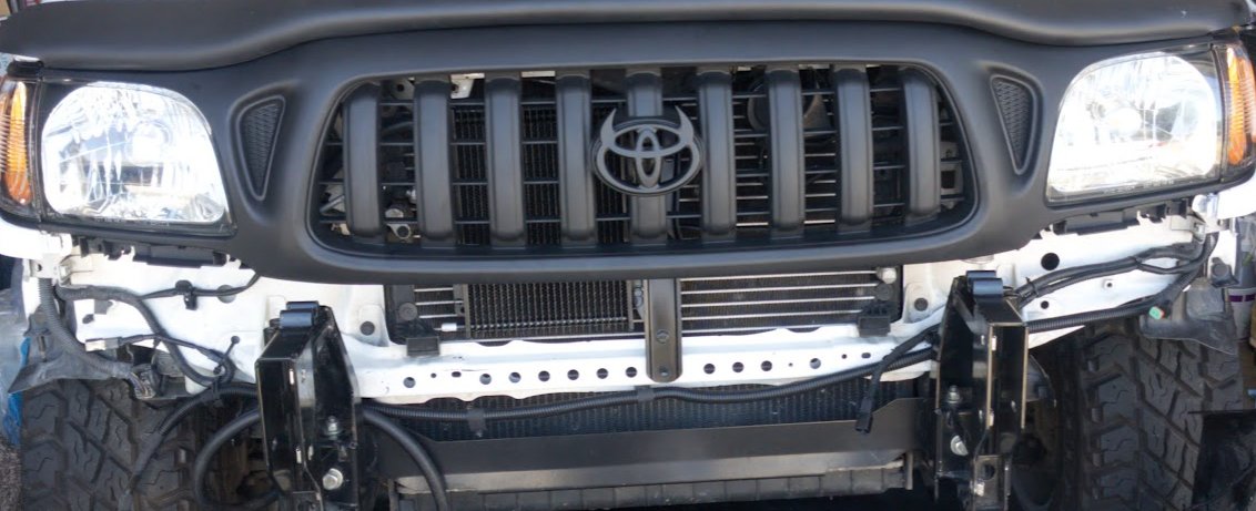

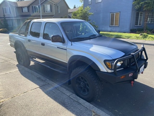

    Looks good.
    Grille swapped here also. Might as well with the bumper off for the trans cooler. I'm not entirely happy with the blacked out emblem/badge. Might paint it white to match (040). Still on the fence with it.

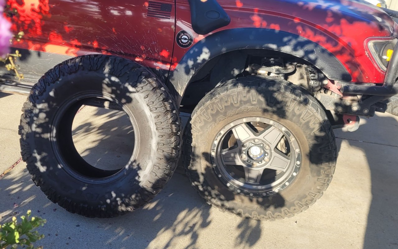

    Shit's 'bout to get real 'round here, yo.

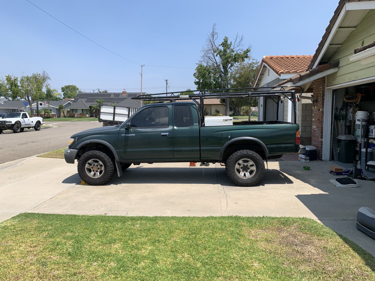

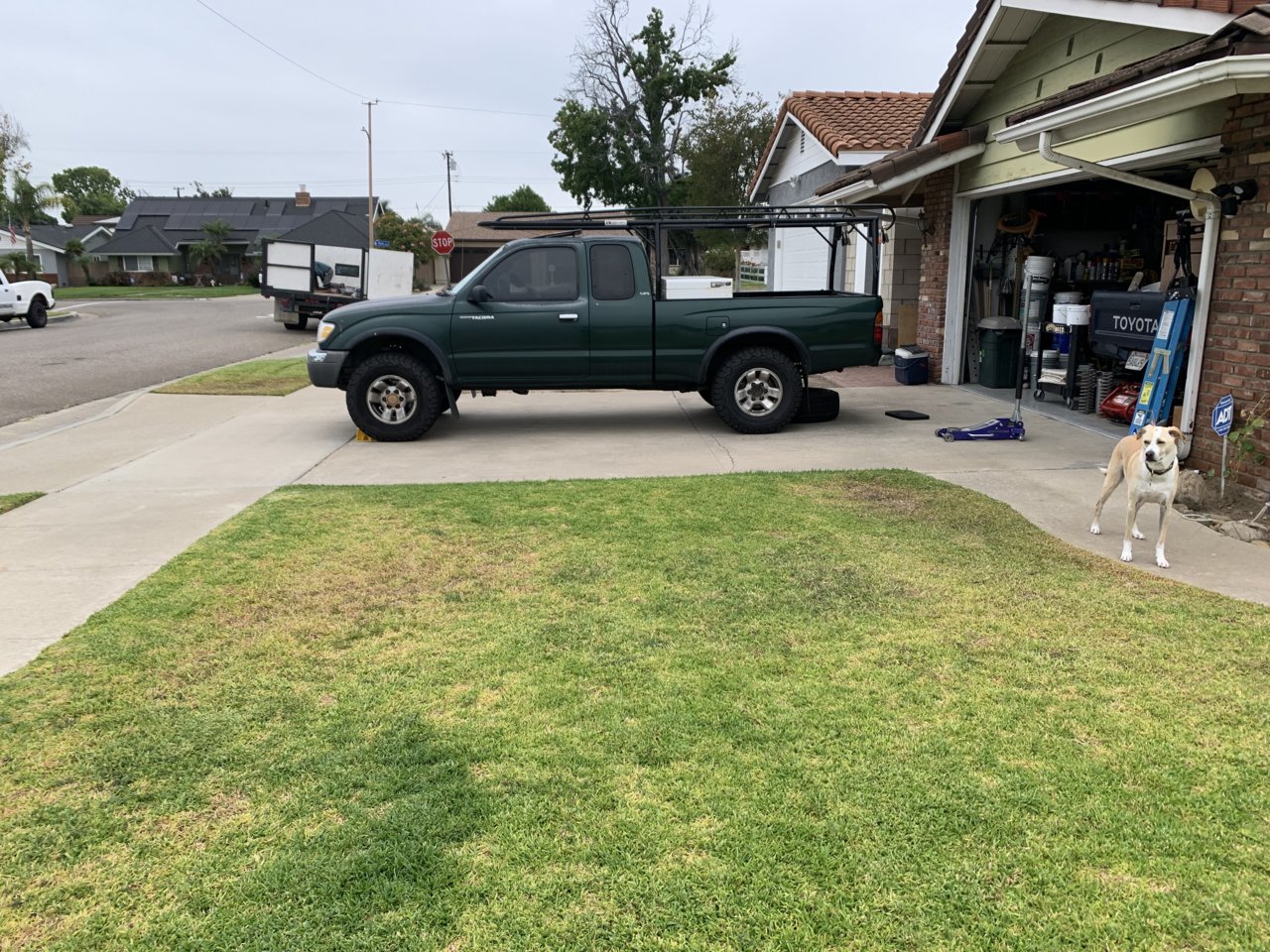

    01C760B6-63CE-42E7-857D-9EE97CBE66EA.jpg D667DD35-DBC6-4106-9A82-8087C30D643B.jpg 5DD235A7-0DBD-4C45-984E-38ECCCFA1522.jpg

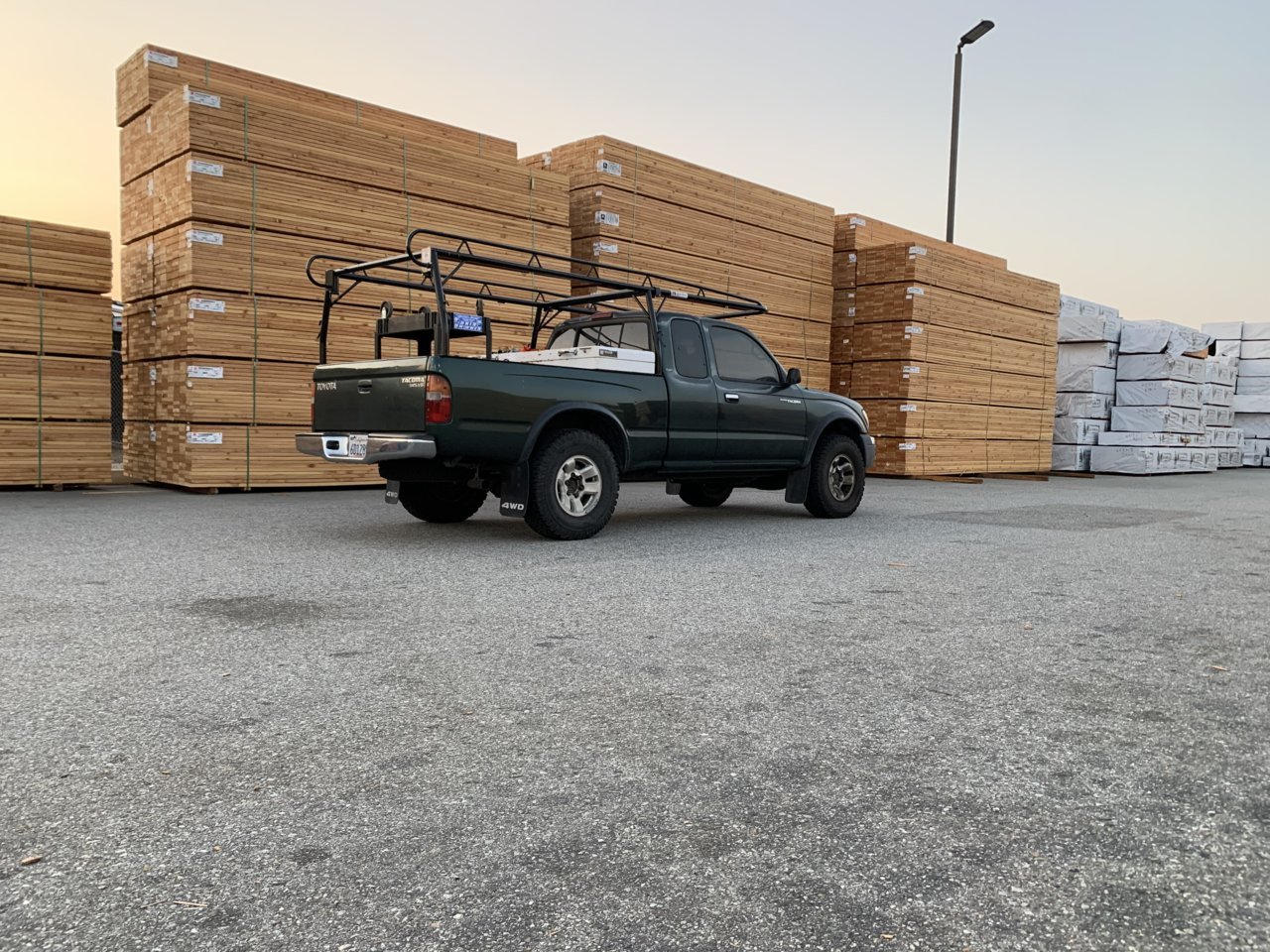

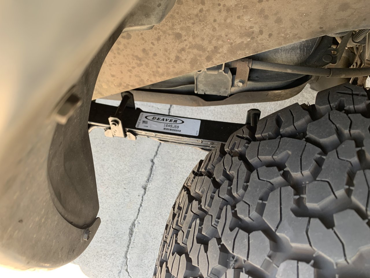

    New leaf springs for the work truck. Deaver j59 leaf pack. 235k on the originals. Hopefully this fixes the axel wrap and just maybe It won’t bottom out now with a load on the rack

    Where'd you order them from and (if you don't mind) how much did they charge for the parts and shipping?
    I've been after a set but the only places I can find them in stock at the moment are charging more than I feel good about.

    6P4. I am fortunate to live about 15 minutes away from deaver spring. I bought them in 2020 and never put them on. Wish I did put them on when I bought them , much better ride. Atlas spring is also located in so cal and they have oem replacements to full long travel springs. I have heard good things about them. They might be able to ship to your location.

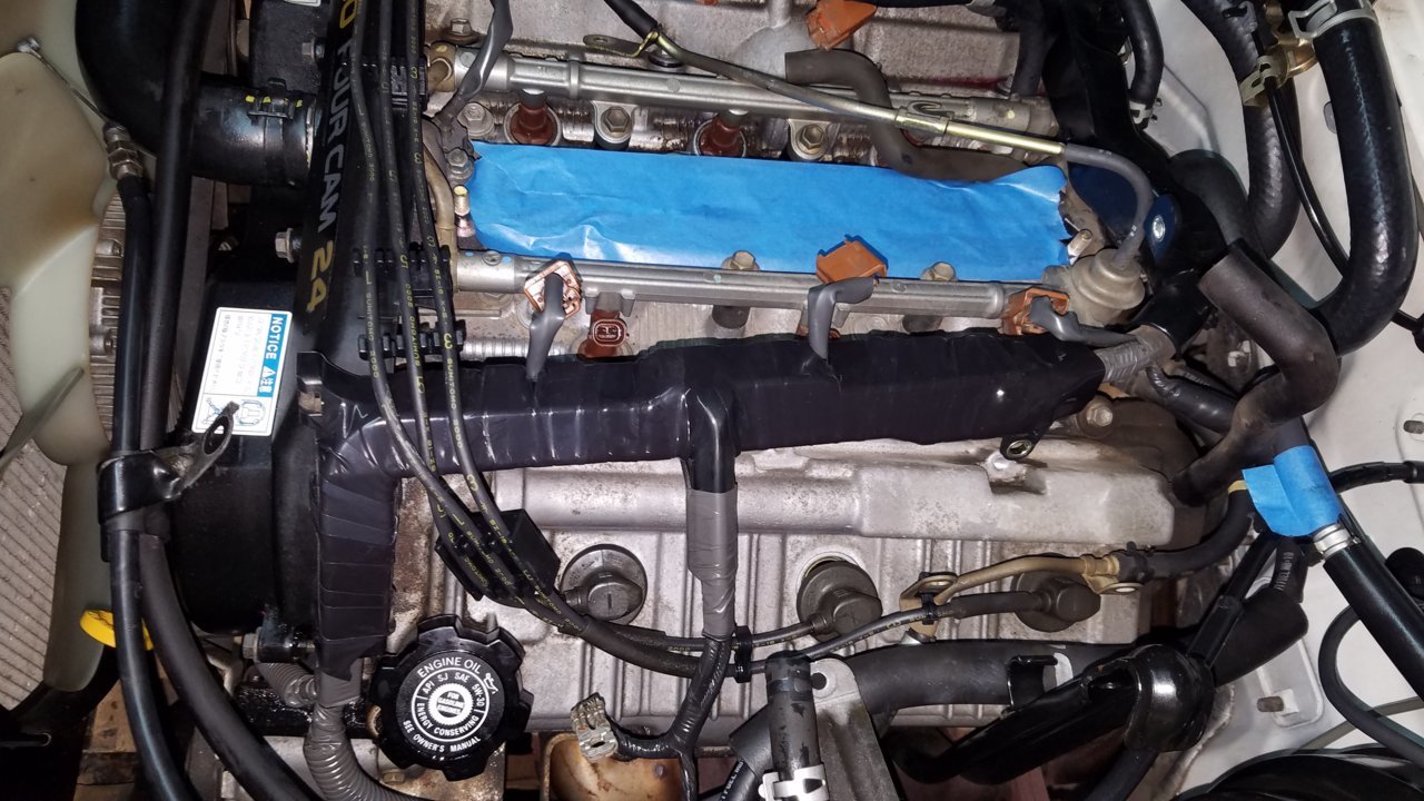

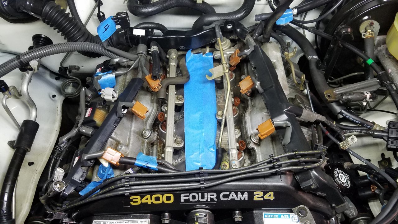

    Dropping the trans is way more difficult than valve cover gaskets. It's a bit tedious, but relatively easy. Just make sure to tape up the wire looms in the valley. I got lucky with mine, but my motor only had 100k on it at the time...

    Mine crumbled just by looking at it. Tape trick was awesome.

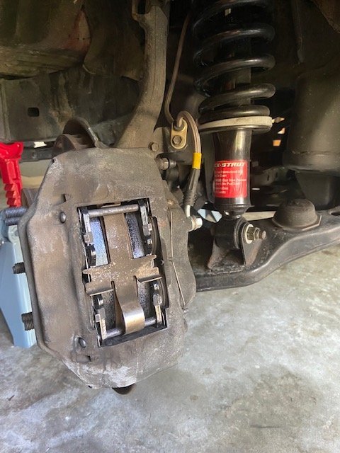

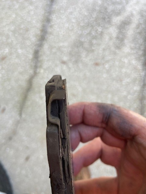

    and just in time too

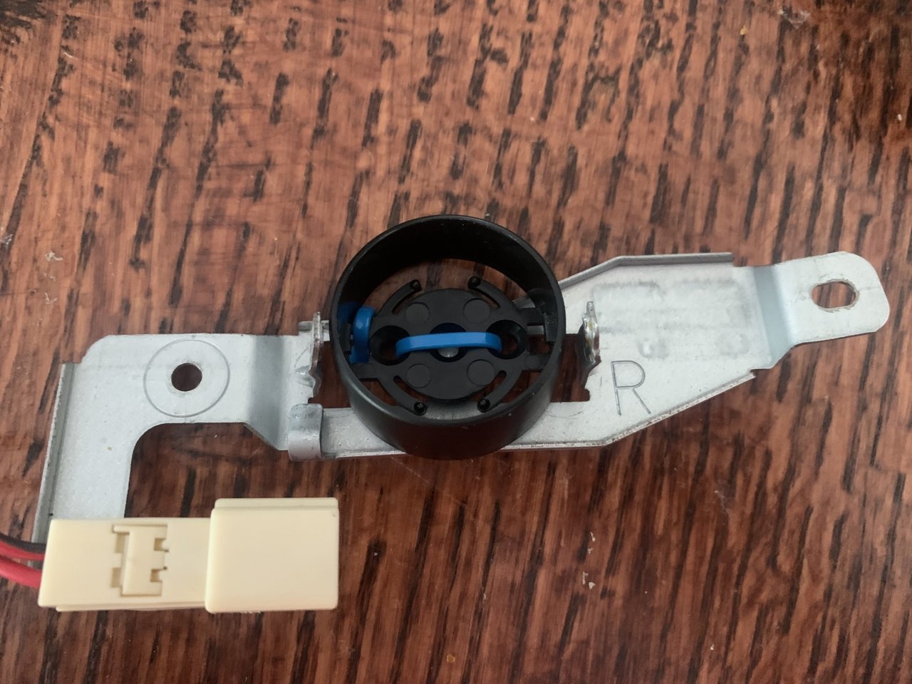

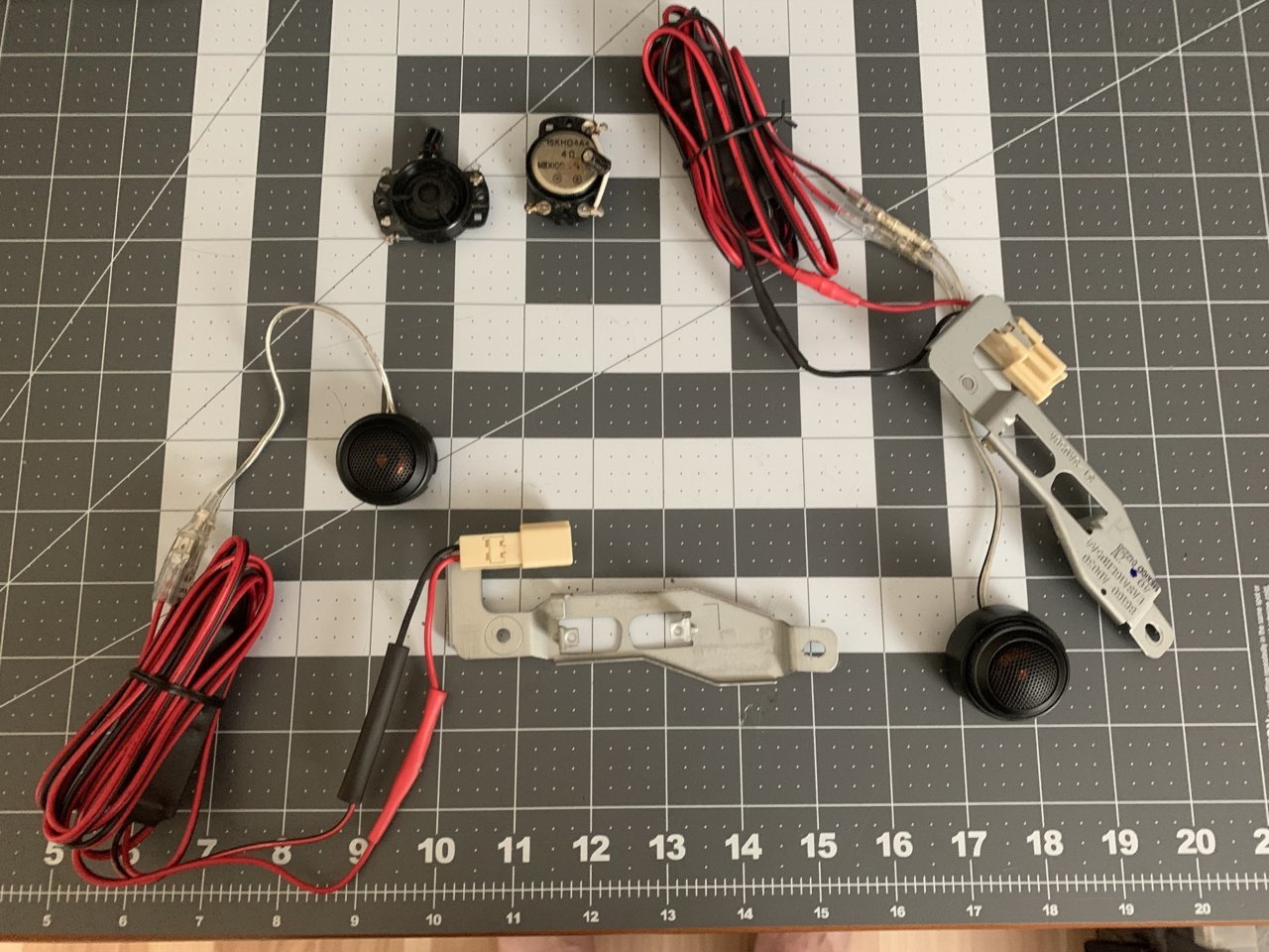

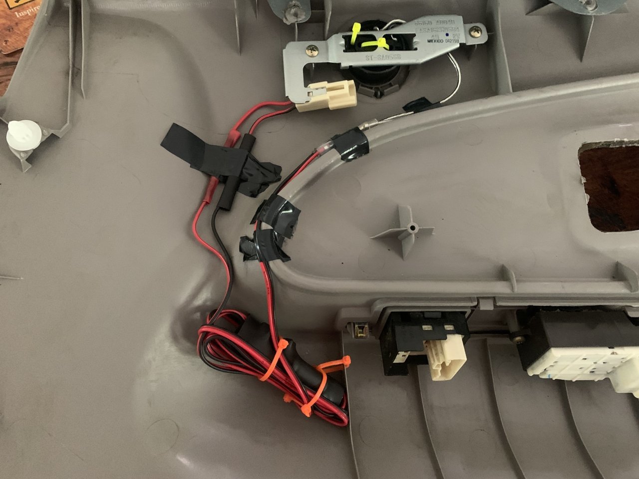

    Installed a set of JBL Club 750T 3/4" tweeters in my doors. Wanted something that would fit nicely in the door panel bracket without having to modify the bracket or door panel. Also wanted something that was small enough to keep the grille on the door panel in place. The JBLs sound good and seem like they're going to work out well.
