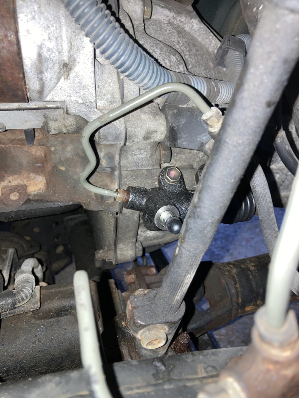

    6A8F1E2C-D030-4E6C-87A1-876AD28AFACE.jpg Changed the slave cylinder. The clutch feels so much better now. I was surprised that the entire boot section of the old cylinder was totally full of fluid. No wonder the clutch was iffy!

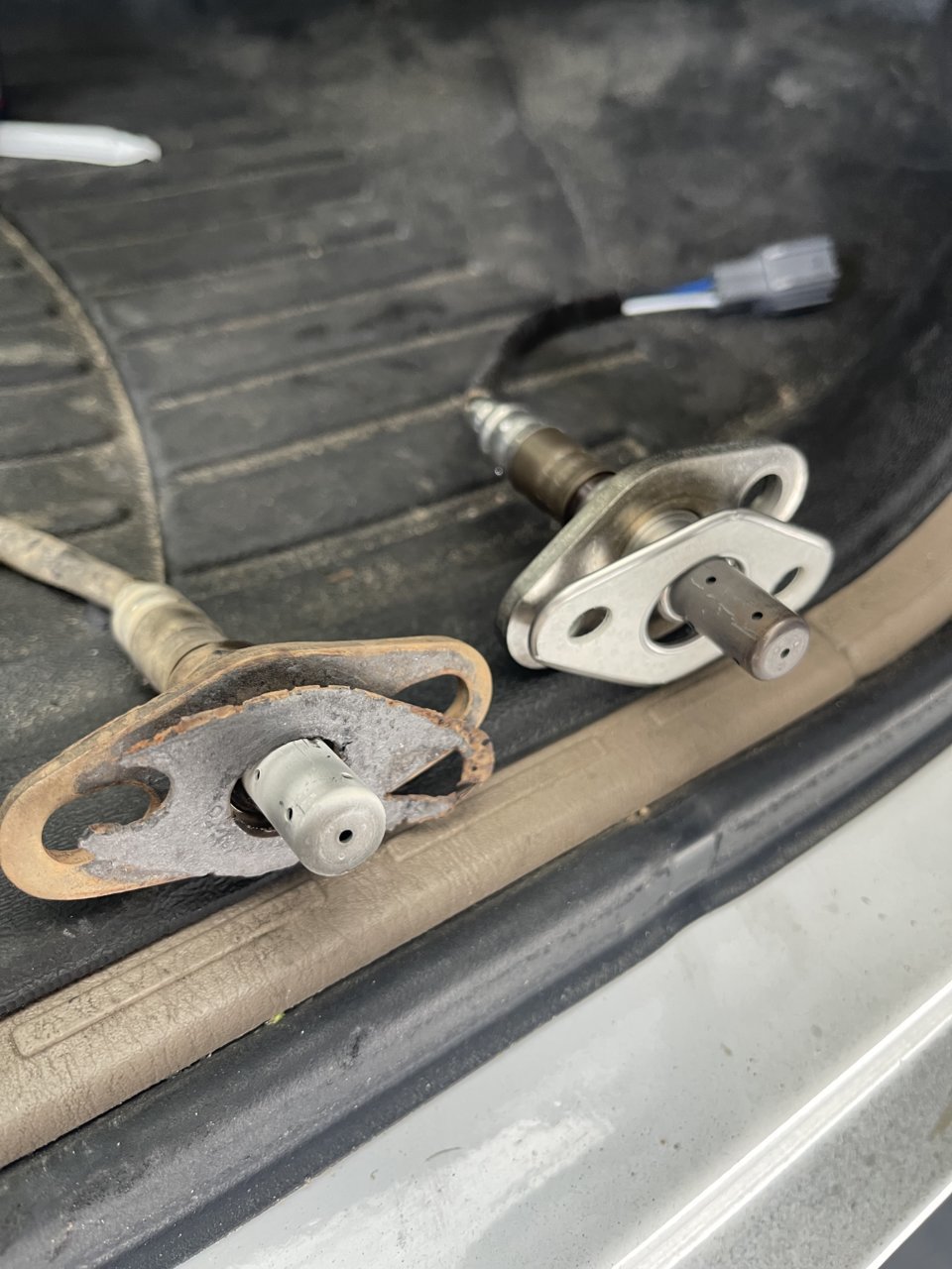

    Chasing a p0300. Hoping this helps. Upstream sensor replacement. Denso.

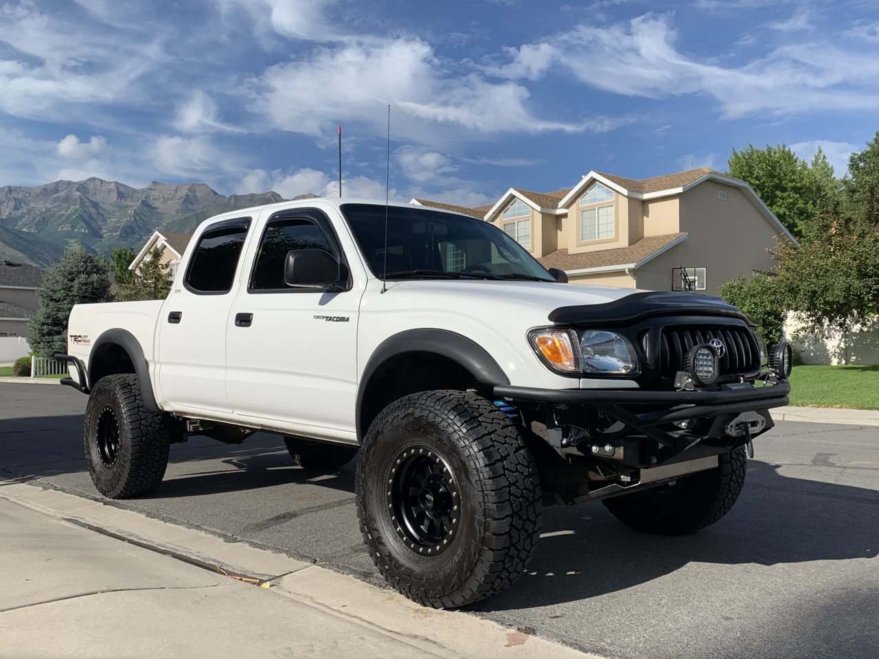

    polished the turd. :)

    Very nice!

    That looks great!

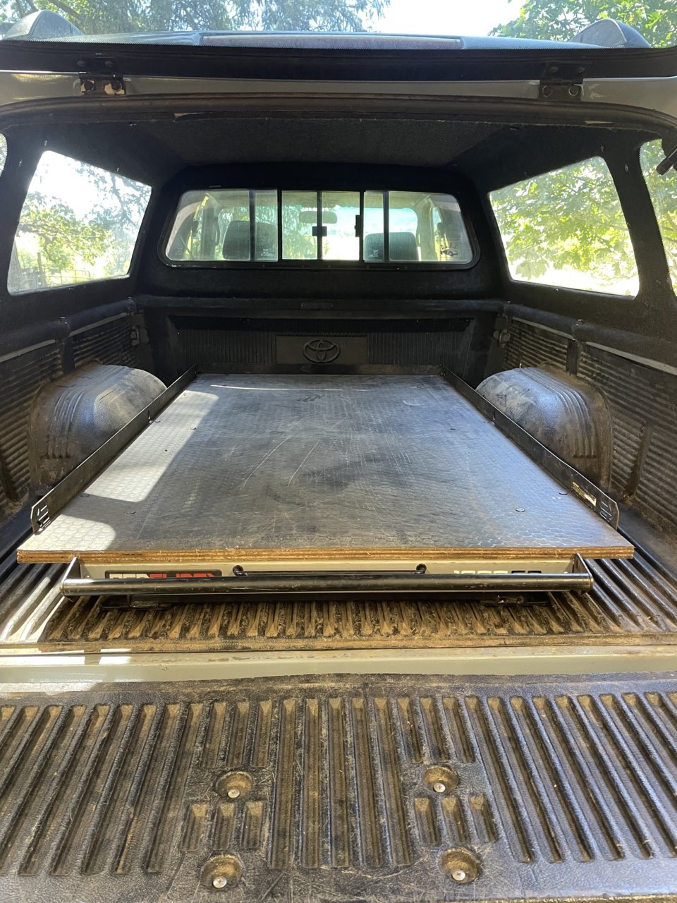

    Picked up a BedSlide last week and then installed over the weekend. Was about 8 inches too wide to fit between fender wells so Sent the deck through table saw and then trimmed up and welded the metal “skirt”. Couldn’t have asked for a more perfect fit lengthwise though, from back to handle is 73.5”. So far I’m really liking it. I think that L-Track will be the next installment to make a functional setup. Anyone have brand recommendations?

    Awesome.
    How tall is it?

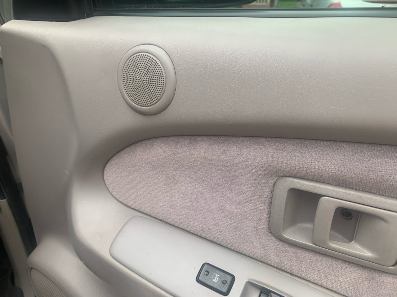

    Yep, not much to see though. Went with the smaller size tweeter so I wouldn't have to pop off or modify that grille.

    did you use the OEM crossover for that new tweeter?

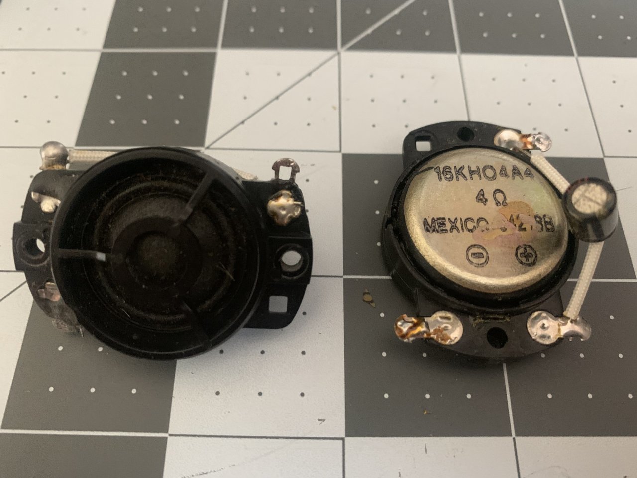

    I didn't see one, but I didn't trace the wires all the way back to the head unit. The JBLs came with a high pass filter that I secured to the inside of the door panel. I think the OE tweeters filter out the lower frequencies using the capacitors soldered onto the old tweeters. Is there another OEM crossover somewhere that I need to delete? I have an aftermarket stereo as well, for what its worth.
    [EDIT] Here's a closer look at the factory tweeters and the capacitor I mentioned.

    Nice bedslide! I got a well used one from a friend who bought a truck that already had it. He didn't want it so I offered to haul it off and cut a new deck to fit the taco and cut the side rails and painted everything. They're a totally worthwhile mod for anyone with a low rack or a camper shell.

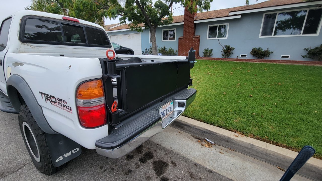

    Tailgate custom made by Ghostship. Tire carrier and foldiwn table.

    It’s 4 3/4” from bottom of truck bed to top of cargo deck.
    that’s awesome, and glad to hear you like the mod, I haven’t gotten the opportunity to actually use it, but I’m enjoying the thought of not having to crawl under the canopy to snag something from a cooler or readjust everything to snag a tool.
    what’d you end up using to re-deck yours with?
