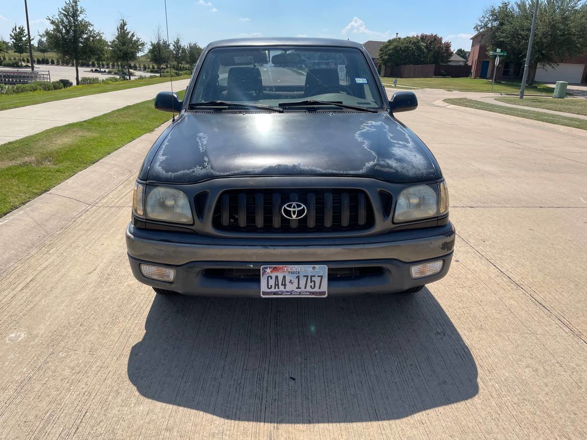

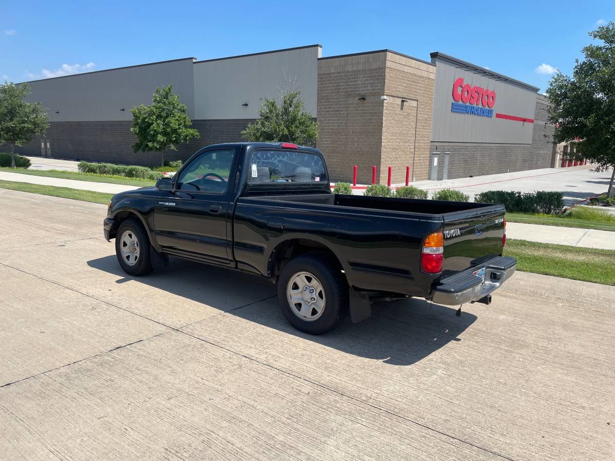

    That 20 year old tint was a pain in the a** to get off. Got ceramic tint for it 30%. Already did the back window.

    Nice Truck, and Welcome!! This heat wave is brutal, so getting your AC going was a worthy investment. How many miles on your truck, if you don't mind me asking?

    126K The sun baked the paint. Texas truck.

    Thinking about getting this soon after getting some tint on the dd. Anything to make it cooler, nice part about ceramic is it doesn't need to be super dark for the heat dispersion so I don't need to feel blind in the winter darkness either.
    Also I feel like all the trucks in TX/NV/AZ/Socal look sun baked like that.

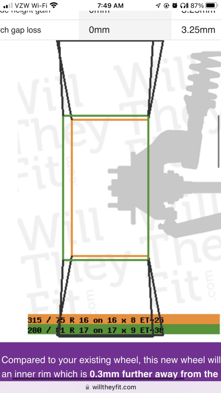

    I’m just running the 3.5 backspace F5s, no spacers. I still get frame rub, but I didn’t want to deal with the poke that I had with the 1” spacers. Even at 2.5 total backspace, I'd still rub at times. At this point, it’s just part of the game.
    I am considering running 35x10.50/17 skinnies down the road to keep the same poke and get the inner tire off of the frame some.

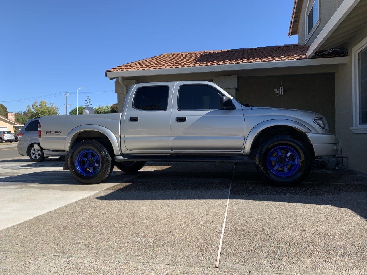

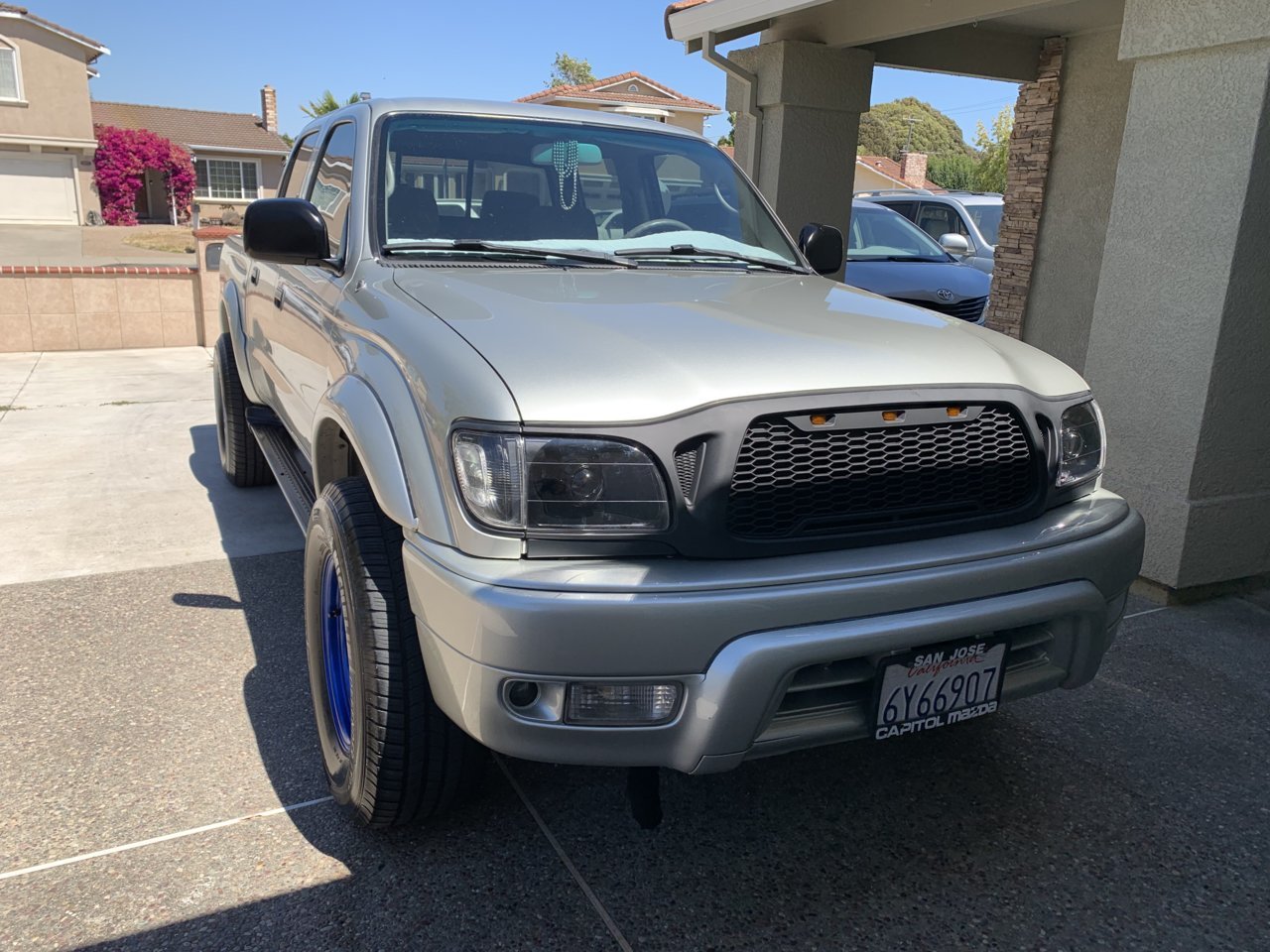

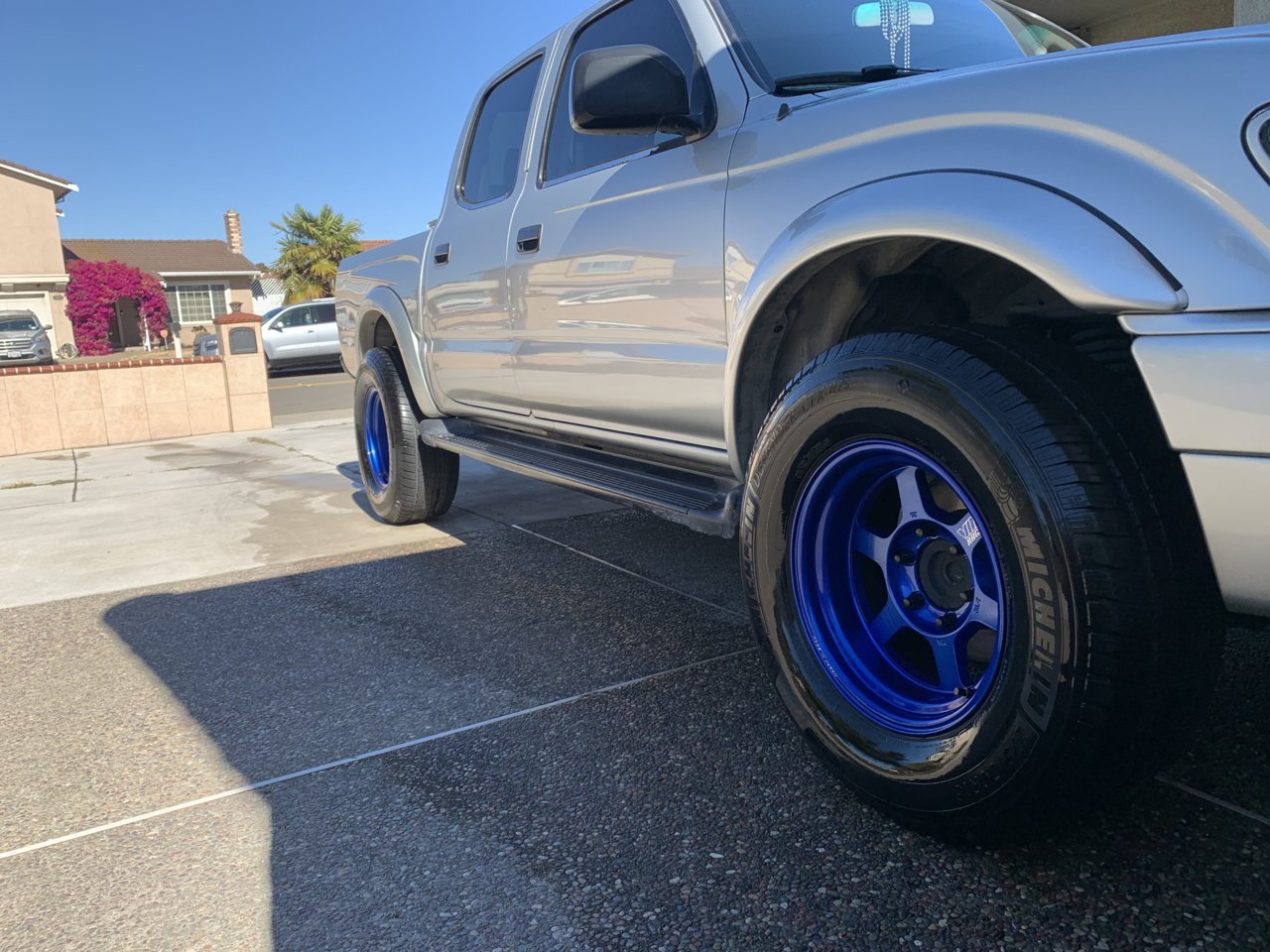

    New addition to the rig:
    4runner Front Bumper Swap
    Facelift Grill
    Retrofitted Headlights
    TE37xt Rims in Hyper Blue

    What did you do with the bumper mounts? Cutting and welding, or just use the couple of bolt holes that lined up and called it good enough?
  17. Jul 28, 2022 at 12:31 PM
    rnijjar17
    rnijjar17 Well-Known Member
    Sep 29, 2011
    #64385
    94
    yeah it pretty much up and bolts on directly but theere is a plate you have to remove from the oem 4runner bumper to allow access for the bolt holes

    Interesting. Maybe the post-facelift ("fat lip") 4Runner bumper is friendlier to transplanting than the earlier bumper.
    I have a '98 4Runner bumper on my '98 Tacoma and only two of the four main bolts lined up. I called it "good enough" since it's essentially a trim piece.

    The "other" two holes are slightly offset for the 4R than the Tacoma's mounting holes.
    If you ever wanted to utilize all the holes, you'd just need to drill the two and call it done. They're maybe only an inch and a half over or two.
