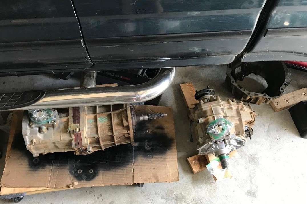

    Started more heavy MTX on my '97 Taco 4x4. Pulled out the R150F 5 speed manual transmission for rebuild. The original OEM clutch assembly was pulled & still looked great. But it will be replaced along with the T/O bearing. Pulled the flywheel to access the rear main seal. No leaking but will replace it with a new OEM rear main seal. Will remove and replace the pilot bearing at the same time. Separated the bell housing and xfer case from the R150F tranny. All the parts got pressure washed to remove 25 years of our sandy Mississippi mud then dried in just minutes in the direct sun. It was a very long, hot day. But I got a very good start on this project.

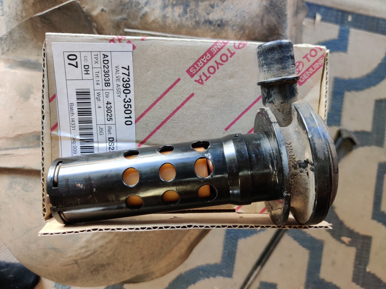

    Hey you, I dig that tank. I need to replace some bits on mine before putting it back in, but don't know what parts are what. The diagrams on this think are confusing. Can you share your partnumbers?

    The extra cab and double cab have different tanks and some other parts are different as well. Without seeing what you're looking to replace I don't know what you need

    Thats fair. Mines is an xtracab. Can you just tell me what these circled parts are called and I can go from there?

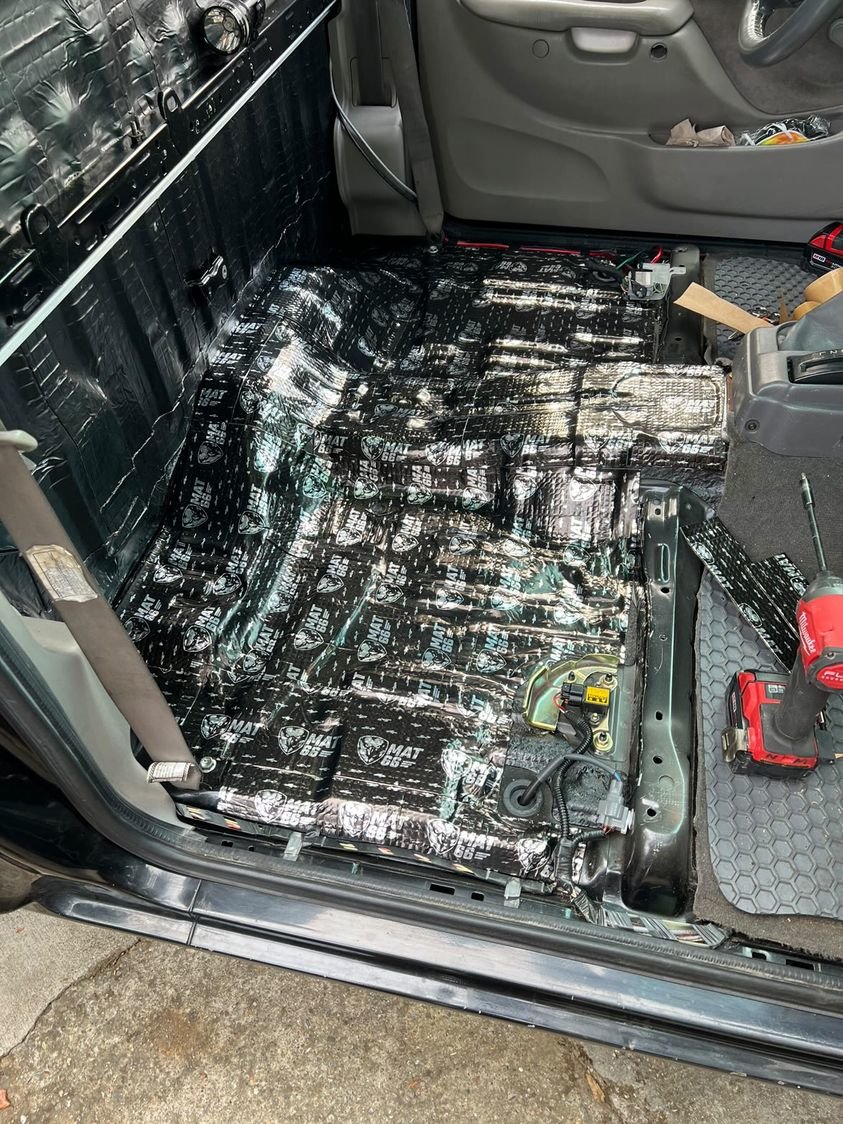

    Pulled the bench seat in my single cab in anticipation of new seats.
    Installed a layer of sound deadening on back half of floor, and a second layer on the tunnel.
    Mocked up junkyard '04 Celica seats, gonna use Corbeau brackets to mount them.

    put more of that on the back wall and doors. You'll get way more out of it then putting it on the floor.

    I've already got some on the back and inside the doors (did it a while ago, different product its all black and hard to see). I've got the roof covered too.
    I'm going to put some Thinsulate behind a panel I'm making to cover the back part of the cab, which will also serve as a mounting point for amp, radio, etc.

    Underneath the red valve circled

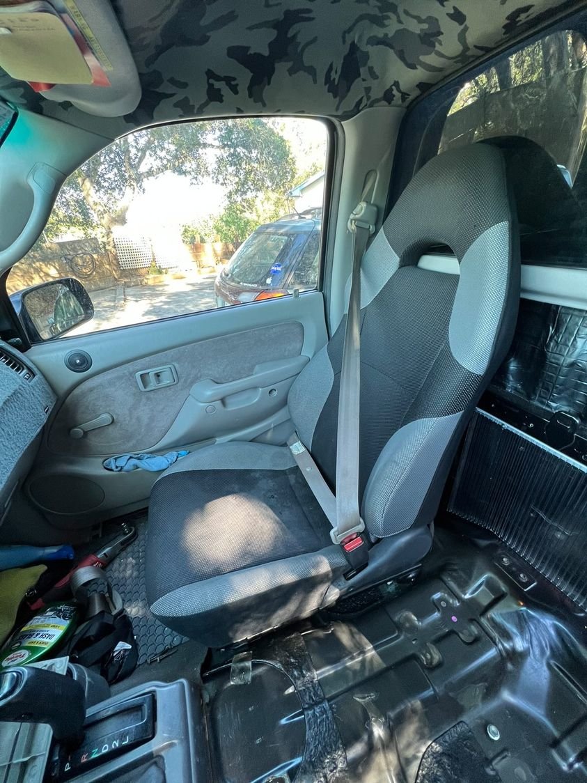

    Jumped on the WRX seat bandwagon. I’m only 5’8 so the height increase doesn’t bug me at all. Pretty solid upgrade.
