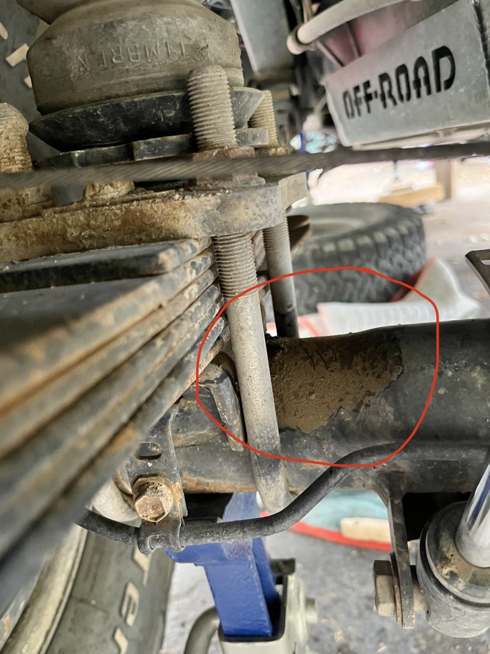

    It's cracked.
    Read through this thread.
    So you push your 1st gen offroad - what cracks next?
    Several members, including myself, have run into the same thing. There's a few different ideas in there on how best to fix the issue.

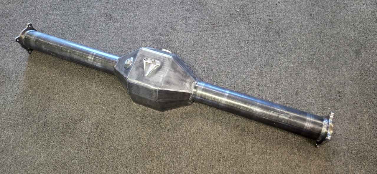

    Wallet can't do full retard unfortunately. Read through the thread, looks like 3" pipe works as the gusset pretty well.
    Dumb question, does that pipe gusset addition change the size of u-bolts, or would the all-pro shackle flips clear?

    If you're only plating the top of the tube, shouldn't affect size.
    The durobumps U-bolt flip kit I got was loose-ish around the axle tube when new and tightened down so should have room even if you plated around the entire thing I'd imainge

    The TRD will have a rear e-locker. I think there might be a minor modification required on a non-e-locker rear housing, but I'm not 100% sure. I see you're already upgraded with inverted U-bolts.

    Just has to get the matching rear end housing for his application. 8 in e-locker vs 8.4 open housing

    I currently have the 8" e-locker w/ non-abs, have found another same housing somewhat local at a junkyard for $250.

    Just FYI, all elocker housings came with the ABS ports etc.

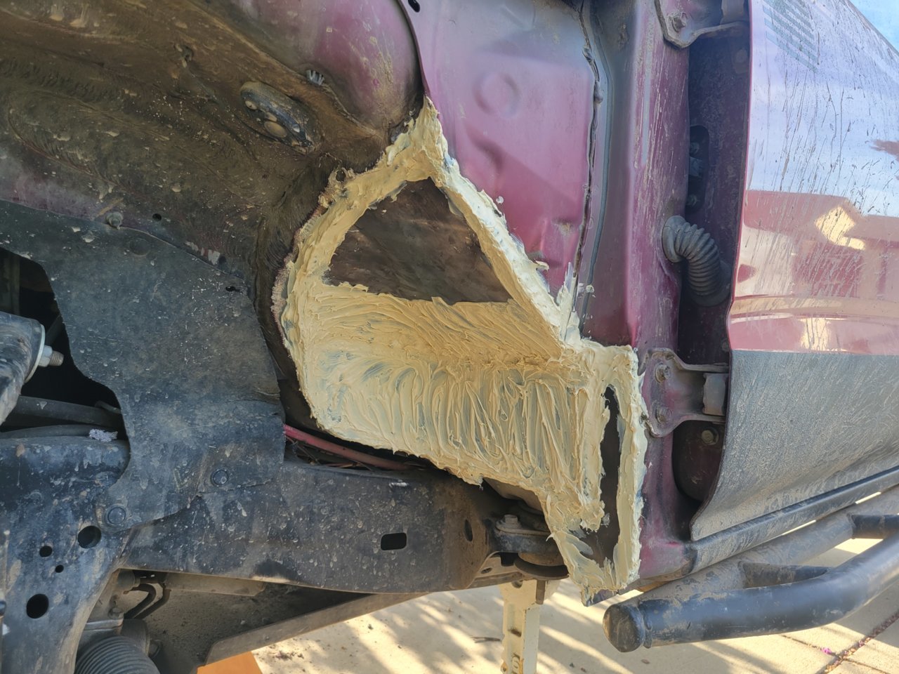

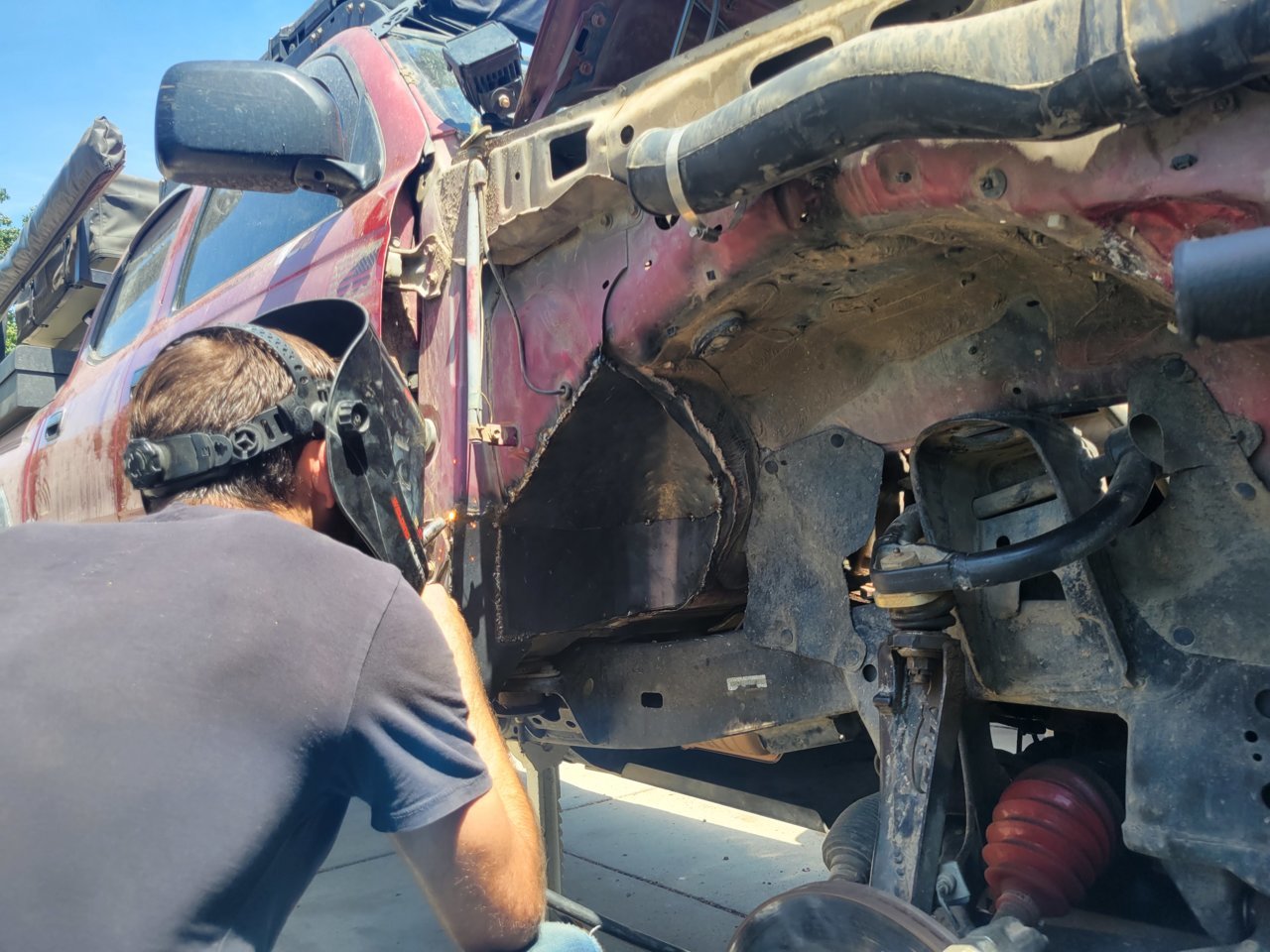

    And
    :welder:
    Is done.

    Now to seam seal, prime, raptorline and rubberized undercoat

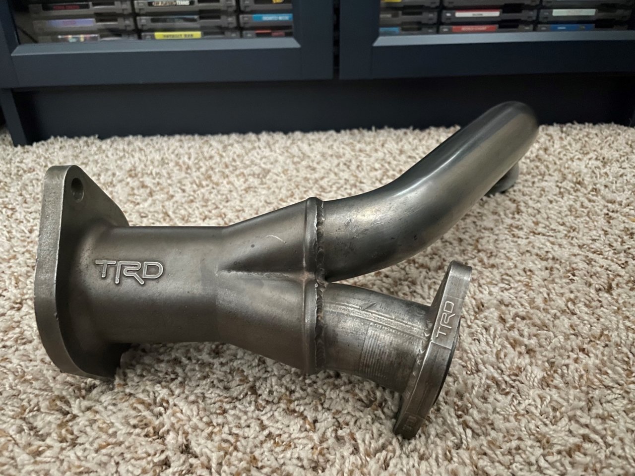

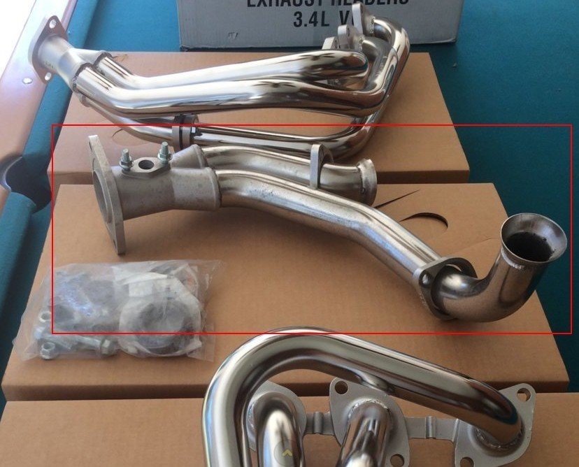

    Was stoked to help a fellow TW’er out! Glad the y-pipe arrived age and sound, let me know how install goes once that bridge is crossed.
