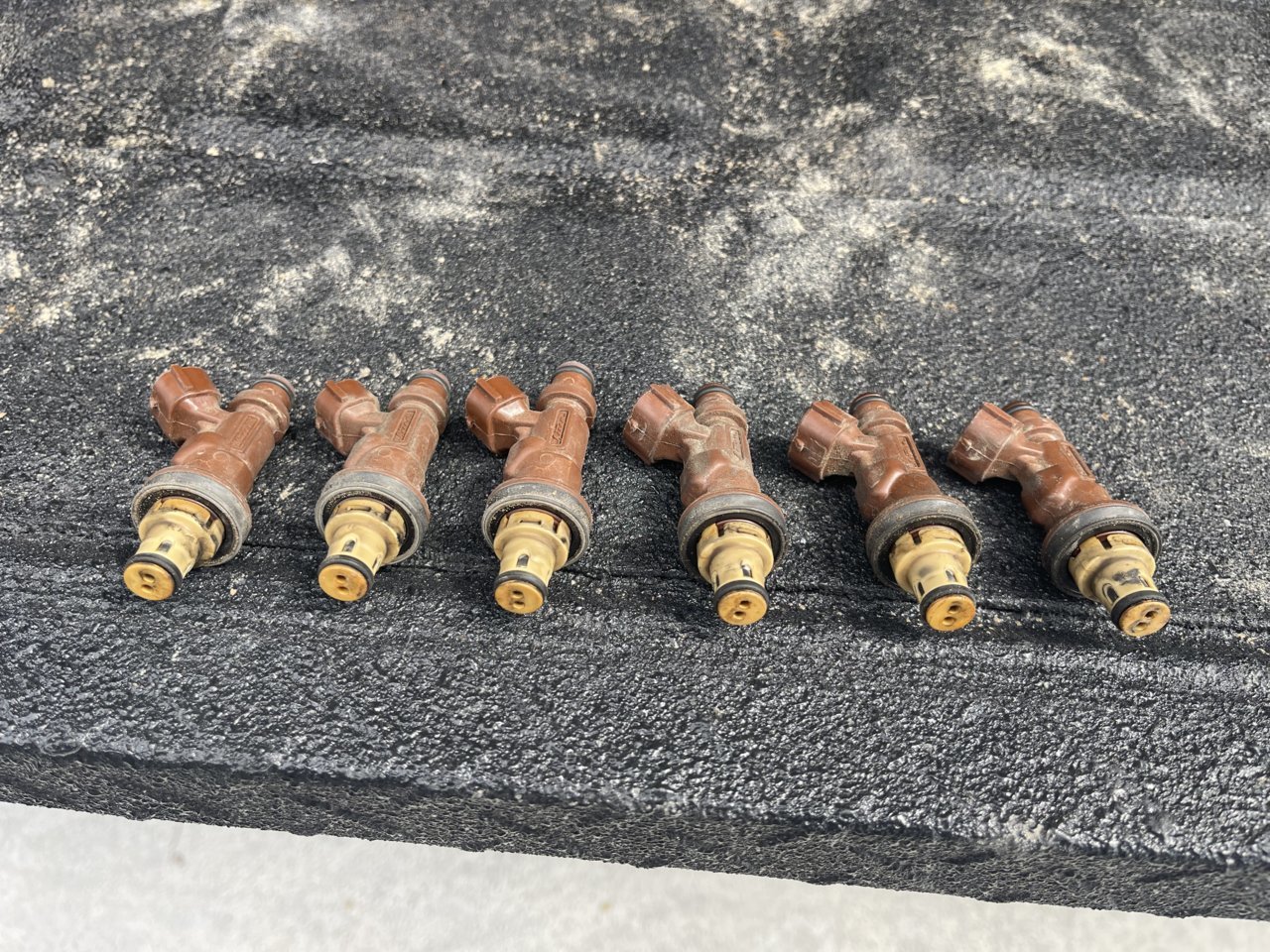

    Ripped these out yesterday and replaced them with the upgraded Denso motor west injectors. Hoping it could fix my p0300. Also replaced the fuel pressure regulator. I can’t hear the misfire anymore when starting but my CEL just came back on but now the p0300 is under pending codes and my p0420 is under stored codes. Usually it was the other way around.
    Starts and runs great though.

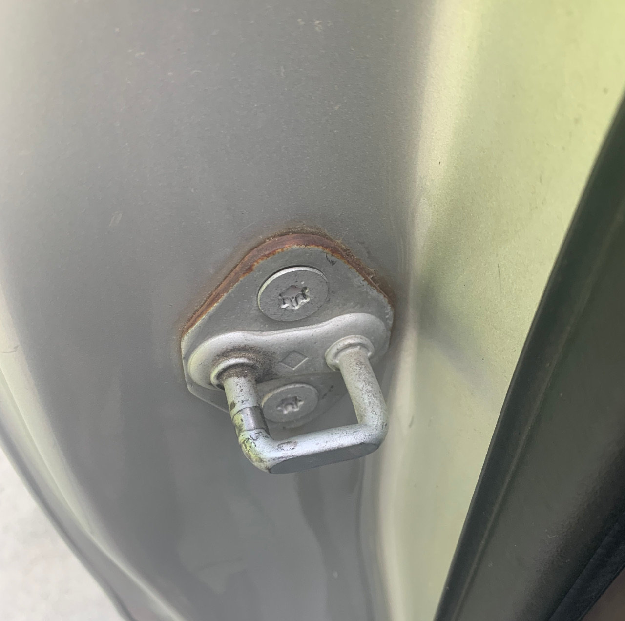

    Lol. Not going to lie, I was thinking about him and those rope hooks while I was removing them. I try not to be OCD about my vehicles though, at the end of the day it's just a truck.

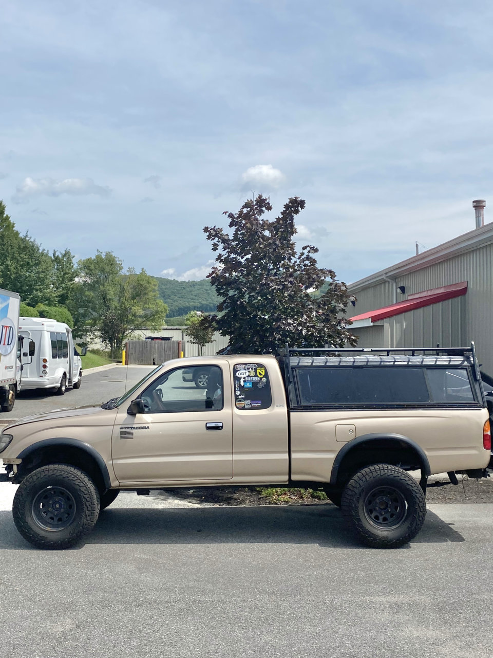

    First post on here! Got new wheels and tires, 15x8 FB marketplace find rims with 4" BS and 32x11.5R15 Falken Wildpeaks IMG_0508.jpg

    Looks great, now mount the bumper!

    Unfortunately the bumper is gone from rear ending someone in the fall. Been saving since then to try to budget in time/money to make a tube or plate bumper

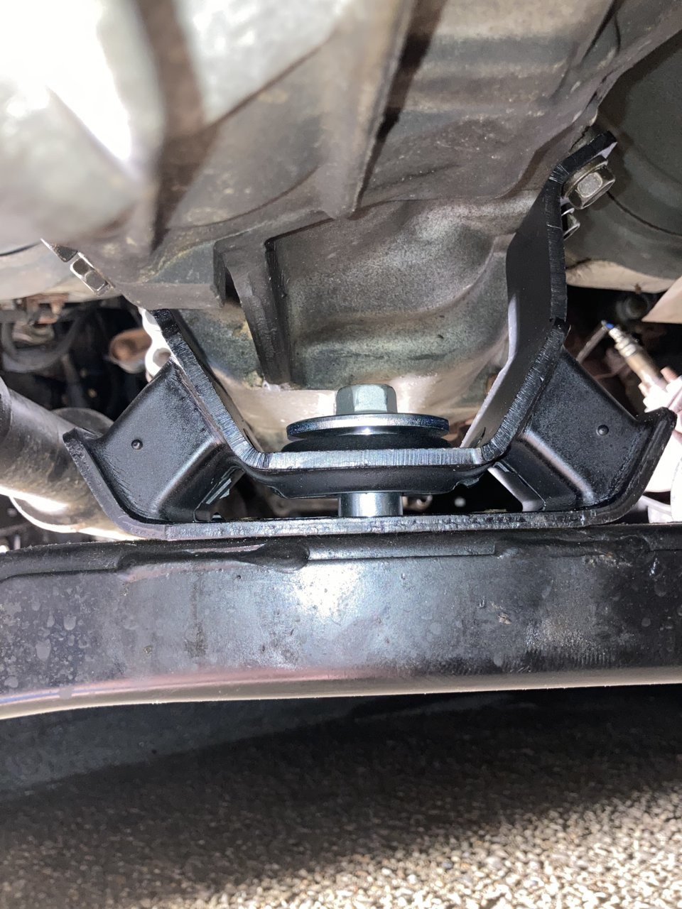

    7DCF0720-36C3-4757-AFD3-0321E2B9579D.jpg Changed the transmission mount. It made such a difference driving it down the road and hitting small bumps that used to make the transmission and transfer case bounce an extra bounce or two. Next up, motor mounts. Not right now though!
