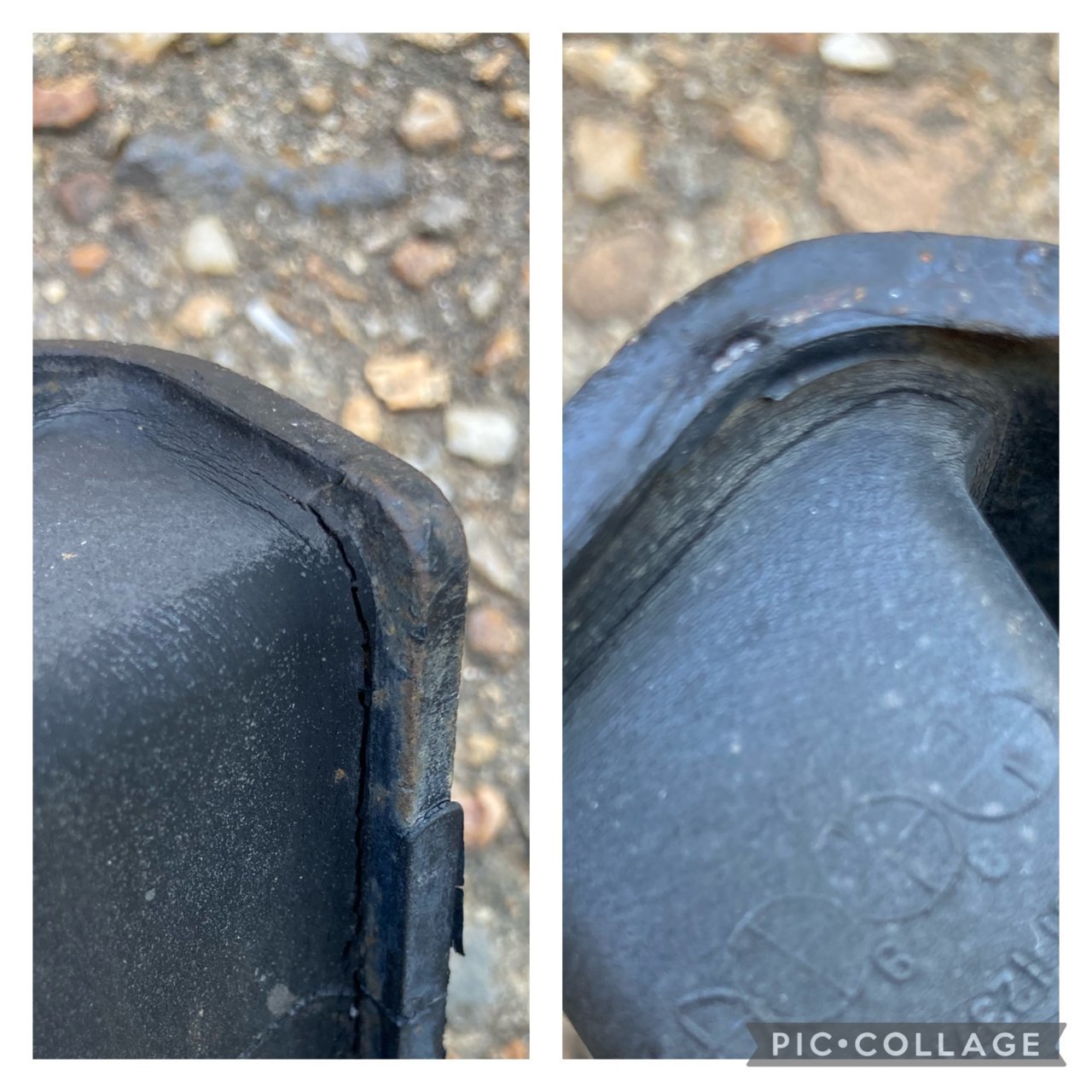

    Do you have pictures of the one you removed and was it noticeably worse/breaking apart? Did you have any like thuds or movement when changing gears (assuming it's manual). I typically get a sort of thud switching gears, especially into fifth gear, and I'm not sure if it is related to the mount or not, mine mostly appears fine and Timmys video on replacement made me think it wouldn't be worth the swap. I also have a vibration that I've thought could be from the transmission mount but I'm guessing it isn't that.

    It's pretty easy to swap. Undo the bolts to the trans and crossmember. The get a jack to lift up on the rear of the tcase, might even be able to push up on it by hand.

    2B5641F0-F19A-481B-B2CA-A9DC3ADBD02C.jpg Here’s the old one. The cracks are like that all the way around. I could definitely feel a thump on bumps. Both the gear shift and the transfer case shifter would visibly bounce. I initially found out that it was bad by putting a 2’ pry bar in it and prying both up and down. I could see the cracks from that. I didn’t notice the separation around the metal plates until I took it off. It’s super easy to change. The torque specs on the bolts is so low that it doesn’t take much to get them broke loose. I also sprayed them down with PB Blaster. If you do it, save yourself a lot of time and headache and just order it through Toyota. I couldn’t find one shown anywhere but 1 place locally. They ordered it and it was not the right one. I found another that said it would work in Miami. I ordered it and it didn’t fit. I finally went to a local dealer and they looked it up from the VIN. Ordered it and it is a perfect match. I wasted over a week trying to get one that was cheaper than OEM.
