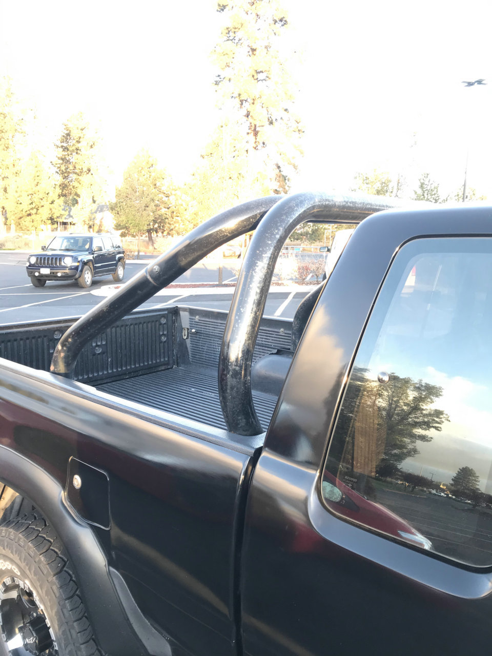

    ok, not what I have done but what I want to do.
    I'm looking for one of these to retro/Back to the Future out my reliable old 2003. Does anybody know the brand/type?? This guy appears to work at the local WalMart, perhaps I should leave him a note and offer an obscene amount of $$$.IMG_1363.HEIC.jpg

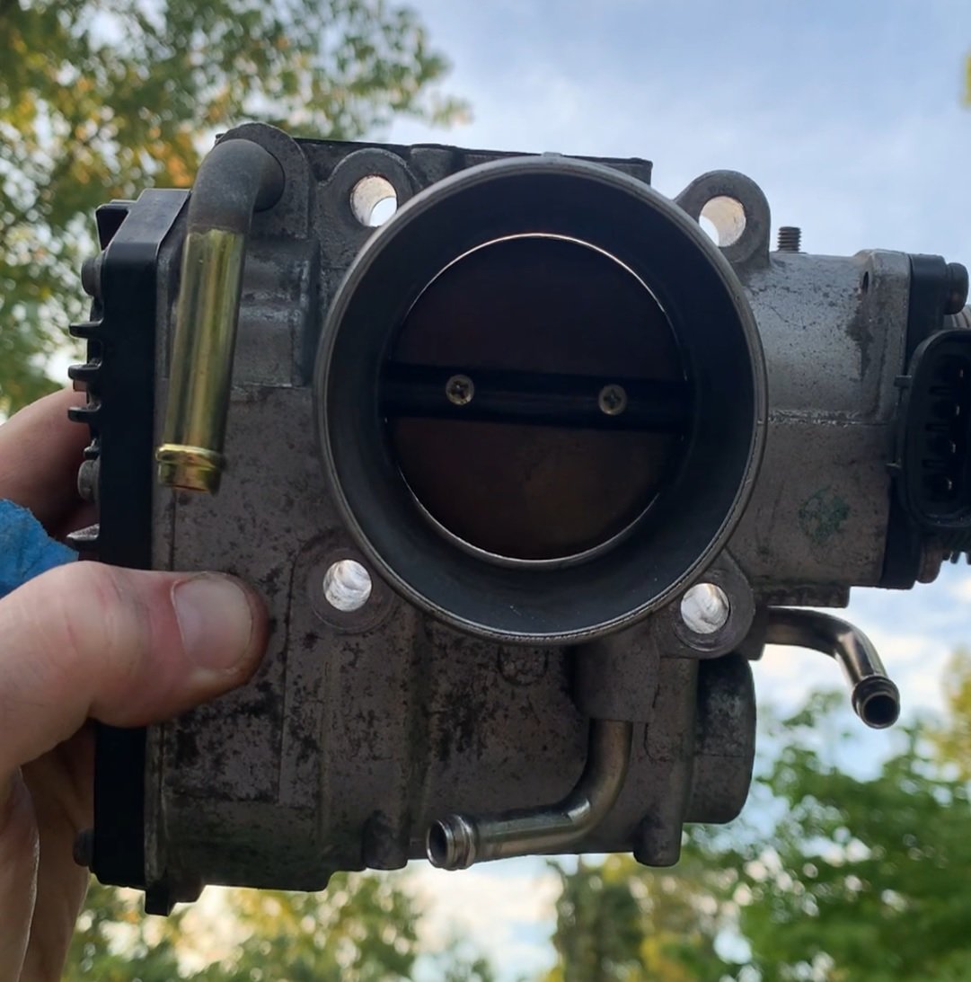

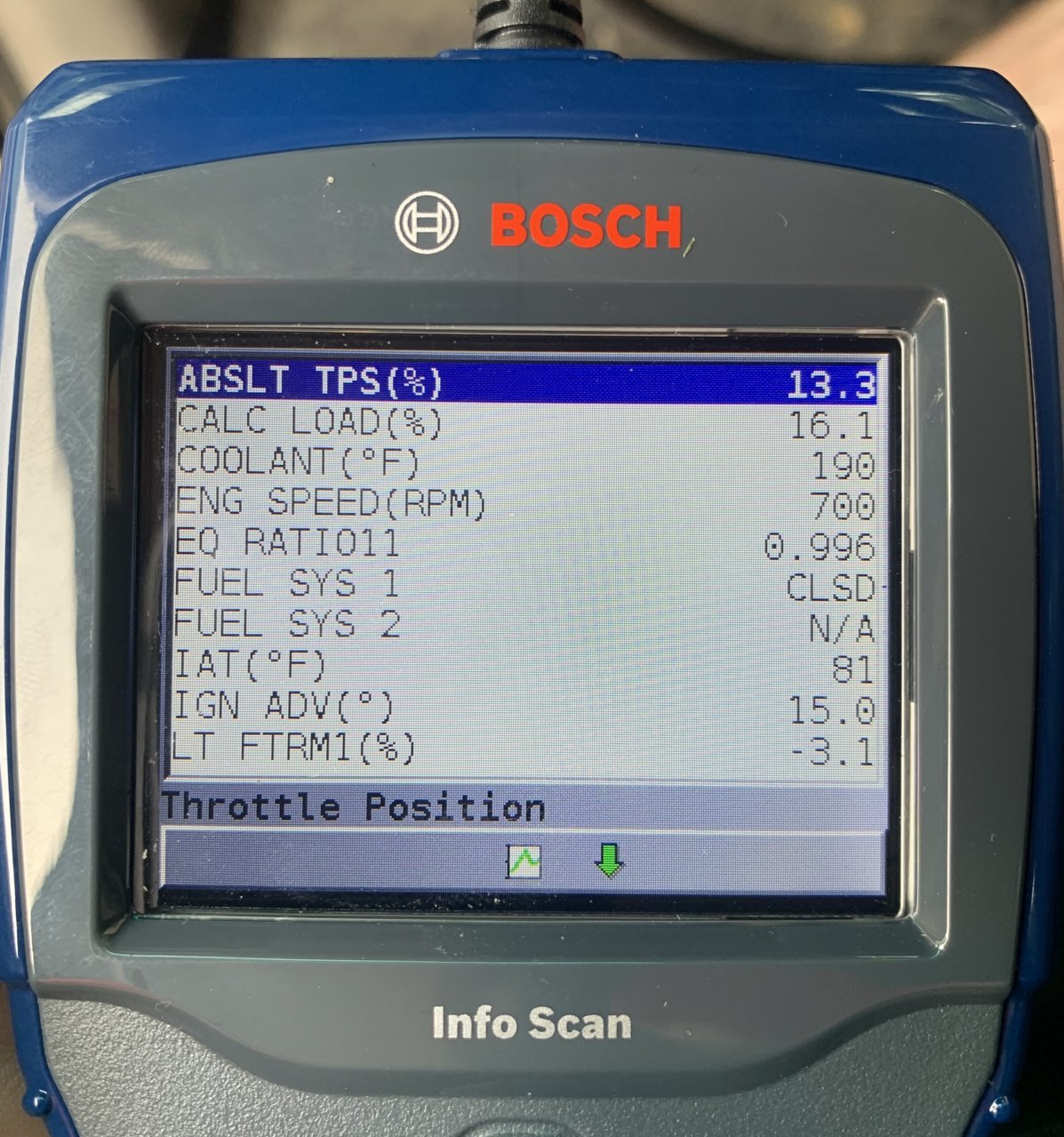

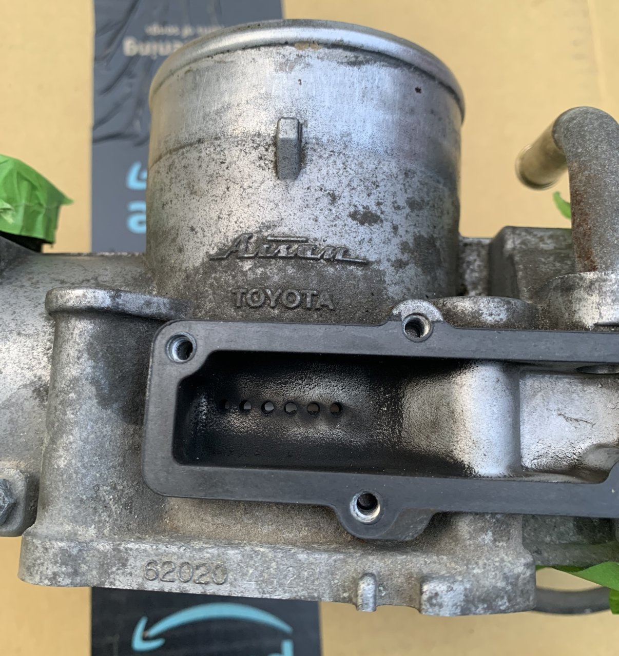

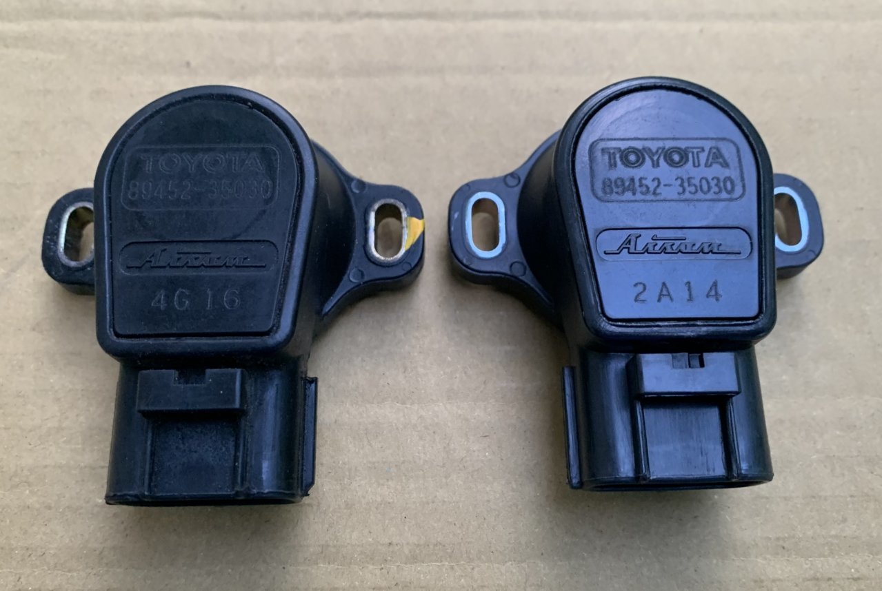

    Replaced the throttle position sensor yesterday and gave the throttle body a good cleaning. On very rare occasions I was noticing a sudden loss of power at a little over 2000rpm. This would only happen maybe one out of 50 times when leaving my neighborhood and seemingly only in 2nd gear. Once up to speed it wouldn't happen. I tried the "pump the gas pedal 100 times" trick, and that seemed to work for 6 months or so which made me inclined to think it was a dead spot on the TPS. Once the issue came back a couple months ago I figured I'd try installing one of the Aisan TPS sensors (W0133-2744128). I was toying with the idea of buying a shiny new $450 throttle body, but frugality prevailed.
    Job was pretty straightforward. I stripped the lower TPS screw even with a JIS driver and had to cut a notch into the screw and use an impact screwdriver to remove it. Took me three tries to get the TPS adjusted correctly. First was too high, second was too low, third was the goldilocks setting.

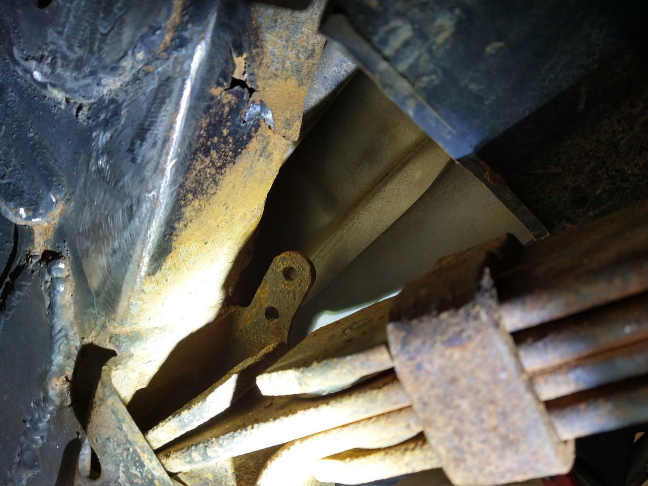

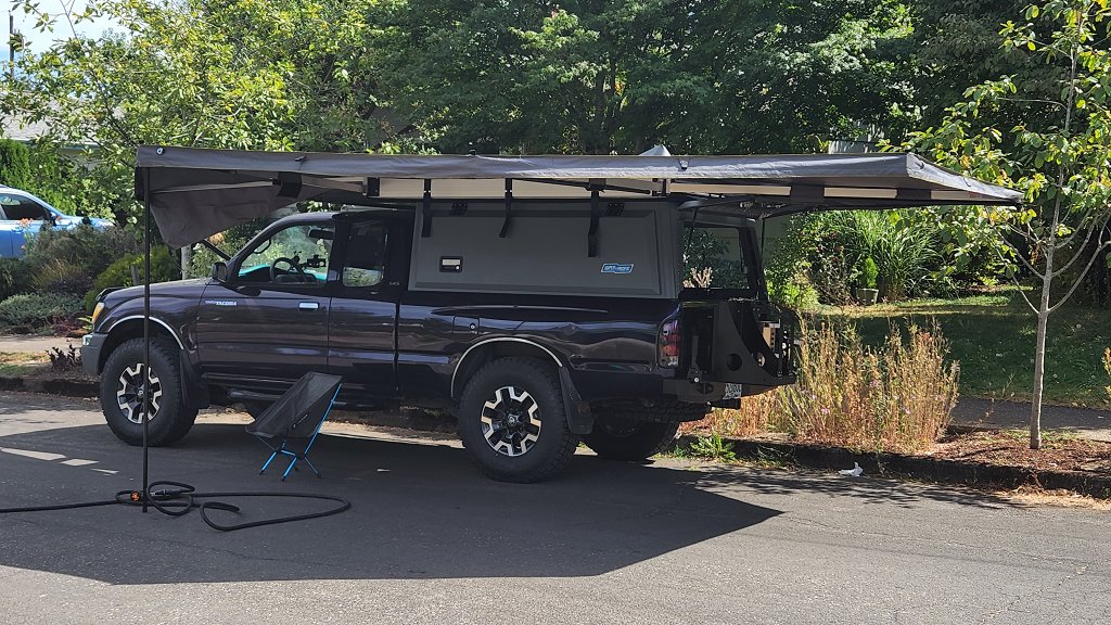

    Mounted my OVS awning just in time to provide shade at our street's block party.
