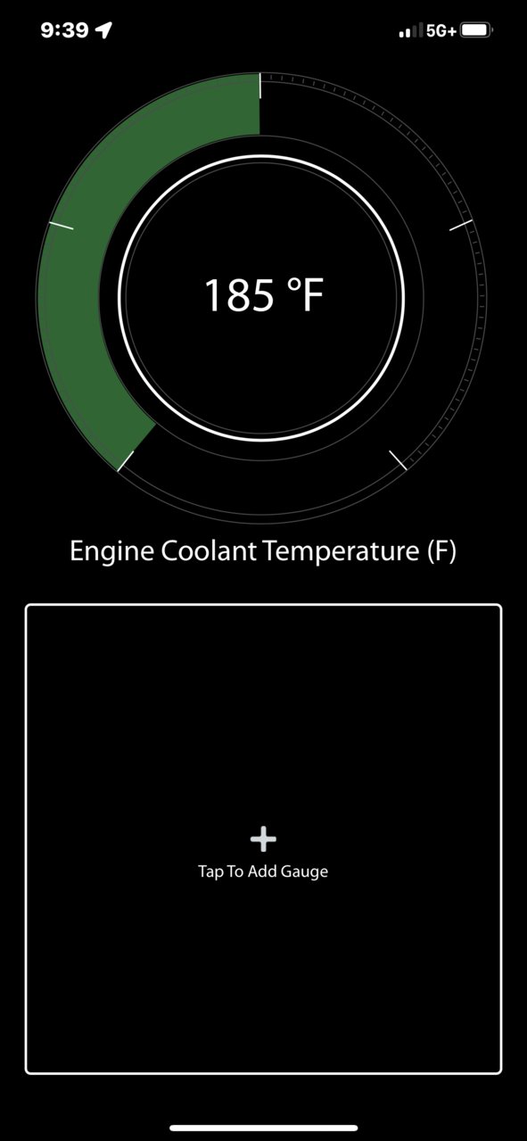

    Messed around with the live data option through my FIXD. This was going through town to go buy some of this stuff. Pup says hello.

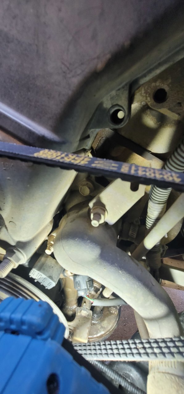

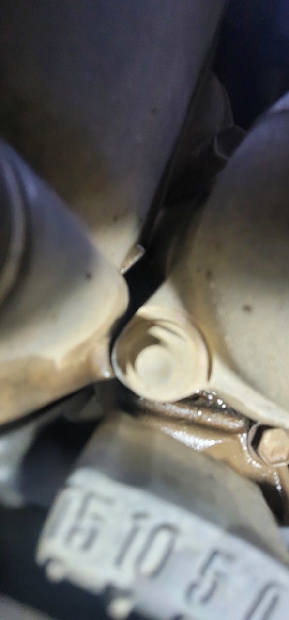

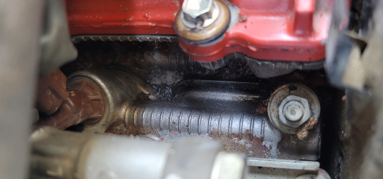

    Nope. Cleaned everything up and shoved a rag to see a general area.
    Looks like the mystery liquid is actually coolant.

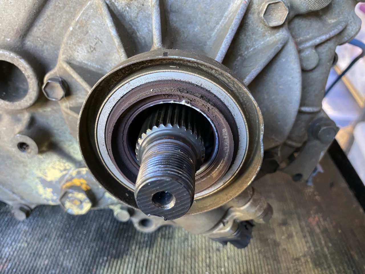

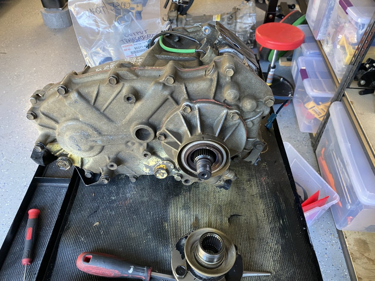

    T-case getting some love

    Hmm, well your thermostat housing and lower radiator hose are right above there.

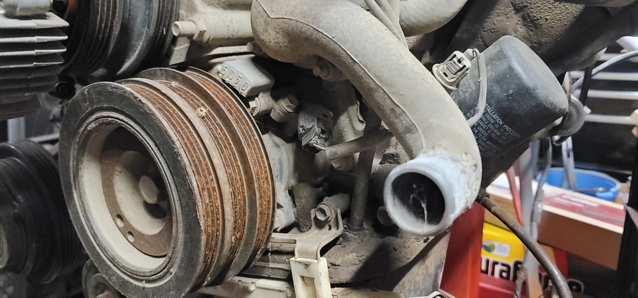

    Doesn't appear to be from the lower hose. More from the block. Can you show me on this other motor where the potential culprits could be?

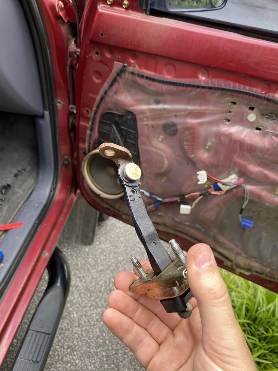

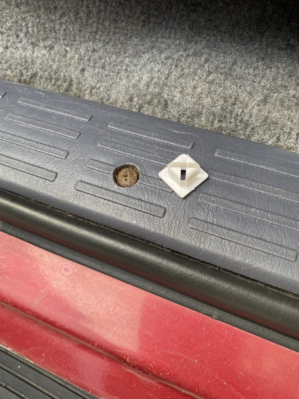

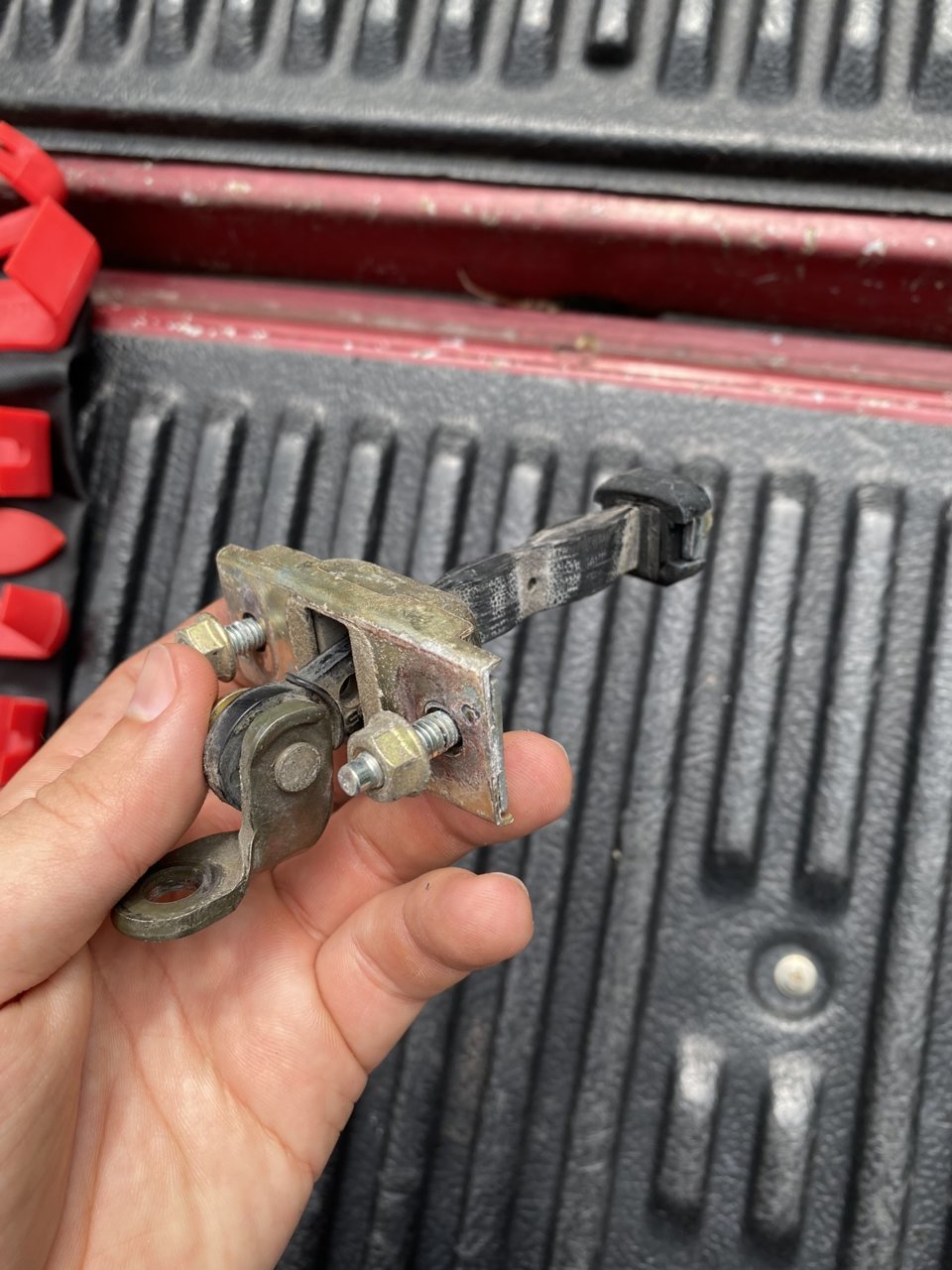

    Been raining daily in SC took the opportunity to do a few small things before taking a drive to Charlotte. Cleaned the inside and replaced a door check that was broken, only lost 1 clip while taking the door off which is a solid win. Also found a nice solution to the door sills that are just no longer attached to anything, a license plate plastic nut 1/4" fits in pretty nicely. Mind the pile of grease... it was making noise right after install.

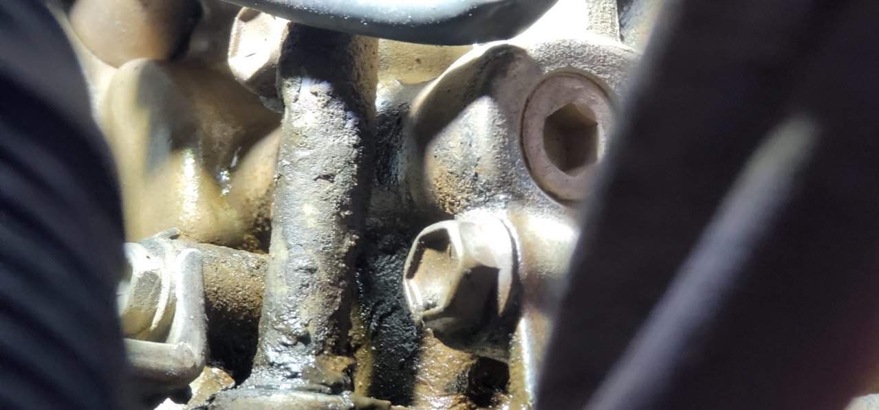

    Hmm
    It appears to be coming from behind the thermostat housing. But I also found coolant on top of the right block behind the valve covers under the lower plenum. Unmistakably red and crusty, photo for location but I cleaned up most of it.
    Curiouser and curiouser
    UPDATE:
    Ok... so looks like it's coming from behind the thermostat housing?!
    What is and how?! Or is there something above that?!

    Its your oil dip stick.
    see:
    That crusty looking thing dead center just pops out of the oil pan. I've had mine get real loose and spin most my oil after doing the supercharger. Undo the bolt that holes the tub up by the alternator and give it a good push down again. Or the seal on it is going bad.

    Stuff leaks from the top down and can be deceiving in where it collects and puddles.
    Go to a car wash and blast it clean, then keep on eye on it until you see where it's coming from.

    Nice find on the license plate nuts, I'll be doing this as well.

    If it’s behind the thermostat housing, it’s coming from the waterpump. As Monte pointed out, your dipstick is pretty crusty, might want to clean that up anyway.
    The coolant in the block valley under your intake plenum is from the cross over coolant pipe under there, very common leak point.

    Got them from Ace... think they were the GM 1/4" ones. They needed a little juice to push them in but they'll pop right in

    You have a coolant pipe that goes off the side of the thermostat housing over to the oil cooler. No one ever changes it and it's exposed to a ton of heat so it's one of the more likely culprits for bursting or at least weeping
