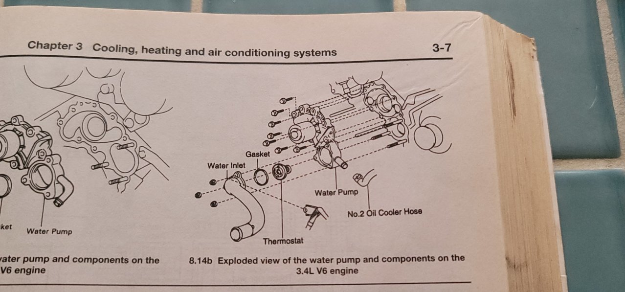

    Ok. Is the thermostat housing separate from the water pump? Because based on what I'm seeing the hose is fine, and so is the front portion of the thermostat (water inlet) but the backside of the water pump is what appears to be leaking.
    If that job was done "poorly" could that gasket have failed? Oh hell... its rtv?!I
    The link appears to be emanating from the back side of the water pump at those three studs.
    What would account for the coolant on top by the valve covers? I can't imagine the thermostat or oil cooler hose contributing to that.

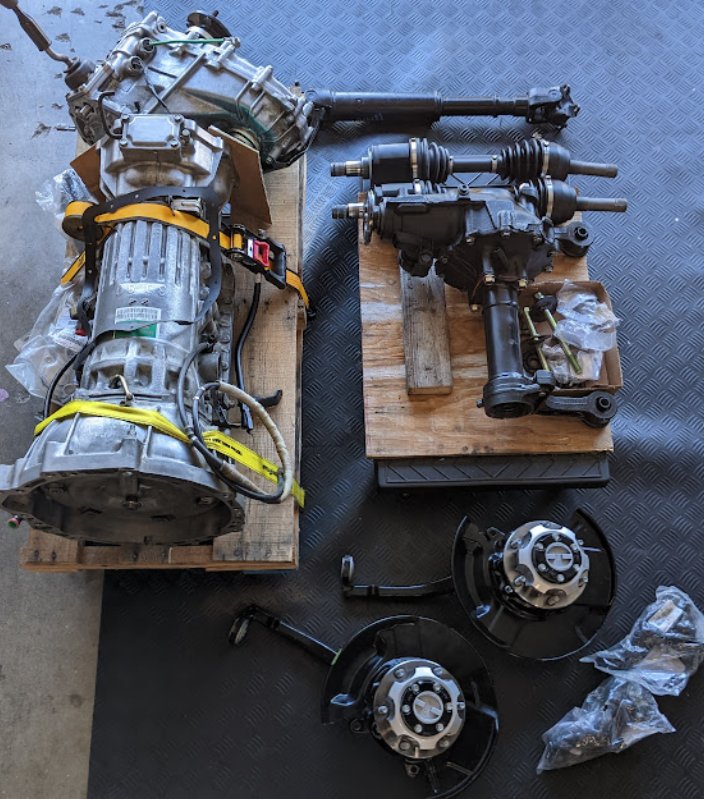

    Just about ready... Still need to change the TCASE input shaft seal and replace the filter on the transmission. Need to resolve the rear drive shaft. Other than that, ready to start working. Lower ball joints will be changed as well.

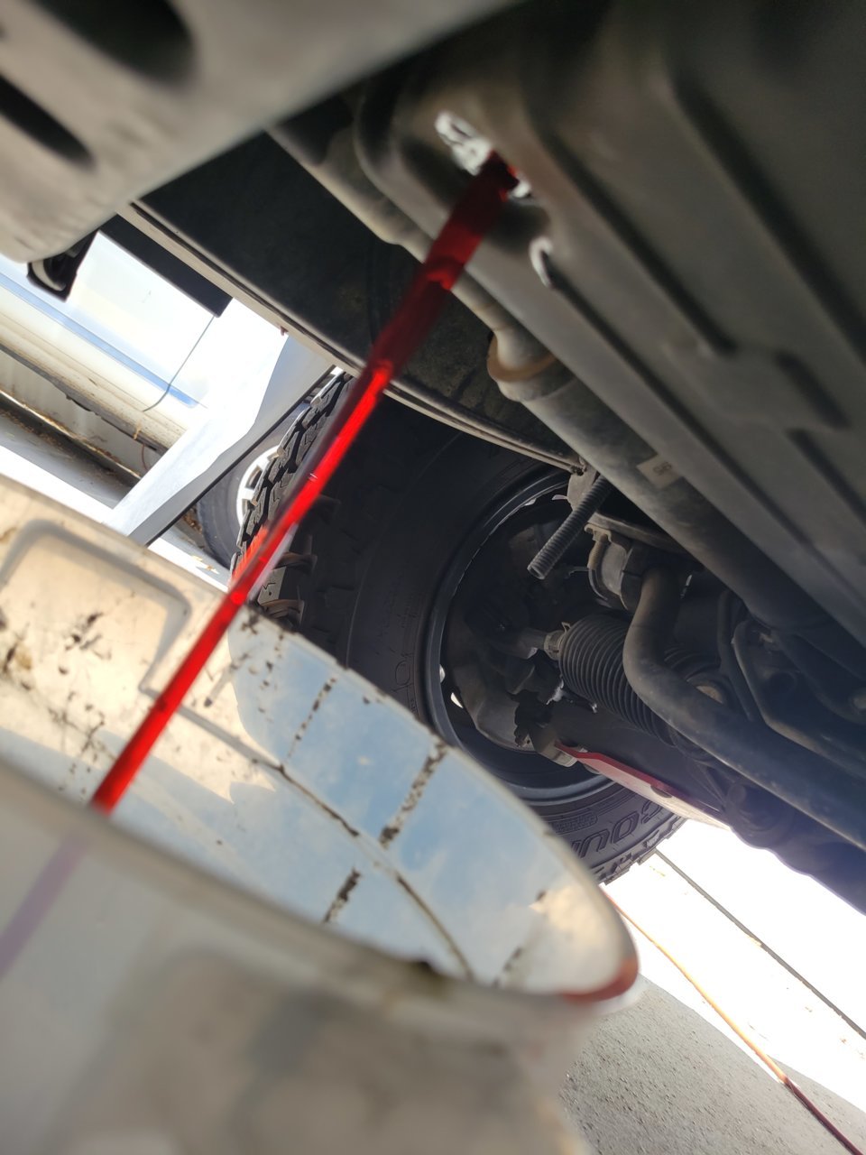

    Changed my transmission fluid at 202,272 miles looked fresh to me...last time done was at 128,639 miles. Used some toyota IV this time, I paid someone else to do this before. The easiest job done, took less tha. 20 minutes. Paid the dealer 180 back in 2015. Fluids and washer was only 54 bucks. Woot
    Forgot to mention, the bolt did not have washer when I remolt drain plug.

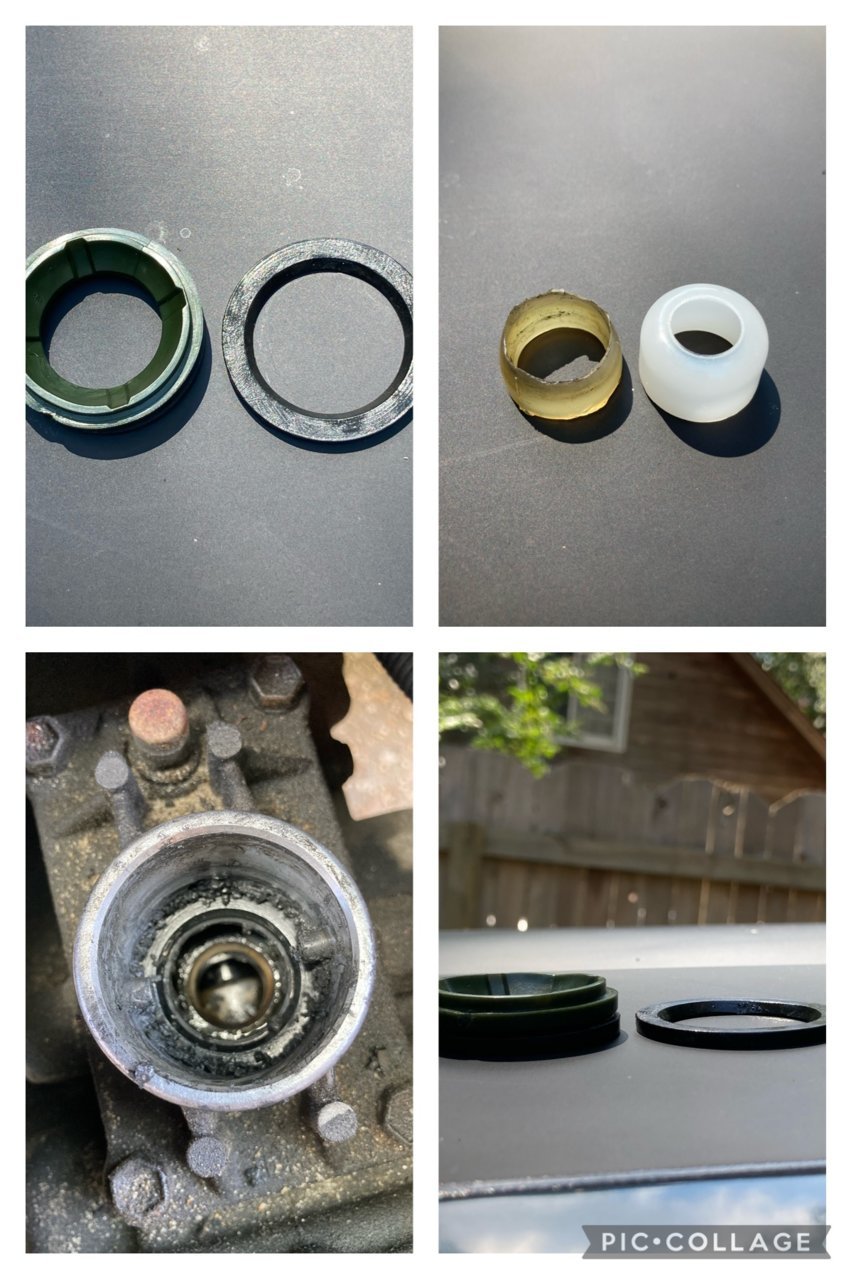

    8C1FB953-FC66-443E-B26D-87A92CC1EB95.jpg Replaced the gear shift bushings. It made such a difference!
