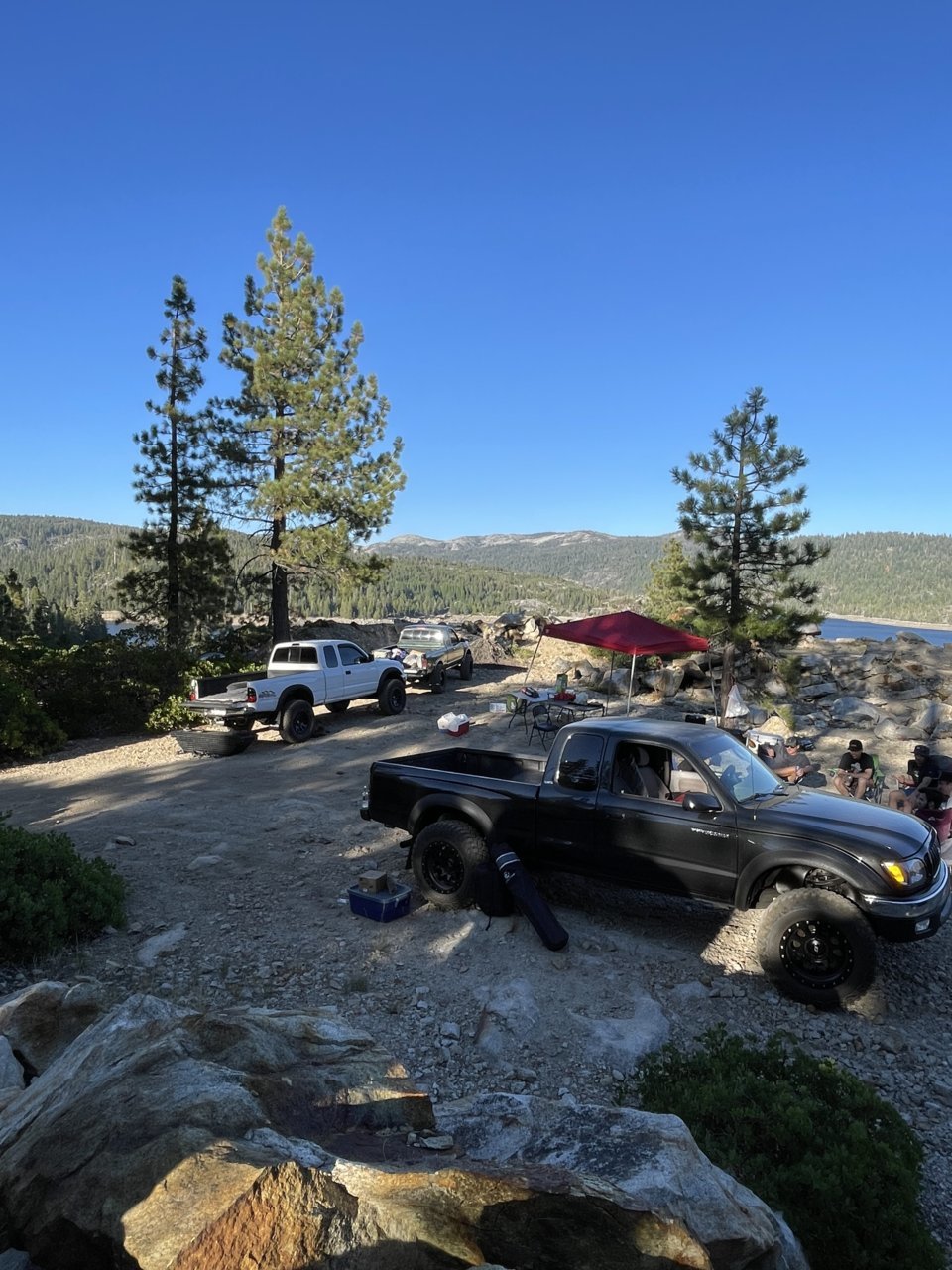

    Annual camping trip was a success. 1st gen city as you can see.

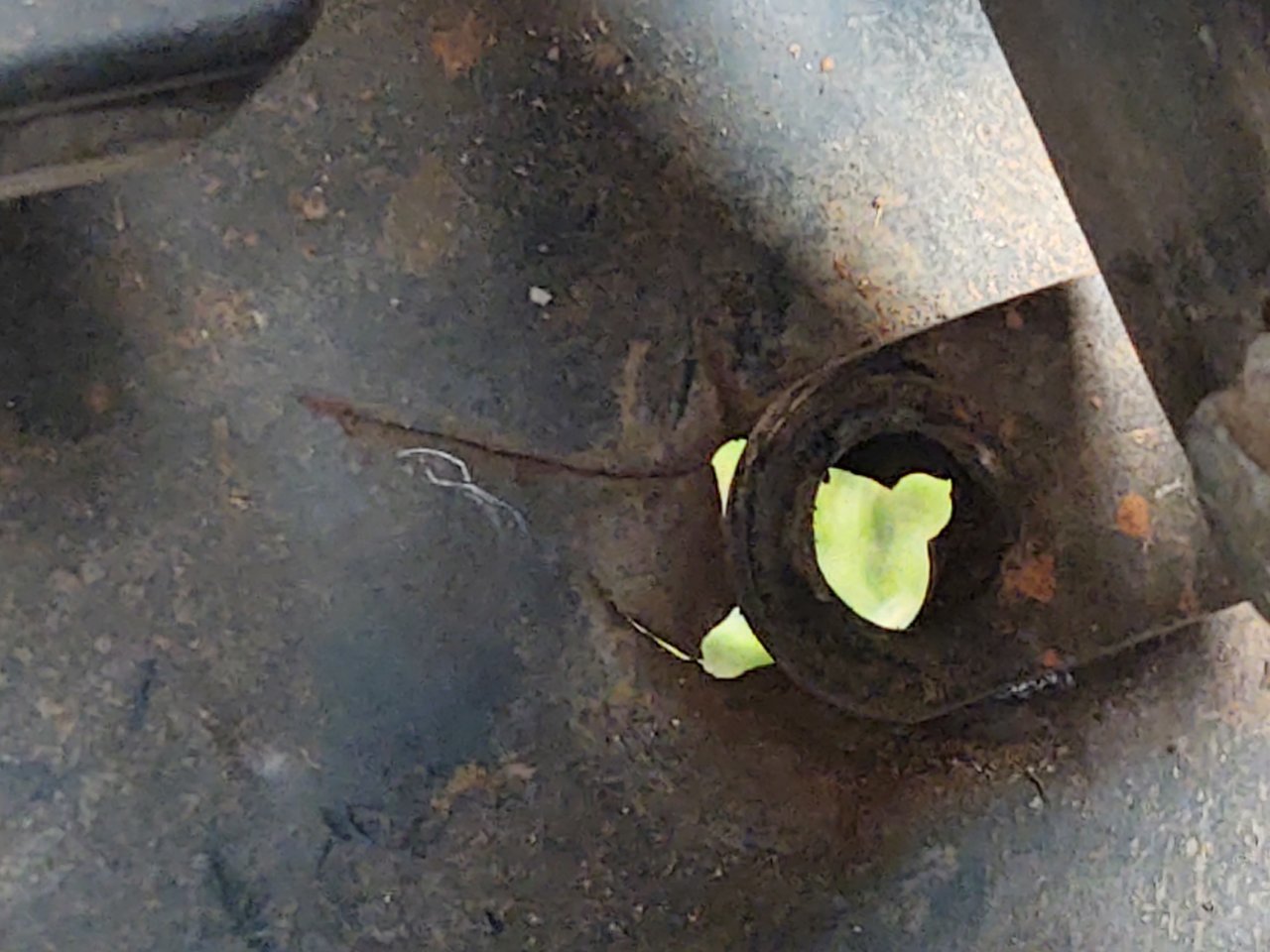

    Got a second set of eyes, ears, and hands to help me check this out. It ended up being the metal around one of the bolts on my "cold" air intake shield cracked and fragmented a bit. There is some slop in my passenger side motor mount, so whenever the engine would torque it would tug on the intake shield and cause that bolt to move around and pop that metal. Fairly easy fix, just added some homemade rubber washers and now I'm back to the normal level of rattling I am accustomed to.

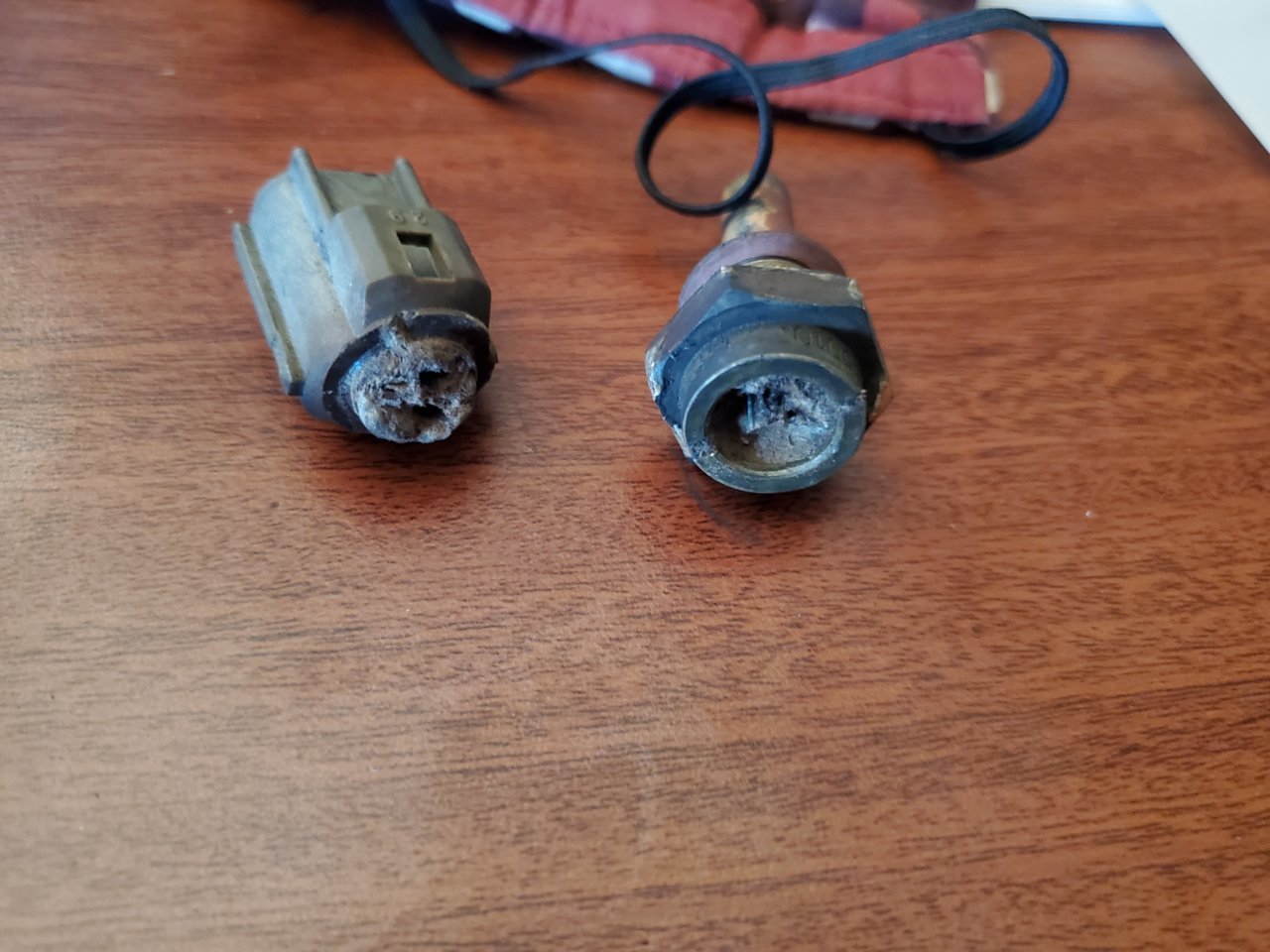

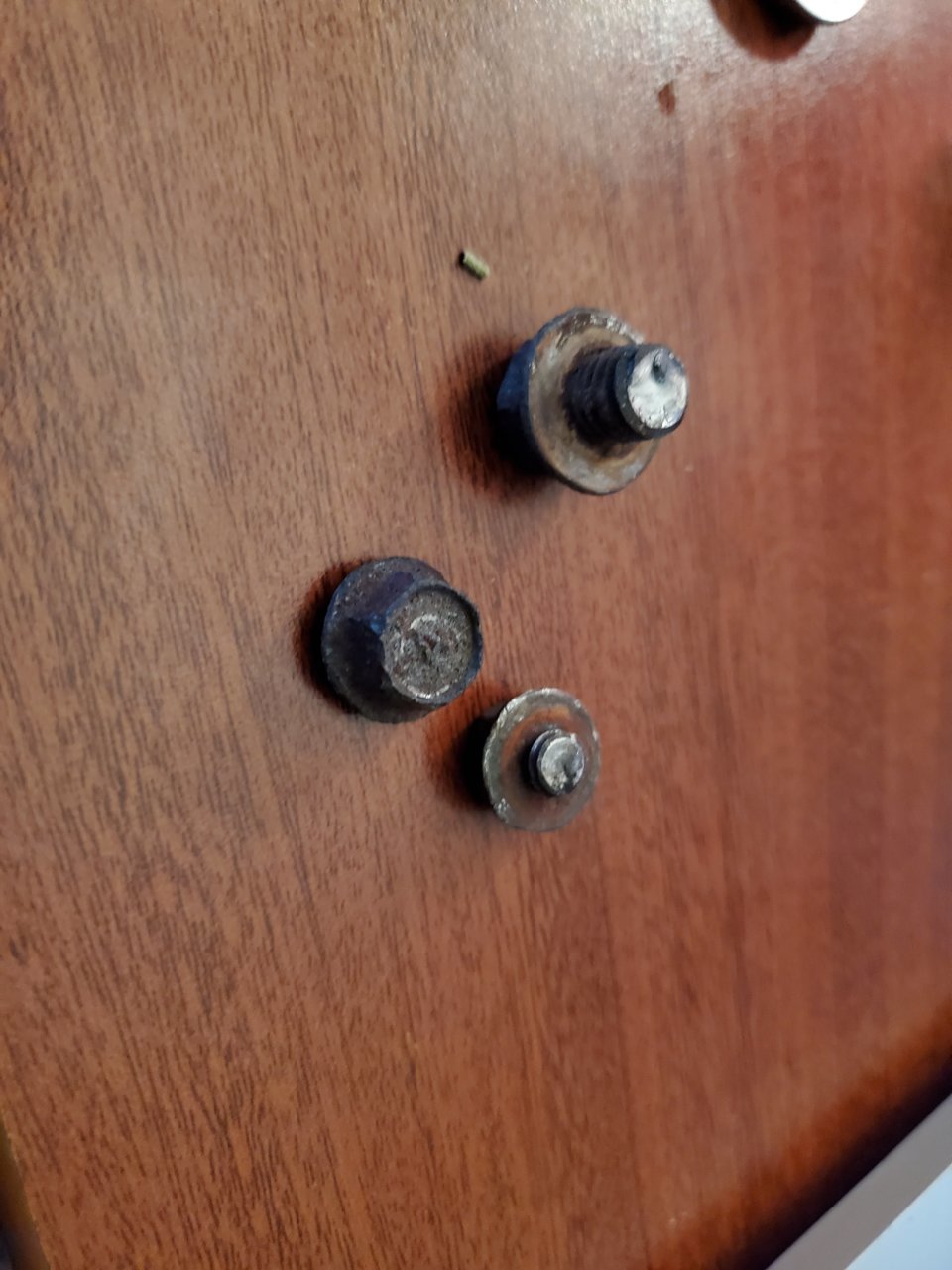

    While the AC compressor is out of the way, I decided to replace my exhaust manifold gasket. I shouldn't have rushed. I broke off some heat shield bolts and an EGR bolt. Luckily none of them are captured bolts, so they shouldn't be too tough to extract if I need to.
    I also replaced my Engine Coolant Temp sensor. Here's what the old one came off like.

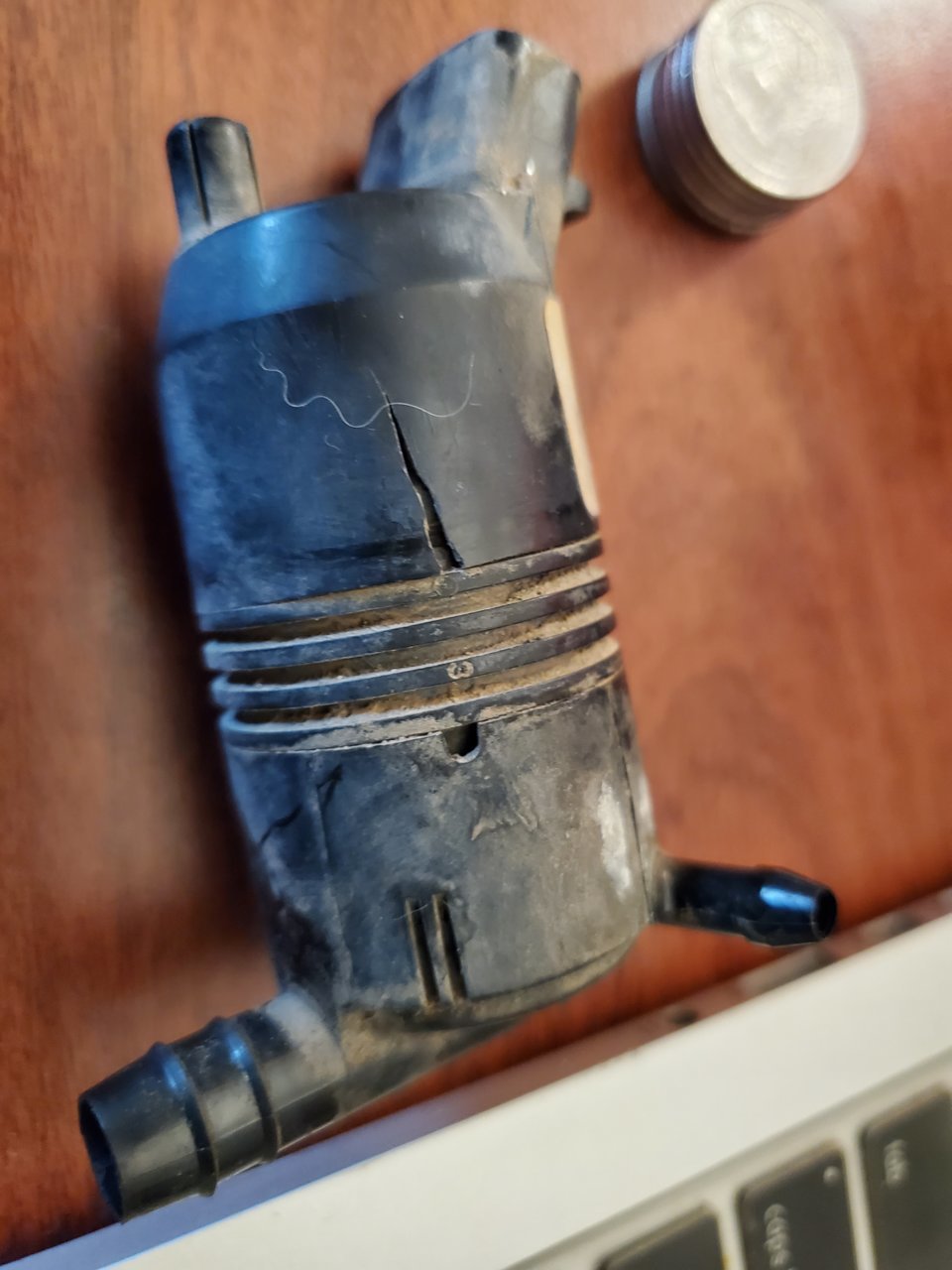

    Unfortunately, none of that fixed a thing, but I did get a peak at my exhaust valves and intake butterfly, and everything looked healthy, so at least there's that. :laugh:
