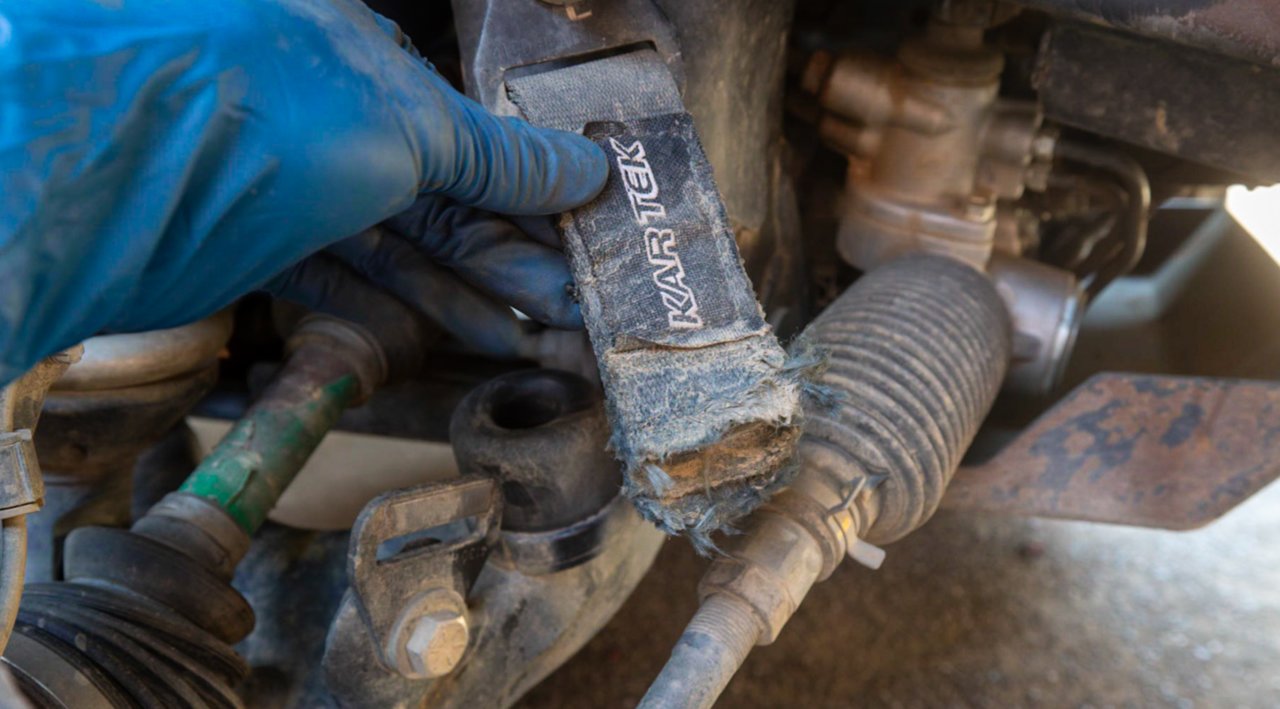

    Yup, looks like you did a good job on that one.
    I haven't had one tear completely across like that one, but I have had them start yo tear. Usually in the middle though, where they fold at full compression.

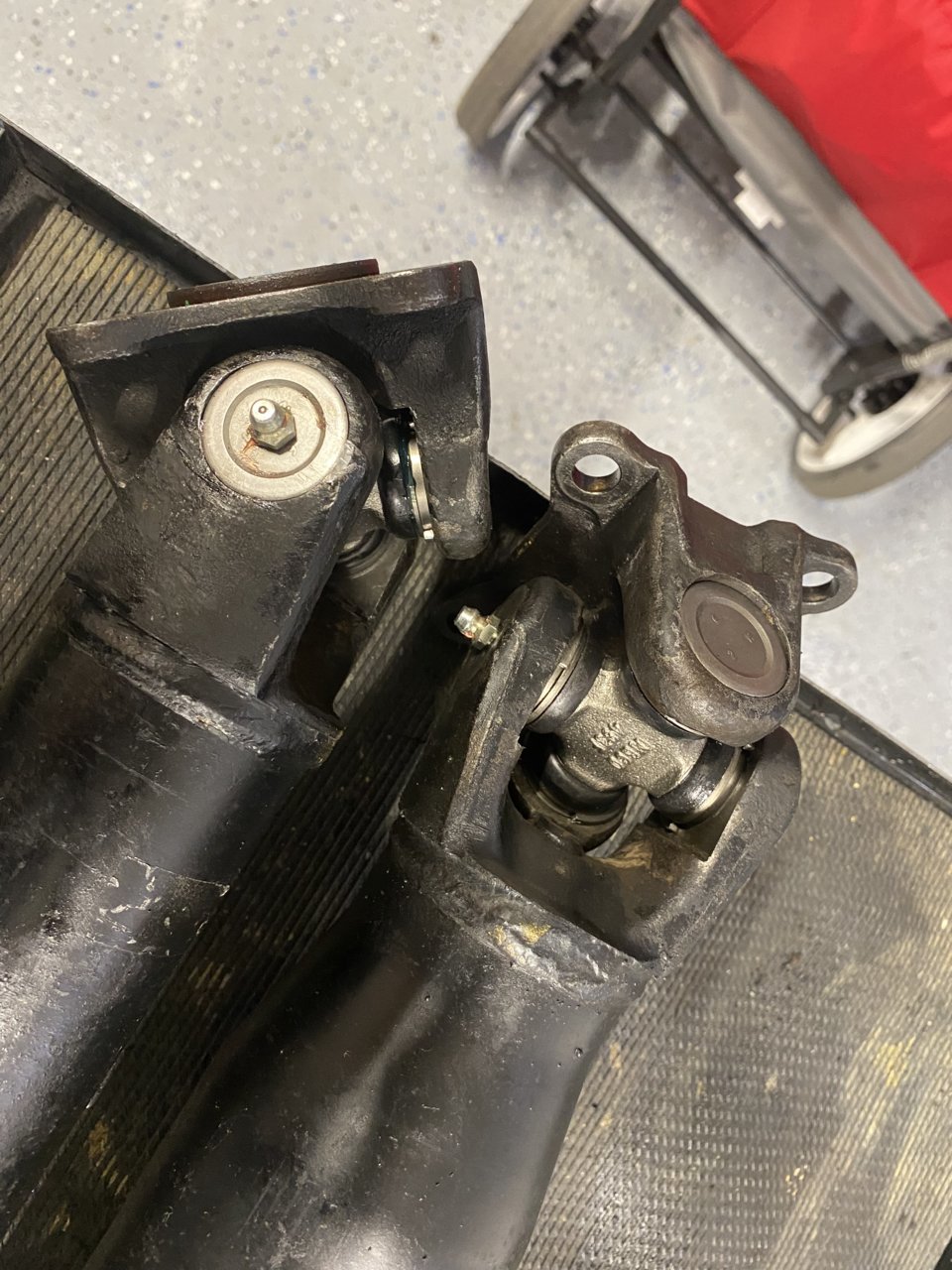

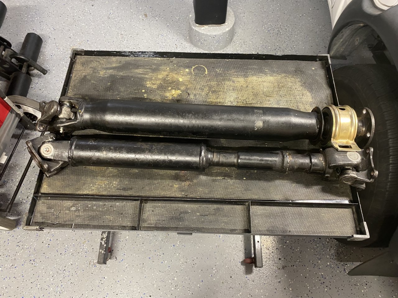

    U joints and carrier bearing. U joints were kind of a pain, as it was my first time doing them. I also suffer from, “I bet I don’t need that” syndrome, when I see a specialty tool. I guess I like shit the hard way.

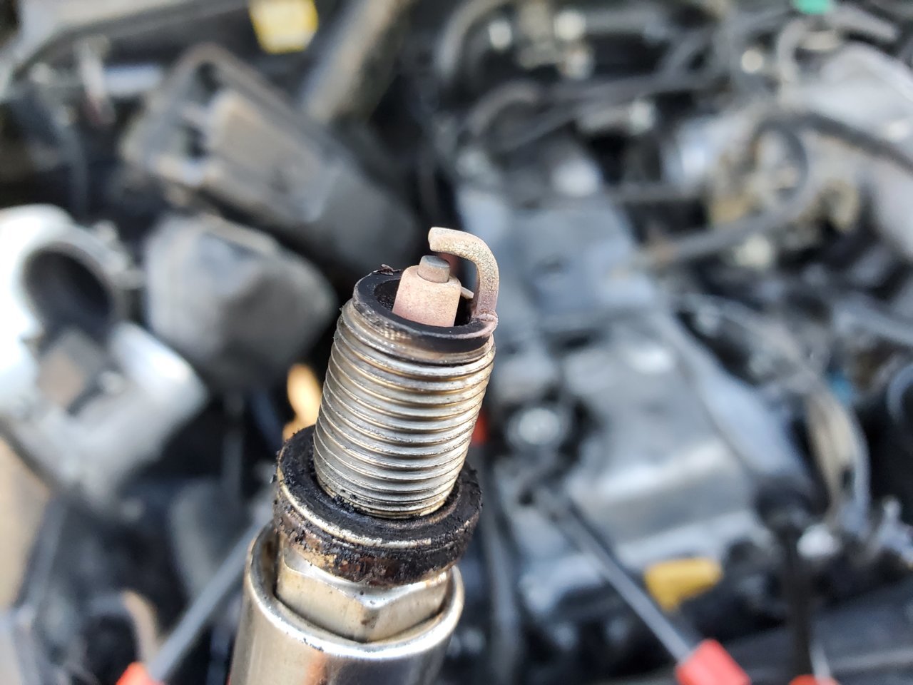

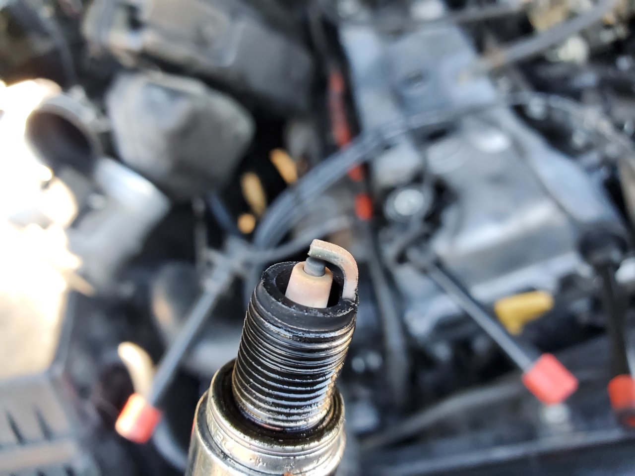

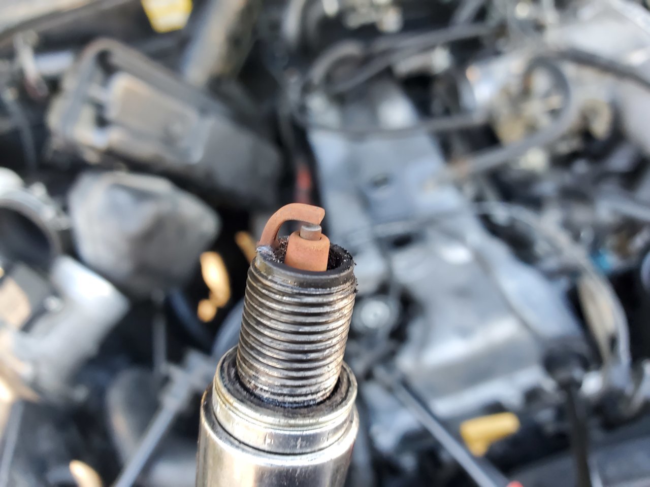

    Replacing the ECT fixed my cold start issues. Still chasing a hard start at temp. Pulled the plugs, they all look good. #3 was super loose. Forgot to gap them while they were out
    :facepalm:

    Clearly I need to clean all the plug holes up, and it seems I have a (hopefully) valve cover gasket failure on #1, but I'm not too concerned about that for now.
