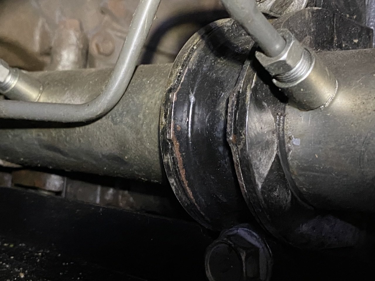

    LOL... I'm going on 4 years with my ES poly bushings. I just looked at them when I was eliminating my alignment cams and installing the LCA skids. They've seen work, no doubt, but don't look at all like they need replacement.

    I know a couple people that have been through multiple sets of the ES rack bushings. They don't last.
    My TC ones have held up great to a lot of hard wheeling and use. Have turned multiple people onto them and they've had no issues with them since switching.

    I wonder how/why some can have completely different results with the same product.
    Lot's of people have said they've had their ES bushings wear out quickly. Which I'm not questioning or doubting. I actually started looking around for other options because of the reports that ES bushings wear out quickly. But as stated before, I just don't see the wear everyone talks about with mine.
    I'll probably end up switching mine out this winter, (as more of a preventative measure) but I think I'm going to go with Whiteline. They recently started offering the rack bushings for ours. With as much better their LCA bushing are, over ES, I'm thinking the rack bushings should be pretty good.

    I’ve gone through 3 sets of ES bushings in like 40k miles. I’ve had the TC ones on there for a good 10-15k and they look like new still

    Right on... But again. I don't get the difference. I've got about 60K on the ES bushings on my rack, They're worn, but not really in need of replacement. I'm just wondering what would cause such a difference in results.

    Quality assurance? Got lucky? You might be the only person I know that has had a positive result from them.

    I wouldn't really call it a positive result lol. It just is what it is.
    I'm just baffled though. Those bushings don't even really do anything. They're more isolators than "bushings."
    I'm not understanding what would even cause them to fail so quickly.
    As far as a difference between ES, TC and even Whiteline... I would have been willing to bet Poly is Poly and it's all the same repackaged shit from the same manufacturer. (obviously that must not be the case if ES bushing really can be that much worse than TC for example)
    I do know, I put a metric shit ton of Poly grease on Poly Bushings. I keep entire tubs of that shit on hand. I'd say I put at least 5 times more grease on Poly Bushings than what is provided with them. I wonder if that might have something to do with it.

    I just, actually, looked back... I have almost 5 years and over 100,000 miles on my ES rack bushings.

    Low miles compared but I put a set of ES rack bushings on in January, 20k later and still no issues.

    Poly is definitely not poly, many different density poly out there. TC seems to be a bit more firm.
    and I think in all there cases mine failed due to the bushing tearing. So not really completely worn out. But that could be because they are softer.

    nagorb Should be a dang perma mod
    Feb 28, 2011
    #52025
    9,352
    Alabama
    2001 dbl cab 4x4
    No picture?

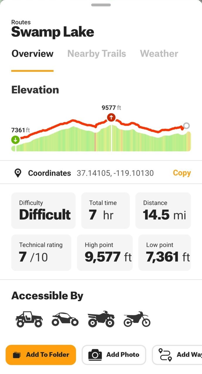

    Finished up the last video from our Swamp Lake trip, last night, if anyone is interested.
    Pretty epic trail. It's called (considered) "The Mini Rubicon" by many. It definately has it's challenges, and definately was worth the trip. We'll be doing this trail MANY more times, I'm sure.

    yeah I feel the same with ES bushings, seen then get woahed out easy

    My guess is the difference in driving styles. Most people seem to get more than a year out of OEM lbjs. I get less than one. Most aren't having issues with cracks in core supports, coilbuckets, spring perches, crossmembers, ect. Or maybe my shitbox just knows it's a shitbox so it does it for attention.

    It might, but he seems to drive his truck pretty hard.
