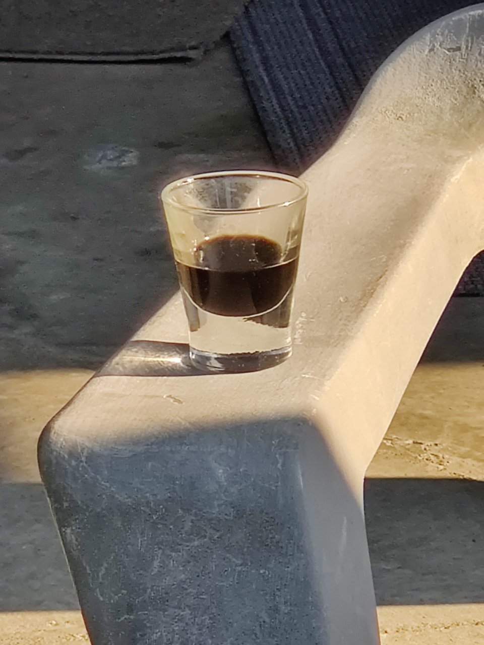

    I have one but got tired of it freezing during winter so it remains vented to atmosphere. Mine collects as much water as it does oil apparently.

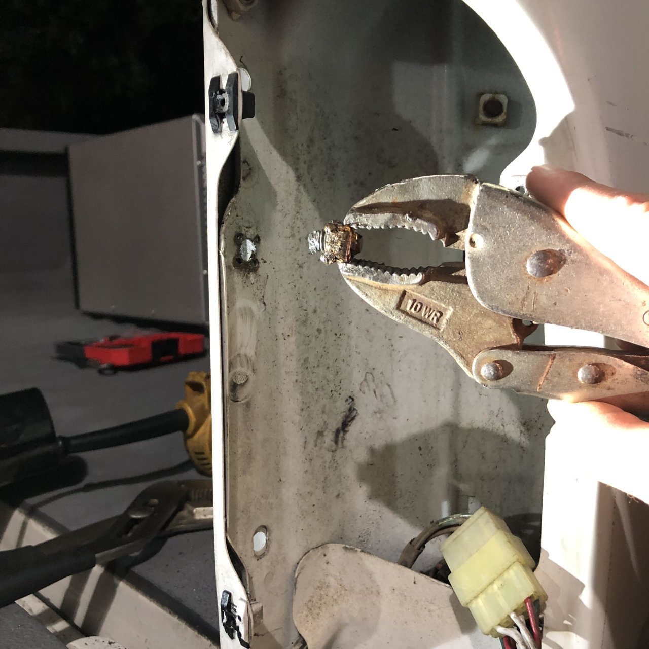

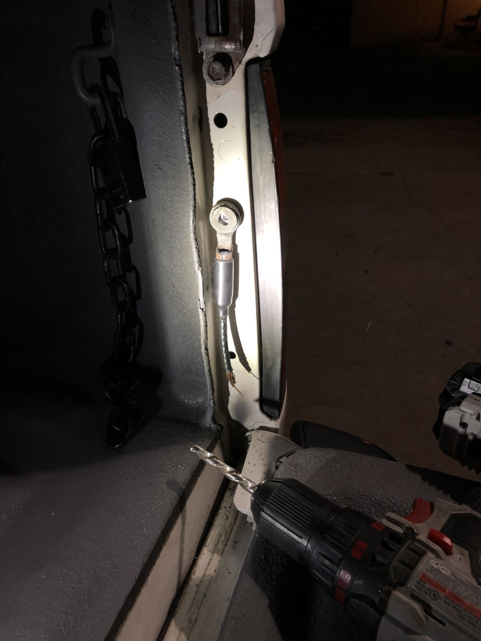

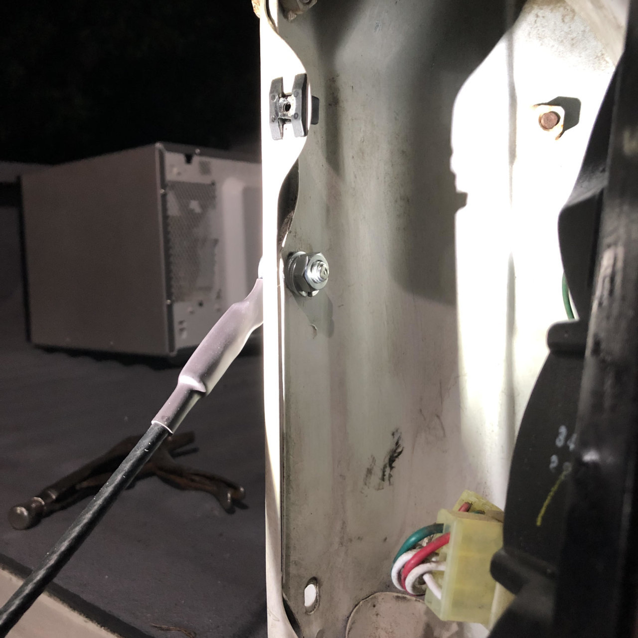

    The Tailgate cable busted, bought a new one, old bolt wouldn't come out, I broke one Philips bit using my impact.
    next tried to use a left hand drill bit hoping to "lefty loosey" this bolt loose, no go.
    then tried to drill it out, that was a no go as well
    used my angle grinder to get the head off, vice grips on the bolt shaft were a no go as well.
    next, removed tail light to get to back of bolt,
    used said vice grips to grab tacked on nut, wiggled a bit and it broke off.
    so, finally able to install the new cable with new bolt, washer, lock washer & nut... unfortunitly the new cable is a bit too long but o'well job done best I could. :thumbsup:

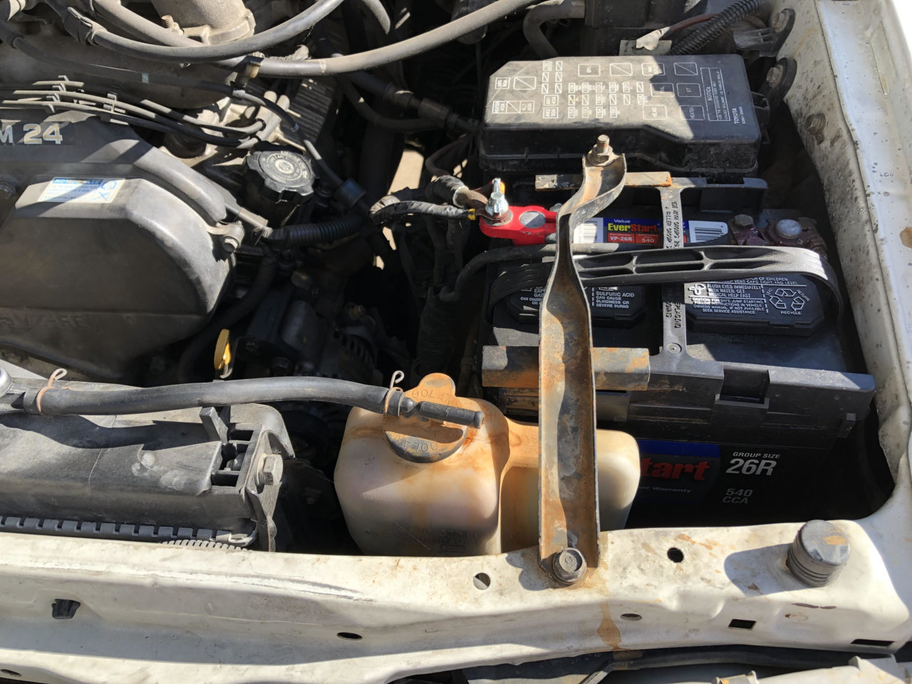

    1-1/2 weeks owning this truck, and still learning it and going thru it with "fine tooth comb"
    Been looking at this and never liked it.
    gets worse

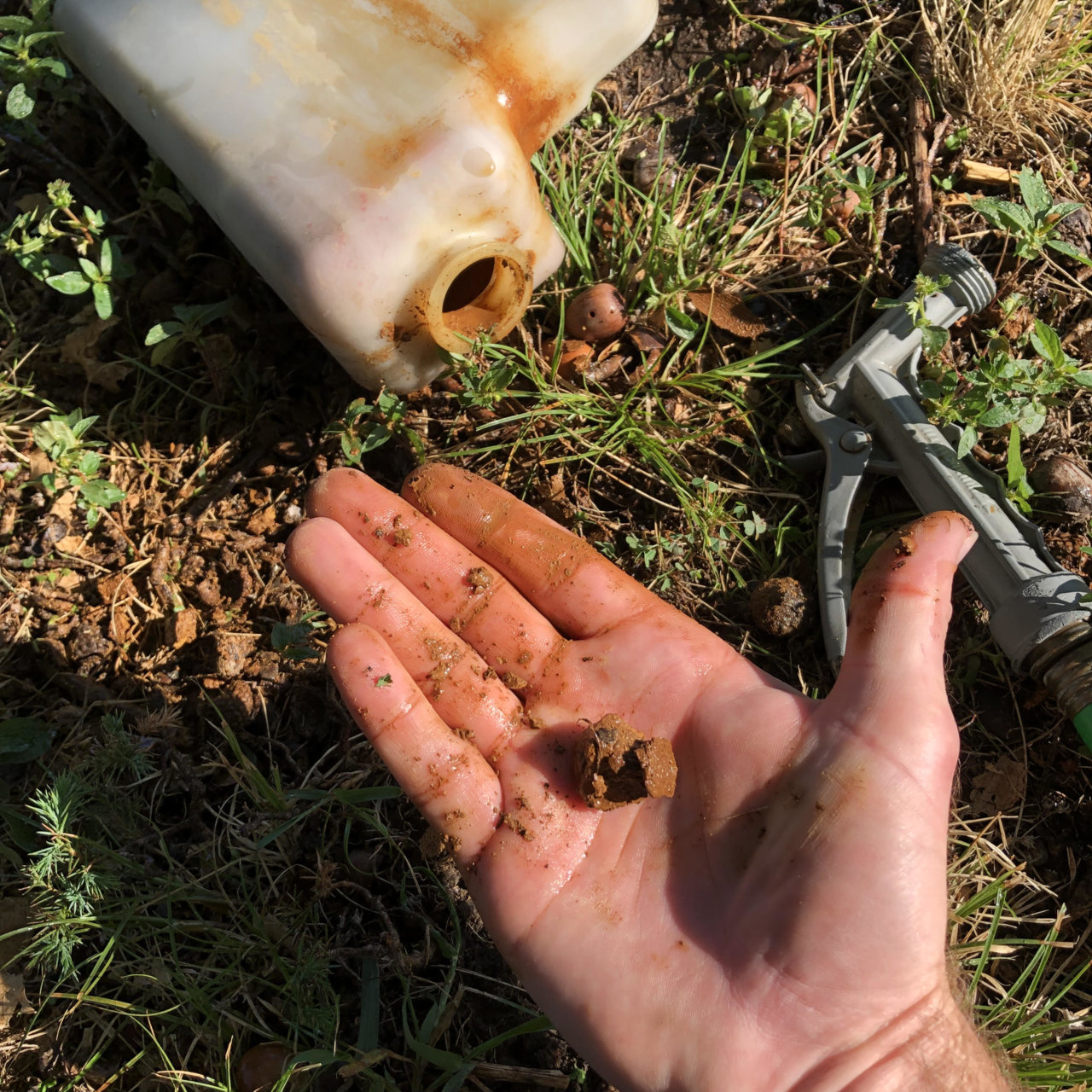

    took off to clean, what the crap is this?????
    did my best cleaning it out and scrubbing what I could get to.
    next plan, new radiator reservoir and a radiator flush.
    PO did tell me he overheated the motor cuz the rad blew. new motor 80k back.
    perhaps this is the remnants of a blew rad and over heated motor?
    you would think, if new rad and motor the tech would clean this out or replaced.

    In the summer it doesn’t collect nearly as much because there is much less condensation building up under the valve covers and elsewhere. In the winter I have to empty it regularly and it has a nasty fuel/oil/water mixture, looks like a mocha and smells even worse.
    I’ve added a second catch can to interrupt the vent line from the driver’s side valve cover to the intake, it doesn’t get nearly as much because the crankcase vapor is pushed out of the PCV.

    Possibly PO mixed coolant types which can do that. Your heater core might be plugged too.
    SwampYota likes this.
  18. Sep 12, 2022 at 7:28 PM
    eon_blue
    Mar 4, 2016
    #180213
    70,112
    Azusa, CA
    Wonder if someone mixed Dexcool in with it, heard that it can form gel and solid chunks and prevent the system from cooling. Could explain how the PO overheated it
