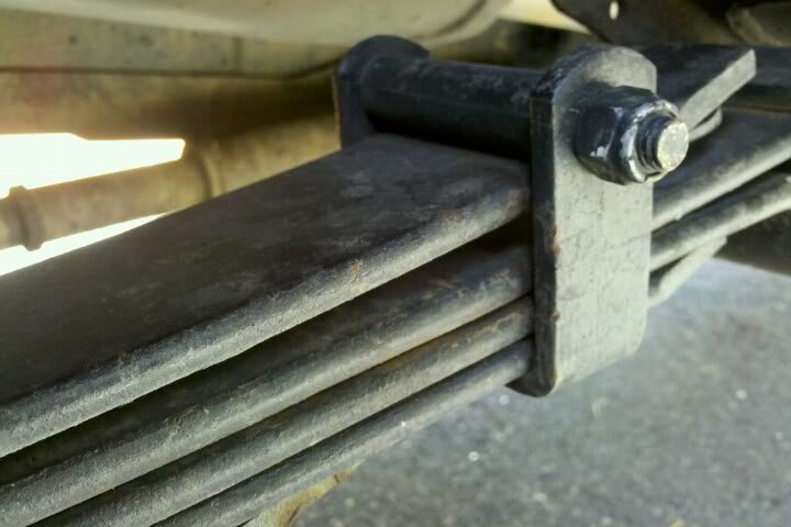

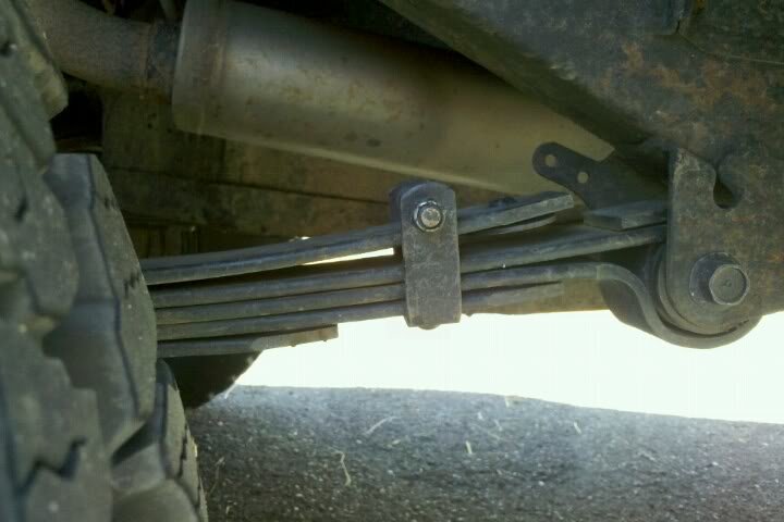

    Clicking leafs?

    Yeah the top leaf on my Expos were over arched and rested on the bolt for the spring clip. Every time I hit a bump they would flex down and make a clanking sound as they hit the metal bolt. It got old really fast so I called AllPro and they replaced the packs with new ones they don't clank every time I hit a bump.
