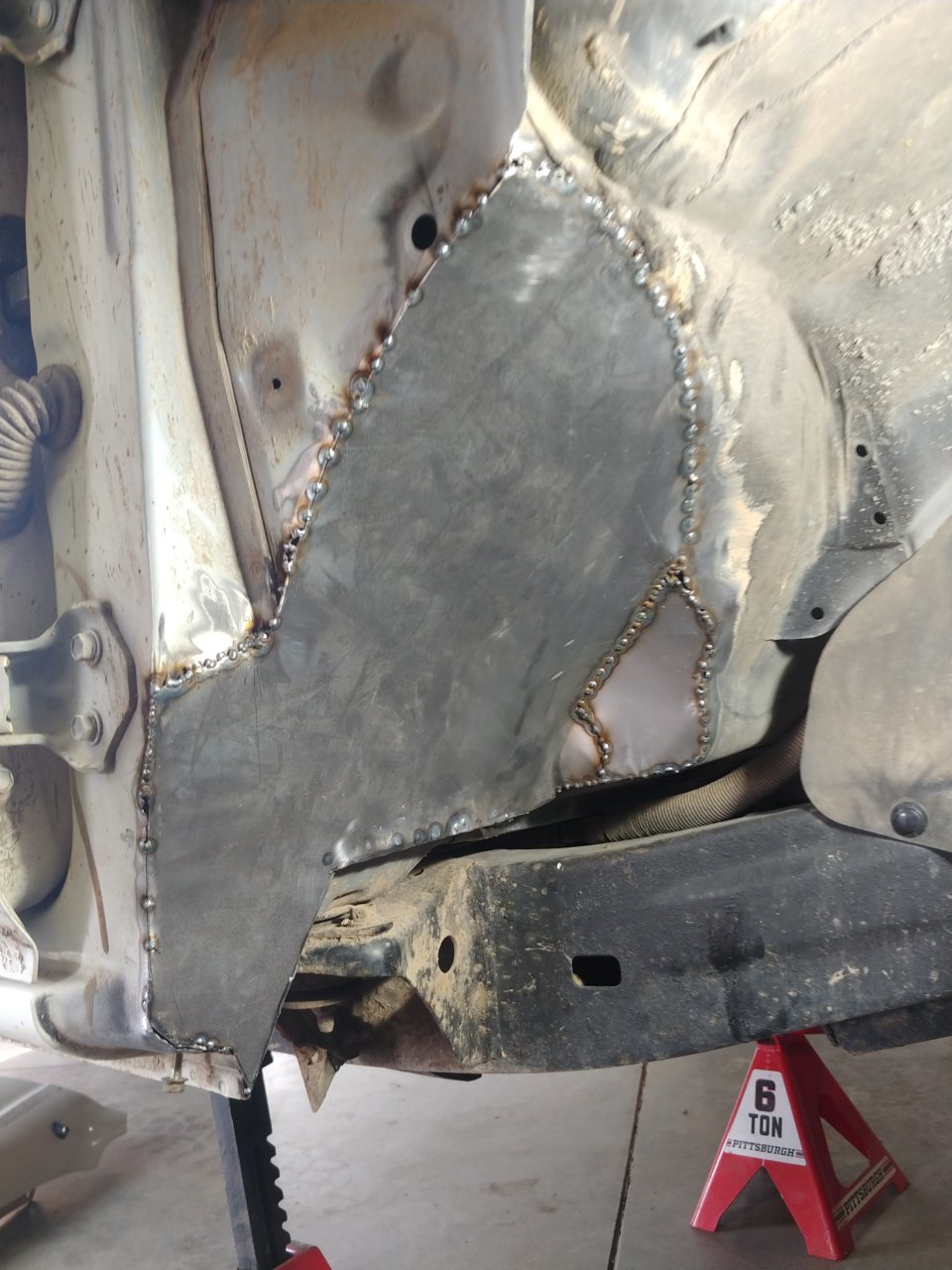

    good god, could fit a six pack through that hole. Is this a tire clearance mod or front entry beer window? :D:D

    It's less Tacoma and more mod
    I think if it didn't get patched back up it would be a mud entry window haha.

    100%
    My back felt broken for a week.

    I'd highly suggest more cutting. It may be fine, but this is what was needed to clear my 315s... it would SUCK to go through all that and end up still rubbing.

    Okay, one side fitted and partially tacked.

    You end up having to chop the frame off and rebuild it with an arch unless you like sitting stupid high and having no uptravel anyway with a SAS. It's a lot more work than people give it credit for to do properly at least

    1,000,000,000% correct sir :thumbsup:

    Looks good. Bringing back memories... or triggering PTSD, depending on how ya look at it.

    Not my favorite project so far, it's a good intro to body work though. Other than these pictures no one has to look at it. :rofl:

    That was what I kept telling my kid.
    We're just gunna cover this shit up with seem seal and undercoat, so who cares.

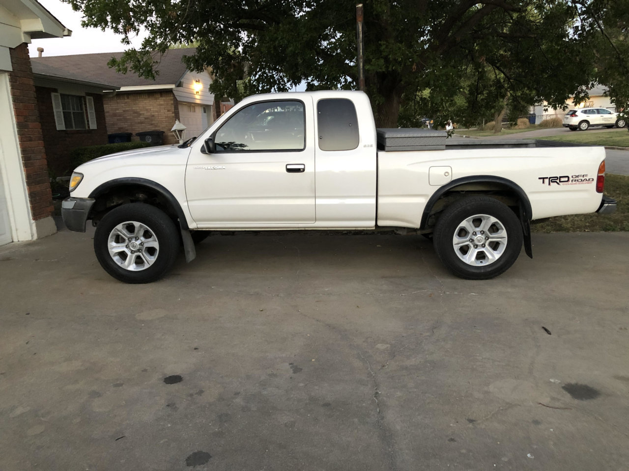

    previous, aftermarket rims, 30x9.5x15
    now with 17" second gen rims, 245/70 17
    weight difference is about 18# each.
    plan to change to 235/80 17 next
    less then 100# total, I'm cool with that. :thumbsup::cheers:
