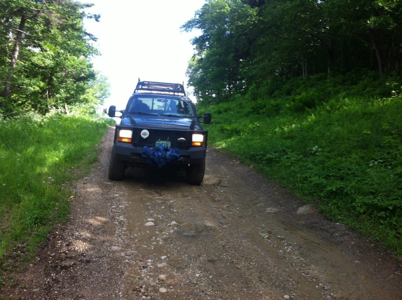

    I don't have experience with all the crazy wheeling trips I've seen from you, but I've definitely done my share of deep snow and mud. My dad and I are both pretty serious woodworkers (I did it professionally for about 8 years), and the best lumber usually comes directly from a logging operation (they literally throw away a lot of the prettiest stuff because it doesn't make good boards). Logging roads get pretty hairy in VT, especially loaded up with a couple tons of burly maple. I also transported telecom batteries up to cell towers for a buddy who owned a telecom business when I lived at home. I don't have any trail ratings to tell you. If those roads were even rated, I never paid attention. Never did any of that with a Taco, it was always a big Powerstroke diesel, so my experience may be completely irrelevant, but...
    Lower tire pressure beats big fat tires from what I've seen, and wider wheels lose beads easier than narrower wheels. Tacos are light enough that you shouldn't have to go super wide, so if you're sacrificing the tire pressure aspect, I'd say it's more trouble than it's worth. Plus, you're getting a bigger (and more useful) contact patch by going with a taller tire already.
    And finally, the whole idea of flotation is a lot more relevant to straight axle applications. IFS doesn't get bogged down in deep snow or mud for the same reasons as a straight axle.
    Sorry for all the editing on this post. I think it's important to articulate my point well, since I'm probably outnumbered here. Here's a pic of one of our trucks ('99 F250 Powerstroke) driving down from a cell tower at the top of Killington Ski Resort as an apology.
