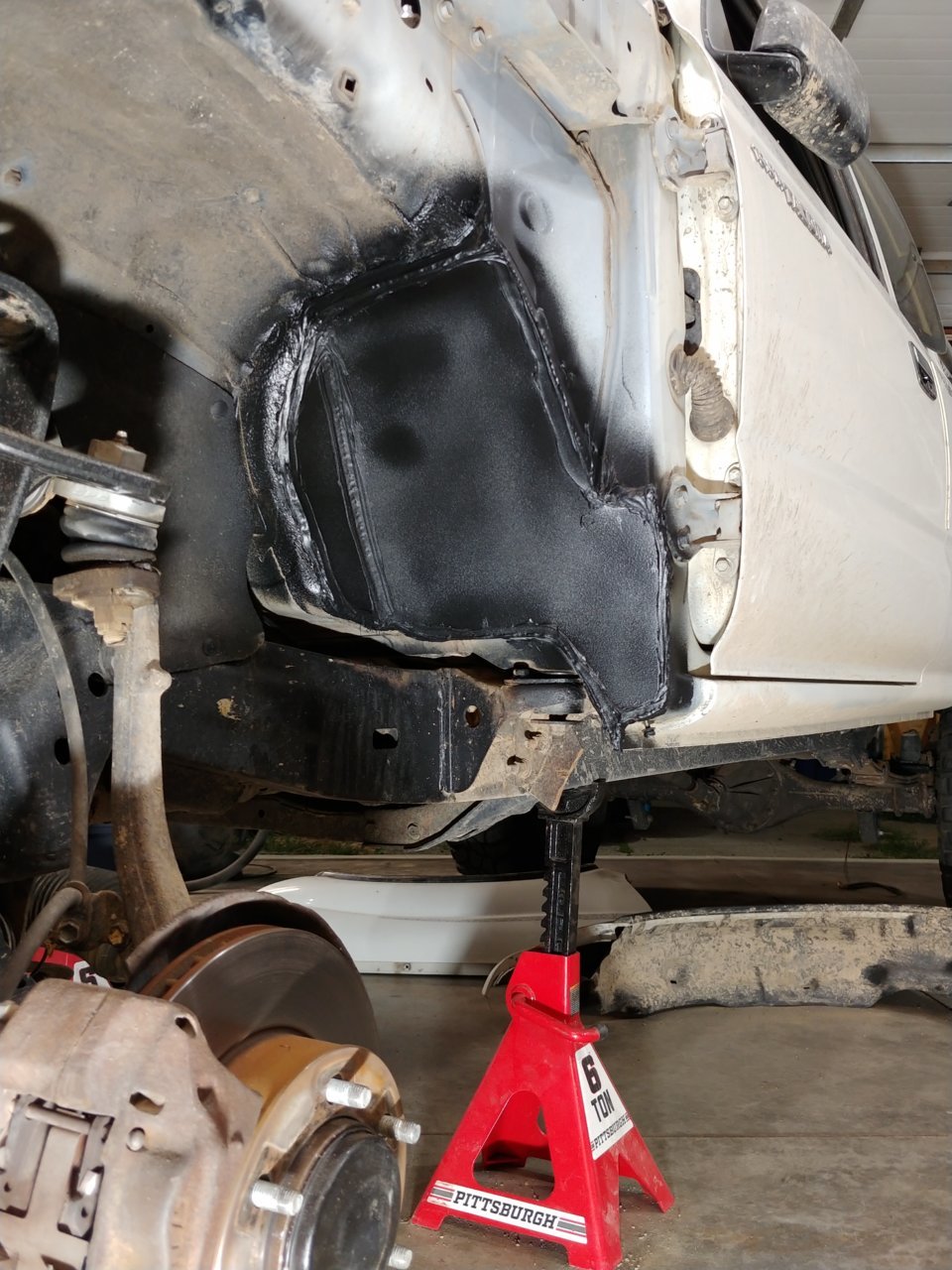

    It's less Tacoma and more mod

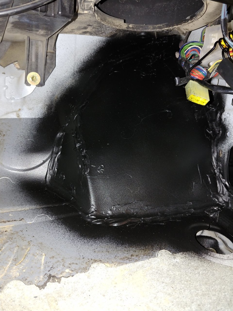

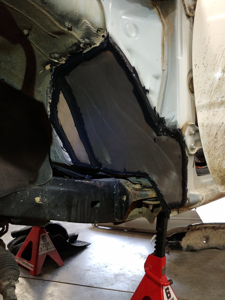

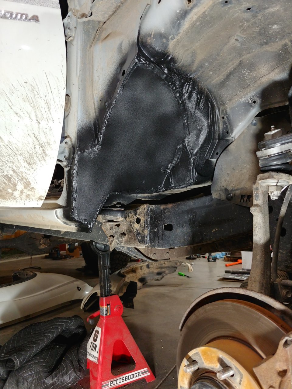

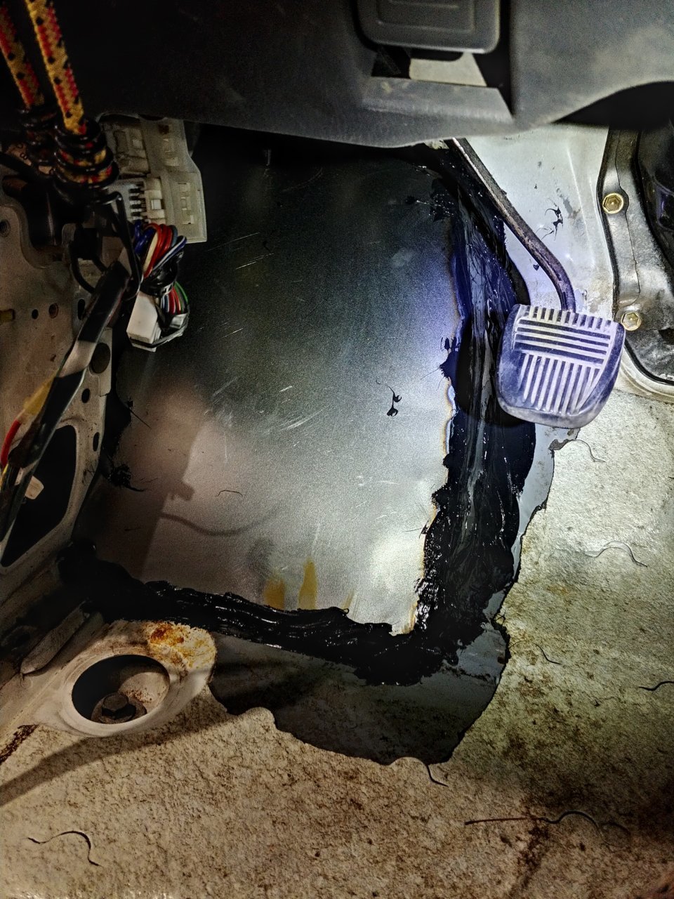

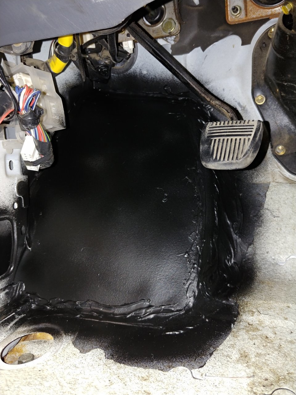

    Got the panels sealed and painted up
    TheBraves, T.Barn, vtroot and 15 others like this.
  4. Sep 20, 2022 at 8:57 PM
    GHOST SHIP
    GHOST SHIP hates you.
    Mar 9, 2015
    #150537
    22,394
    GHOST
    That’s the cleanest example of a proper wheel well tub I’ve seen on this site. Fantastic work man!
    :fistbump:

    Big thanks! I've really never done sheet metal work before so it was a lot of whatever felt right and whatever curves and bends my knee and vise could make. I'm happy with how it turned out :)

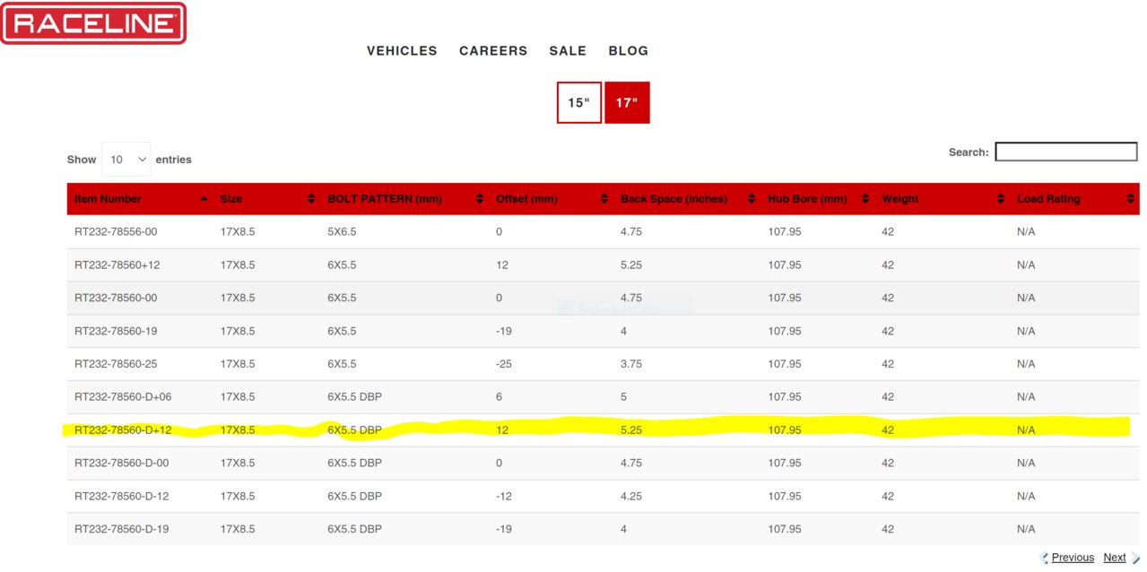

    Yeah going to echo Zane's concerns that you won't clear the spindle or upper ball joint. Worth a shot. But I highly doubt it will clear with 35" tires. Maybe if the wheel clears and you're running 10.5" wide tires. But I wouldn't count on it. Buy one wheel to test fit first I guess haha

    For me, sealing it was the best feeling.. Project completed haha. I used the flex seal paste. Got about 1/4” on the panels too. Been great so far too.

    It feels complete now, I still have to cut the wings of my bumper and bash the front of the fender by the battery and airbox, but that wont take long. I wasn't sure what to use for sealing the panels but the local body place had tube of SEM Seam Sealer and it was super easy to lay down, push into cracks, and you can paint it before it is dry.

    Ya, I'm a long way away from getting to the point where I'm looking to change wheels. At that point, it wont be 35s though, it'll be 37s.
    The plan is to start piecing together the LT, and get the rear set up started. I'll probably run the LT without the spindles at first (with Tundra axles). Doing the entire front all at once is A LOT of money. I'll need to do it in steps.
    I'll run 35s with the wheels I already have until the set up is completely done, then I'll go to 37s. Most likely 37x12.5 Patagonias (I'm really liking them)
    As far as fitment of the wheels go. I'm pretty sure, by the time I get to that, I will have had an opportunity to check and see how they fit. Bobby/Solo Motorsports are pretty heavily involved in the Off Road community. I'm sure they either already have experience with that kind of backspacing or have access to a way to find out for me, given enough of a timeline.

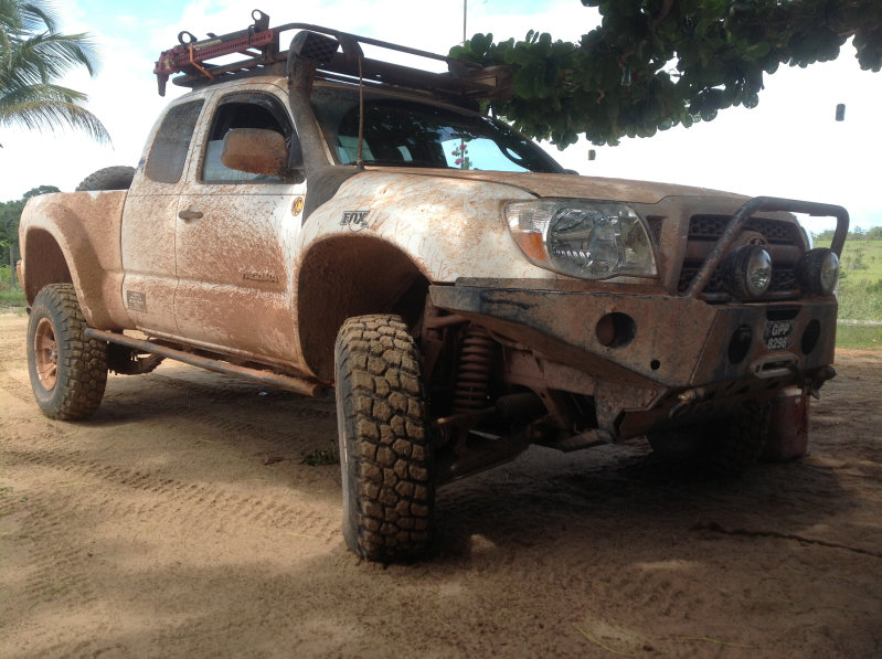

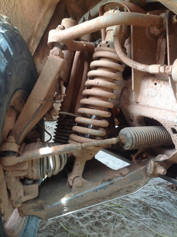

    As a part time submarine owner myself, I have to ask, that's a "normal" "puddle" for you?

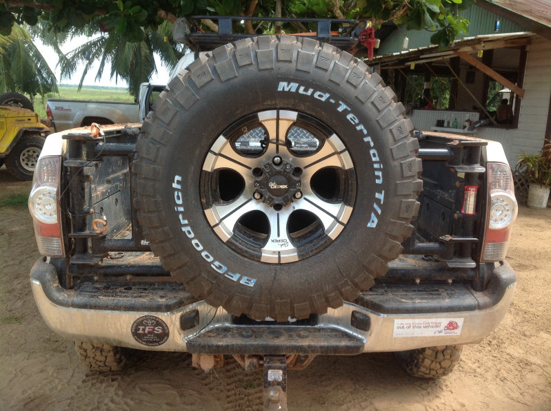

    What does this part mean?
  19. Sep 21, 2022 at 6:42 PM
    turbodb
    turbodb AdventureTaco
    Feb 9, 2016
    #177696
    8,535
    Dan
    PNW
    2000 Tacoma Xcab 4x4 SR5 V6 TRD
    AdventureTaco
    Nah, even for Monte, this puddle wasn't "normal." The busted LBJ an hour later though... yep, totally normal.
    Thank goodness Mark was there to make us lunch. That was a lifesaver. @IDtrucks
    Which part do you not understand?
    Sorry, couldn't resist the "Matt reply." ;)
    It means, that was the last day Monte drove that truck (Frank). It was Day 7 of The De-Tour (Sep 2017). From that point on, Igor has been slowly destroyed.
