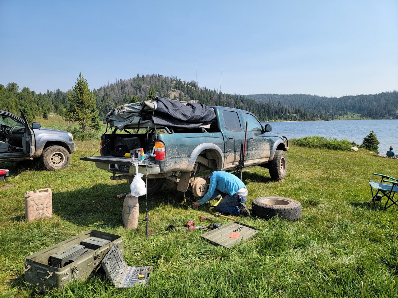

    Was that in the Bighorns? Looks familiar

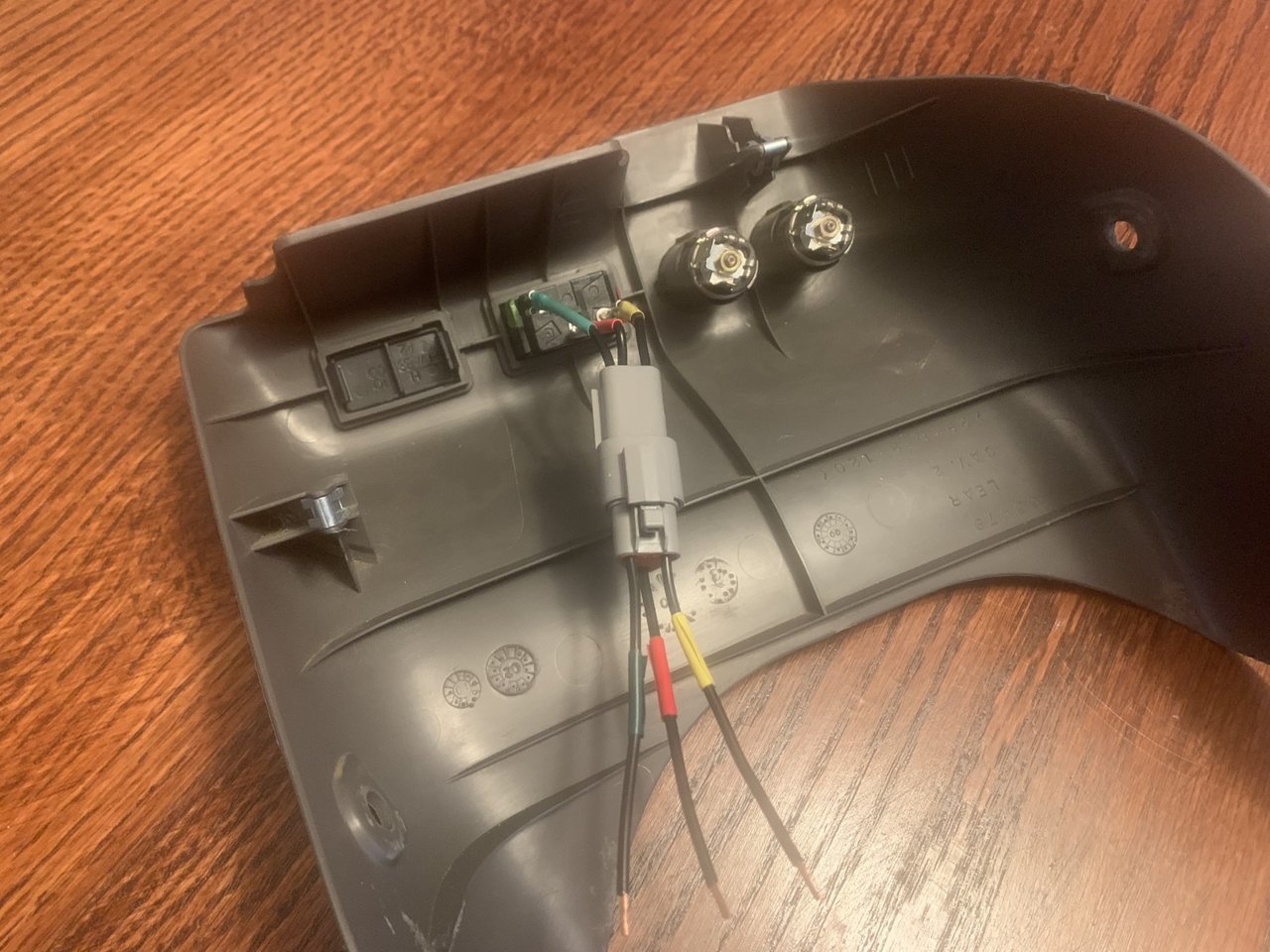

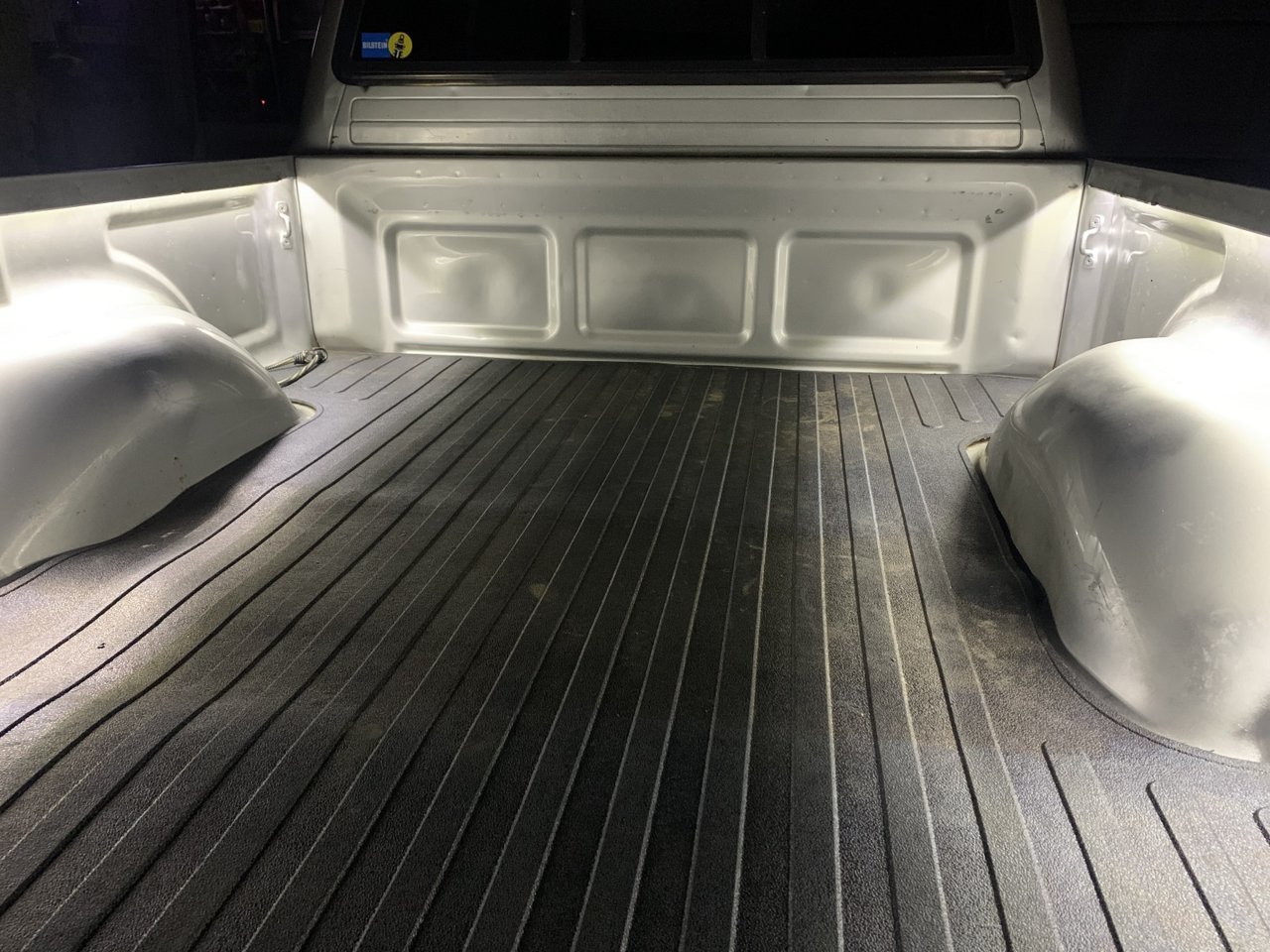

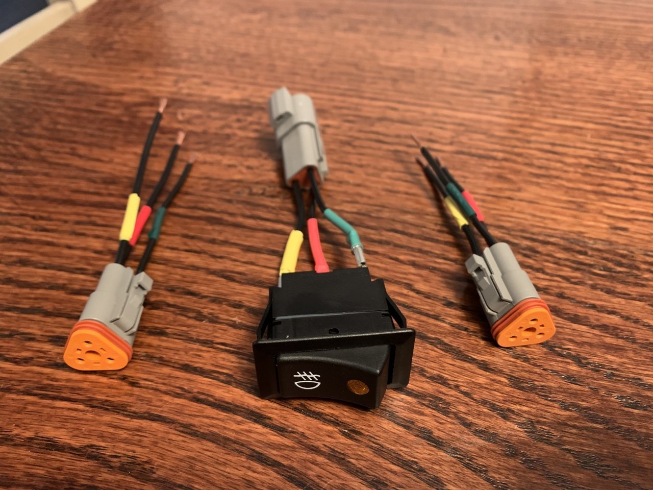

    Today I wired up some LED bed lighting and connected it to the 00550-35976 fog light switch with some Deutsch DT connectors. I wanted an OE style connector that would allow me to remove the center console plastic without having to disconnect wires from the switch. Originally tried using some Weather-pack style connectors but my pins kept coming loose. Was impressed with how well the Deutsch connectors worked.

    Looks great, what type of lights did you use?

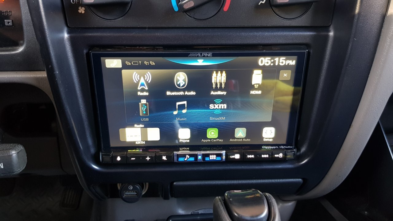

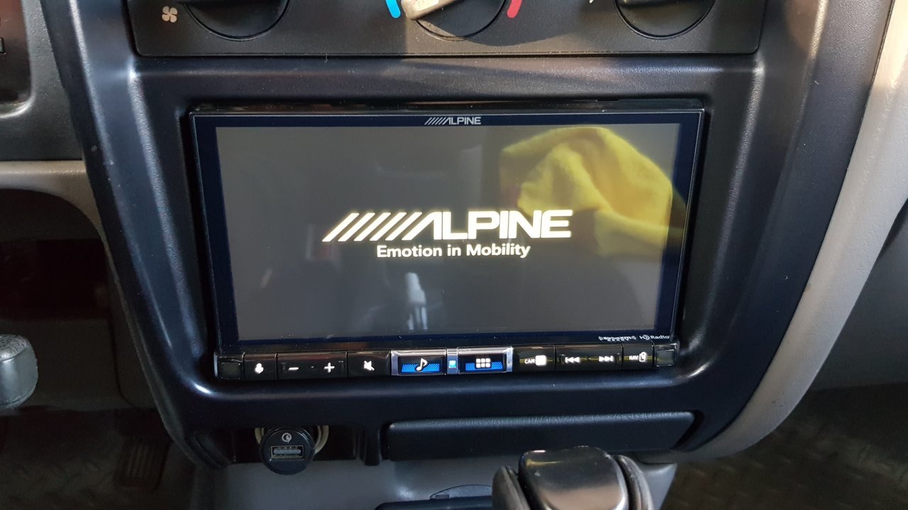

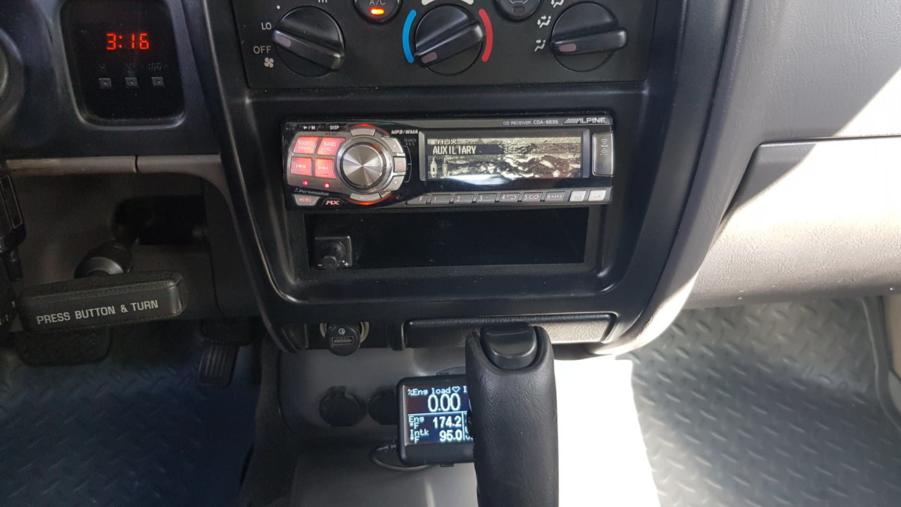

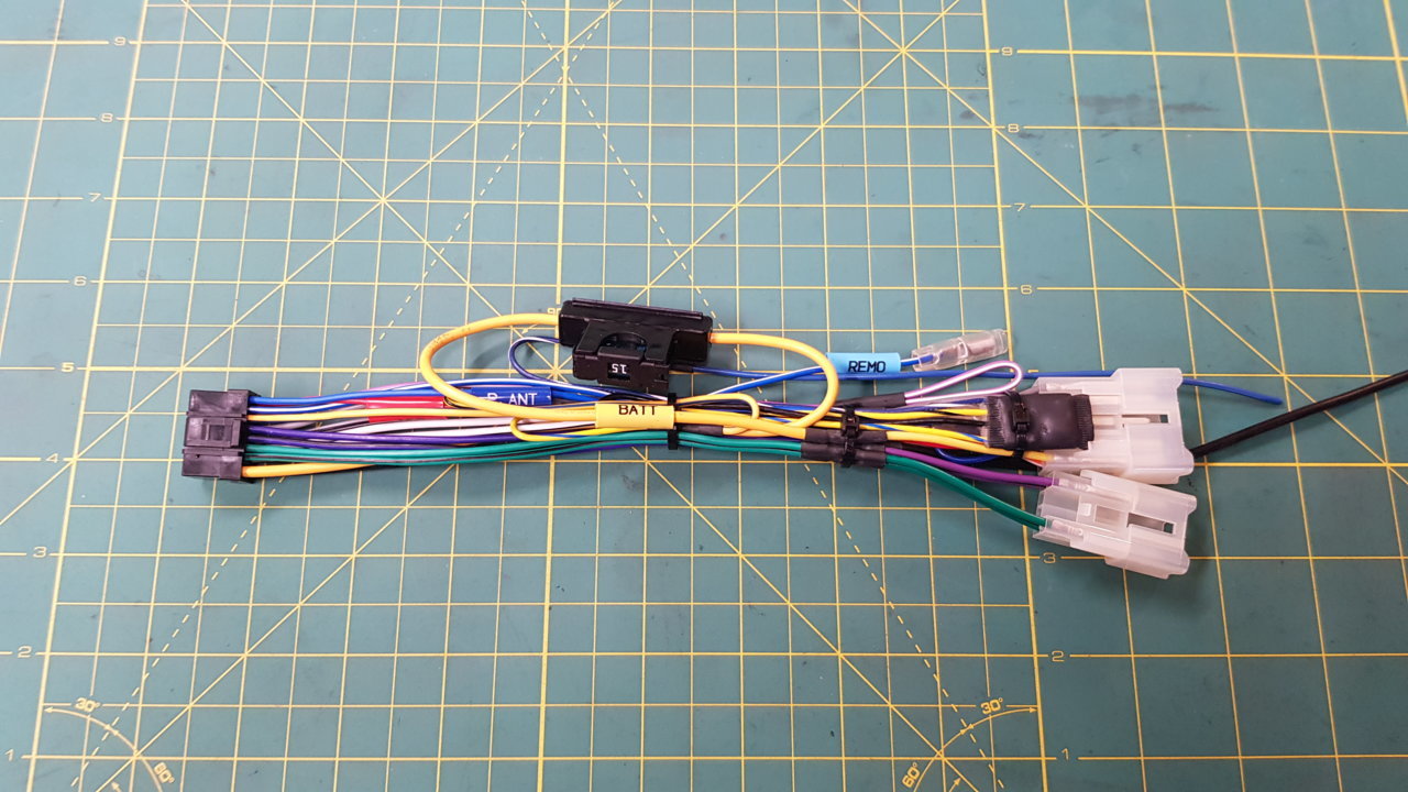

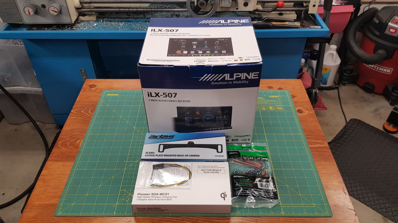

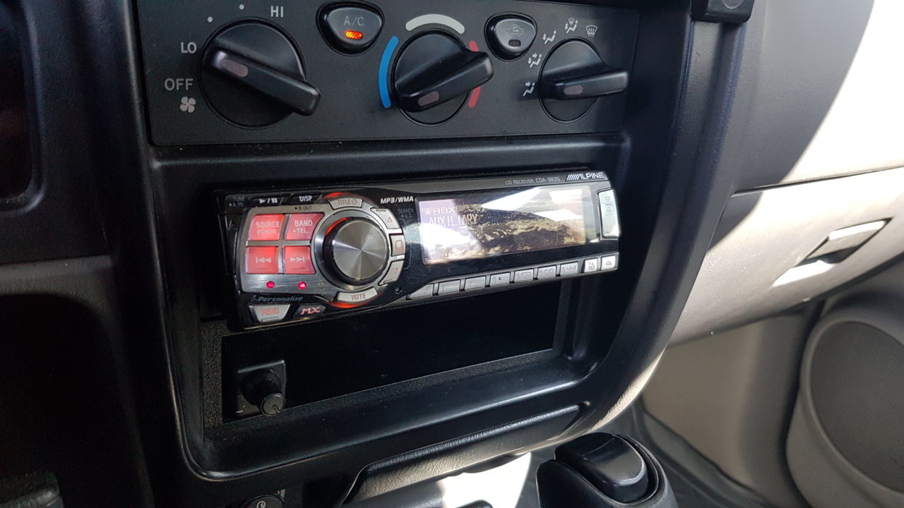

    Installed a new HU, well yesterday. My old Alpine is 17 yrs old, so old didn't even have aux input or bluetooth. I did add bluetooth to it but had to control everything from my phone. Due to the low radio position on the 1st gen, I never wanted to upgrade cause I liked the tilting face & didn't want to go with a double din. I also prefer volume knobs instead of push button volume which I actually really hate.
    Well it was time to upgrade, got a me a double din. I'm really gonna miss the tilting face & volume knob. Got me the new ILX-507 that just came out recently. Yup, just as I feared, gonna take some time to get used to the low radio position w/ no tilting face. But at least there's a remote volume knob available for this model that I'll get as soon as I can (OOS right now). With all the new features available now it's well worth the upgrade from what I had. I love this thing already, my wallet didn't though.
    Old
    New
    Also installed a bypass module for the stupid parking brake settings lock (little black module on the right). I'll install a backup camera some other time. I'm not used to using one and never do when I drive newer cars that have em. I did get a free backup camera & wireless phone charging pad from the vendor I bought from. But it's a license plate mount camera & I don't want to use one of those.

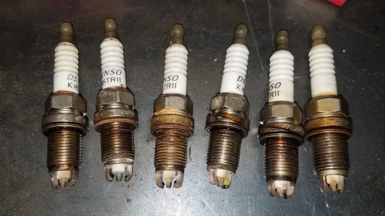

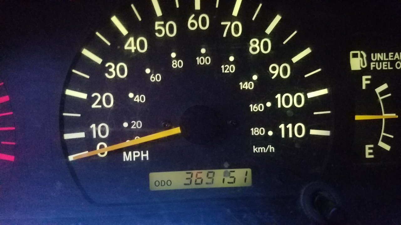

    2000 Tacoma with 369,151 miles on the motor and almost 40,000 on the plugs.

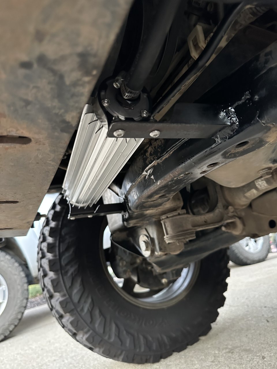

    Truck recently got a new rack, today it got a power steering cooler. 6293CAA6-24C6-43EA-9399-7B7E8155B90D.jpg
