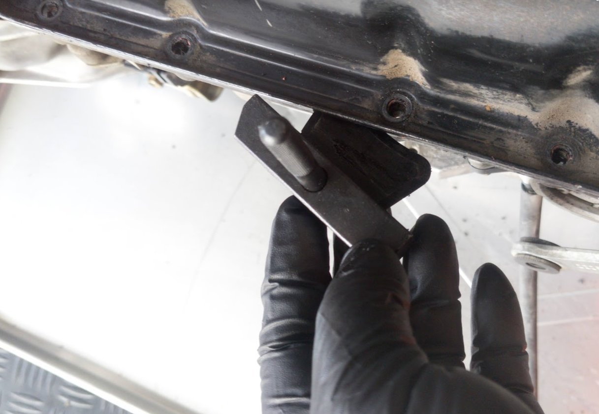

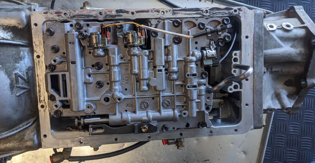

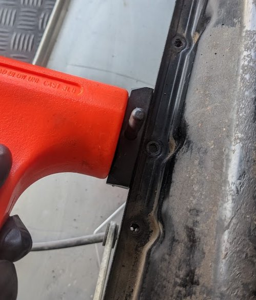

    Replaced the throttle cable today in the A340F. Wasn't bad at all and didn't even have to remove the valve body, not sure why Toyota FSM says you do.

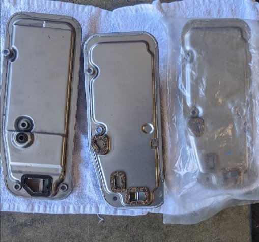

    Was going to replace the strainer and what do I find - it's different than the one I had ordered! Ugh. Another difference between the taco and the T4R transmission.
    Left is the 99' 4Runner A340F strainer (part# 35330-60020) and on the right is the taco strainer (part# 35330-60030). Kicking myself for not checking before.

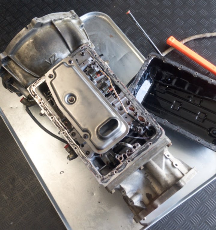

    Also, whoever worked on this thing used black RTV and did a shit job of it to boot. PITA to remove. That pan removal tool did help quite a bit though. Glad I ordered it.
    So now the trans is on hold until the correct strainer arrives this week. Going to start on the knuckles next.
    Edit: worth noting, this A340F has only 4 magnets in the pan. I believe the taco A340F has 5. Odd.

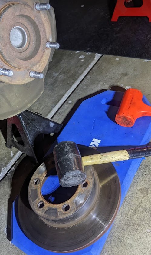

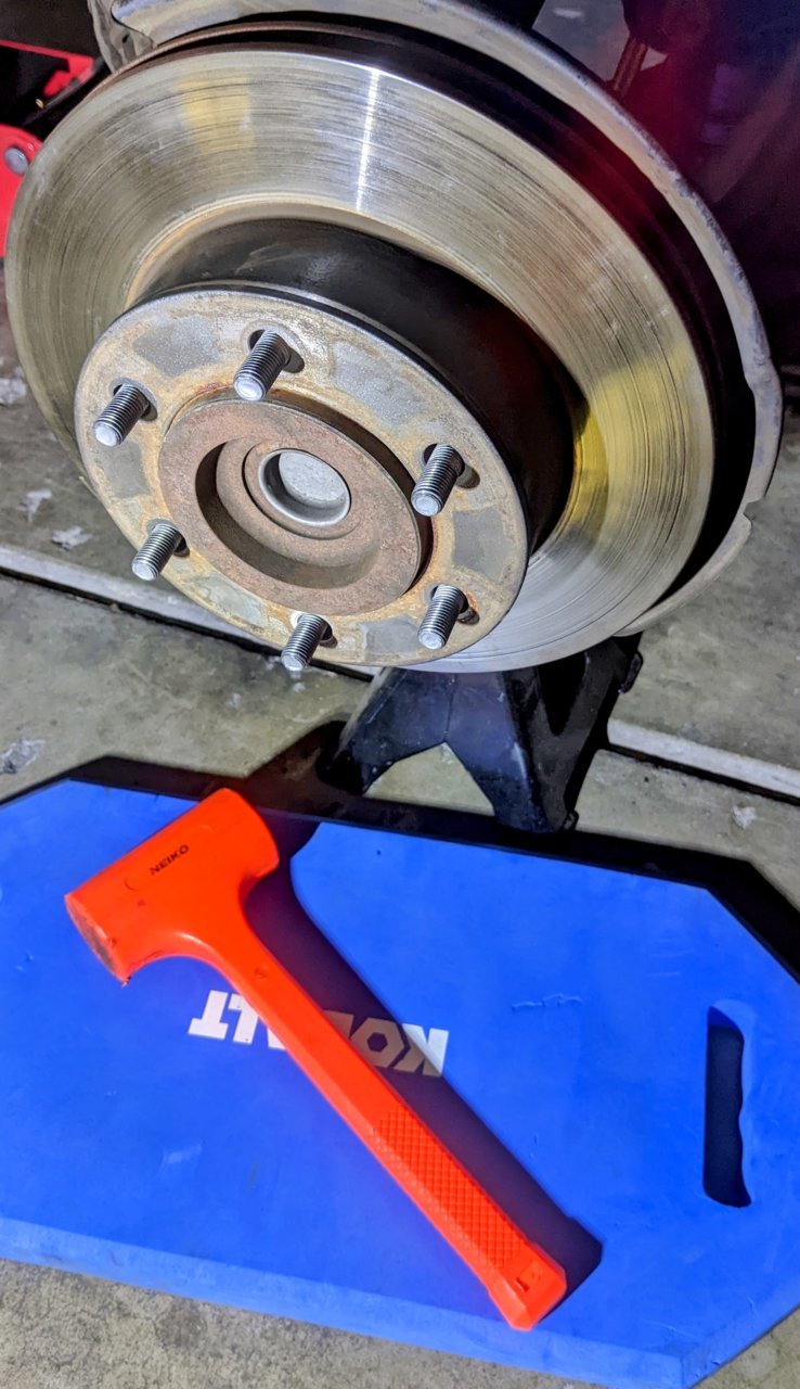

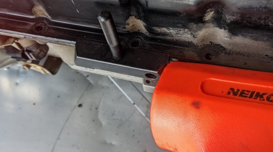

    Beating the living hell out of the rotor and it still doesn't want to come off. FML. :frusty:

    It's less Tacoma and more mod
    Metal hammer be better for that

    Northern California, Bay Area
    02 3.4 DC TRD PreRunner 4WD SWAP
    Trying not to damage it since I'm not replacing it - not yet at least

    You need to shock that center portion though and you won't do that with a dead blow

    I should've went with it to begin with. Trusty 15+ year old rubber mallet did the job.
