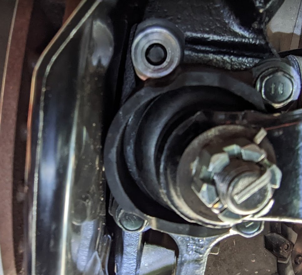

    Yeah, so fak you LBJ bolts. Seriously. Now maybe its the damn knuckle I used (not my original 2WD PreRunner knuckles), who knows. Damn bolt snapped off while before hitting the torque value. A mere 59 ftlbs. New bolts straight from toyota. So now I get to figure out how to salvage this knuckle that I just pressed in a new OEM hub/bearing/etc. @SpikerEng - FYI for your study/thread. These were bolts 90119-10933 for use with the dust cover. No loctite applied.
    Was all done with the front half of the swap and was wrapping up with torque spec. Super pissed right now. :censored::bananadead:
    EDIT: Photos added of the carnage. Makes me want to order new bolts all over again from a different supplier. These came from Toyota Colorado Springs. Not saying they are crap, I like their parts department. Just going to go with a different batch.
    I do think I can save it though. Going to pull it off the vehicle tomorrow and then pull the LBJ. Hopefully can grab onto what left of that broken mess and remove it.
    EDIT 2: Pulled the ball joint and the steering knuckle off the vehicle. Amazed I didn't need anything to remove the remainder of the bolt. Unscrewed the remaining half easily. Weird.

    I think it broke off right at the surface. Don't even want to take the damn knuckle off the truck. So tired but its going to bug the hell out of me until I do. I don't think I can tap it out either, right?

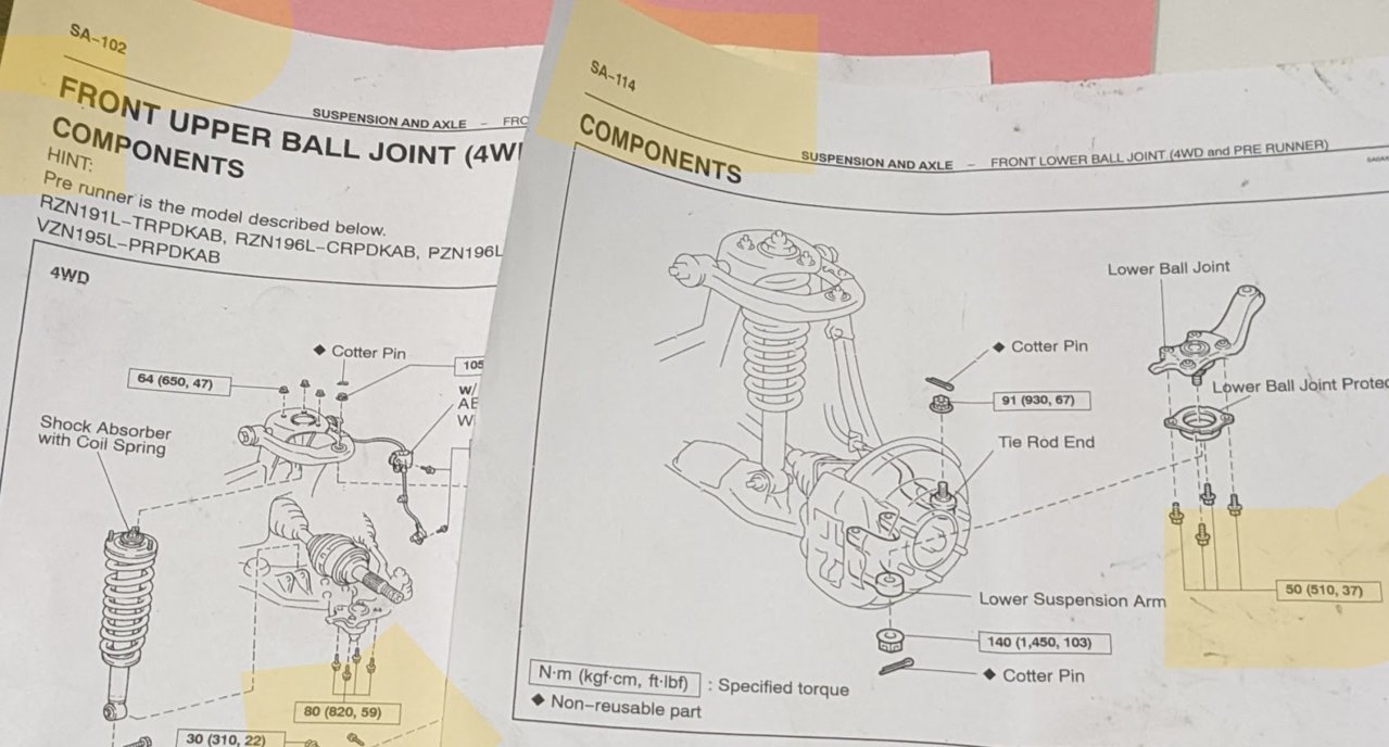

    Captured washer bolts are 37ftlbs. Spike just did a test on lbj bolts.

    OMFG. My fault. Rushing and look what happens. Actually, I had a stack of screen caps from FSMs with me and looks like two different specs. Hell, I even commented in his thread the other day before I installed the LBJs and mentioned the 37ftlbs and also attached a screenshot. Unbelievable. At least now I know it wasn't the bolt but as usual ---- USER ERROR.
    Thanks for mentioning it, feel better knowing what happened.
    @SpikerEng - Confirmed torque exceeding 37ftlbs on 90119-10933 will definitely produce a failure :anonymous:

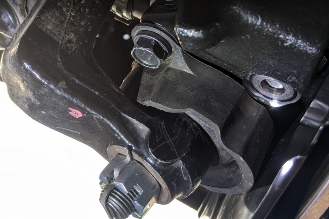

    If you aren't using the boot protector and its not the black bolt w/washer, you're OK. If it is that black bolt w/washer, I'd be ordering 8 new ones asap and swapping them out. Anything over 37 is going to cause stress on those threads (as he detailed in his thread).
    This is the one that snapped. It was bugging the hell out of me so I just finished backing out the remaining 7. The driver side was at 37 - was nowhere near as tight as the passenger side. Still, going to replace all of them. Just don't want to risk it.

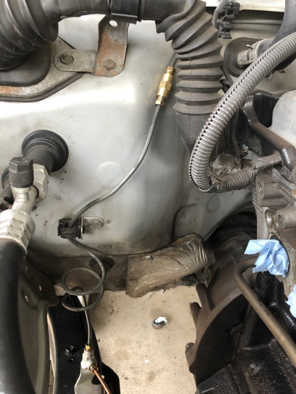

    EGR deleted…
    I connected the coolant hoses with a vacuum hose connector. Someone holler at me if I shouldn’t do that.
