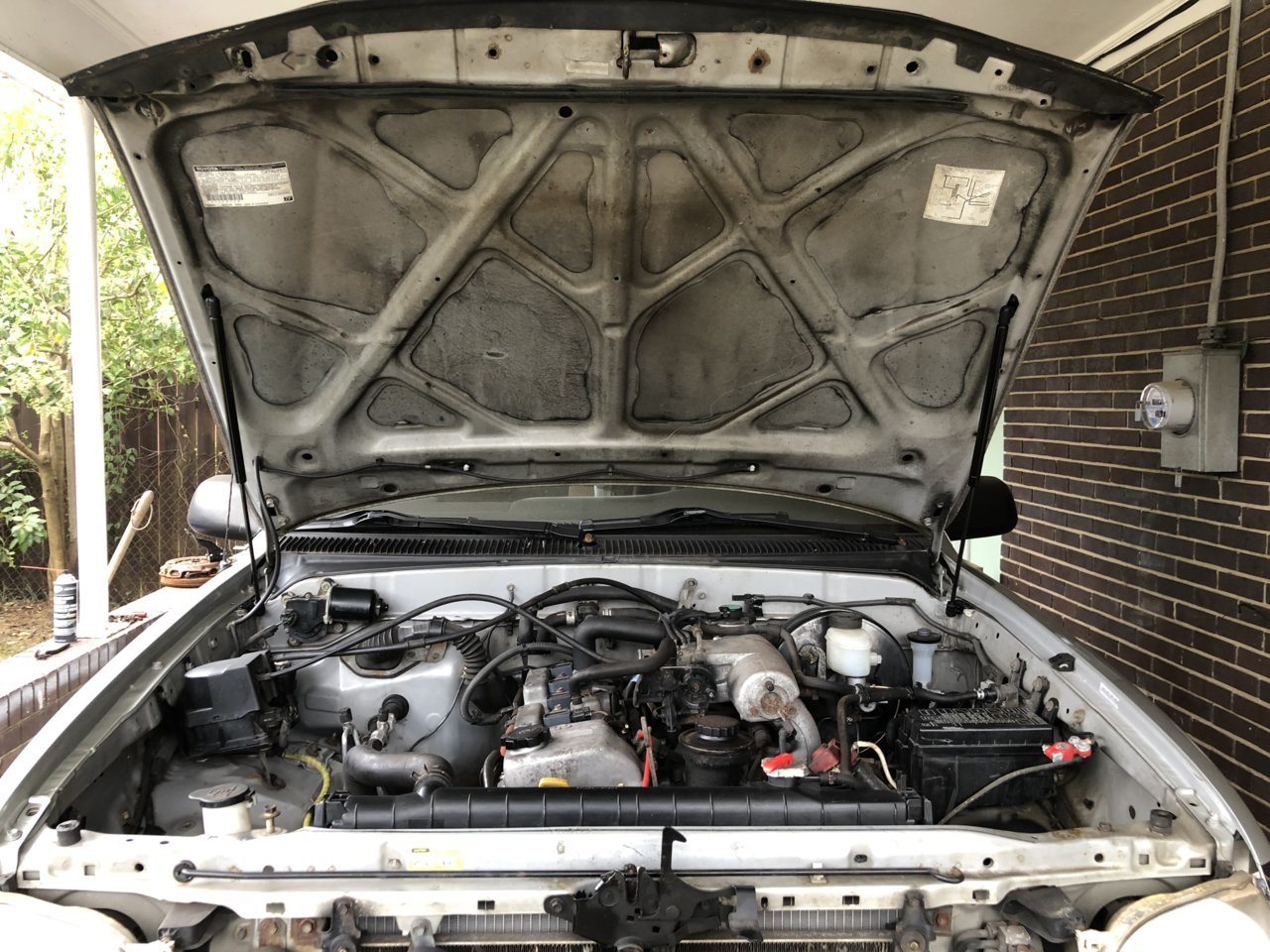

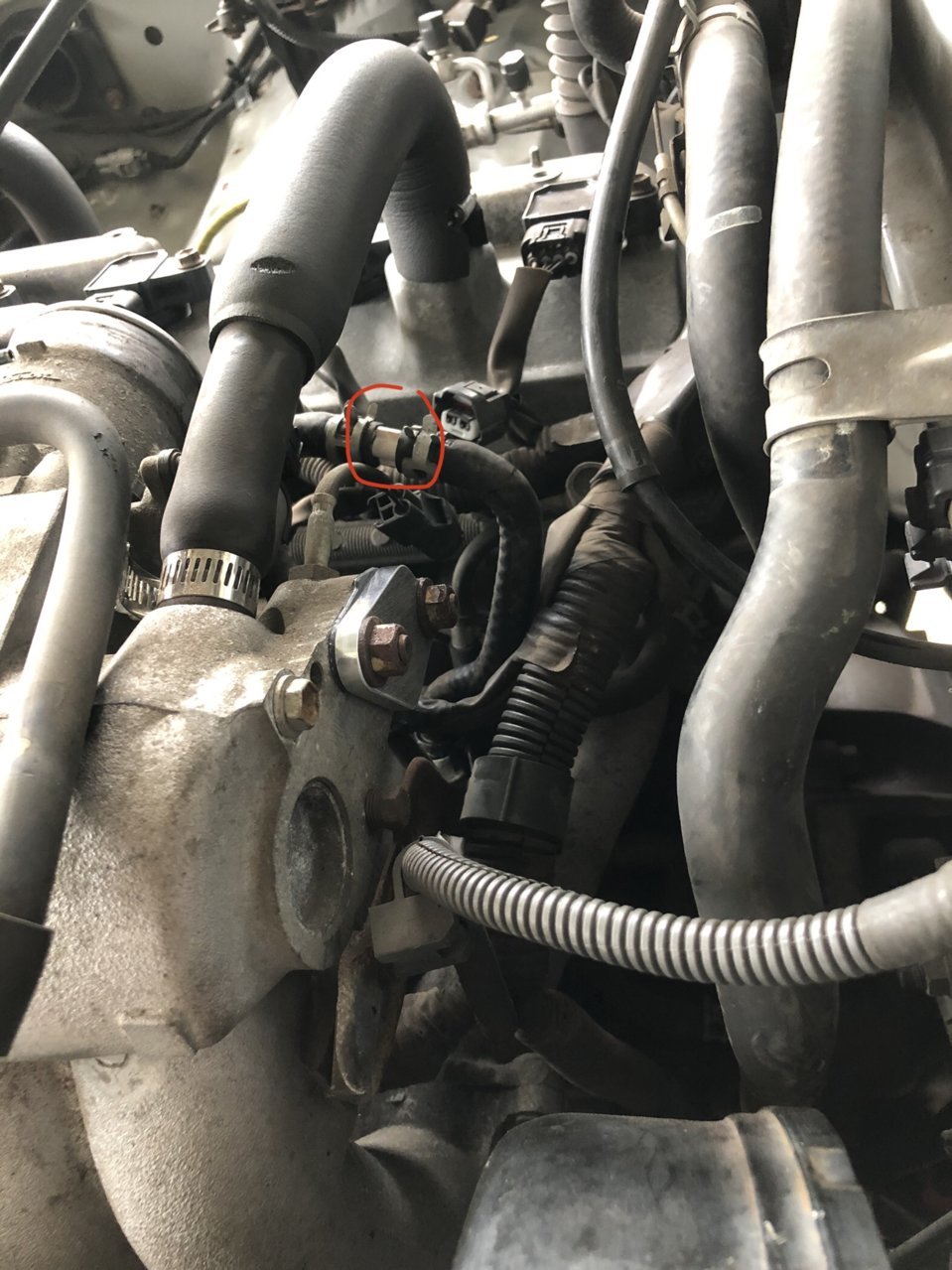

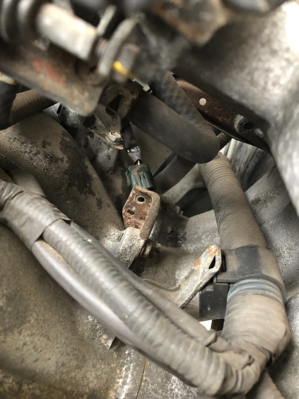

    Well, it’s purpose is to reduce exhaust temps to protect the cats or something like that, but I have no cats, so it’s useless. Removing it won’t uselessly recirculate inert exhaust gas back to the cylinders, and makes the engine bay look a little cleaner and less cluttered.

    And since it’s no longer uselessly recirculating inert exhaust gas back through the cylinders theoretically the motor should get more better and consistent combustion. I think anyway

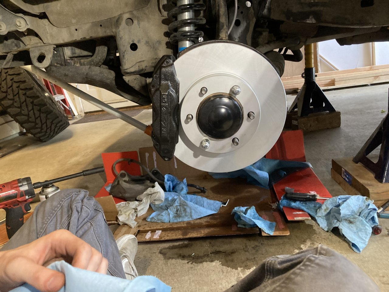

    Glad to see its all buttoned up and on the road again, nice job! Hope to be there in the coming weeks. Parts to resolve my LBJ screwup will be here Saturday or Monday and then its on to swapping the transmission and driveshaft. Nearly there.

    I've melted plastic fittings in my coolant system. Good chance it's because of the turbo but I don't trust using them again.

    Thanks for the warning, I’ll look for a proper fitting online, the store next door just didn’t have anything.

    Probably can find a straight barb fitting in the plumbing section of ACE hardware or HomeDepot, they'll have brass at least.
