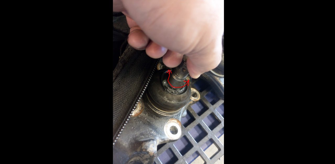

    The LBJ stud - is it supposed to rotate easily? Not talking about orbiting around the circumference just talking about twisting it in place.

    Yes. Otherwise you wouldn't be able to turn. :D

    Proper way to check is them still installed. Then just jack the wheel off the ground and use a pry bar to pry up the lbj. If it moves, it's bad.

    You are correct. Toyota doesn't say anything about threadlocker.
    I always use blue Loctite and torque to 55 lbs (used to use OEM. Now I use the brass color bolts like Spiker showed in their tests)
    I've never had a problem.
