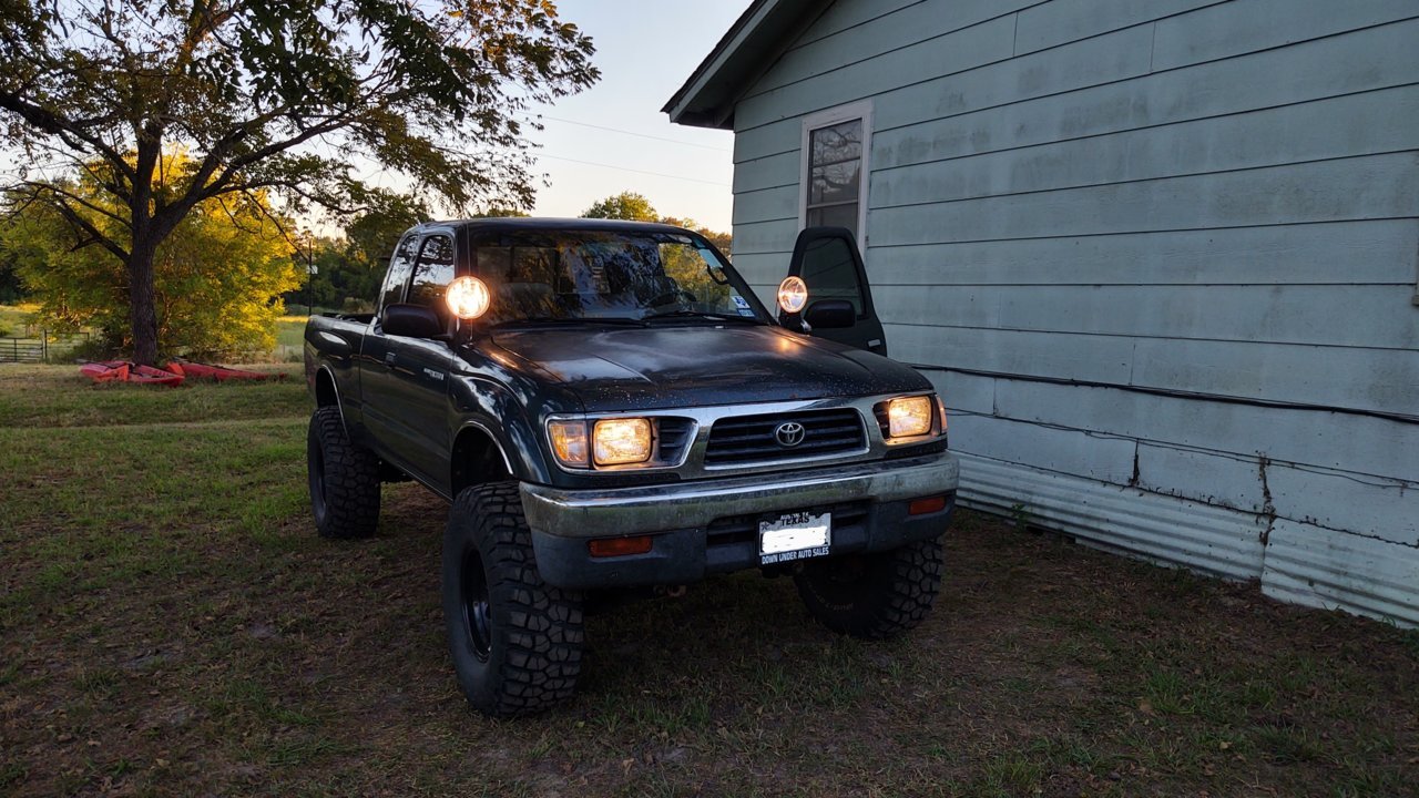

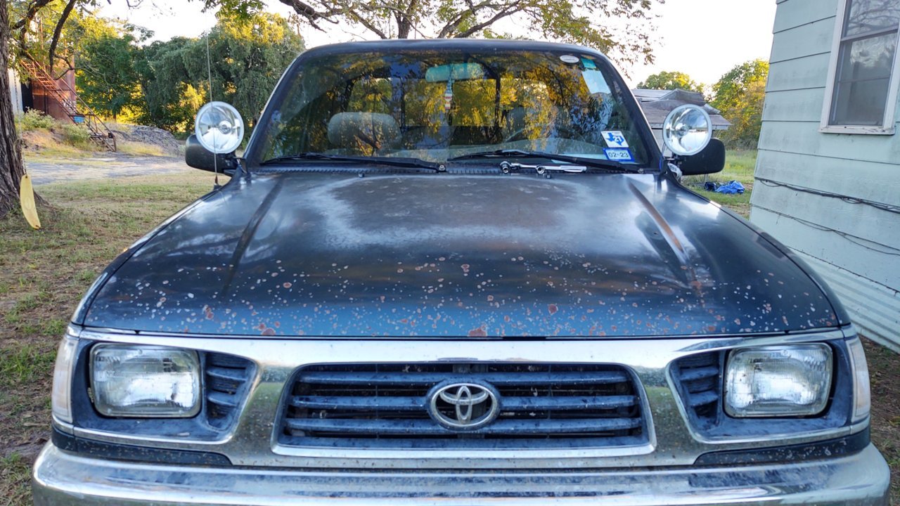

    Got my Hellas installed yesterday and went to pick up dinner and test them out. I need to spend some time one night aiming them how I like, the driver's side light was almost perfect for lighting up the ditch and trees but the passenger side was way too far up and out completely detached from all my other beam patterns. I also got pulled over by Highway Patrol (I guess the 33s threw off my speedometer more than I thought) but ended up just talking Toyotas for 10 minutes and getting let go :D

  7. Oct 4, 2022 at 7:51 AM
    FatBilliam
    FatBilliam Well-Known Member
    May 31, 2015
    #156458
    124
    East TX
    '97 3.4l 5spd Ext. Cab
    Yeah they're pretty obtrusive (my girlfriend thinks they look dorky) but I like the look better than LED pods on a truck with the older front end. Now that I have the brackets installed, I may change things around down the road if I find some compact pods that I like. One positive is they catch a lot of wind and whistle sweet songs to me while I'm going highway speeds.

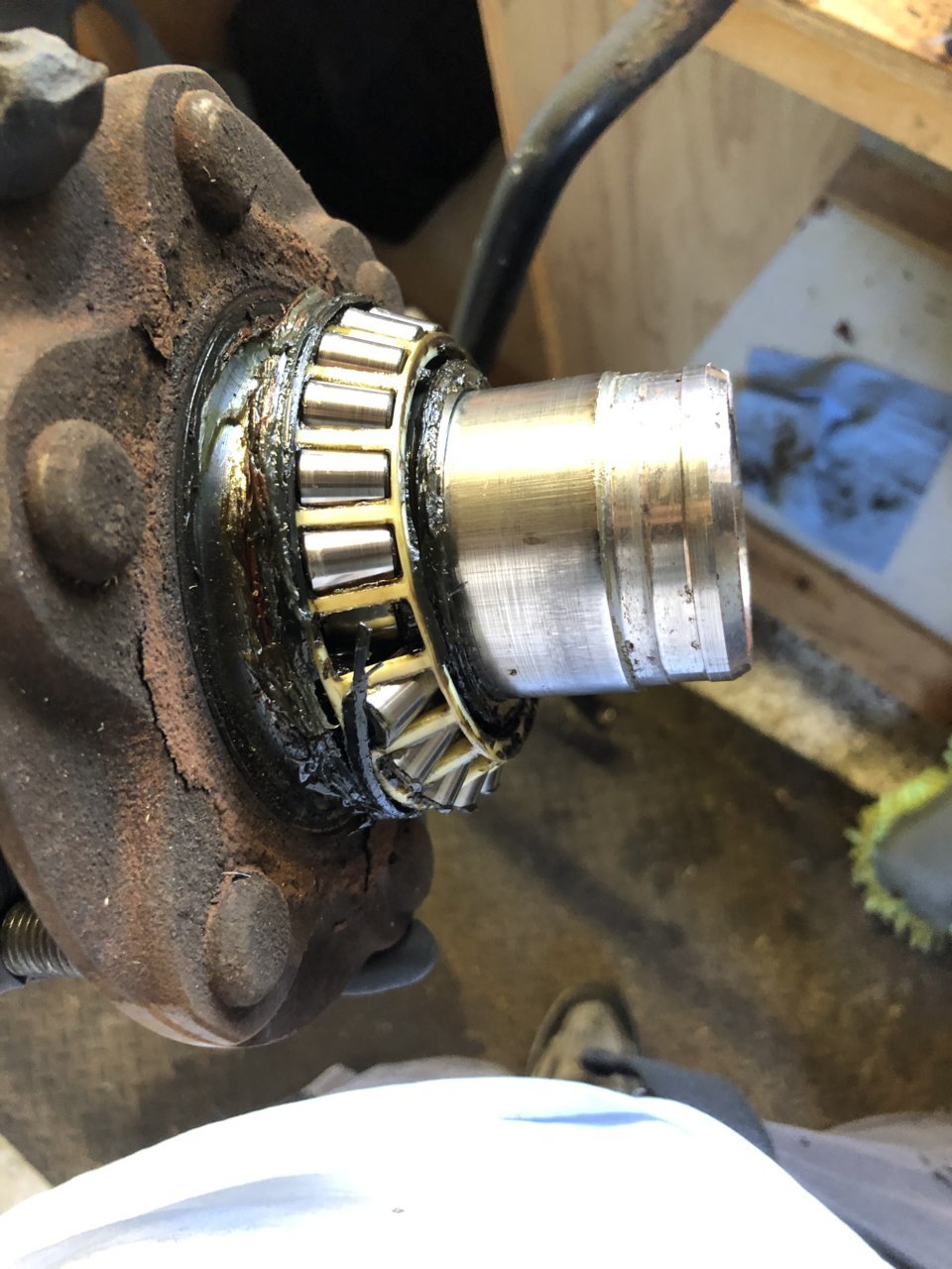

    I pressed out my hub, but the bearing came apart instead, what did I do wrong?

  9. Oct 4, 2022 at 1:06 PM
    Speedytech7
    Feb 20, 2014
    #123587
    57,844
    FCQM+VG Cheney, Washington
    It's less Tacoma and more mod
    Nothing, that's what happens, they're not a reusable part. Easiest way to remove the old bearing cage and race now is to heat it up with a torch while rotating it and itll nearly fall off the hub.
  10. Oct 4, 2022 at 1:08 PM
    Jakuku Pahwheenis
    Jakuku Pahwheenis i provide useless forum contributions
    May 27, 2022
    #398083
    1,098
    J Phoenix
    South Carolina
    2003 Xtracab 2.7L 3RZ-FE 4x4 manual 245K+ miles
    Oh ok, yeah I’m replacing the bearings.

    You didn't do anything wrong. That happens to me just about every time I do the wheel bearings.
    I usually just cut a slot in that with a dremel (will need to be at an angle to get in there) and then use a cold chisel to pop it off. (Careful not to cut through that bearing and in to the hub snout)
  12. Oct 4, 2022 at 1:20 PM
    Parkvisitor
    Parkvisitor Do you know midnight?

    Yup on 4 spindles 3 ended up like that. No problem, many different ways to remove the remaining race

    I might just try renting a bearing separator kit….eventually

    Yep, just posted about this the other day. 4 out of 4 ended up this way for me. It's pretty damn rare for it to press out clean apparently. As others mentioned, heat it up and work it out or cut it/chisel.

    Not going to work (don't ask how I know lol). The typical kits on Amazon are too small or too cheaply made. OTC has a large bearing separator but I'm just going to Dremel them.

    Thanks for the heads up, looks like I’ll be buying a dremel
