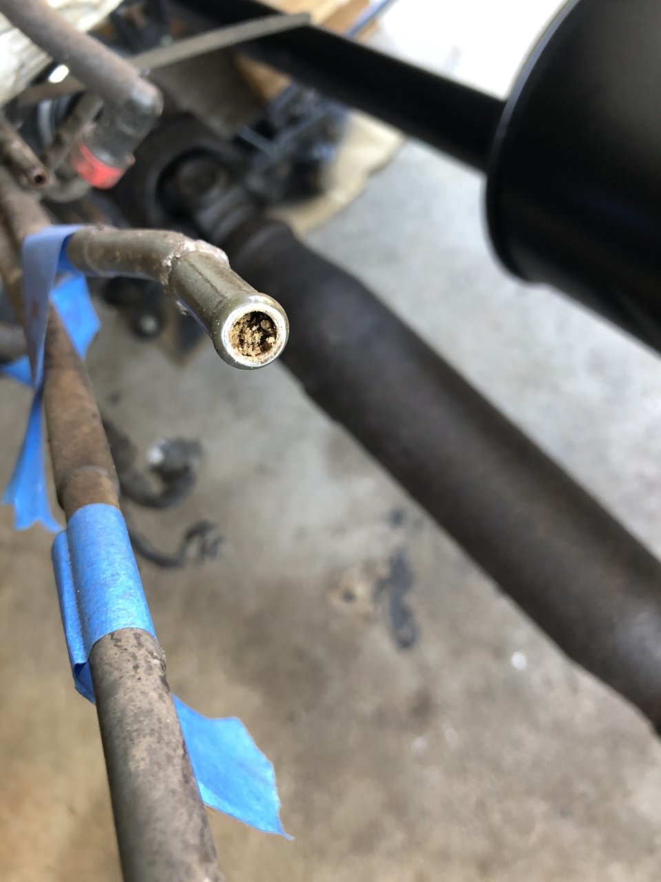

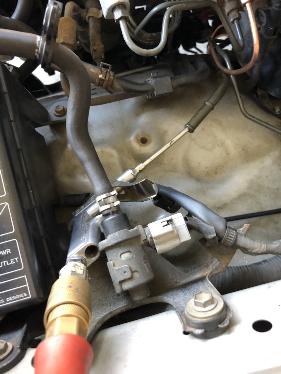

    Dirt dobbers or something layed eggs in my exposed evap tubes. Nothing an air compressor and pipe cleaners can’t handle. Glad the didn’t invade my fuel lines.

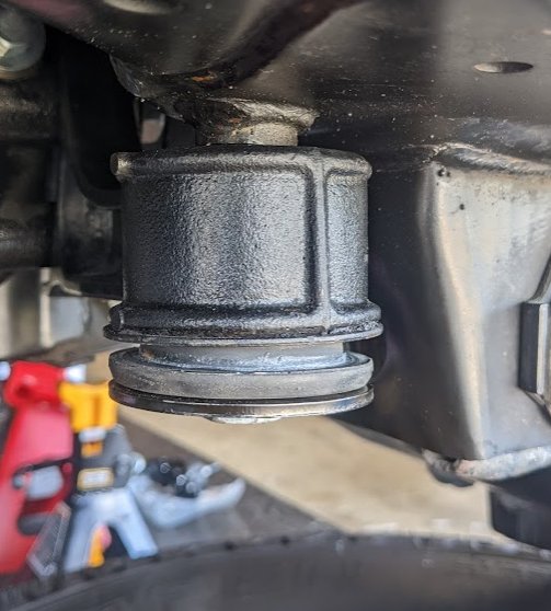

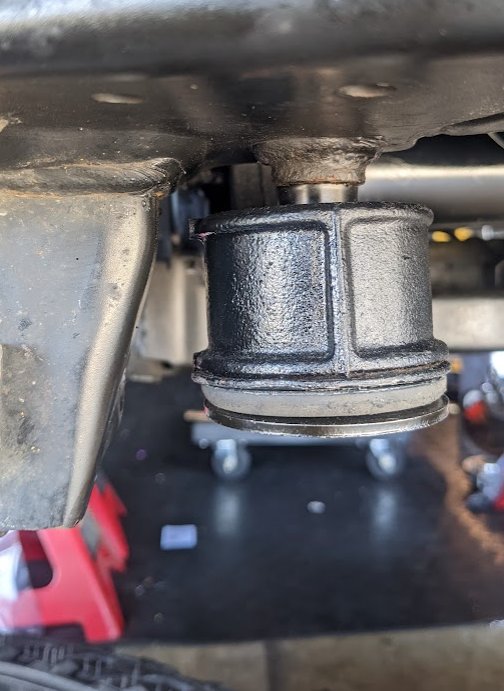

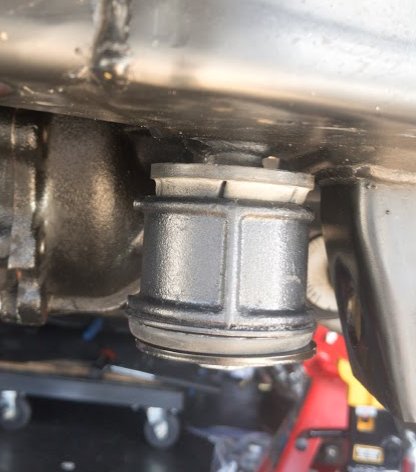

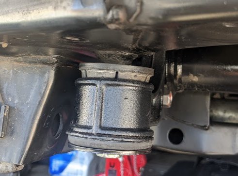

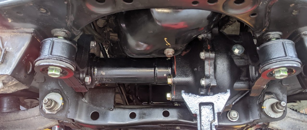

    Lower ball joints just showed up via the big brown truck. Was getting ready to put the knuckles back on and noticed this with the front diff... WTAF? Is it supposed to be flush or not and wtf happened to my durobump bushing on the driver's side? It wasn't like this before when I first installed the front diff a few days ago. Truck has been on stands ever since waiting for the LBJs. Diff mounts were all torqued down. Should I loosen up the mounts, try to reseat everything then proceed with installing the knuckles?

    You're missing the bushing that goes on top, which isn't supplied with the replacement durobump set.

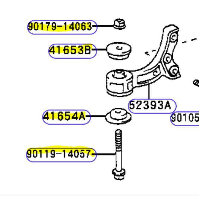

    No I had ordered all of that from Toyota. I used this as a reference -
    Oh WTF. I know what I did. At least I think I do. Need to go out there and check. I might have put 41653B on top of the damn cross member. :facepalm:Will check and report back. lol

    That's exactly what happened. I put it on top of the crossmember and bolted it down. FFS. Well, in my defense lol, didn't have a front diff before and it was the first time installing one. Oh well, will loosen it up and hopefully I didn't screw myself here.
    EDIT:
    Mistake fixed. Good to go.

    LOL... mistakes happen bro. You don't have to defend anything. You're doing more than most right now. Keep it up.

    Much better! :thumbsup:
