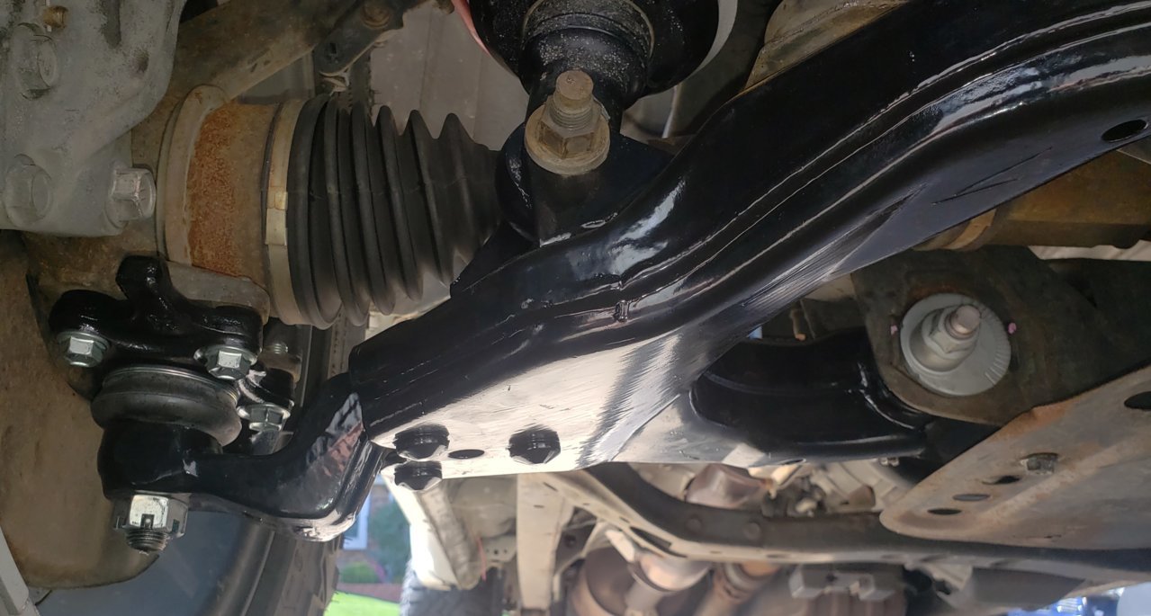

    That looks 100% seated to me. It won't be flush. There will be a gap like that with a little in/out play, perfectly normal.

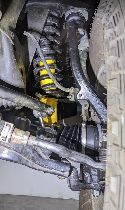

    I would not bother with a diff drop. It just slightly tilts the diff a bit, doesn't really drop it. I noticed no difference after doing mine a few years ago. Little hard to tell with the pics but I don't think I see much boot rubbing. What OME springs are you running?
    That crunched boot just looks like you pinched it when handling it, it'll pop out.

    Continuing to look at it, have to agree with you and Zane. Its seated, there is just very slight play in/out of the diff so will run it. If its going to leak, I'll know when I fill it - right? :rofl:
    OME springs are 881s. I didn't do any kind of measurement but I don't really see a difference with the diff+CVs added weight. I just wrapped up the ARB and its also back on the truck but it seems fine. Didn't really want to run the diff drop either - too many mixed opinions on here. Will skip it.
    Quick pics that are a little better of the outboard boots.
    Driver side -
    Really do need to get this project wrapped up, this thing needs a driveshaft attached to it. I actually was planning on saving the front end for last and get the transmission/transfer case swapped in first. Bugging the hell out of me so just did the front end anyway since everything was ready. Plan for tomorrow is to replace the transmission strainer and FIPG that thing so its also ready to go. After that is done, its time to start unbolting this 2WD transmission and wrap this thing up. Oh and I was able to pop that boot back into shape lol.

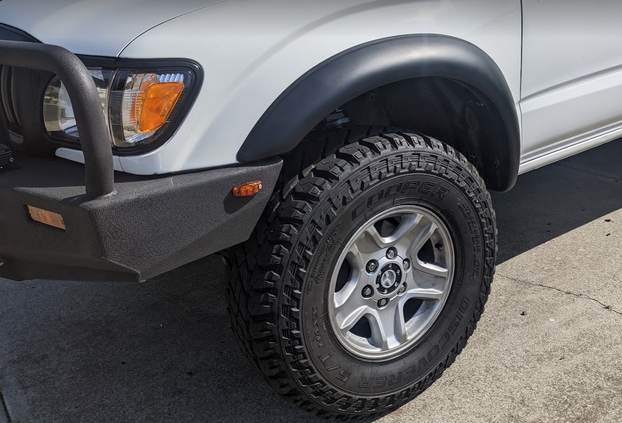

    To cap or not to cap... that is the question.

    2000 Tacoma 3.4 TRD "Stock AF" & 2006 GX470 Sport
    Cap IMO. Looks cleaner.

    I am liking it with the cap.
    The end is in sight. It shouldn't be too bad once you get going. Great work so far, time to wrap it up.
