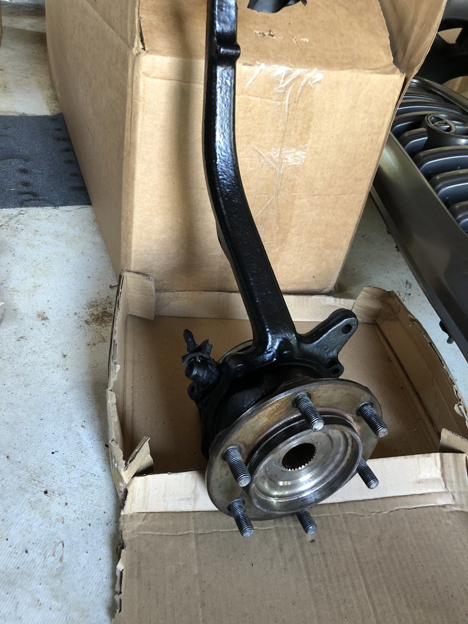

    Ok I had time left to finish the other half of this knuckle today. Hub, spacers, inboard seal installed. Just needs a UBJ, but that’s a tomorrow problem. Look at that byoot.

    Skipping the dust shields?

    Yup, screw em

    It's less Tacoma and more mod
    I cut a tiny section from mine so I could remove them independent of the hub.

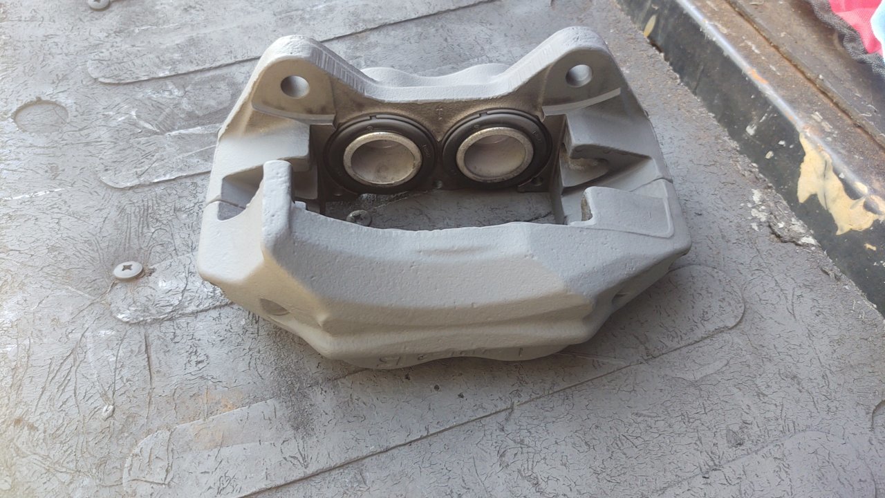

    I tried to free up the seized/partially seized pistons on my caliper but there was one of the three that I just couldn't get. Went and got a reman caliper from O'Reilly, painted it to match, and got it installed with some new front brake lines and bled the system. I wanted to paint the rear drums and hubs today as well but I think that may have to wait.
