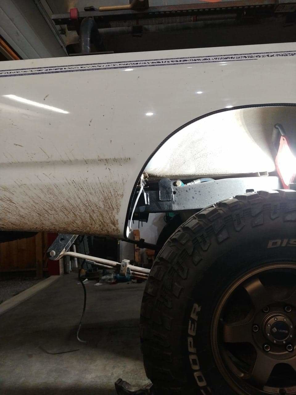

    It's less Tacoma and more mod
    Had to take the ol slice and dice to the fenders to keep the tires from hurting themselves.
    jubei, FatBilliam, SwampYota and 6 others like this.

    How much uptravel you got at ride height with them fancy pants 63's?
  8. Oct 12, 2022 at 1:37 PM
    Speedytech7
    Feb 20, 2014
    #123587
    58,091
    FCQM+VG Cheney, Washington
    5.5" right now. Gonna move the shocks through the bed so I can run 14s and pull closer to 6 on the uptravel. The 12's can be maxed out easily with 63s

    oh is this what the shackle angle is supposed to look like, maybe thats why my truck rides like hell
  10. Oct 12, 2022 at 2:29 PM
    Speedytech7
    Feb 20, 2014
    #123587
    58,091
    Around 45* at ride height is what's ideal yeah. Not all the weight is on my rear axle in this pic but when it is I clocked those shackles at 43* when I first set it up, probably sagged a bit by now tho haha
    DashMaple[QUOTED] likes this.
  11. Oct 12, 2022 at 2:31 PM
    DashMaple
    DashMaple Well-Known Member
    Feb 11, 2018
    #244129
    981
    Louisiana
    01 V6 4wd PreRunner DCSB OME lift
    Yeah mines a good 60-65*

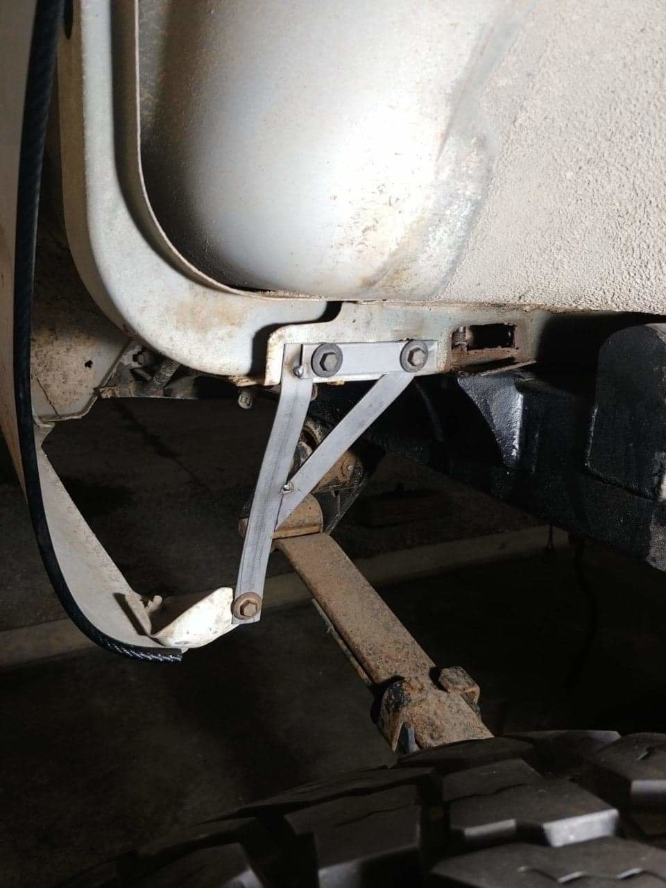

    Got a couple of quick fender stay brackets whipped up, just gotta finish weld and paint.

    Clean cuts :thumbsup:
