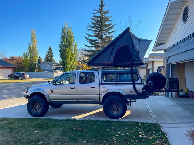

    Thanks! I’ve had a few before but always soLd for odd reasons.. lol. I couldn’t pass up this deal on Amazon though. And yeah the heater on the lowest setting will keep it perfect even on the -20 nights up here.. I was debating getting some sheets of insulation, and cutting to shape. Would be easy to store just inside the tent too.

    Ian

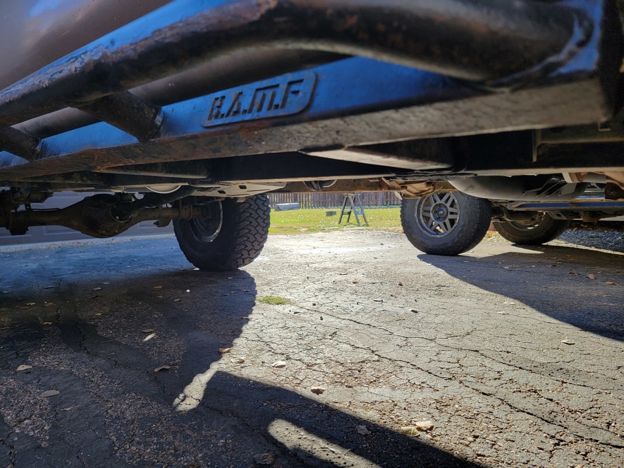

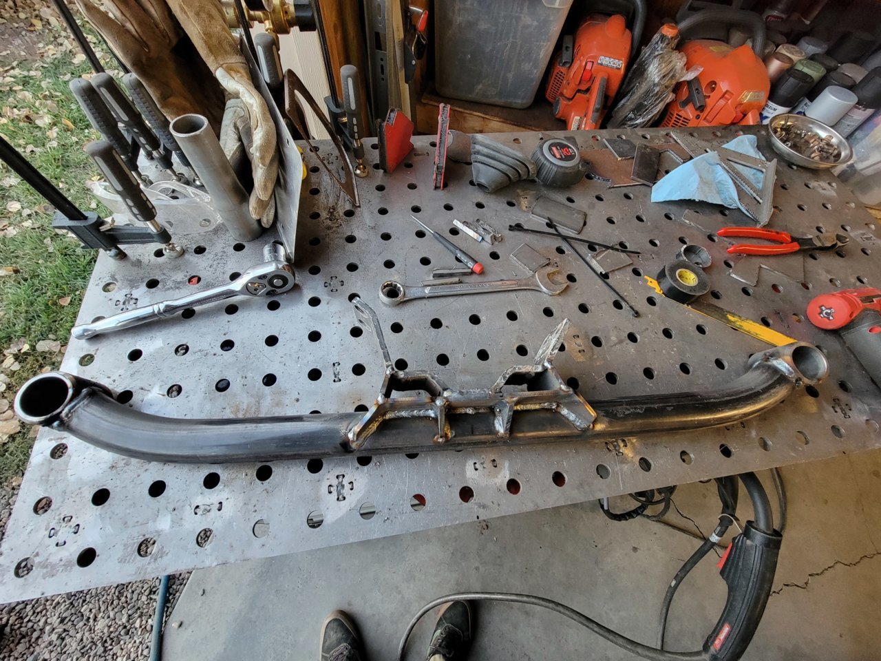

    Build a new trans crossmember, which was the last step in my (nearly) flat belly project. Went along with clocking the tcase, deleting the 2nd cat, and raising the gas tank.
