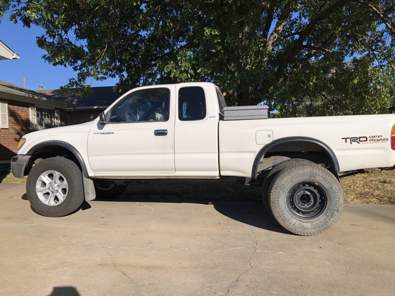

    OK update POST
    after a week or so I went and re-torqued the bolts on the rear leafs and shocks, and I have one u-bolt that needs replaced. one nut just spins:rofl:
    the rest are guuuuud
    pic is just to show "stock" 31s and my 235/80/17.
    I am very happy with these cheap highway tyres. :thumbsup:
