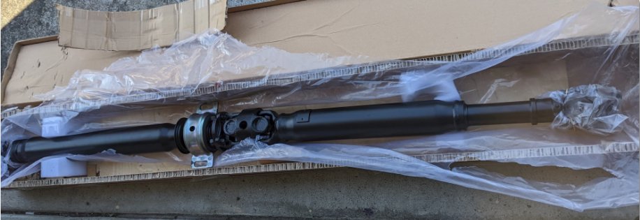

    The diameter of the tube is much smaller than the OE driveshaft which leads me to believe that the OE shaft will be stronger. Of course materials and thickness of the metal plays a part so this is just my assumption between the two. I don't think it would make a huge difference in our low power trucks. Fitment was great. Perfect swap. I removed all of the grease in the slip yoke and replaced with my own.
    After about 4k miles on the driveshaft, I lifted the truck's front end by 1.5" and the rear 2". One of the U-joints in the double cardon started to squeak immediately. It goes away if I shim down the CB so that the shaft is straight from the CB to the rear diff. That tells me that the needle bearings did not like the articulation. I'm going to open it up one of these days and replace it. I figured the u-joint was probably some made in china junk but I called wholesaleimportparts and they said that they use a brand that was made in the USA. I can't remember the name at the moment. I think the name started with the letter C. Anyways, their website does say that they aren't for use on lifted trucks. I don't know if this is just to cover their asses or if there is really an issue. Maybe it is just my luck. Who knows.
    Overall, I'm pleased with them minus the u-joint squeak. BTW, the u-joints are sealed so I can't just pump grease in there to see if it will fix it.

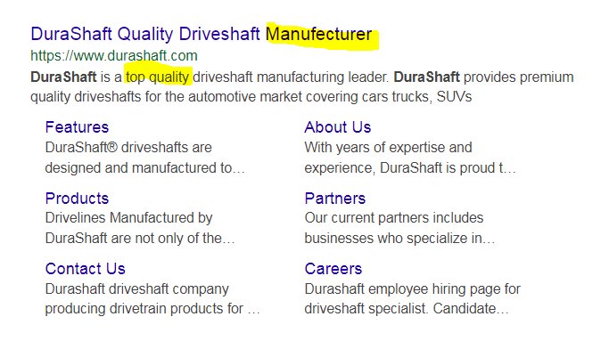

    Was this shaft from wholesaleimportparts?
  4. Oct 21, 2022 at 12:51 AM
    Area51Runner
    Area51Runner Well-Known Member
    Jun 26, 2014
    #132748
    11,980
    Northern California, Bay Area
    02 3.4 DC TRD PreRunner 4WD SWAP
    Yes. Box has a bunch of 'Dura Shaft' stickers on it.

    The one that you got looks very close to a OEM driveshaft whereas mine looks completely different. I figured that they(wholesaleimportparts) are just the middleman and don't actually make them. Mine was made by driveshaftpro.com. The one that you got is much beefier with greaseable u-joints. On face value, I would prefer the one that you received. Let me know how it works out.

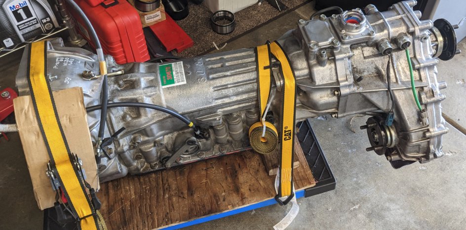

    Will do. Calling it a night. Have all the electrical disconnected from the 340E. Throttle cable free, coolant lines removed, driveshaft removed - all that is left is to unbolt it from the engine and drop it down.
    Tomorrow I'm going to compare side by side the two driveshafts and will take some measurements. Will pass them on.
    :facepalm:

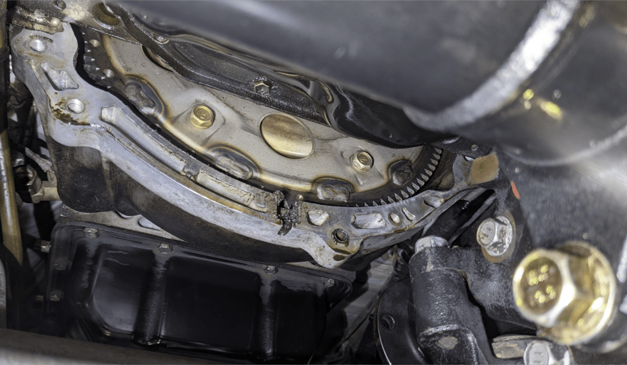

    That last (or first if you start on the driver's side) bolt to remove the inspection plate to get at the torque converter bolts - ROYAL PITA if the diff is installed. I refused to remove the diff and everything else - made it happen with skinned knuckles lol.
    Almost there - next up the 6 tc bolts, remove crossmember, remove starter and finally 6 bolts and 340E is outta there.

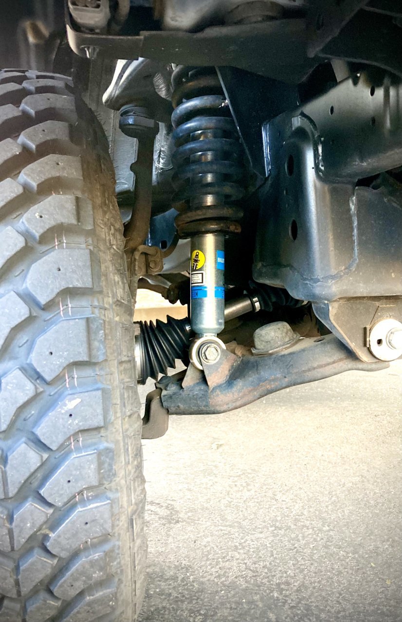

    After 10 years of Old Man Emu struts it was finally time to replace. Some new Bilsteins, shining like silver gold!

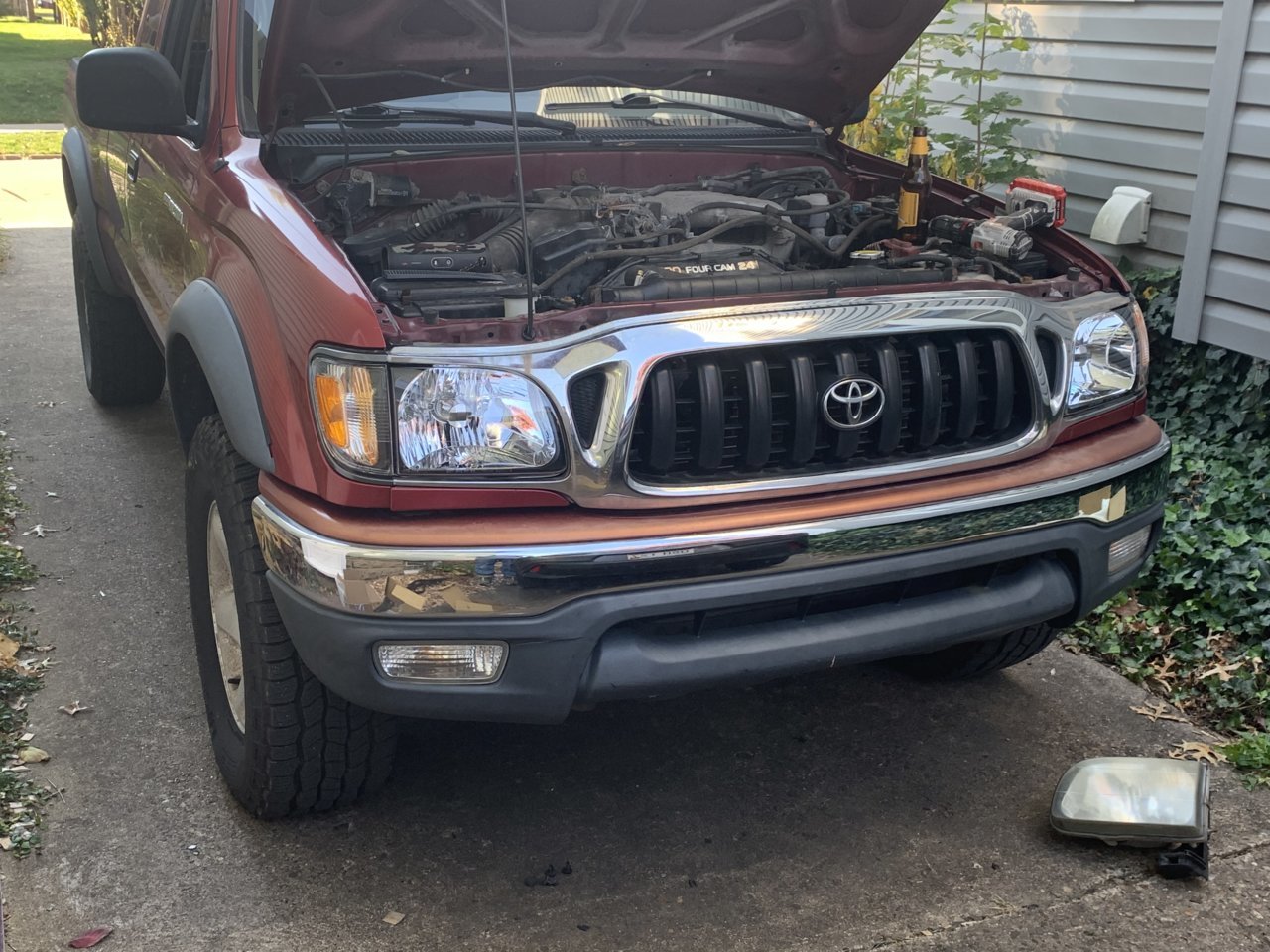

    new headlights and corners. Maybe i’ll be able to see on the way to work now.
