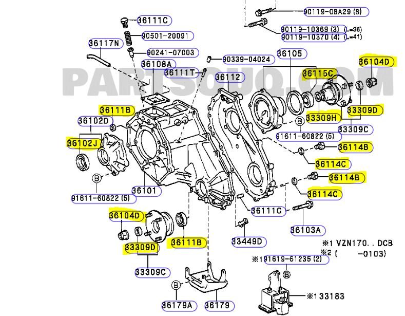

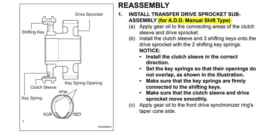

    So the ADD case/2-4 (however you want to label it) and the MT is going to have that synchro ring and the shift keys. Because those are missing, I wanted to add that little blurb. The seals and bearings are going to be exactly the same. Its literally the same case. At least that's what I've taken away from my time spent inside and outside of that case as well as pouring over all the docs I can find on the subject. I would love to have a 2-4/push button 4wd as well as a manual (MT) case to poke around and rip apart. Don't have it though so unless someone wants to donate ;)
    Edited and reworded a bit
    Page 20 TF-31, 1

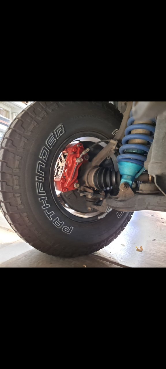

    At 715k the front hub bearing decided to let my know they were done.
    Had new bearing, seals and hubs replaced and put new calibers on.
    That constant wheel vibration at 60-70mph is finally gone and with the new calibers and paint she stops on a dime again, super easy to lock up the tires if I want.

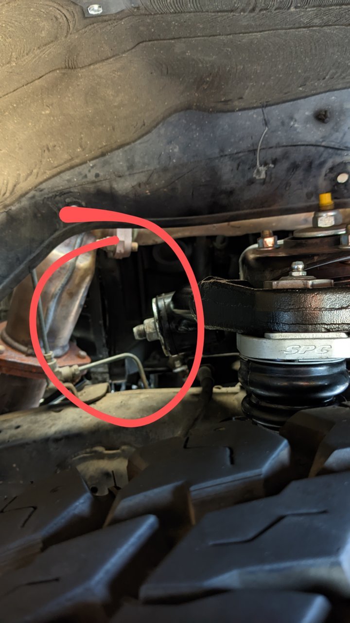

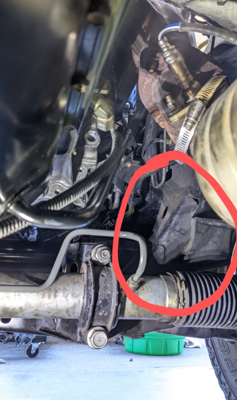

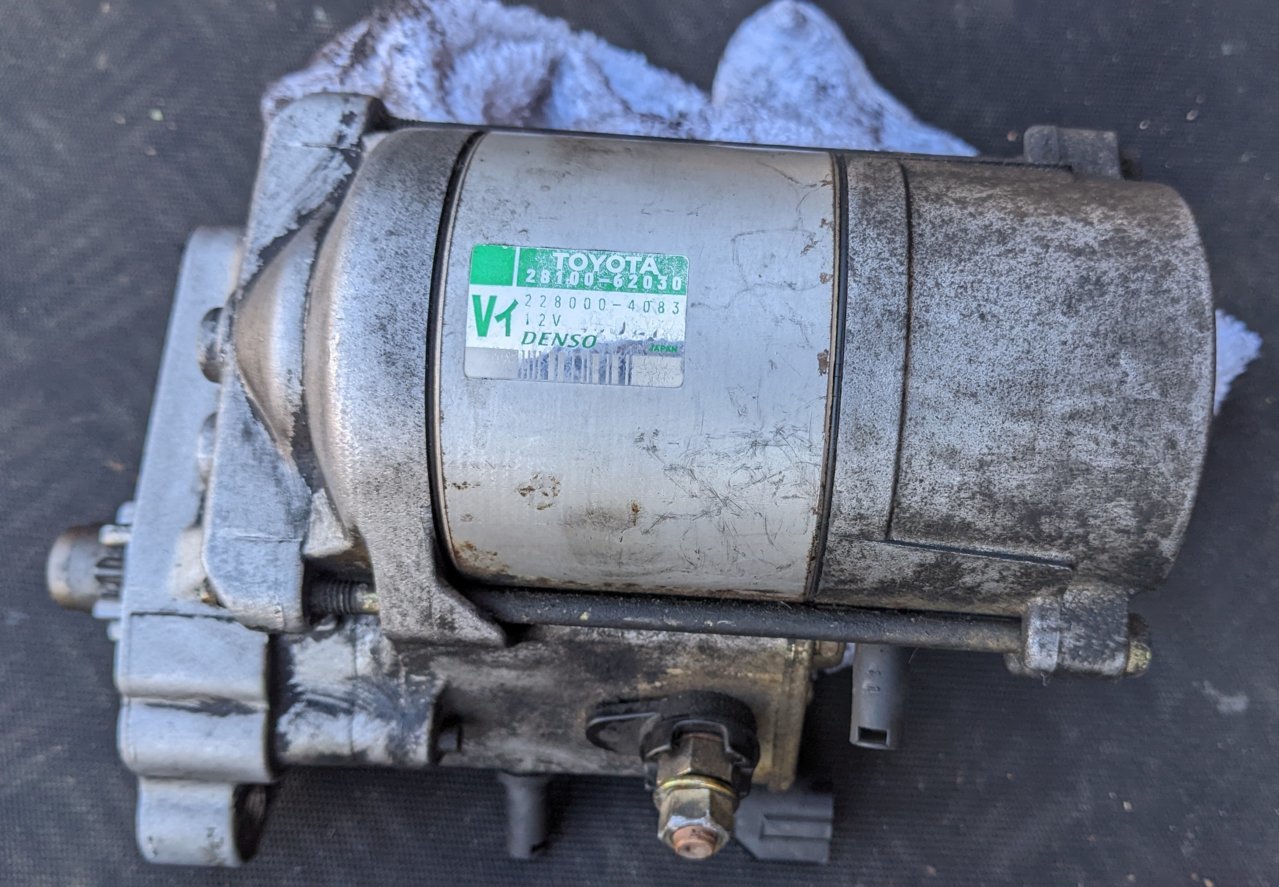

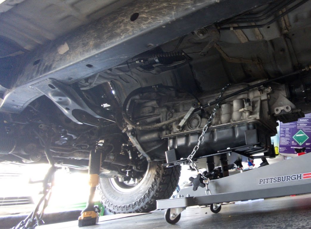

    Also, for whatever reason I simply could not get the starter out through the wheel well (and yes, I did unbolt the brake line bracket as well as unclip it above the coil portion in the engine bay).
    Ended up taking it out over the steering rack near the CAT. Much easier actually.

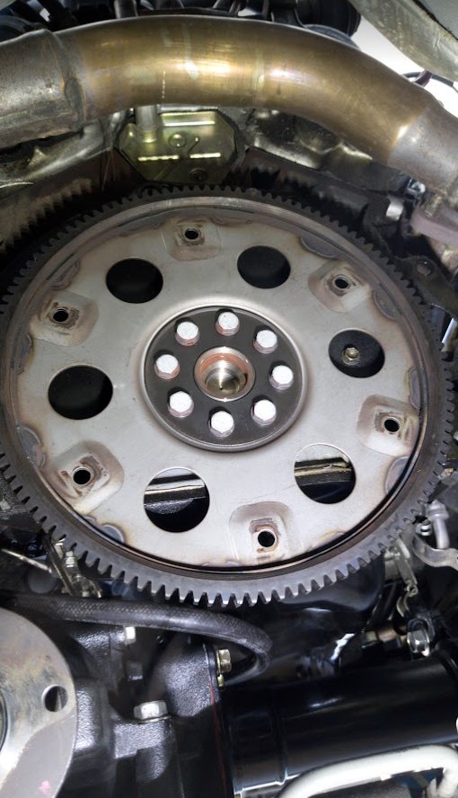

    I wonder if I could bolt it up to the transmission and then install the trans. (?)
    Just thought about that and no bueno.
  12. Oct 23, 2022 at 12:30 PM
    Speedytech7
    Feb 20, 2014
    #123587
    58,548
    FCQM+VG Cheney, Washington
    It's less Tacoma and more mod
    You can't, cause there's a flywheel/flex plate in the way

    Crazy, what was hard about getting it out through the wheel well?
  15. Oct 23, 2022 at 2:53 PM
    Area51Runner
    Area51Runner Well-Known Member
    Jun 26, 2014
    #132748
    12,005
    Northern California, Bay Area
    02 3.4 DC TRD PreRunner 4WD SWAP
    For whatever reason, its not the same as the 4Runner. The brake line has only 1 bracket bolted to the engine bay side of the frame. It doesn't have the play even after unclipping it from above.
    Instead of dicking around I dropped it down and had it out relatively easy as I described above.

    ...and with that, A340E is out! Now, to jack up the driver side to get her out hahaha. Won't clear the frame on the trans jack.
