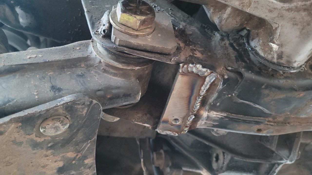

    Wasn't quite as successful of a weekend as I wanted. Steering rack proved to be way more of an issue than I though it would be.
    When I though the bolts came lose on Dusy, it was more than that. The tack welds on the nut (bottom) and bolt (top) of the bracket (passenger side) bolt broke. That was a bitch.
    Ended up having the re-weld the bolt... that bitch is not going anywhere. Those aren't tack welds any more. I had to weld front the bracket mounting surface side and then counter sink the bracket to allow the weld bead to nest in it.
    Then I cut an access hole to get the (tacked) nut out, and allow access for the Grade 8 nut and spring washer. So the bottom of the bracket is now Grade 8 nut and bolt.
    Rack bushings were replaced while I had the rack lose. Even with 100,000 hard miles, and the rack coming lose on one of the hardest trails in CA (with it being lose for a couple miles until I figured out what the sound was) the only (Energy Suspension) bushing that was really bad was the band bushing, under the bracket... with the problems with that bracket, it was obvious why it was bad.
    Also got the tires rotated... and re-fabbed skid mounting points. I drilled out the front 2 that have the nuts tacked inside the crossmember. (mine were both broken long ago) then welded in Grade 8.8 flange nuts. The stupid tabs, at the rear LCA mounts, that are barely thicker than sheet metal with nuts tacked to them were replaced by 1/4 thick by 1 inch Flat bar drilled with a Grade 8.8 flange bolt pressed through it and welded on the back side.

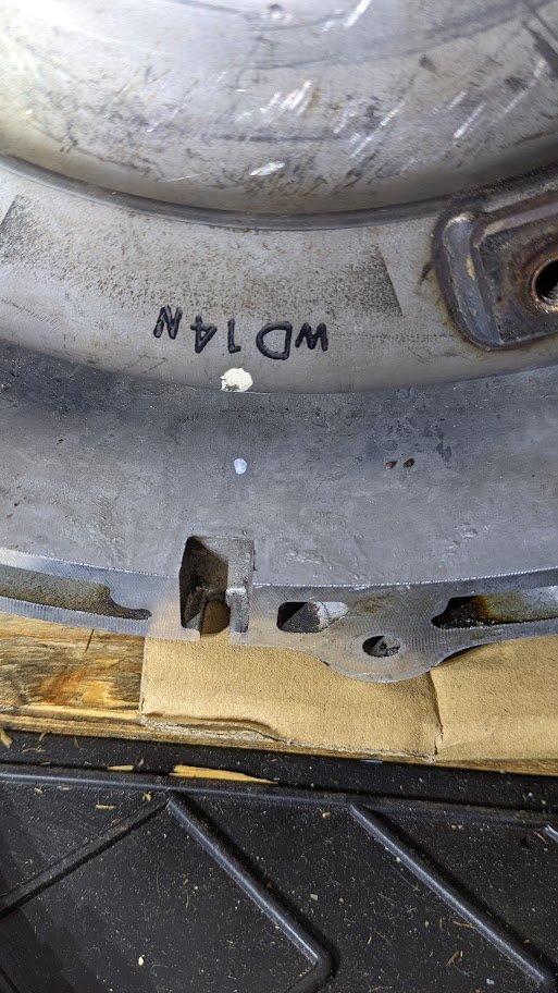

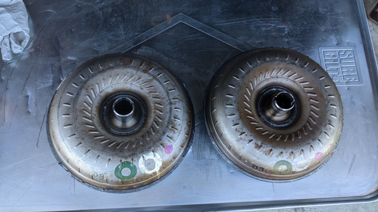

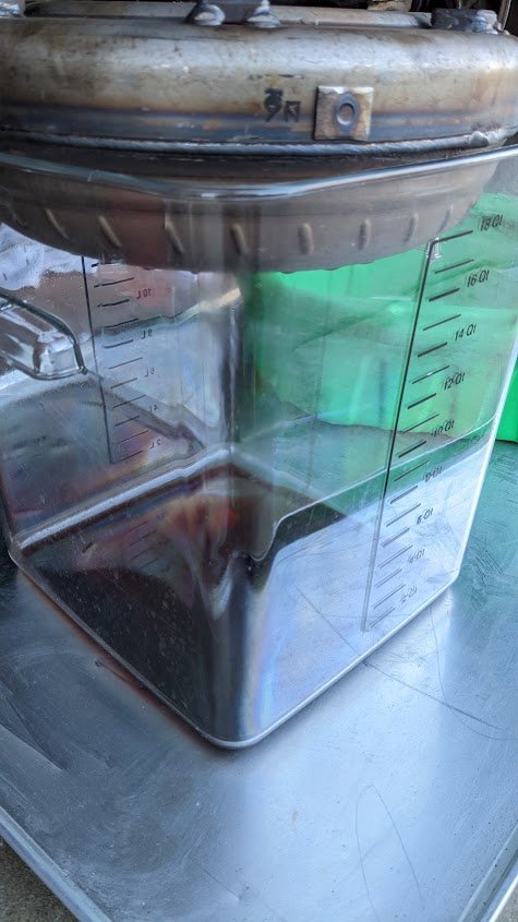

    Torque converters... yay. Drained a little less than 2 quarts out of the prerunner torque converter. The torque converter from the A340F transmission was drained before shipping, nothing in that one. Going to have to 'fill' it before installing the transmission. EDIT: I was able to get roughly 1 qt into the TC, Maybe 1/4 of it came back out when I was trying to reinstall the TC. As long as you have some fluid in there, call it good.
    Wanted to note and share, if removing your torque converter for whatever reason - get a mark on it and the bell housing. This will help big time in getting it lined up and back on the transmission. I didn't mark the A340E and stll messing with trying to line it up. PITA to get it to seat fully. This can help also - watch it.

    I've put a lot of torque converters in, push and turn, shake back and forth, push and turn. Last thing you hear will be a more clunk of the converter seating in the pump gear. Should be three clunks, make sure it is seated all the way before calling it good, if you don't seat the last one, you burn the trans out cause the pump won't be engaged.

    3 clunks for sure... thx:thumbsup:

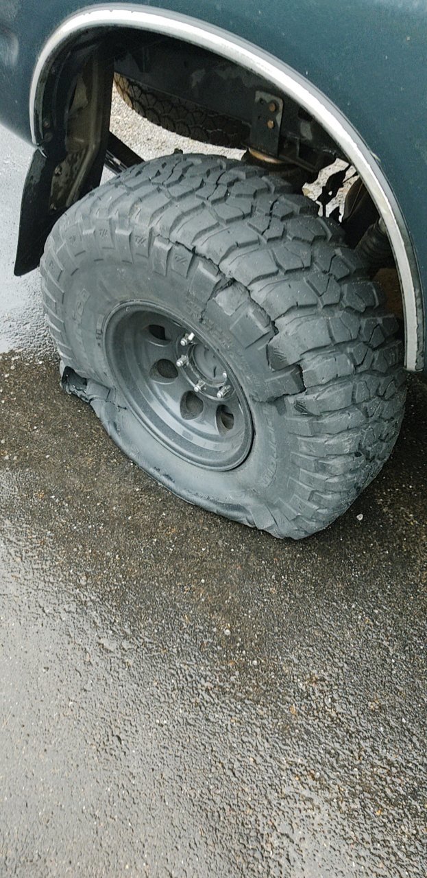

    Yesterday I replaced my master and slave cylinder, it drove like a dream up until this happened on my way back from lunch (during the first big downpour we've had this season). Now do I look for one KM3, or do I switch all four to ST Maxx/Falken Wildpeak?

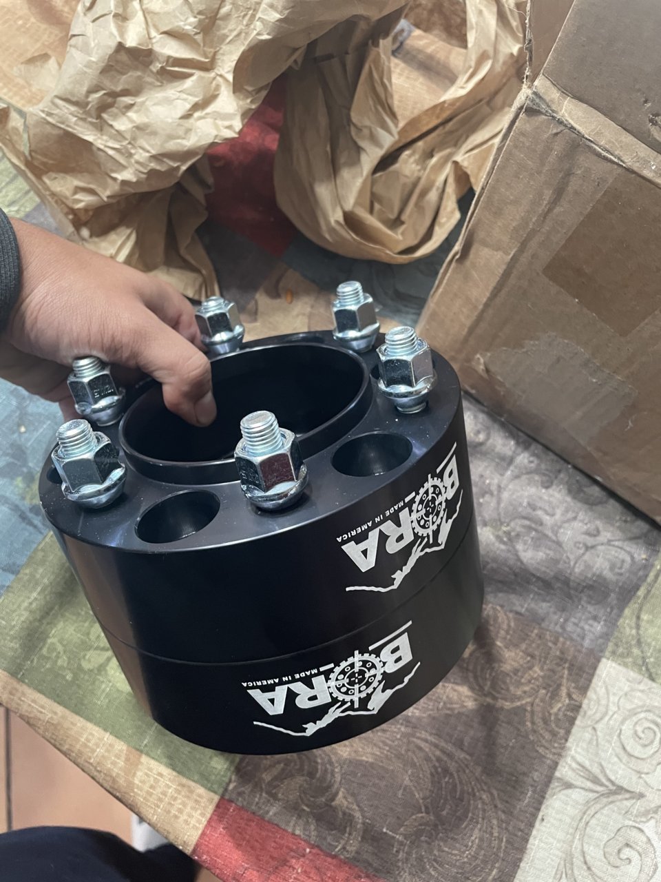

    A member here was nice enough to give me a smoking deal on these BORA spacers that are brand new!! Gonna mount them up soon :cheers:

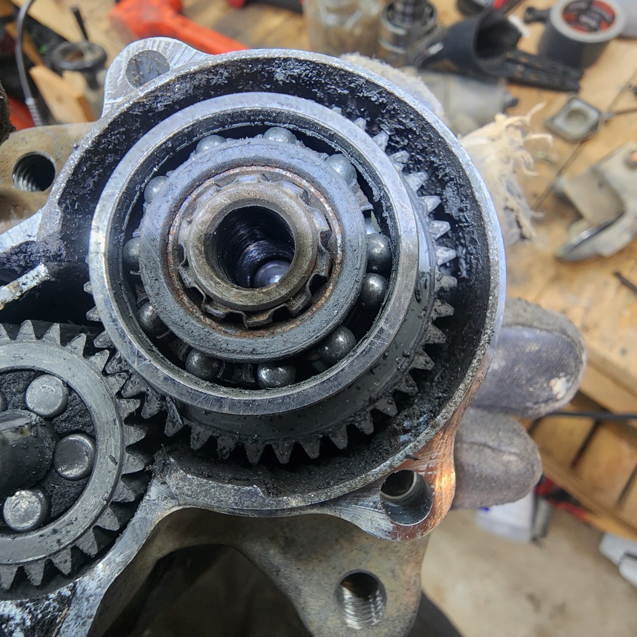

    Just pulled mine apart. Found a bearing with half a race. I'm kind of surprised that it doesn't look worse after being flooded and using it to climb obstacles that the engine could not. No sign of heat discoloration on the gears. 20221024_194607.jpg

    When filling an empty torque converter, about how much should be expected to go in? I had nearly 2 quarts drain from the prerunner TC and with the 340F (which nothing drained out), it seems that it doesn't want to take more than 1qt. Just call it good? Thx!

    you can never really get them fully drained. i'd put 3 quarts in, when the transmissions in, fill the thing till its up to the hot mark high. then adjust once its running.
