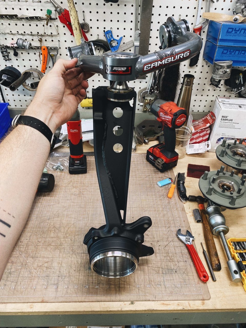

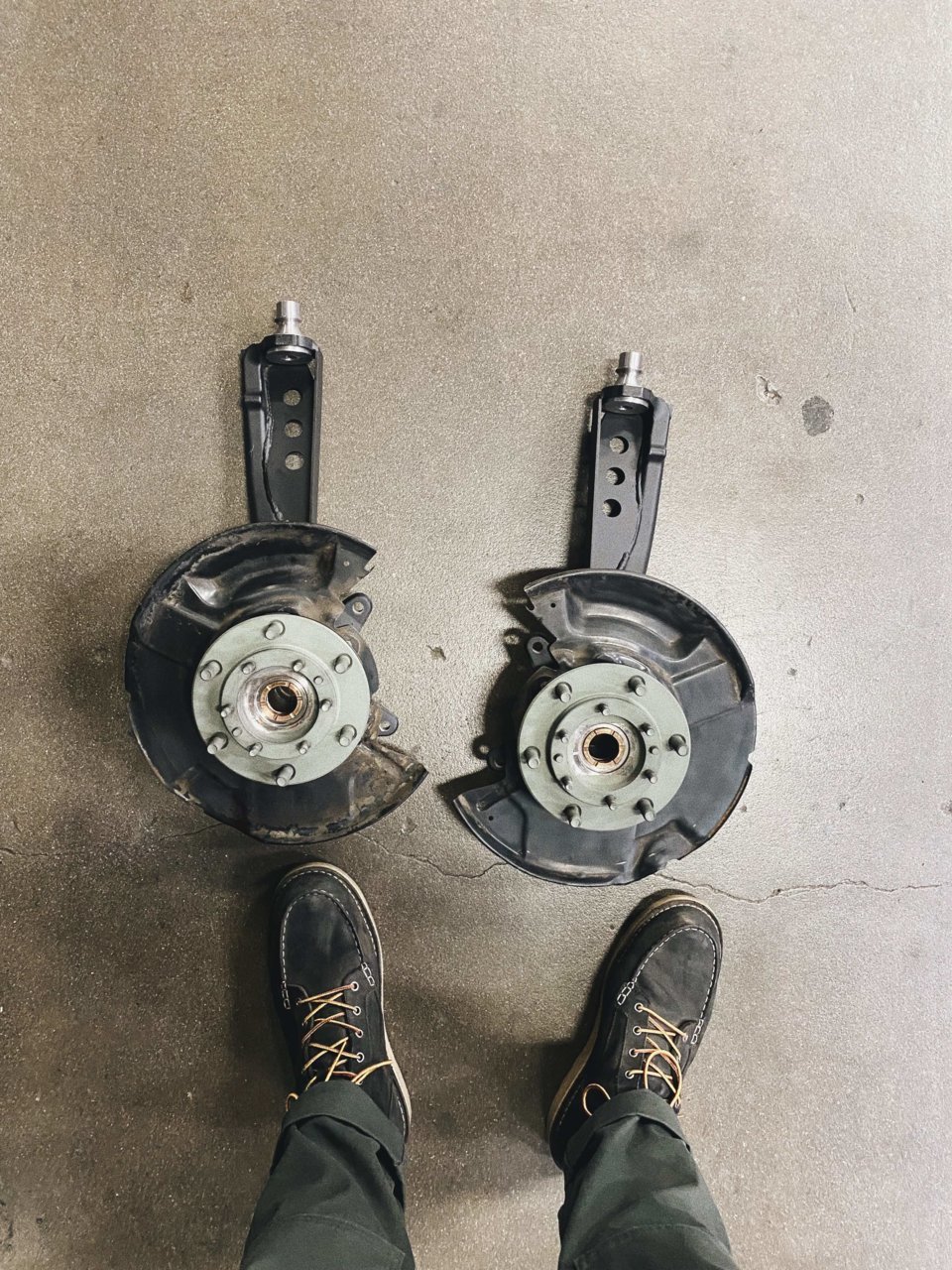

    Built some spindles for a soon to be had lift and 4x4 conversion...

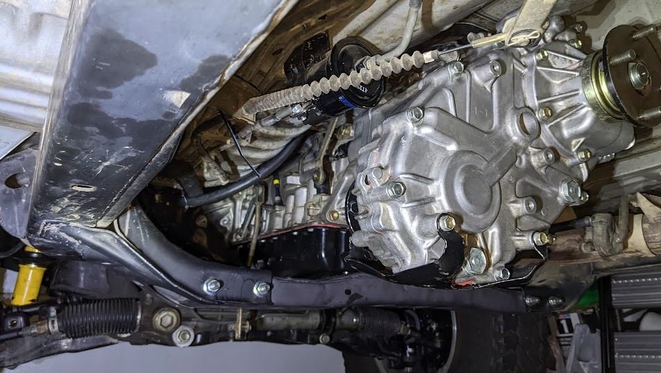

    Another swap update... played 1v2 with the transfer case/transmission jack today. Finally was able to mate up the transfer case. I never, ever want to take that damn thing back down. I don't know if its the position switches I put in or if its just normally a pain in the ass to tighten the top two bolts (tcase to trans) but that was :rant:. Hardly any space to work in and without a swivel on the end of an extension, I'd still be out there trying to tighten it up.
    Tomorrow connect the trans cooler lines, reinstall the starter, fill the transmission/transfer case and connect the drive shafts and call it done.
