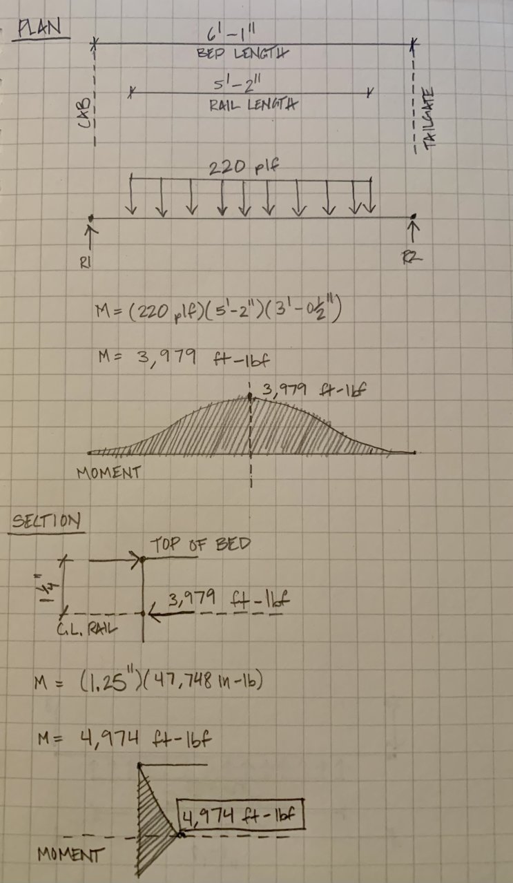

    @Area51Runner they are bolted up with M6 stainless steel rivnuts and each rail has 5 M6x1 torx bolts. It’s plenty strong for how I am using it, but I will certainly follow up if I start seeing any deformation. The bed cleats are spec’d to hold 110 ft-lbf. The rail helps to distribute those concentrated loads into a uniform load along the bed. I took a swag at calculating the max moment, but without some kind of sheet metal table I’m unsure how to calculate the allowable bending stress since it isn’t a structural shape. Maybe somebody on here knows, but I came up with a max moment of 4,974 ft-lbf based on two bed cleats taken to failure at 110 ft-lbf each. My methodology at first pass was to treat the drilled surface in plan as a beam and find the moment then use that moment as a concentrated load in section to find the overall max moment on the double walled sheet metal.

    Looks like you really planned it out and looked at the same concerns. Nice work! Will be interested how it holds up and the use you get out of it. :thumbsup:

    What part of the bedrails are you thinking won't support the weight?

    Not the bedrail itself from weight on top (i.e. bedrack for RTT, cap, etc.). I mean the flimsy inner portion of the rail and pulling at it from the side. Some of our 1st gen beds actually had holes along the inner 'lip' the length of the bed. Horrible example picture below - the carperting is my cap and below is the under the rail bedliner. Gives you an idea what I was referring to. That thing is way thin. With the 2nd gen rail itself or unistrut running the length of the bed, I guess it would act as a brace (?).

    I think I'm following. Was gunna say, the top of the bed rail holds A LOT of weight, and takes some pretty hard abuse to boot.
