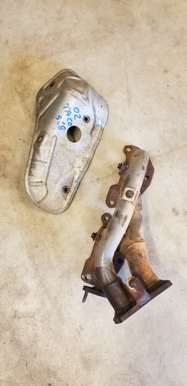

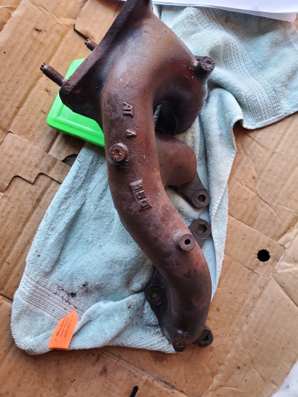

    When I brought it to the machine shop and they quoted me $175 for all 4 bolts, my first thought was this. :rofl:
    They ended up charging me $50 for the one bolt after quoting me $75-$100. I think the job probably took them less than 5 minutes, but whatever. The tool upgrades I ordered are yet another good lesson in why it's cheaper to buy the good stuff. :D

    It's less Tacoma and more mod
    When I worked in a machine shop I love broken bolt and stripped thread jobs, usually 10mins of work for $75 haha

    What brands of extractors would you recommend? I'm sure there's a lot of guys on here with broken bolts they're just ignoring cuz they're afraid of making it worse. :laugh::censored:
    Luckily, that was not the case this time, but I've been down that road before, so I knew when to say quit.

    My favorite extractor is a Millermatic 250 haha, but the old fashioned straight square extractors from MAC are the shit too.

    There's always the option of "upgrading" to the tubular style headers too instead of the factory cast ones.

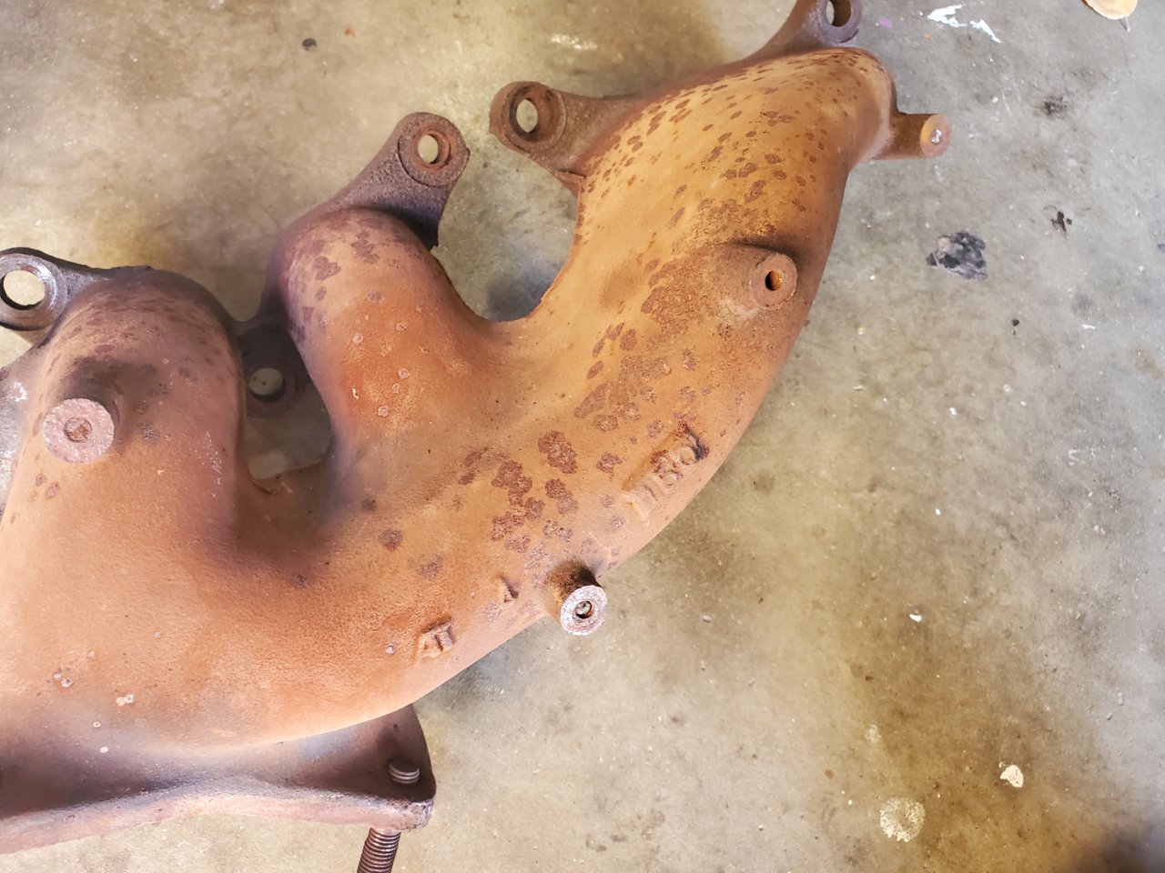

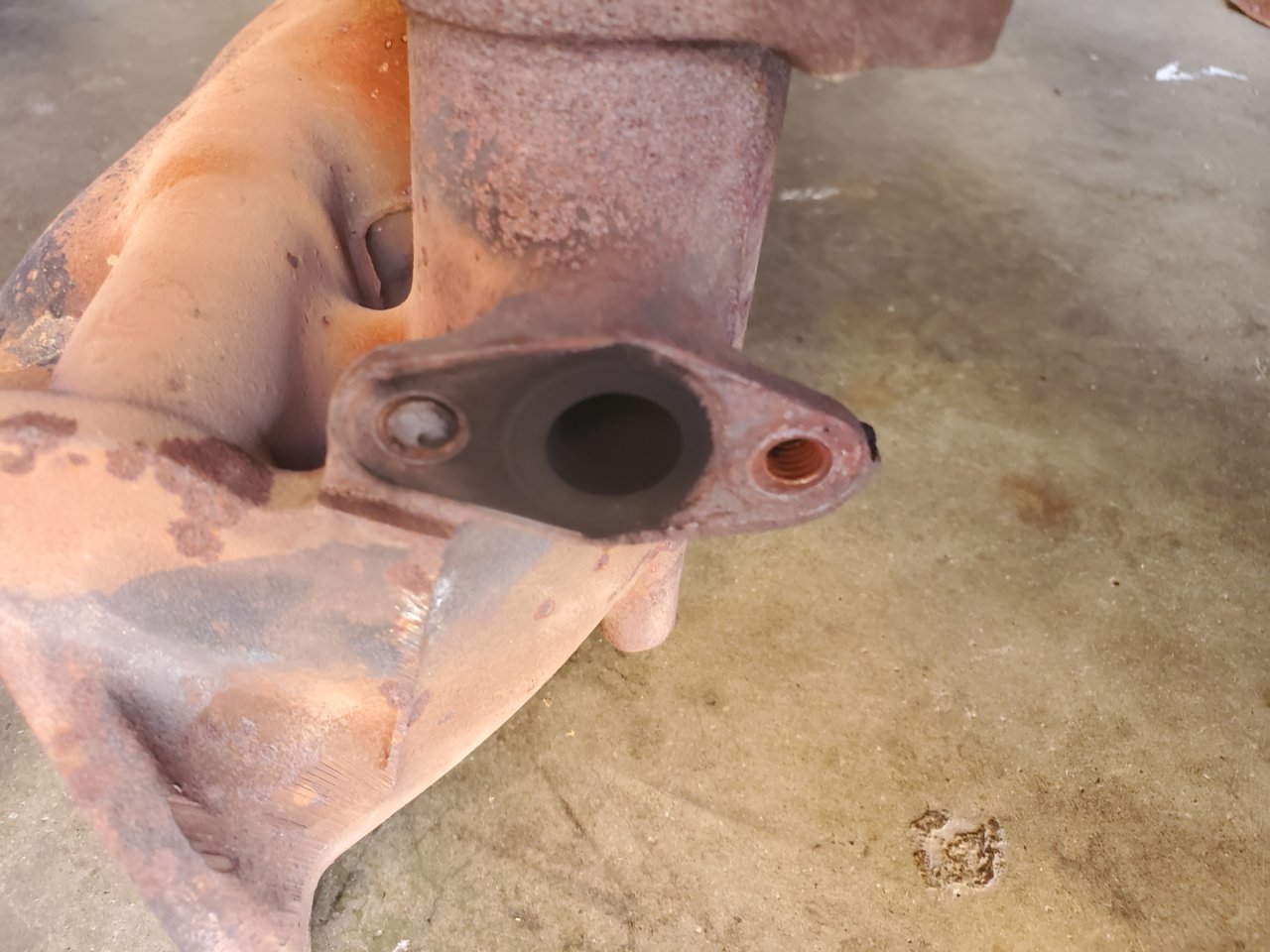

    My complaint with aftermarket headers is that they don't utilize the OEM support bracket that bolts to the bellhousing. I called LCE to ask them about that and their answer was "OEM is over engineered and ours doesn't need it" o_O
    I ran my OEM header without that bracket for a while and chased exhaust leaks endlessly. The engine would twist around under load and then the forces would get translated into those exhaust joints and develop leaks.
    It actually loosened the rear most stud on the cylinder head exhaust manifold mount to the point where the threads are pretty fucked now. I have the fear that if I take it off again, the threads will pull out on that stud and then I'll be screwed.

    Maybe that's why I had a burnt out gasket :rofl: When I bought my truck that bracket was just rattling around loose, and I probably drove 20k miles before I got tired of the noise.

    Ya that would be my guess. Same thing that happened to me.
    The black spots are where the exhaust was leaking. Both on the cylinder head connection, and on that top donut gasket

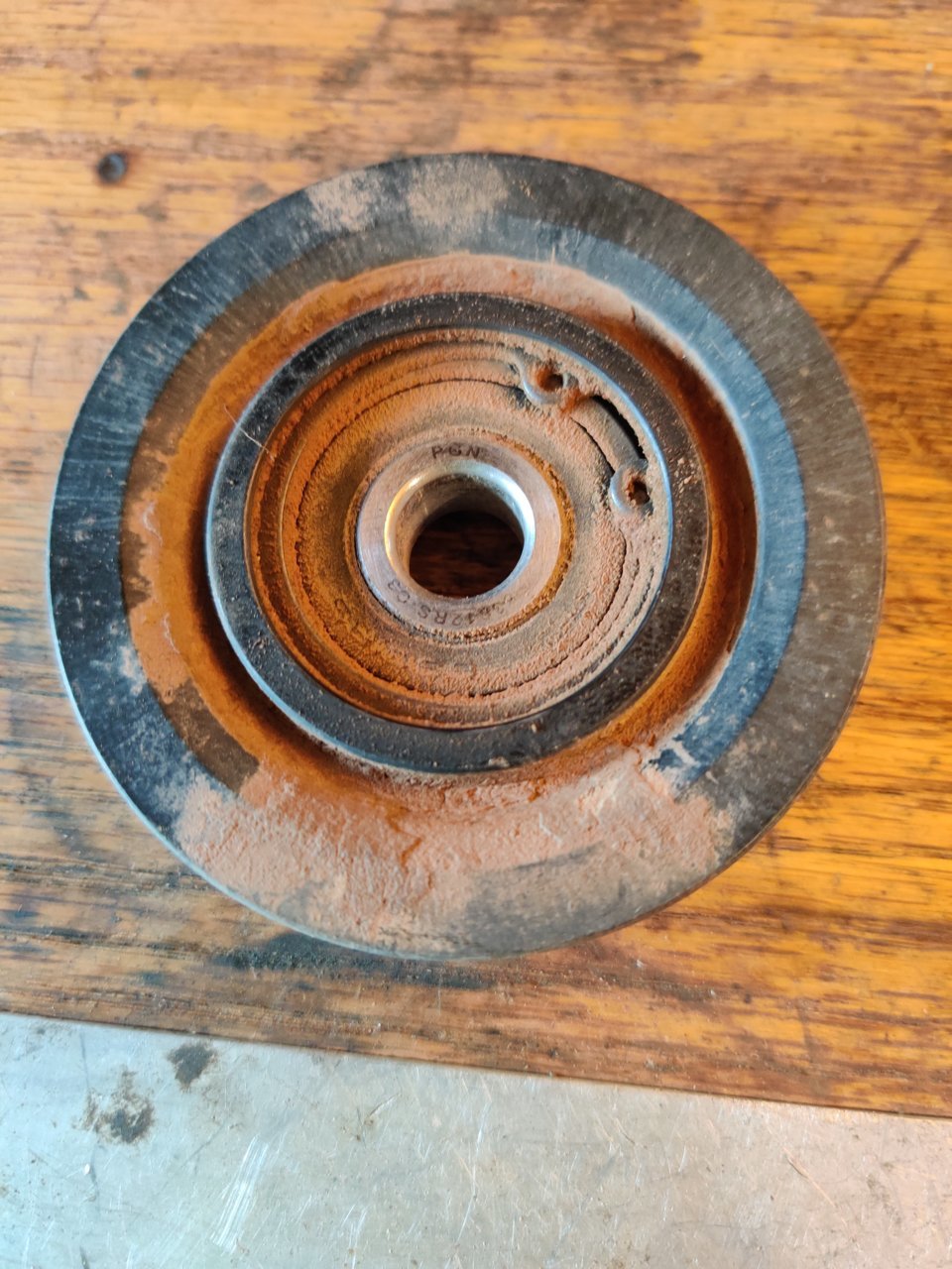

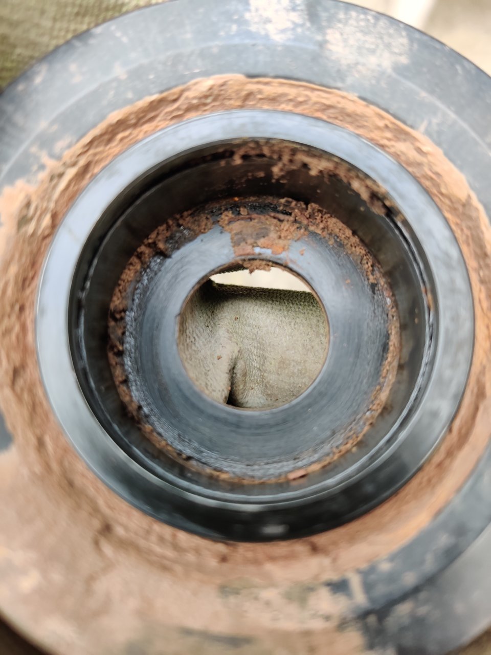

    Replaced the bearing in the idler pulley today. That damn Moab mud gets into everything.

    What kind of lifetime are you getting out of your idler pulley bearings?

    This one lasted about 20K but it can vary quite a bit. It depends greatly on exposure. Similar to seals, that bearing is vulnerable to mud and muddy water crossings.

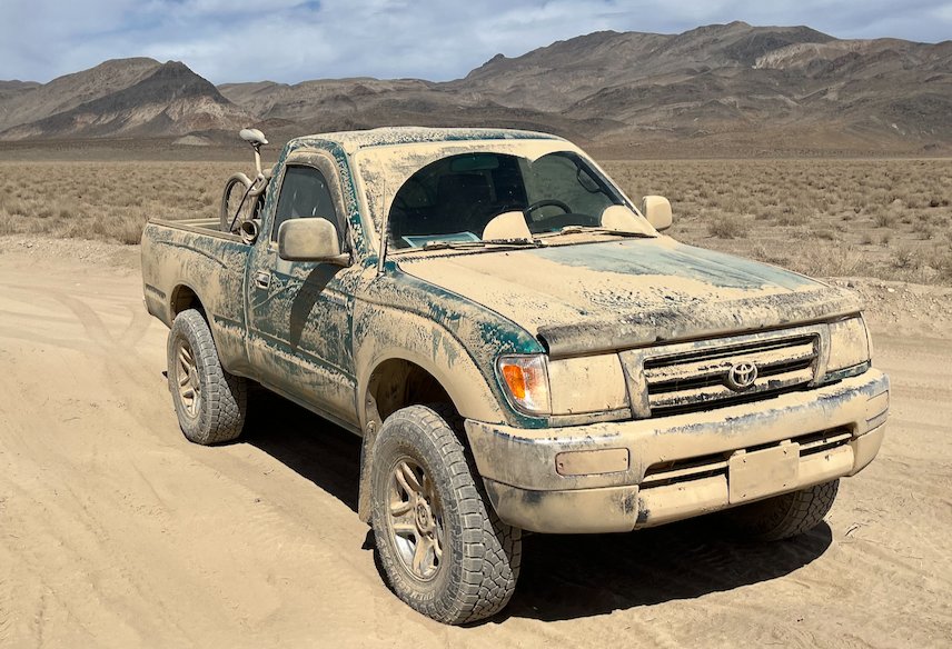

    I think my Death Valley dust will outlive the truck...

    Something sexy about regular cabs covered in dirt and mud.
