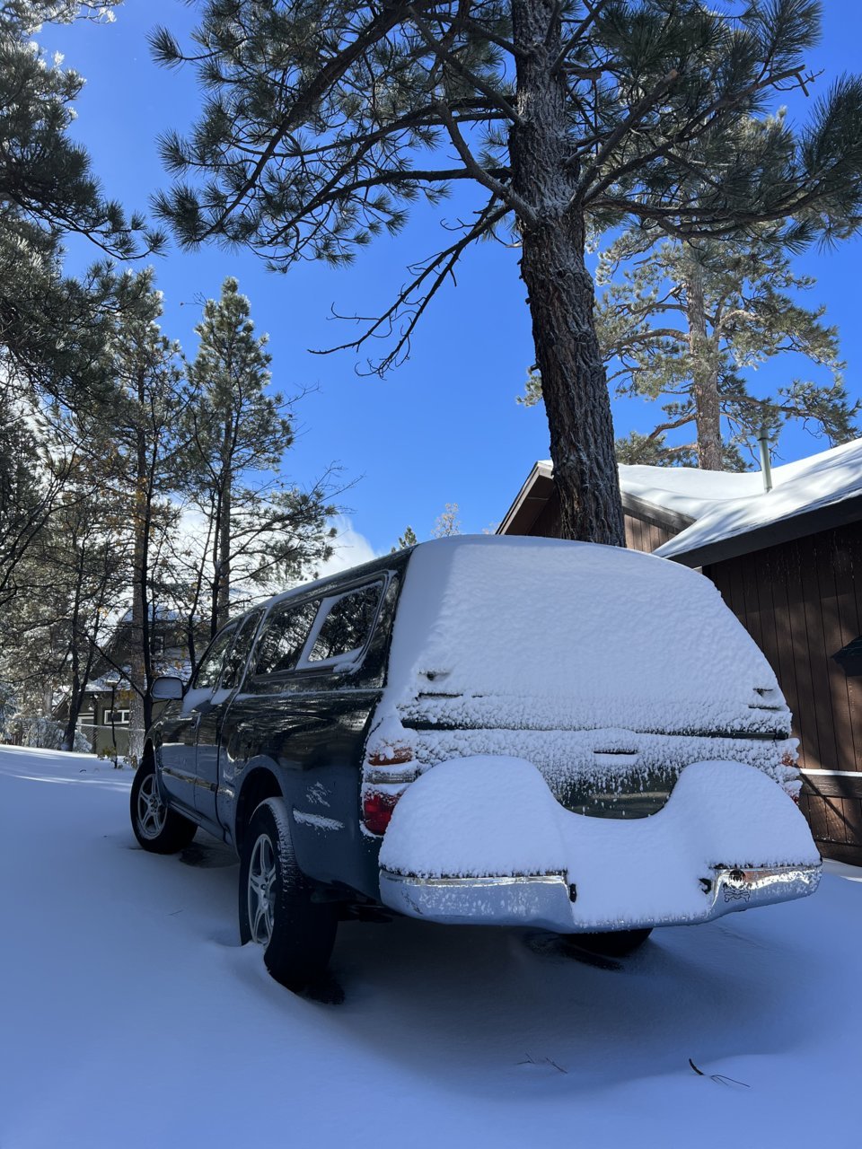

    2 weeks in my possession and just arrived home from a successful Big Bear trip. It got the full on sun, rain, snow treatment for its’ 1st outing.

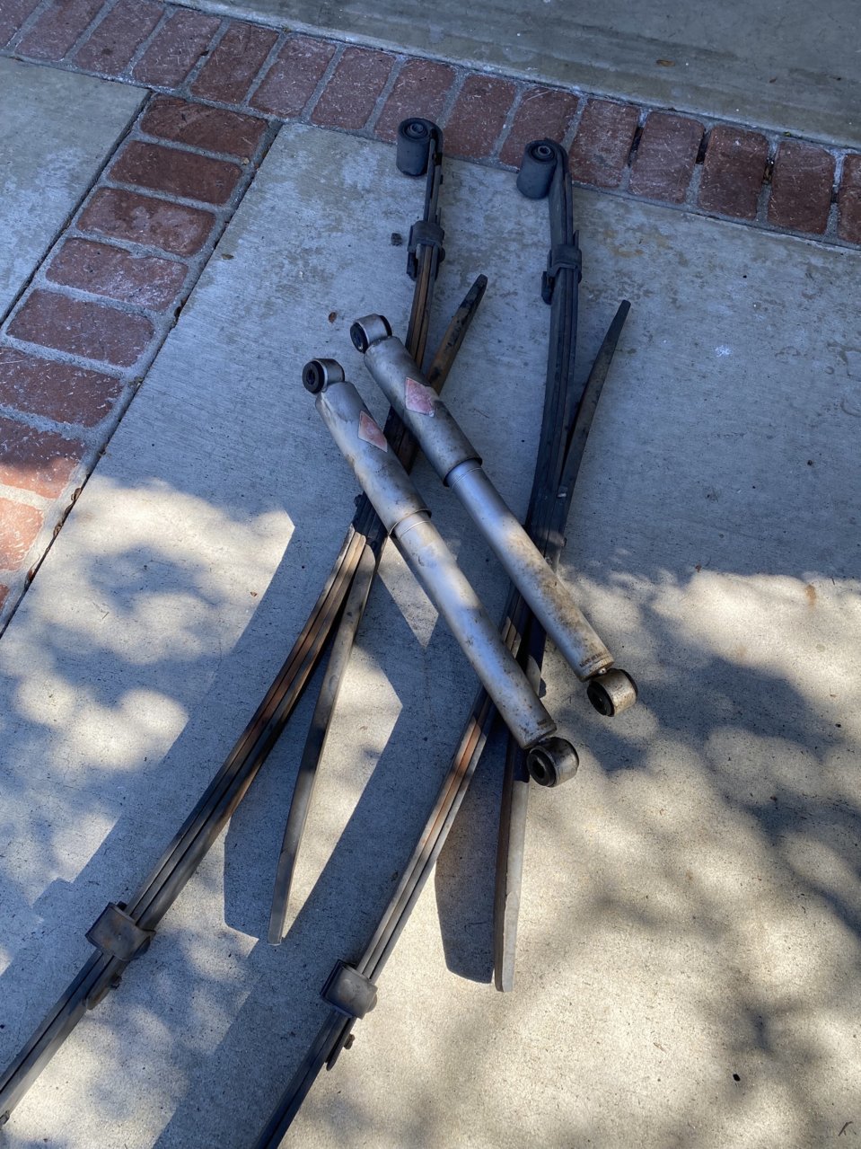

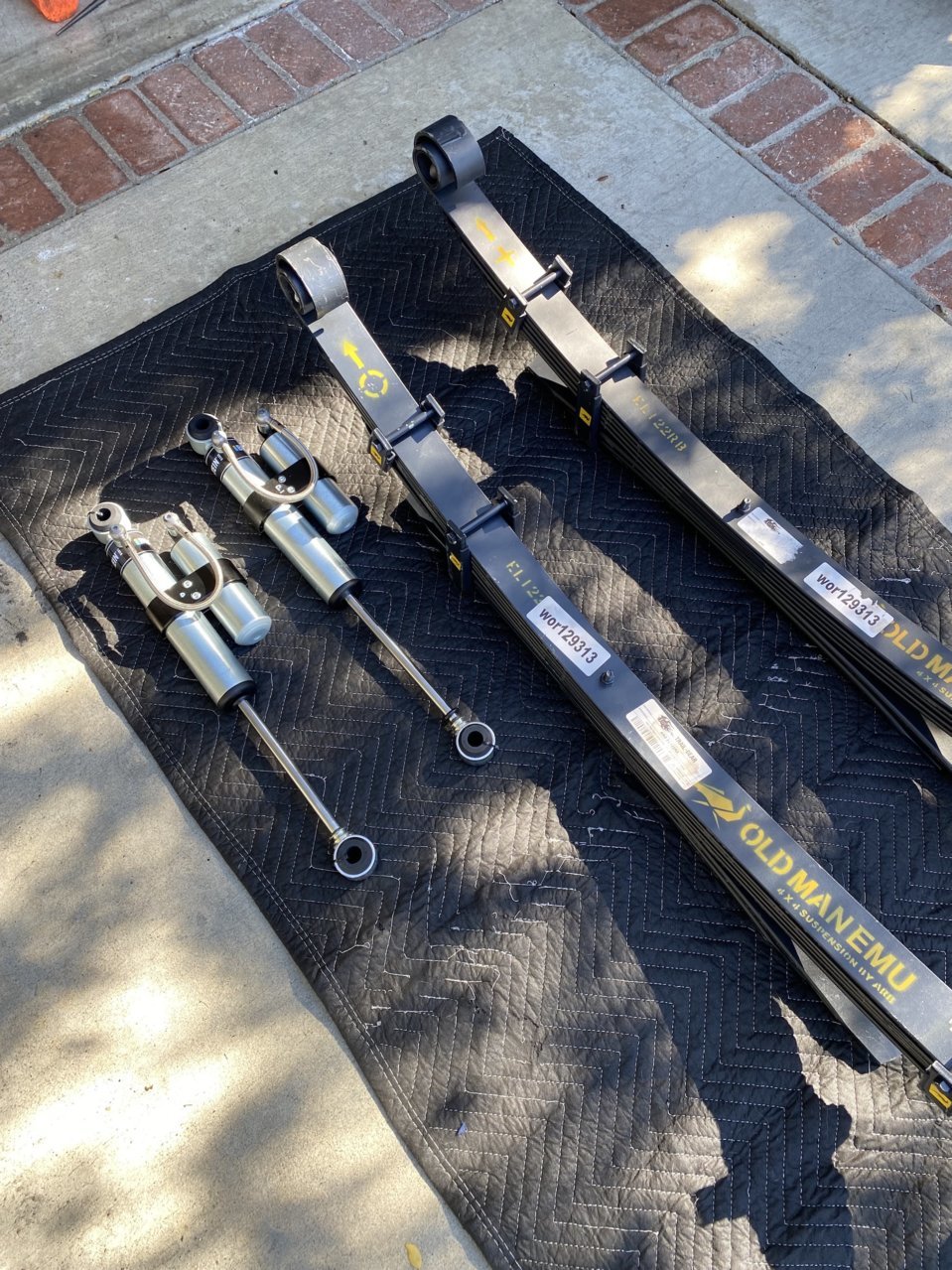

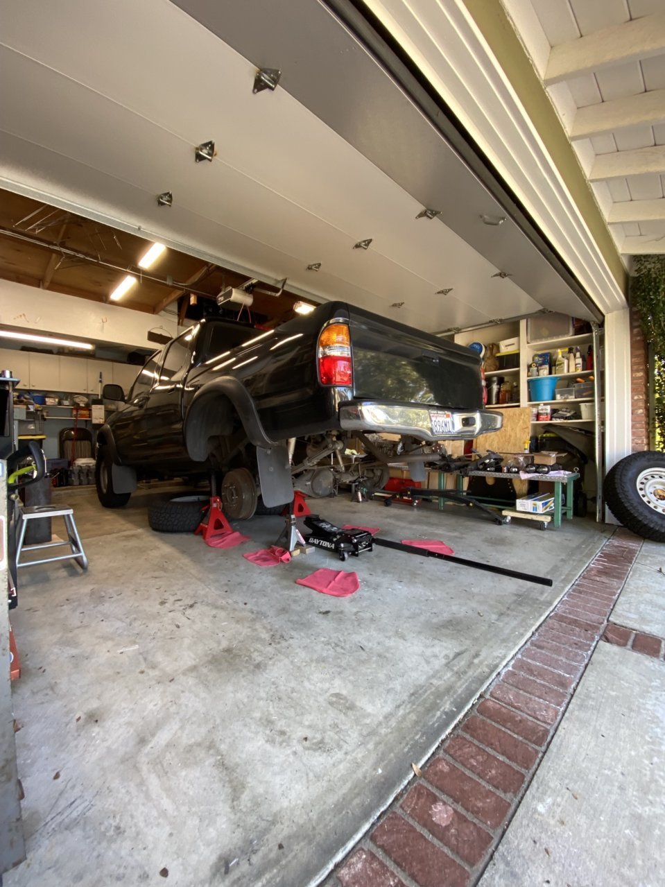

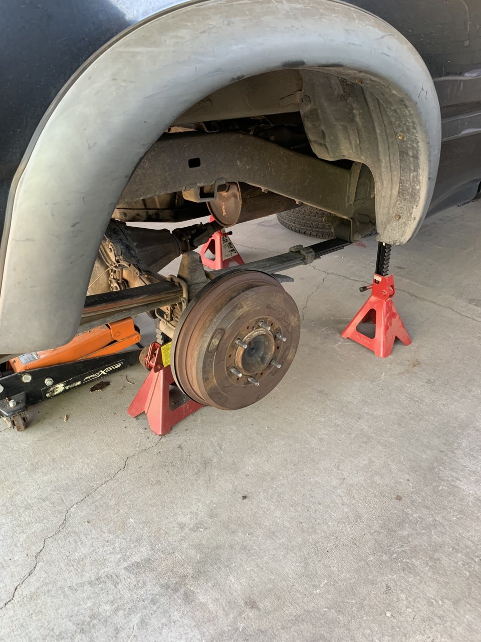

    Out with the old and in with the new.
    Been hoarding parts for too long. So, today I installed Dakar leaf packs, Bilstien 5160s, OME bushings / grease-able shackles, extended brake line, duro bumps. Excited to refresh this 20 year young truck.
    Next up - front end.

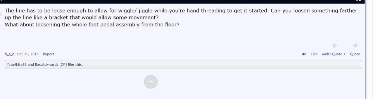

    Working on finishing up the swap today. Have 1 of the 2 transmission hard lines threaded and snugged up, the shorter line is being difficult. Can't seem to to get it threaded. Last thing I want to do is cross thread that thing.
    Found a similar post (hard line to master cylinder) and going to try giving it a bit more wiggle room and see if that helps.

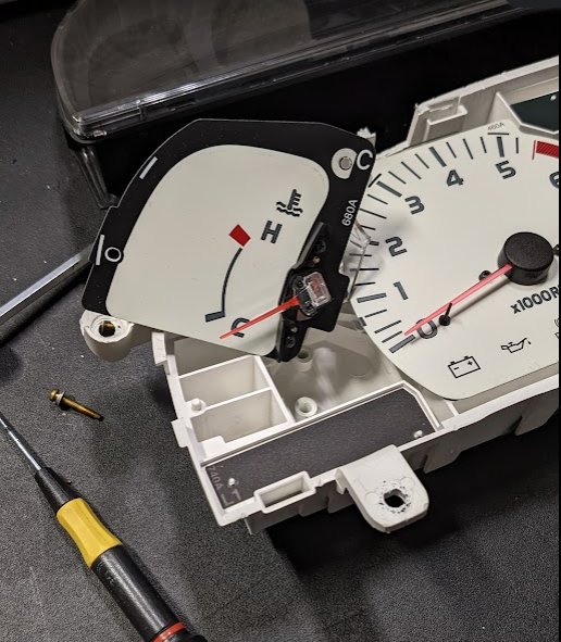

    Also, something is up with my cluster... more to follow with that one. ;)

    Nice! I wonder how the 5160's would compare to Nitrochargers and how much (if any) it would alter rear height...

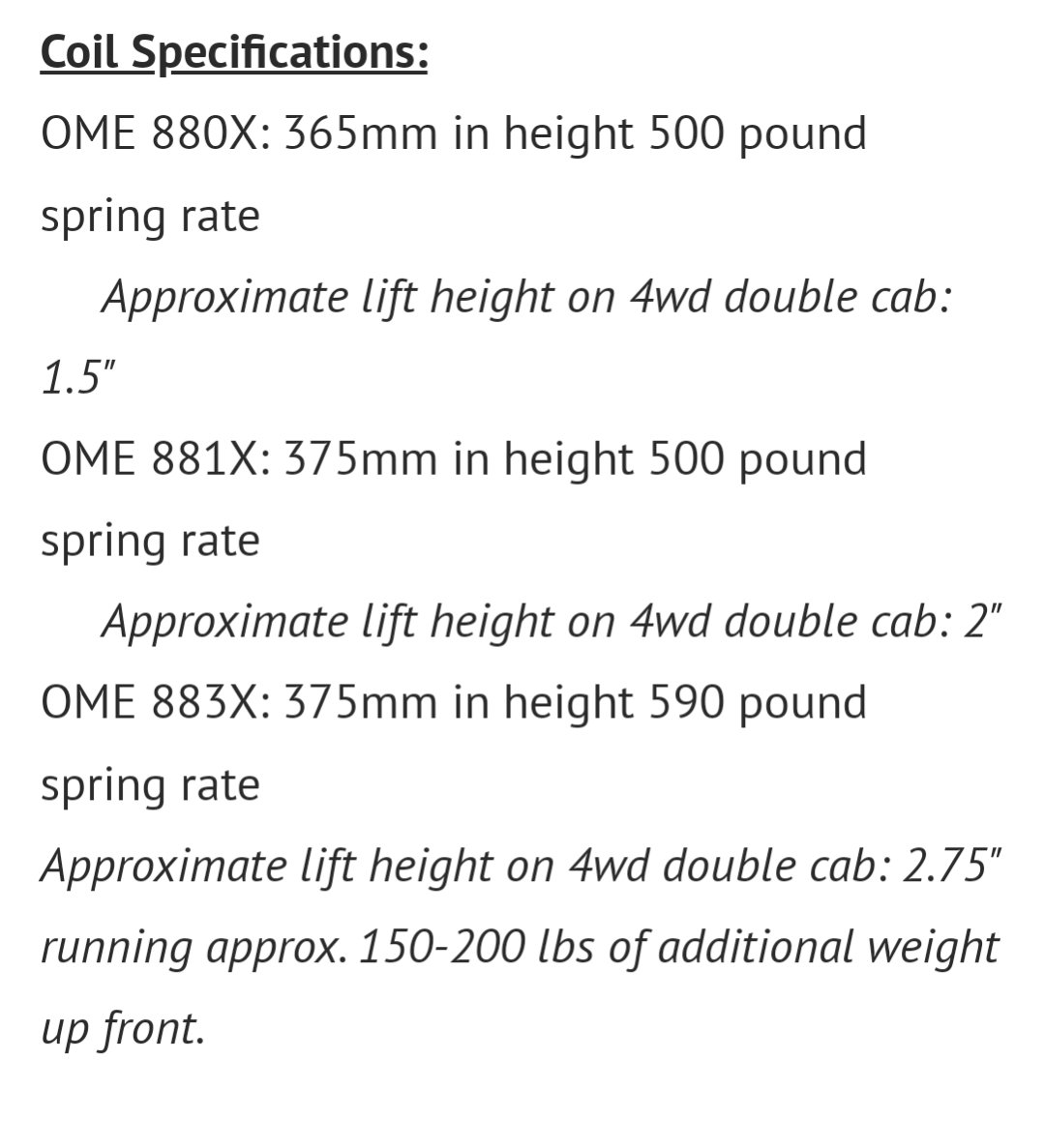

    883s are 590lb rate and same free height as 881s. 882s are taller but same rate as 881s which I think if I remember right is 550.
    Stock is 500.

    880-882s are all 500#, the 883s are indeed 590#. I can never seem to find reliable info on what the stock rate was, see some saying anywhere from 450 to 550
    (from Headstrong ORs website, they omit the 882s for some reason)

    This was from Wheelers site back when I was shopping for my OME kit ..

    I think it's 500. Just about every OE replacement is 500 I think.

    From Wheeler's website. OME coils.
    880-16mm dia. 365mm length. 500lb rate
    881-16mm dia. 375mm length. 500lb rate
    882-16mm dia. 395mm length. 500lb rate
    883-16.5mm dia. 375mm length. 590lb rate
    I found/posted this in 2017 when trying all three sets out. 881, 882, 883

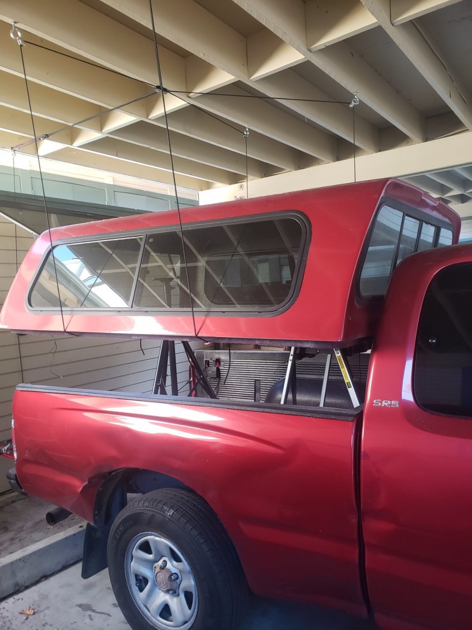

    resealed my shell.

    What did you use?
