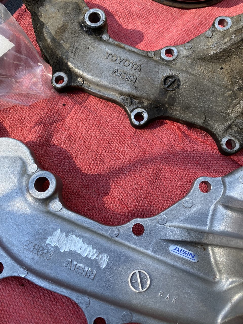

    Going through the process of replacing the front main and doing a few other things like rebuilding the oil pump and new water pump while in there. Here's the starter bump method for anyone who might be planning the same, super easy worked great.
    https://www.youtube.com/shorts/zwOoN6jg9GA
    Also found this funny... ordered the pump off Rockauto and its a Toyota part just scratched out.

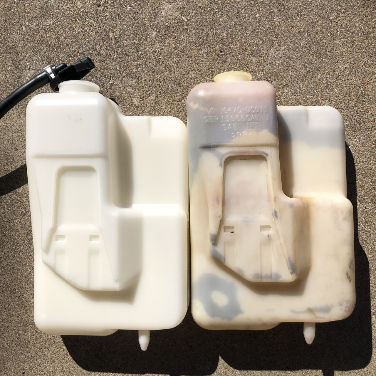

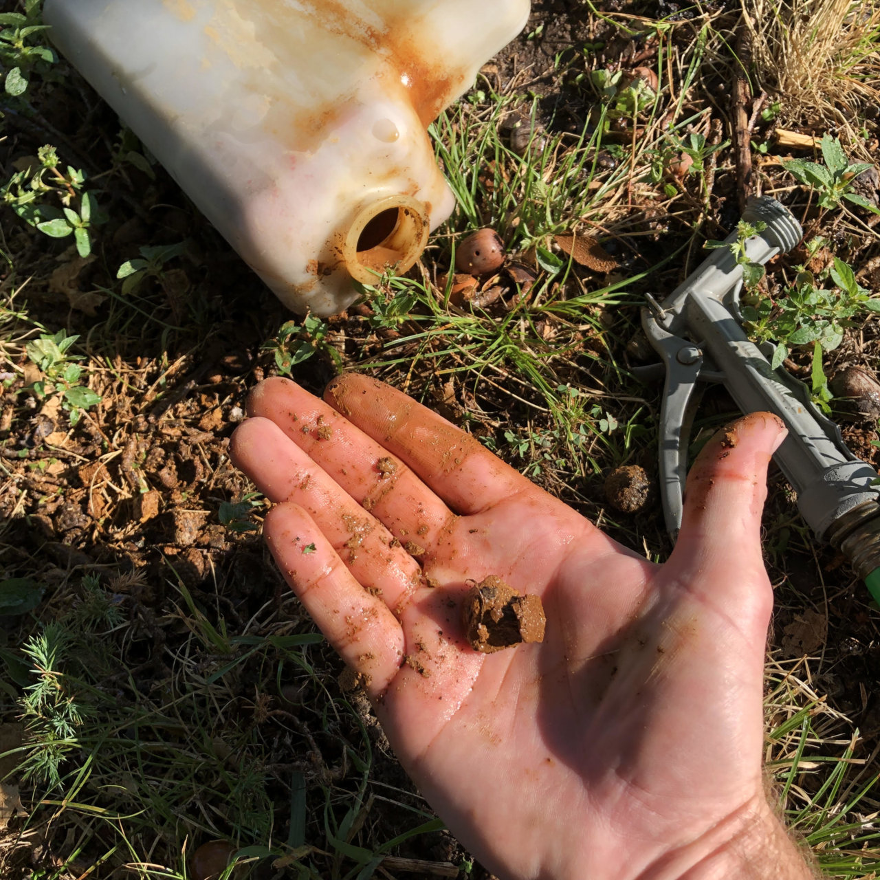

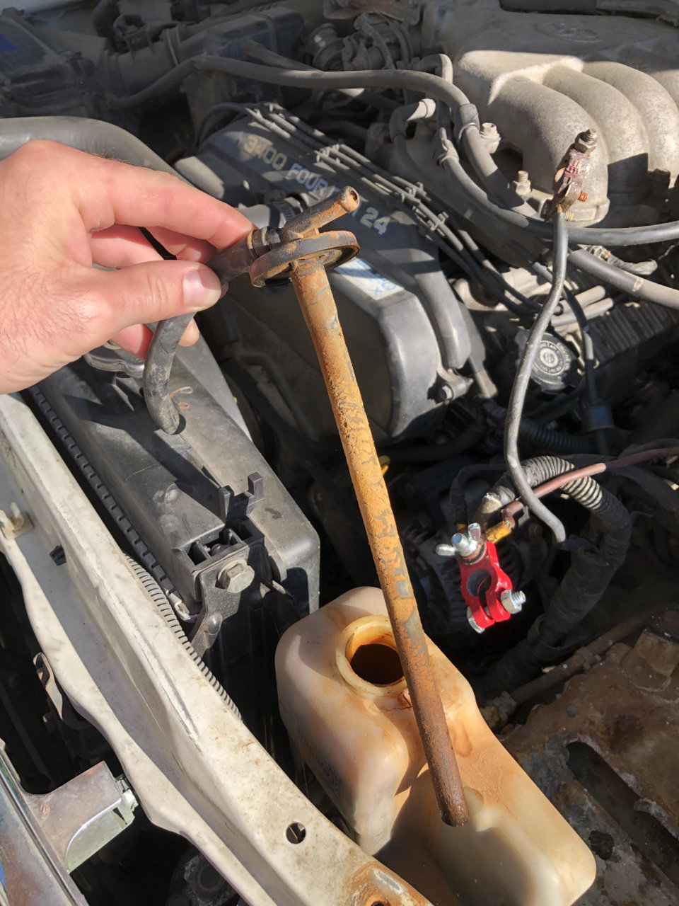

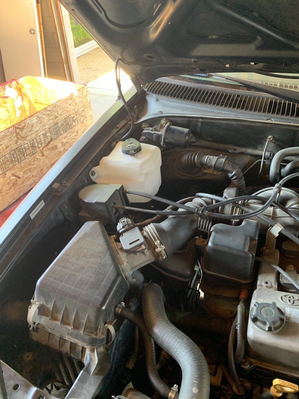

    thought I had already posted these:
    The guy I bought the taco from said he burned the motor up 70k back and had a "new" put in, no paperwork to back it up but Im guessing he in fact did overheat the motor and these are the remnants from that.
    I did a rad flush, about a full week of drain and fill, once with rad flush cleaner which stated good for rust, I have no idea what that is, could have been clay .

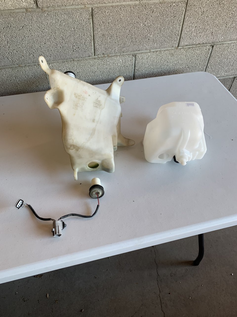

    I could not get the resivor clean so I bought a new one. once I got it installed I refilled with anti-freeze and finished this weekend and good timing too because we just got 25* temps over night.

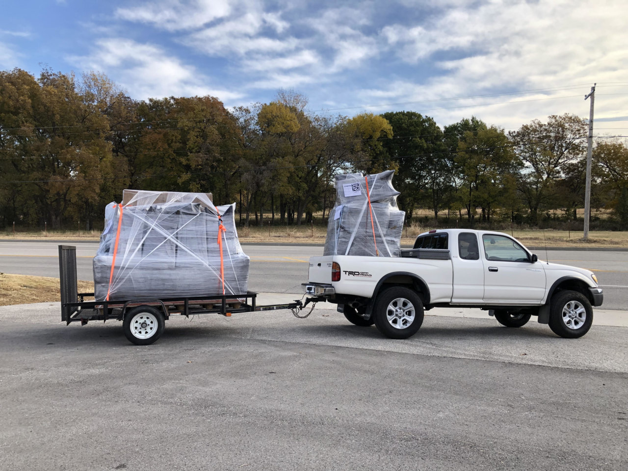

    one back log from about 2 weeks back
    I got a receiver hitch from FB marketplace for $70
    install:
    and then in the next week got to pull two trailers.
    one Im certain empty was the trucks weight limit.

    Best way I've found to clean stuff like that is to throw a handful of nuts, bolts, and washers inside and shake vigorously with your choice of cleaner. I like Fast Orange hand cleaner. I also put mine in with a load of dirty laundry so I don't have to shake it myself :D

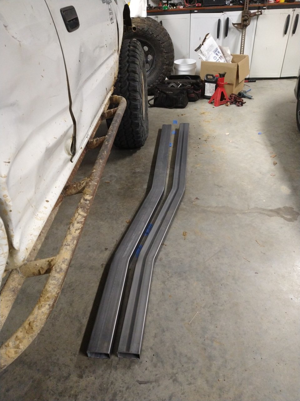

    Picked up my new rear frame rails today, only a a few more tools to buy, some more steel and some Chevy 63s and it will be time to cut the truck in half!!

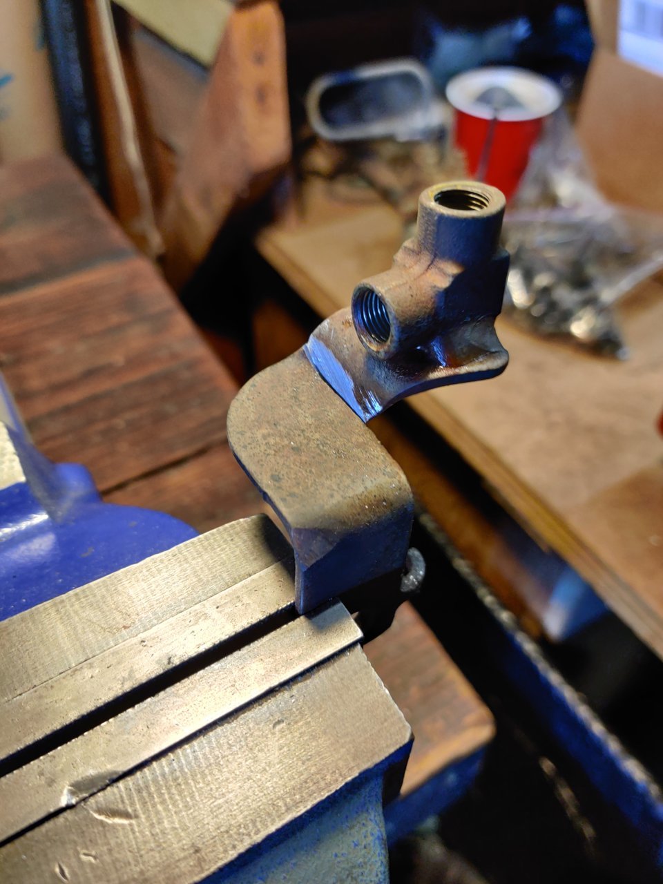

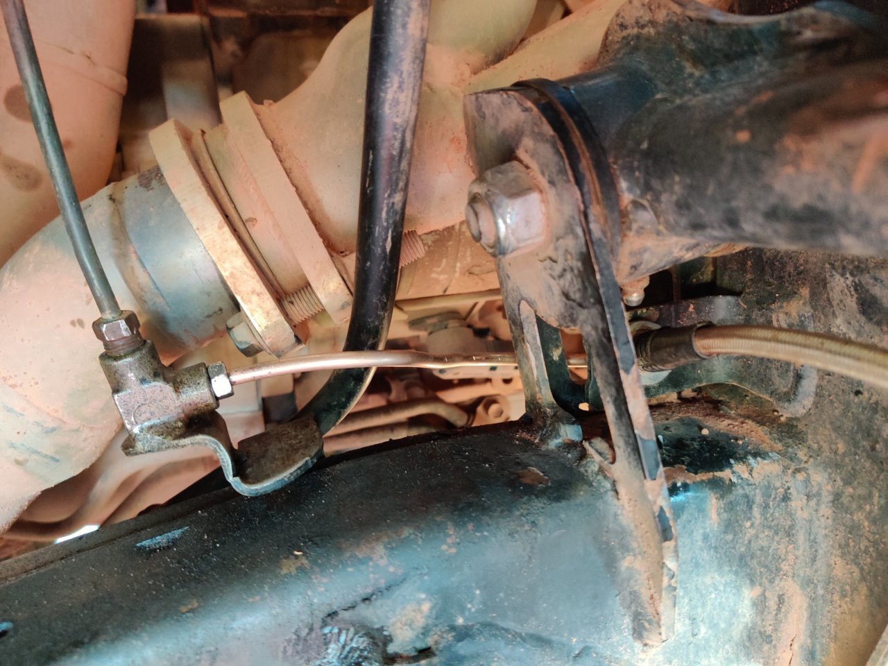

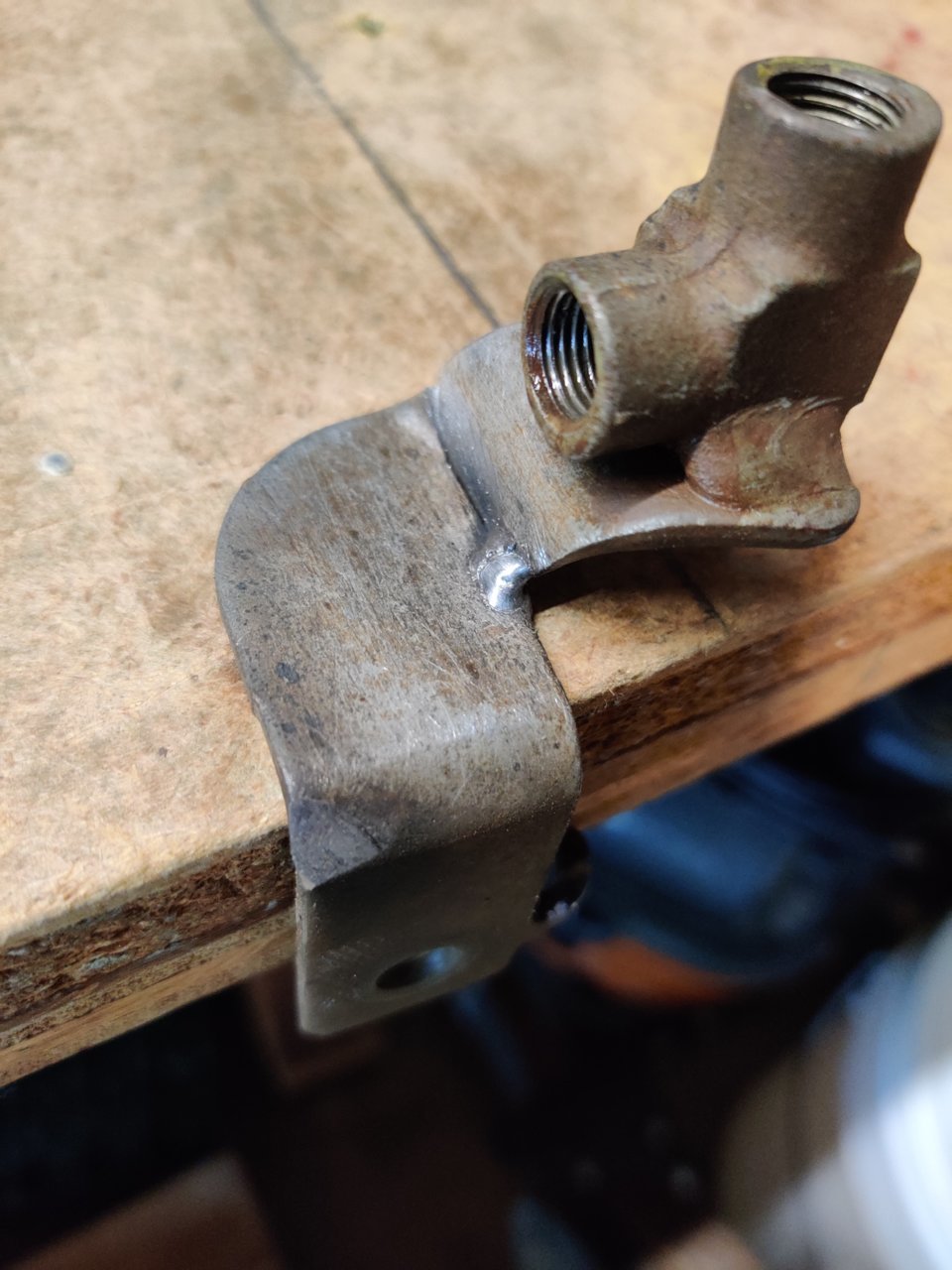

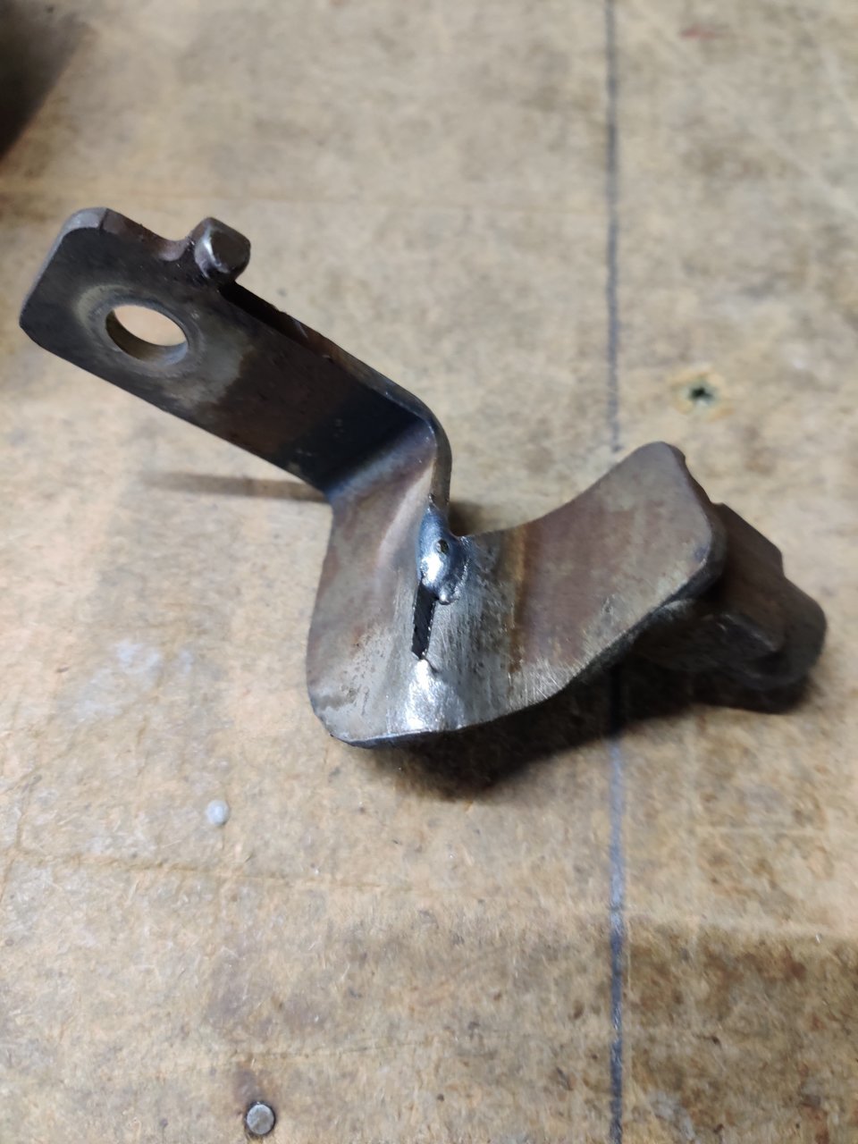

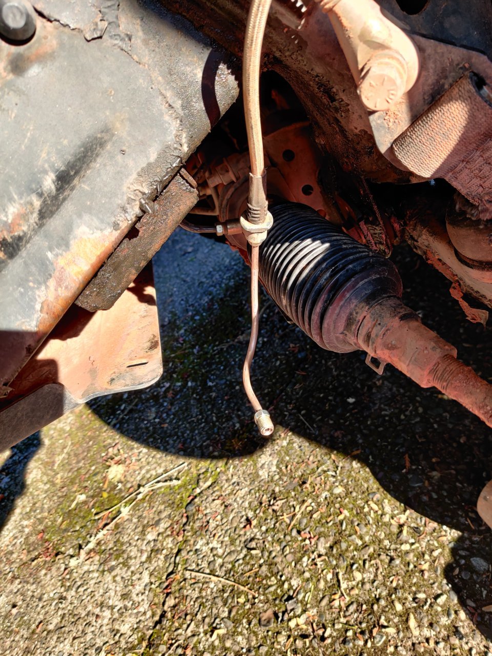

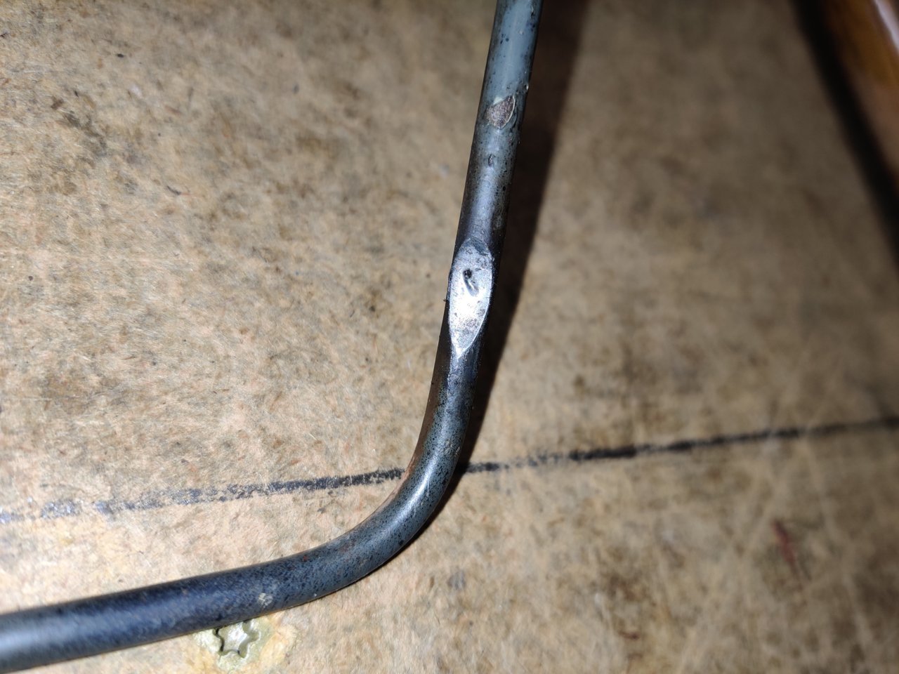

    With lots of help from Big Dan, we replaced a section of brake line today that I damaged when I was in Moab last week. Thanks for the help with this Dan. :hattip: @drr
    Had to modify the fitting bracket that goes to the passenger side brake caliper so the brake line could be routed away from the header collector.

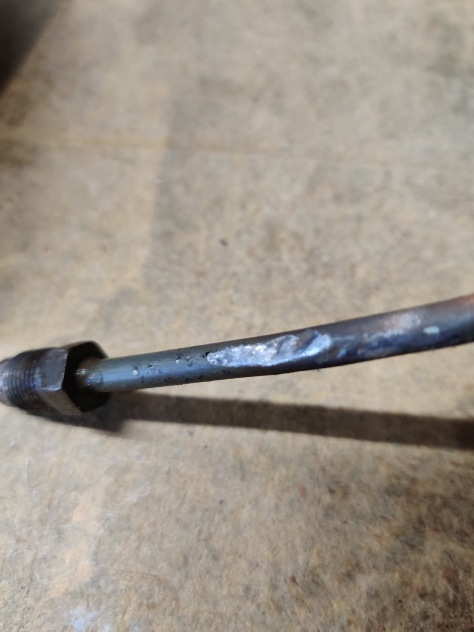

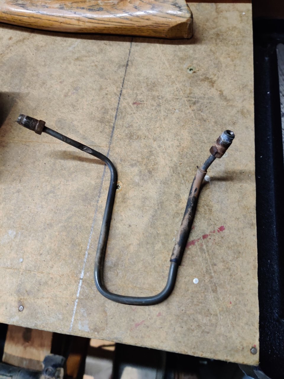

    Here are some pics of the old, damaged brake line.

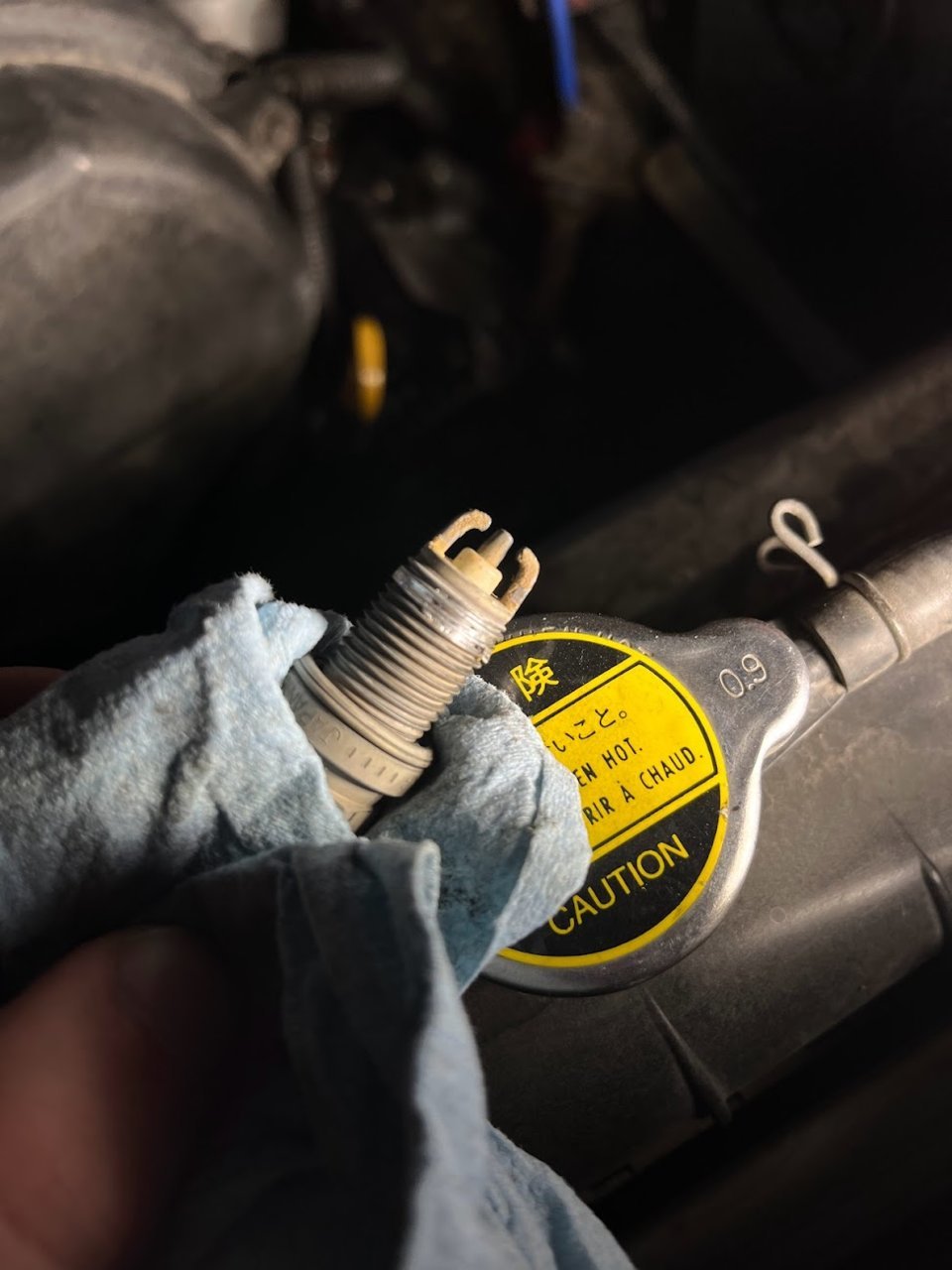

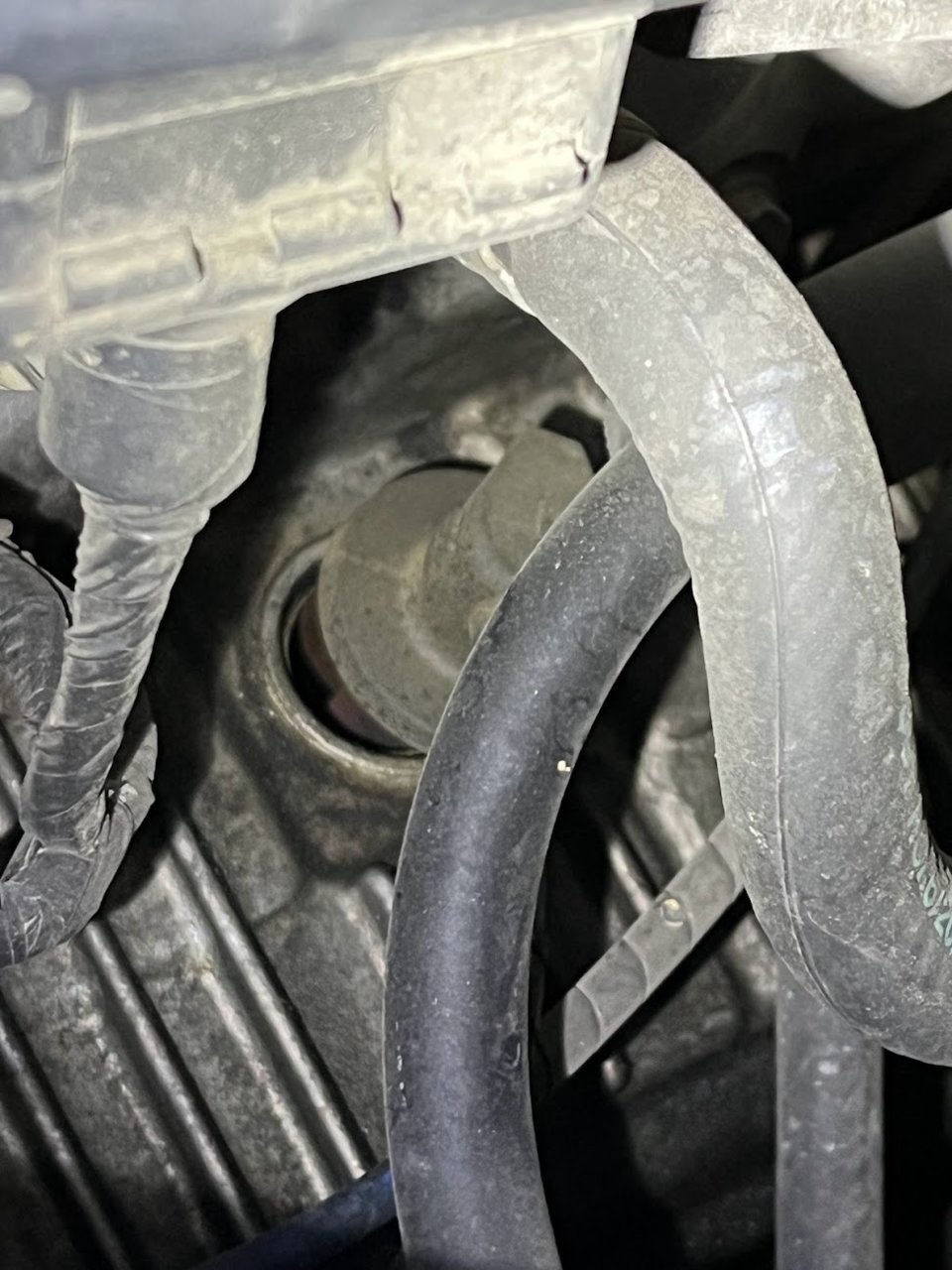

    Heard a knocking on my drive home the other night, got scared, turns out I just had a spark plug back out.
    Still need to chase the threads in the head and get a new plug back in

    It looks like the brake line got smacked by the header collector. The brake line was between the header and the dipstick tube.
