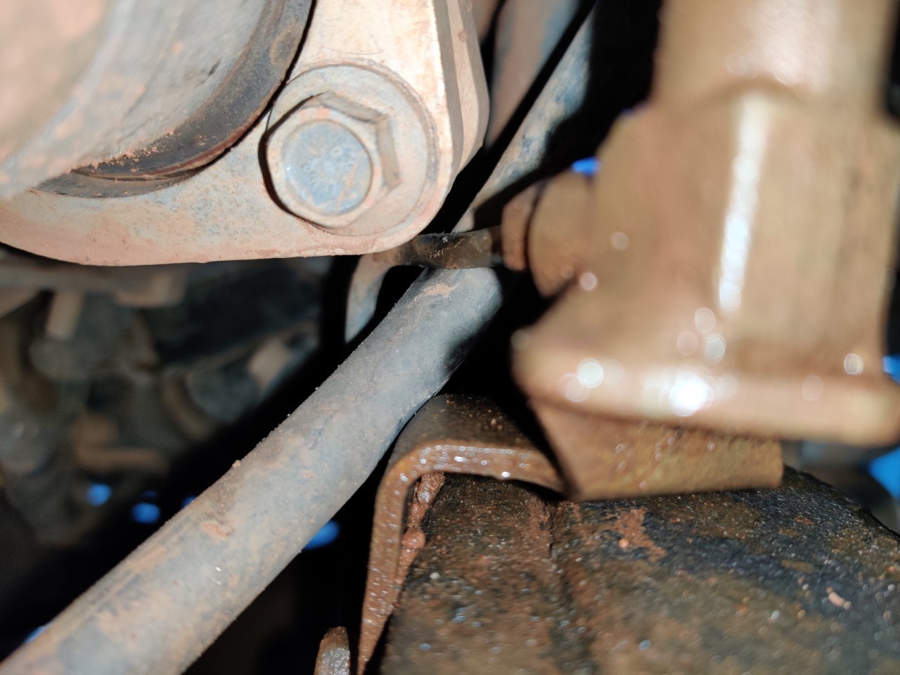

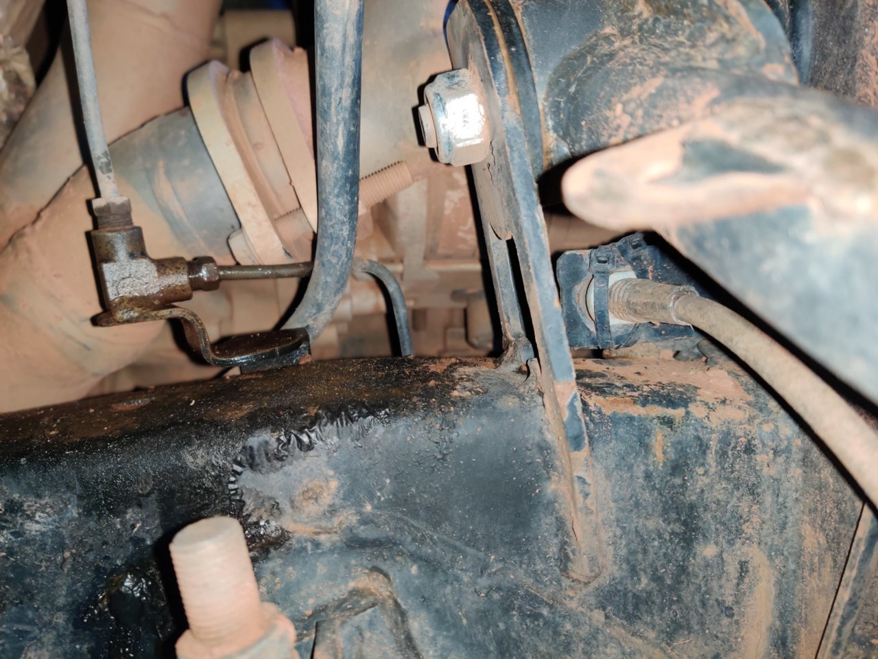

    So what happened when you were on the trail? Loss of braking? Intermittent? Was a temp trail fix necessary?

    My first indication there was an issue actually came from both Zane and Dan after they drove my truck. We all swapped rigs for a while on White Rim. They both said that my brakes seemed a bit soft to them. The following day the dash brake light came on indicating a low fluid level. At that time I couldn't tell where the fluid was going and thought it might be a master cylinder issue. It wasn't until I got home that I found the leak.
