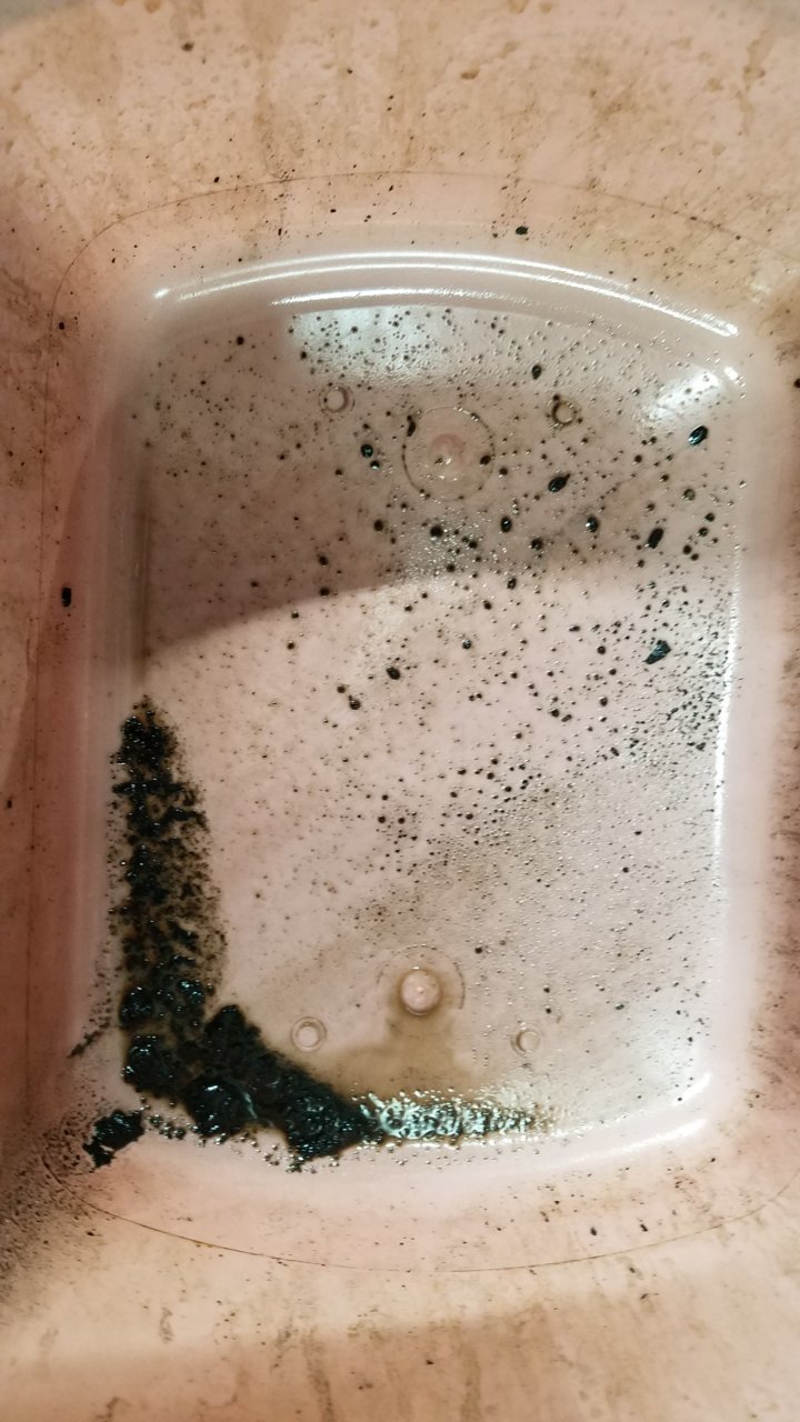

    Contacted @Empty_Lord earlier today and told him my power steering pump sounded like a pit bull chasing a mailman. He told me to clean the screen in the reservoir or he would send Tacoma Protective Services to place my trucks into foster care.
    Got it done and quieted down nicely.

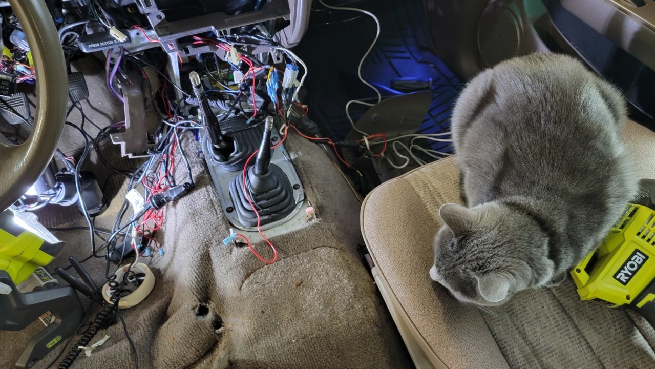

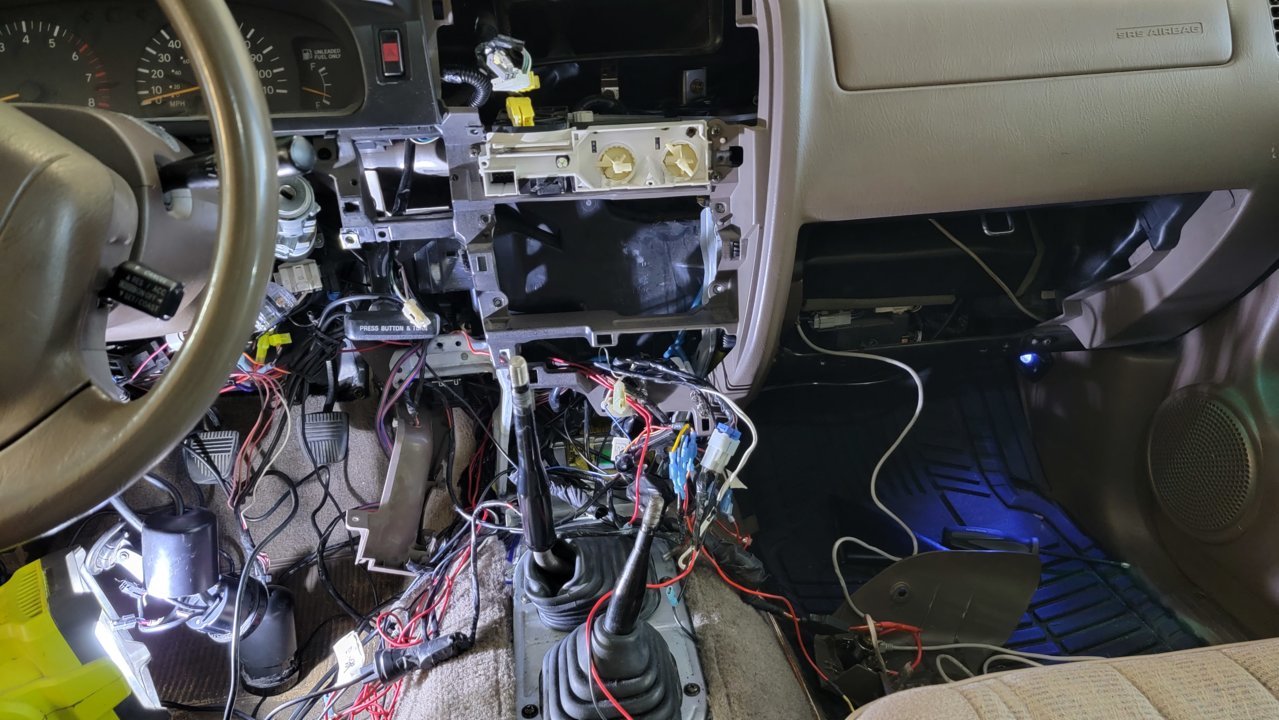

    Redoing all my accessories wiring. And there is a shit ton. FML20221116_131406.jpg

    Wondering what everyone did for central ground and power locations for all their accessories. Or how they routed everything. Thinking about using the glove box but not sure yet. When I started my build 7 years ago added things one by one and now I need to redo to make it better. Things change over time.
    Hoping some people can share what they did as I have a crap ton of gauges and accessories. Any help or advice would be appreciated thx

    I ran a small 6 fuse slot circuit that has 4 Key on Hot and 2 Constant Hot.
    Had already upgraded wiring from an ALT upgrade. But be sure to upgrade Cab to battery ground, and engine block to Cab ground so you have nice clean low resistant paths.
