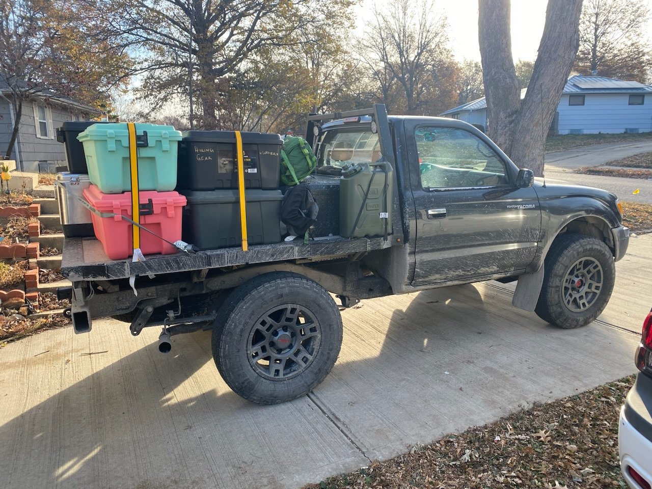

    Packed like a boxcar, driven like a stock car.

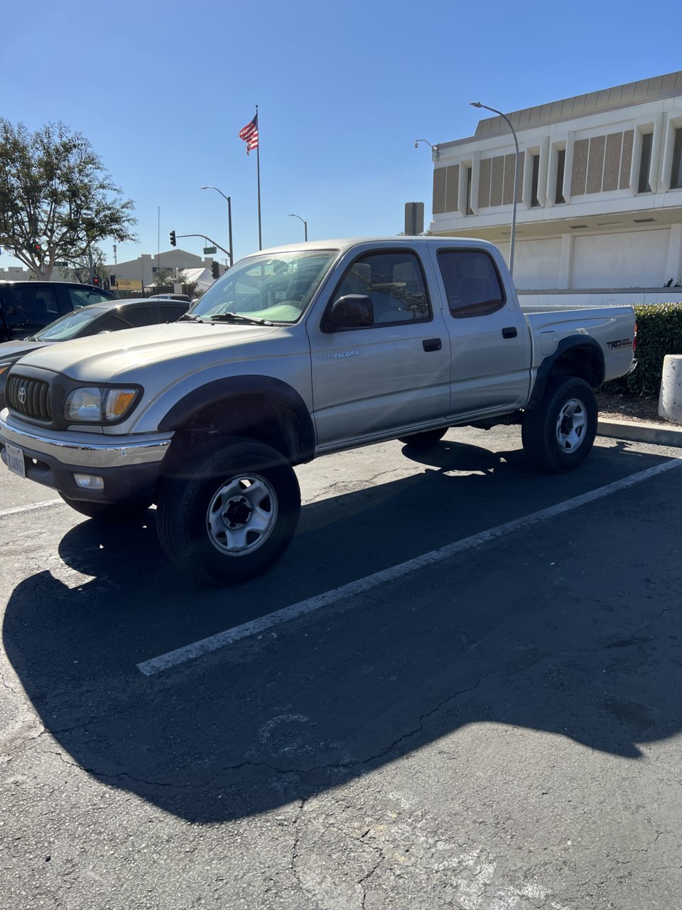

    Dobinsons all around, 650lb springs and SPC uca’s up front, ARB Dakars with extra leaf at back
    Too much lift?

    It isn't if you like it. If you are not 100% with it, consider larger tires and adding a bit of weight.

    Perfect lift, tiny tires.

    Too little tire...

    Mas tires

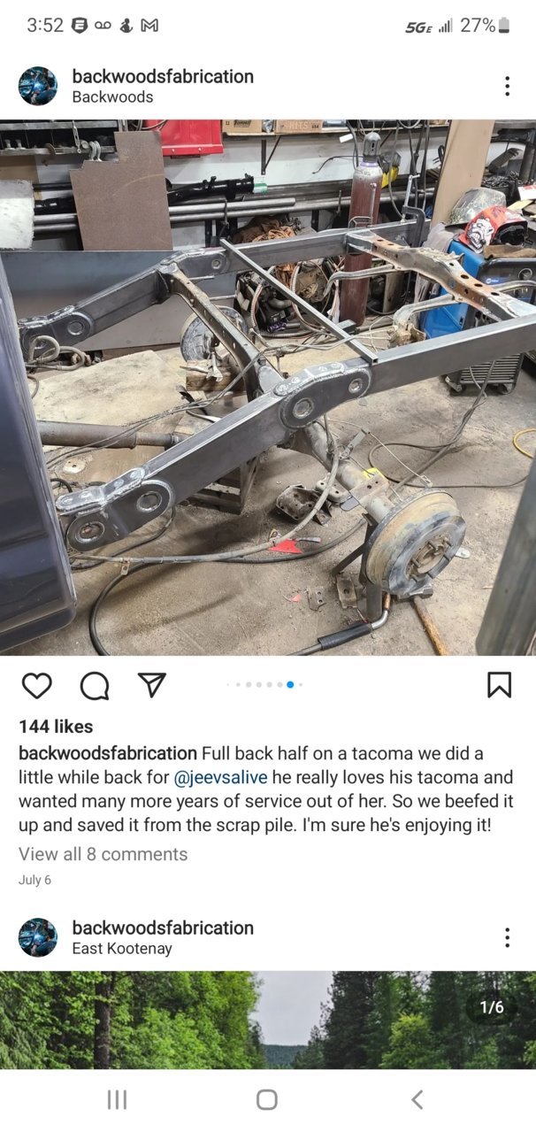

    Did you cut the back of the frame off and do your own tube?

    Looks like bigger tires are in my future

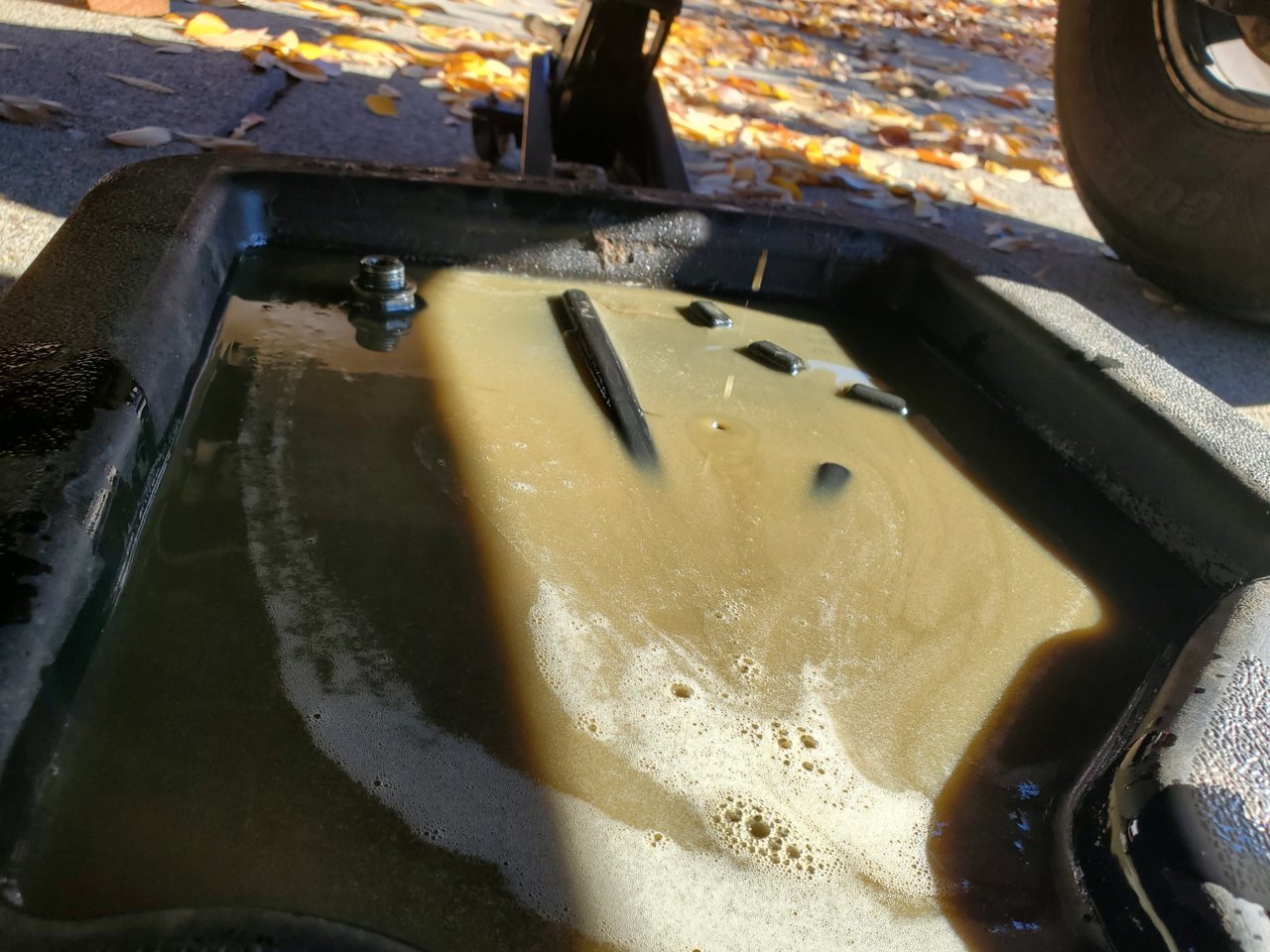

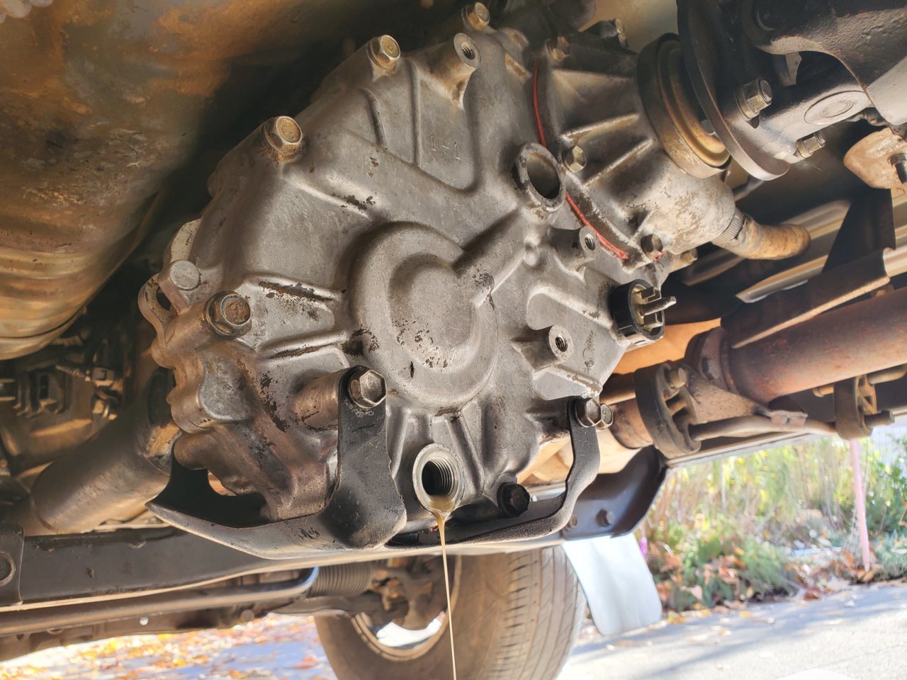

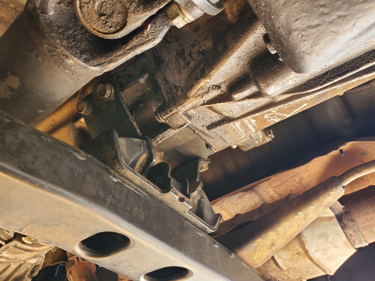

    Been meaning to do this for months and finally got around to it. When I changed my clutch in July, I power washed the trans/transfer case, and I was worried I got some water in them. Looks like I was right. New MT90 in (had to special order it, I couldn't find anyone who stocked manual trans fluid around here), and it immediately started shifting better.
    I saw evidence of a leak while I was under there, but not sure where it's coming from. Maybe the transfer case input seal?
    Also ordered new shocks and struts today.

    and so begins the process killing all mpgs. Death to the MPGS!
    Looks a little tall to me. Even for tires. With 650lb coils and no weight I bet it feels pretty darn stiff. Why did you go with such heavy coils?

    I had Back Woods Fabrication do it, you can see the build on his instagram: https://www.instagram.com/p/CfreJJnpDtZ/

    Nice. That's rad. Looks like they did a good job. Forsure a lot stiffer back there now
