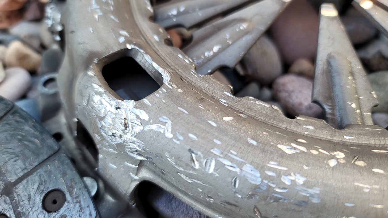

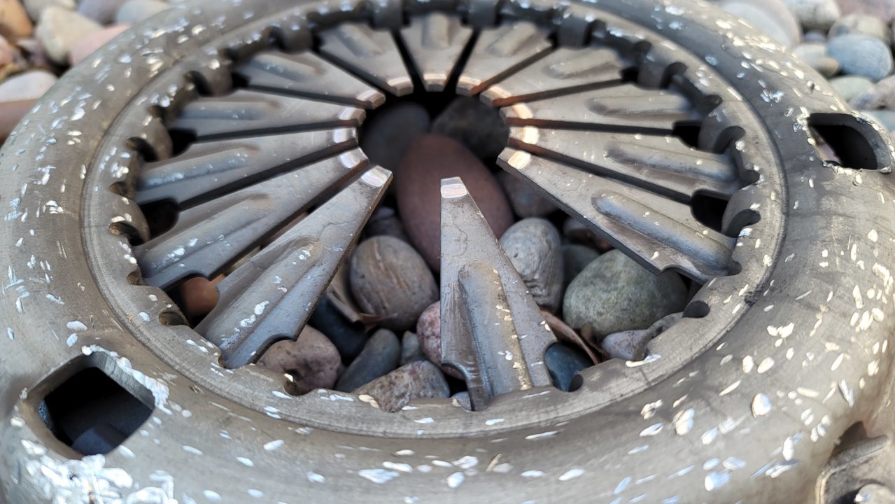

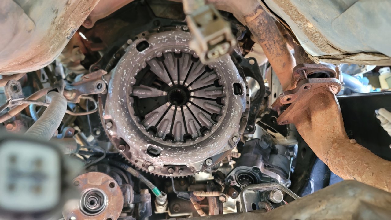

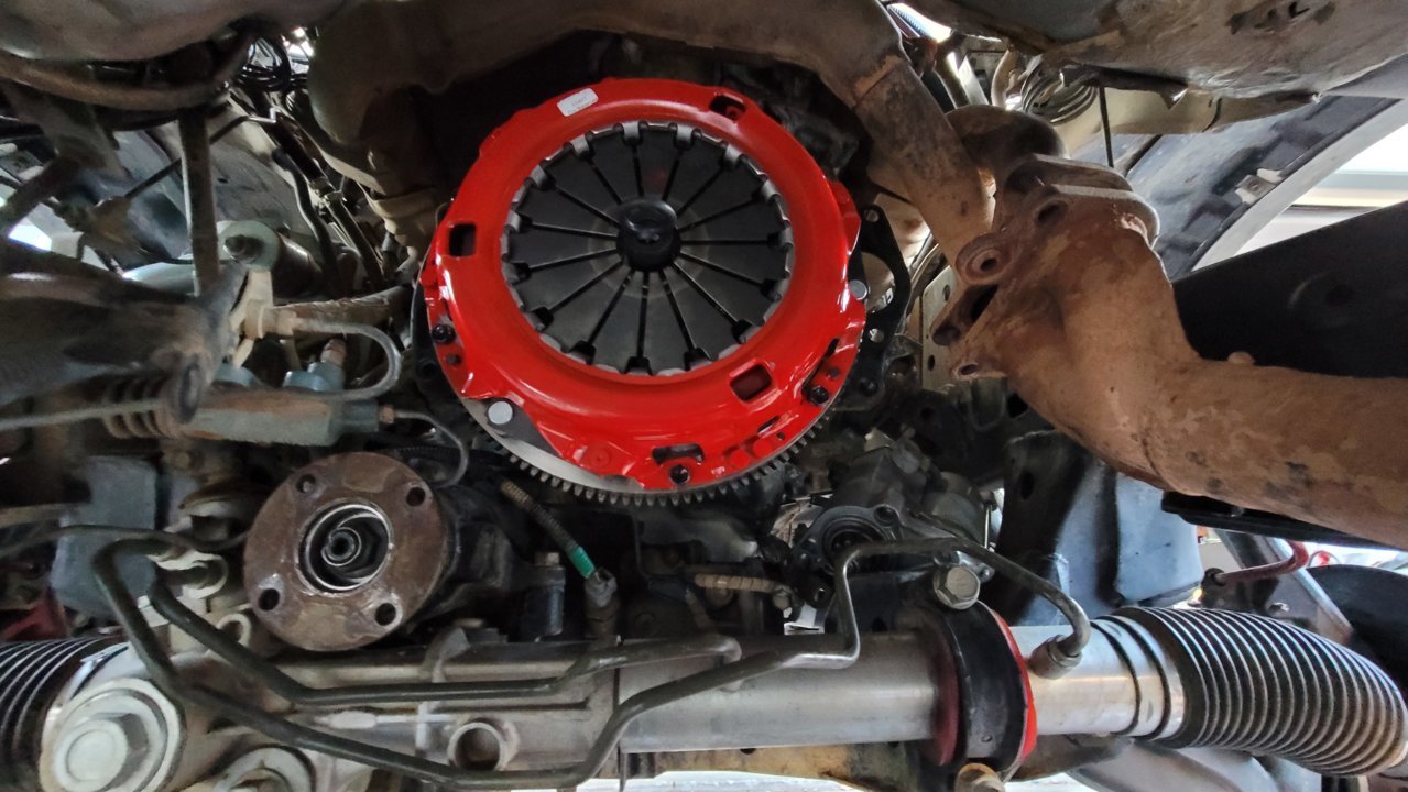

    Found the noise!
    I think my clutch needed replacing haha
    Went new everything. And while I was at it had a local shop rebuild a spare tyranny I had. Likely didn't need it but if she was coming out I didn't want to put a 360k one back in.
    New rear main also. Super easy when you are there.
    A leisure couple days.
    @Speedytech7 is there a trick to getting that slave in the fork and bolted up? I didn't release any pressure in the line. But wondering if a heavy clutch (did the lce pro) might make it a bit more difficult.

    Crack the bleeder so you can push the pin in by hand maybe, usually isn't tough though, are you sure you have the fork seated on the pivot pin entirely

    Ok I'll try that.
    Yeah I checked several times before us getting it in. Should it move by hand easily?

    You can usually compress the slave cylinder by hand if the pedal isn't depressed yes. Your clutch was pretty fubar, you might also have an over extended slave or a busted slave given the damage, may even have been the cause. Should check it, only a $15 part anyway

    Haha just a little.
    I have a spare slave somewhere I can toss in I think.
    Yeah I can't compress the slave. Lulz
    Fork is seated correctly. Took the boot off and checked just to make sure.

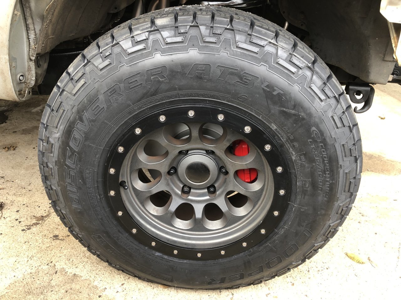

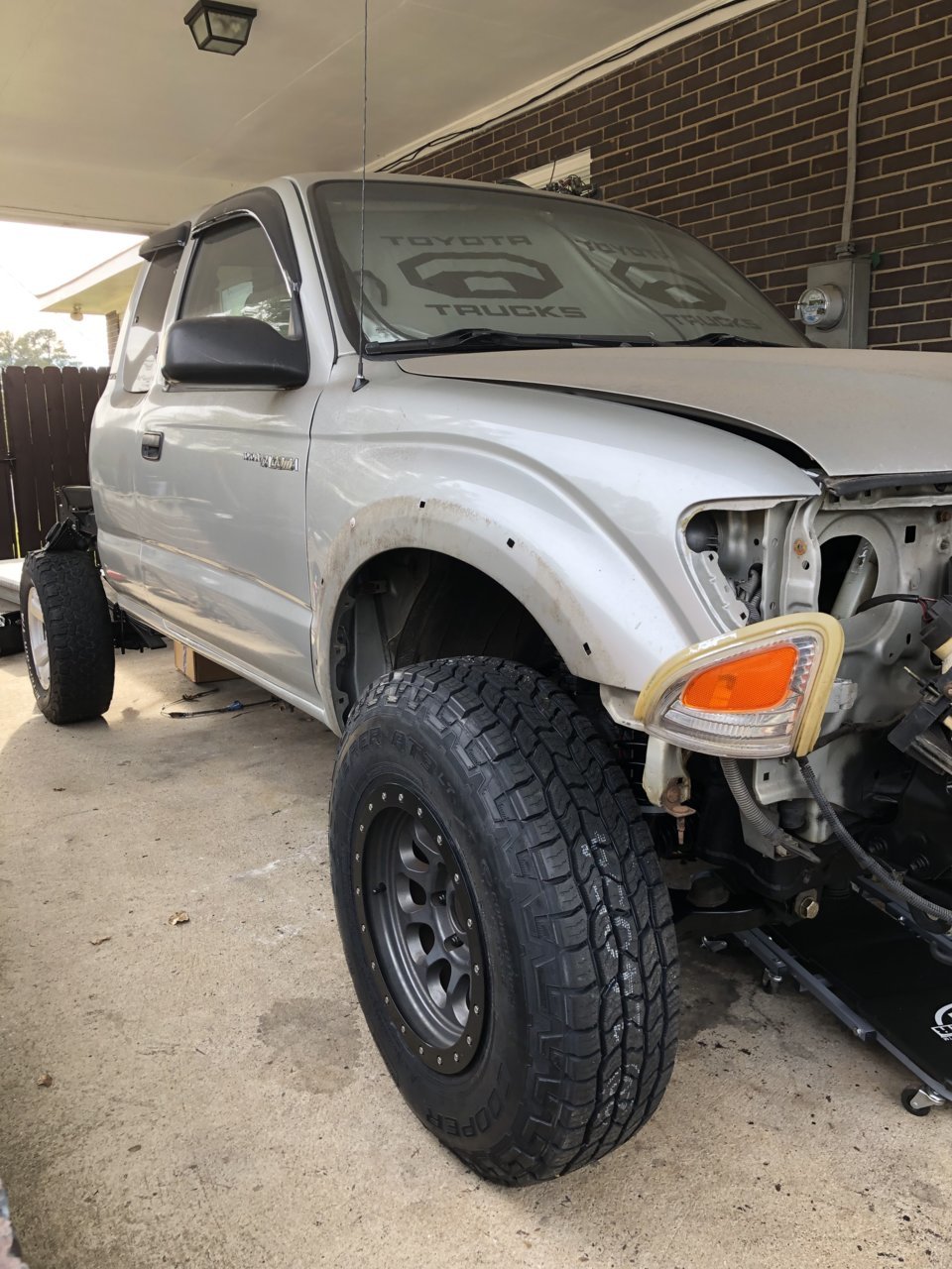

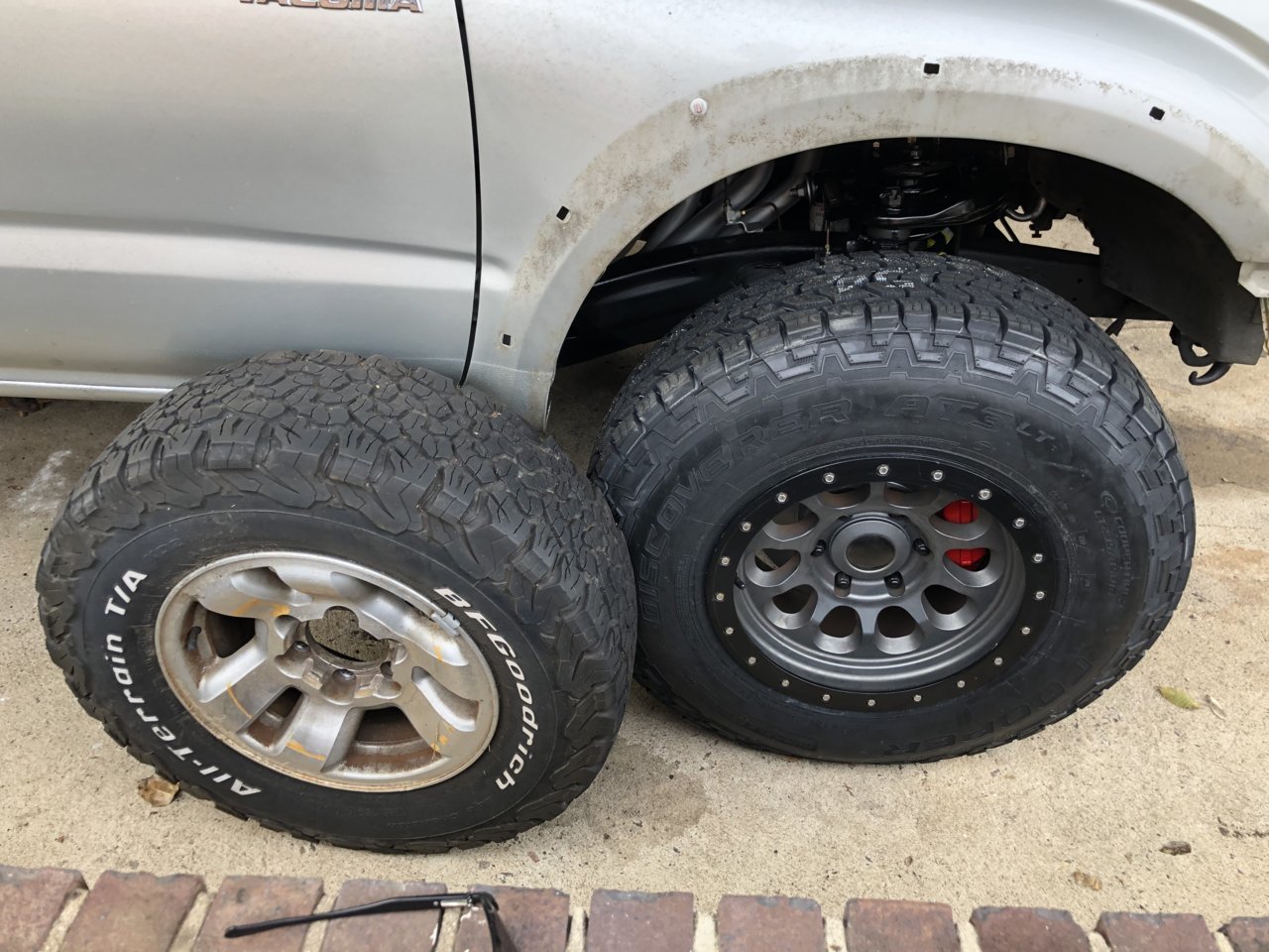

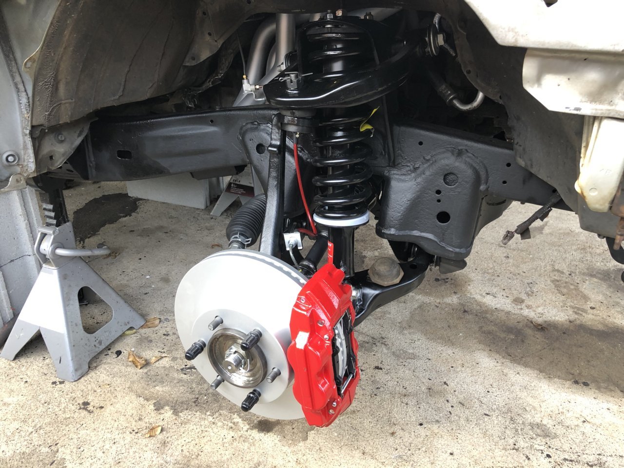

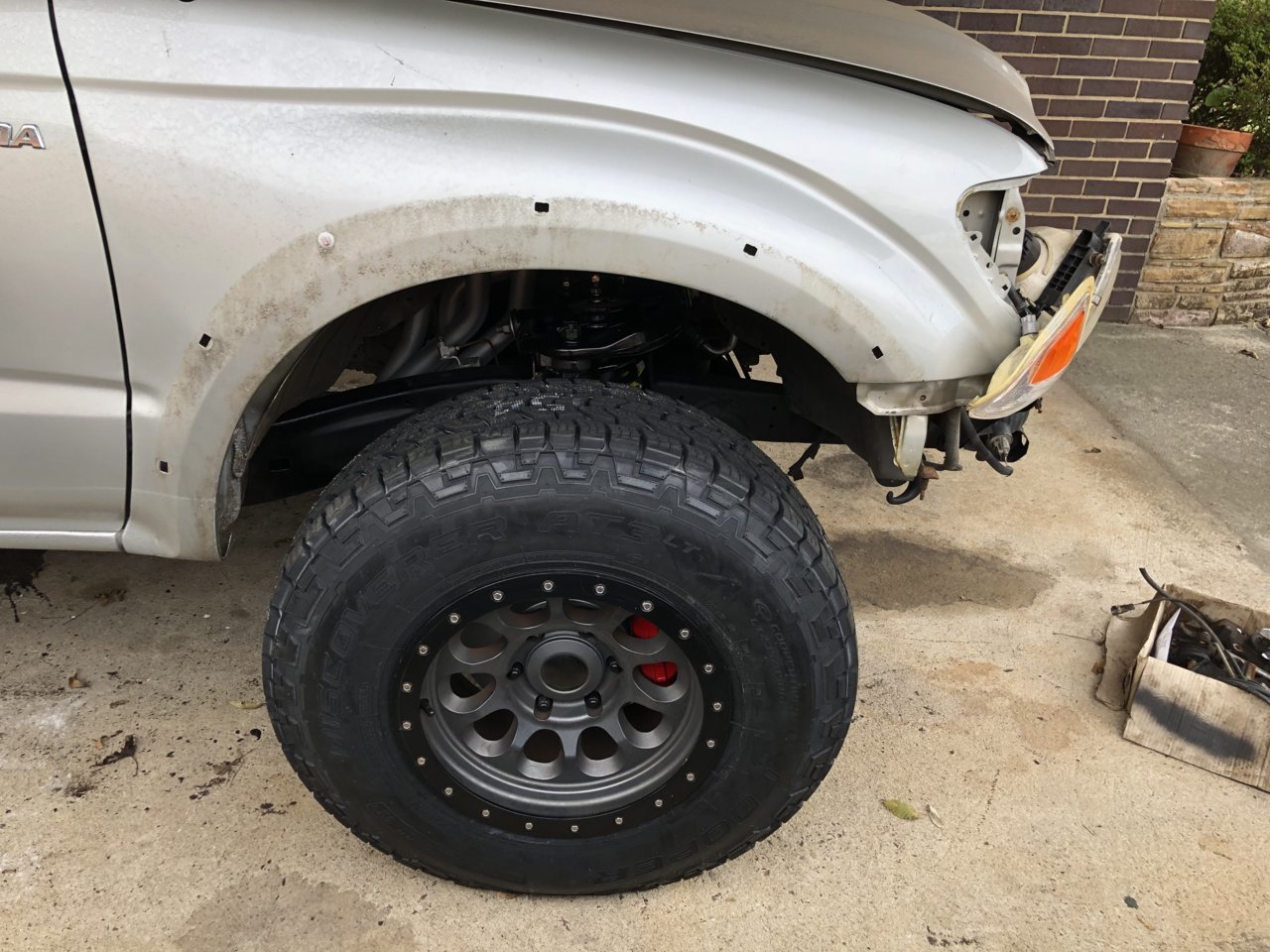

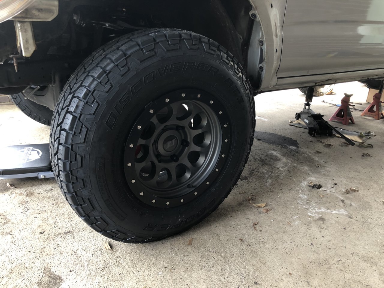

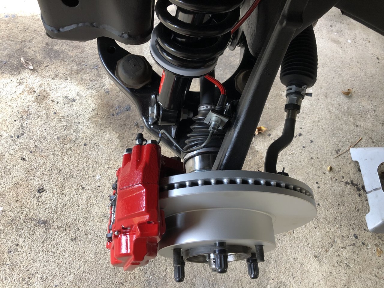

    Tundra brake upgrade with new Cooper 235/85/16s on SCS Ray 10s.
    look so much better than those stock 15s I had.

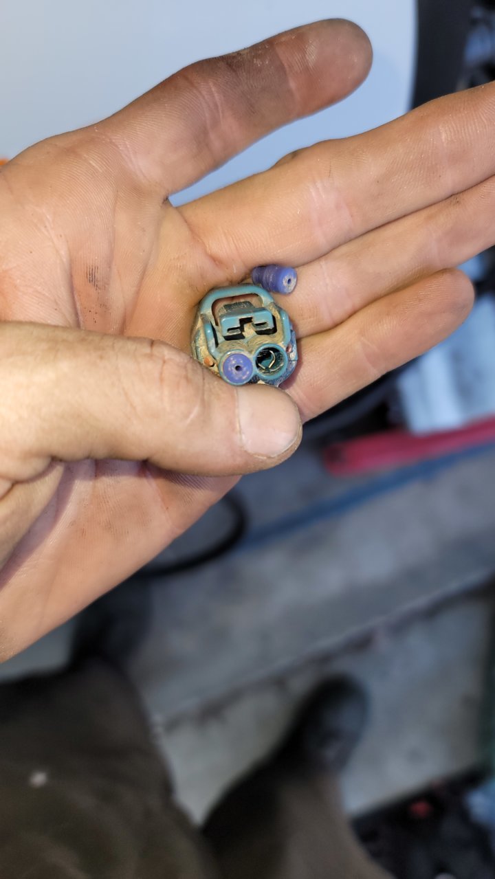

    Bleeding worked. :bowdown:
    Just found hanging wires though :rofl:
    Looks like 4wd might need some repair.
    You know what removal tool it is to get out those pins to re connect it? And just when I thought everything was going smoothly haha

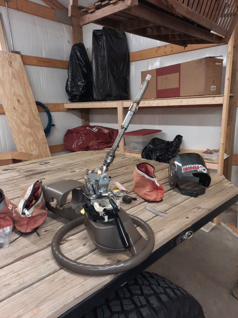

    Fixed the steering wheel play, hopefully. I did the tac weld mod. Should have done this along time ago. I enjoy driving it again.

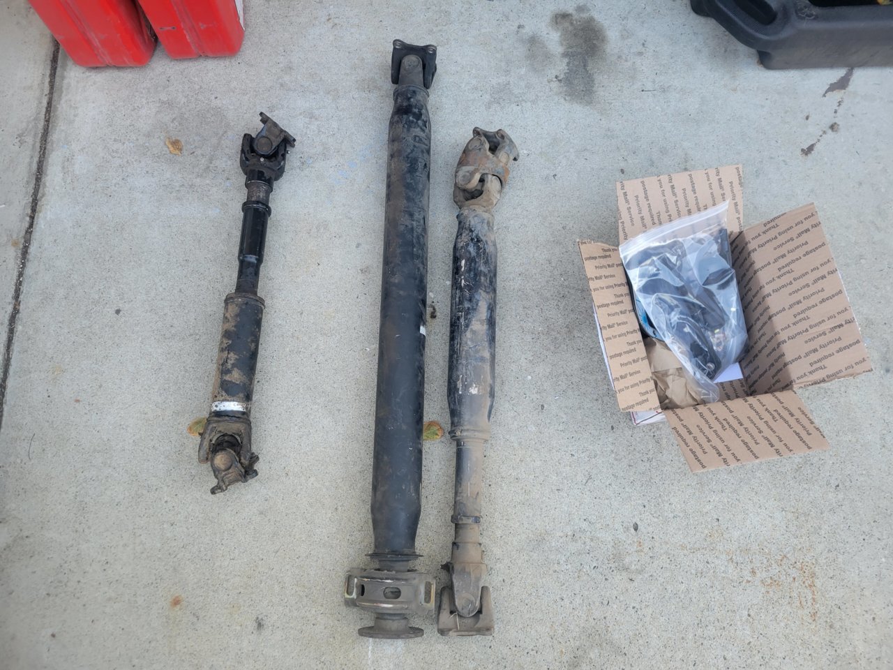

    RADesigns triple sticks showed up.
    Found the front section of my Pre-Runner rear driveline under a pile of parts. My rear section was in the truck for a spare.
    New center bearing should be arriving later today. I'll replace it before I take the DL to get cut and balanced.
    Pulled the front driveline so it can be lengthened.

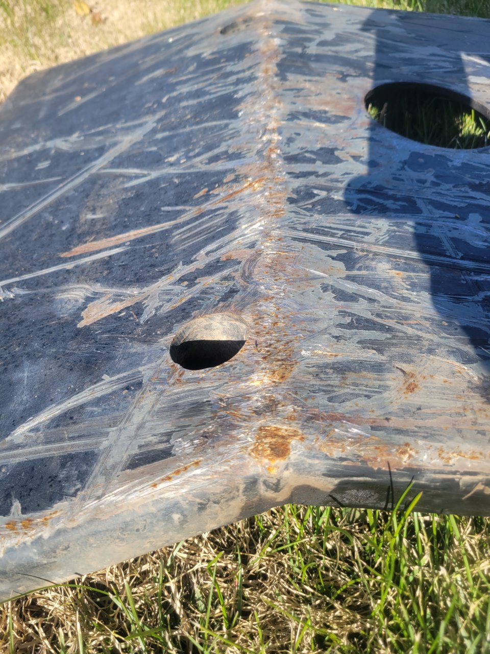

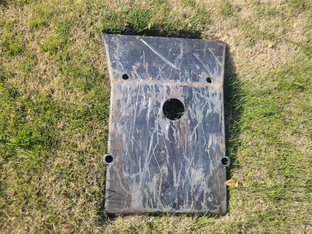

    This skid plate was painted 1 year ago

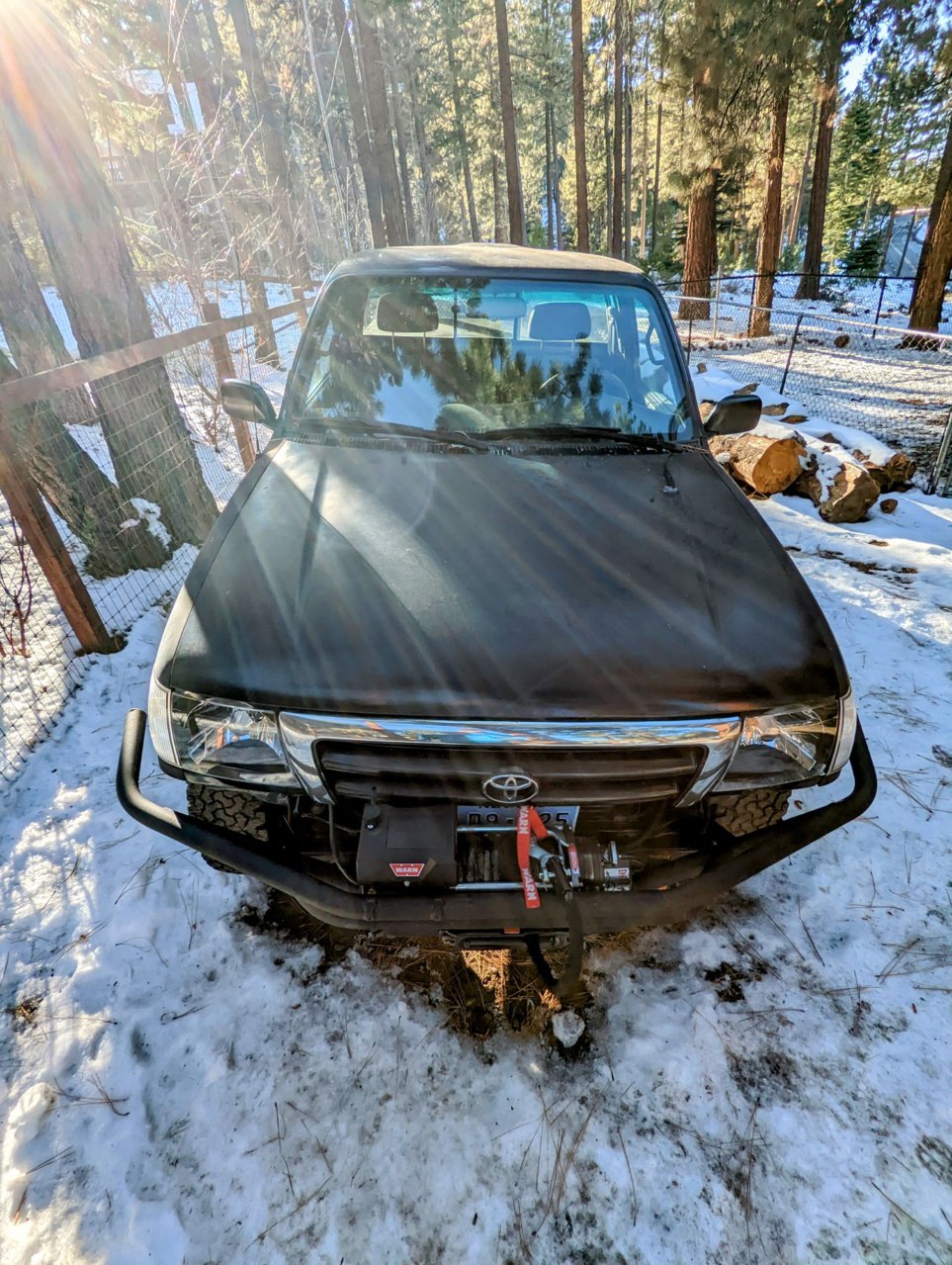

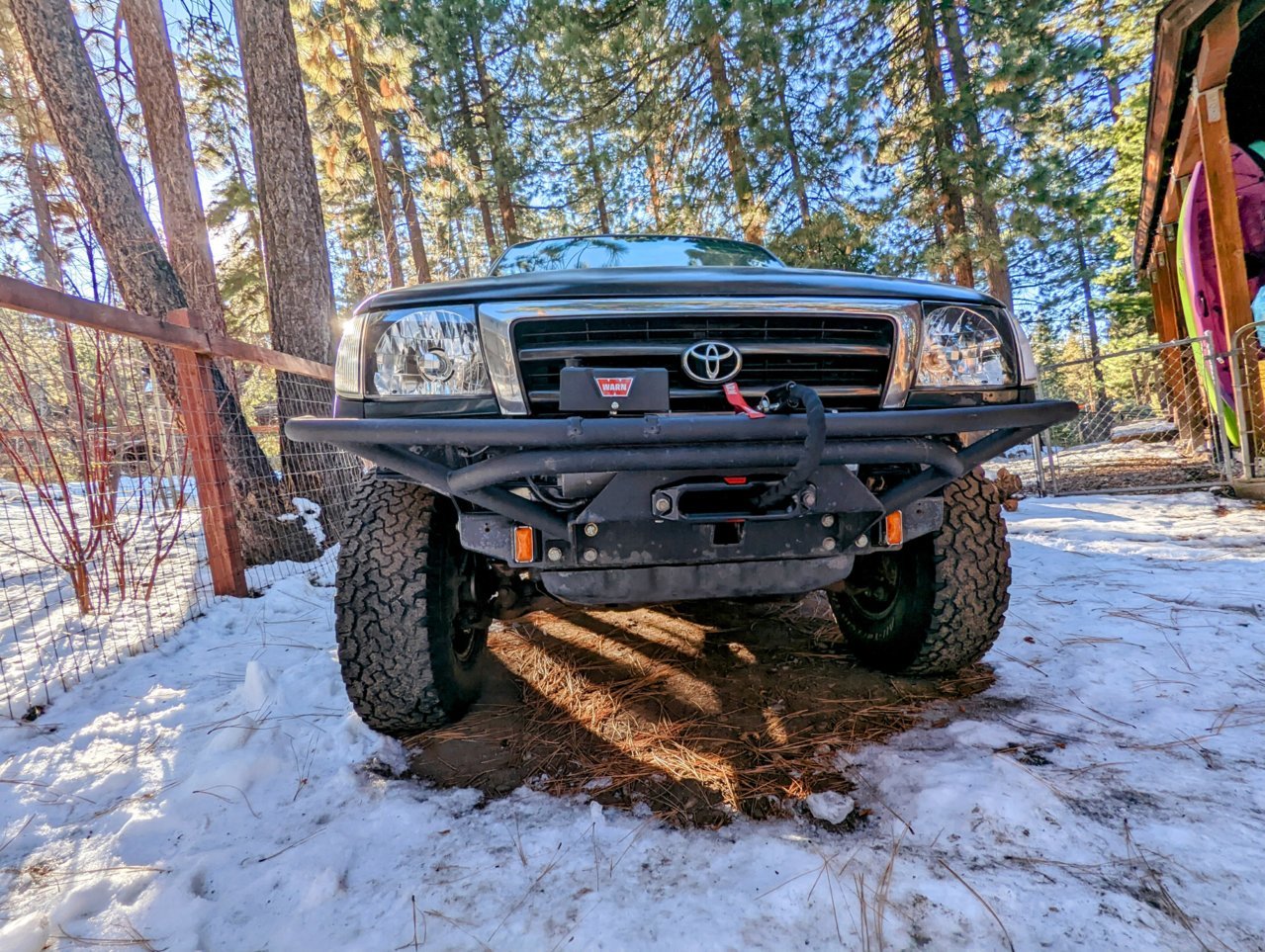

    Finally had time to install my freshly rebuilt Warn winch today.
