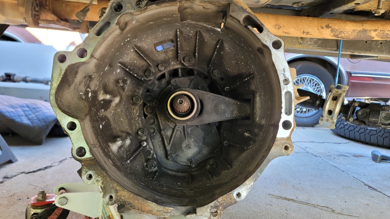

    New clutch is like butter. I'm amazed at how smooth and light the clutch is compared to one with broken fingers.
    Just did a commute with it and it pulls up hills again. Got a little chatter at the end in low speed light to light of the drive but I'm guessing this might go away after it being broken in more. We are at like 24miles so far.
    That plug and wires that broke off seem to work in conjunction with the transfer case, another wire in the rear of it and a silonoid (that kept actuating the solenoid on my drive) lots of clicking and 4wd light going on and off mostly.
    Stoked to have done it right (unlike the last time)
    Luk flywheel from marlincrawler (didn't know it was luk or I would have just picked one up local)
    Lce pro clutch kit (yes it has factory bearing and throw out)
    And a fully rebuilt trans by a local shop m.i.t.

    Glad to hear it, I was amazed at the carnage from your old clutch. Happy it didn't damage the bell housing or anything important when the fingers broke off.

    Oh... it did...
    And we found a finger lodged in what I think is the hole above the fork. I'll post a photo of it when I get home. It looks like a real finger now.
    I have a spare everything (lost my last truck and salvaged what I could) so that trans went in for the rebuild. This one will need a new bell housing for sure
    Little worried about the chatter but I've never done a performance clutch before and saw that could be normal foe when it mates. But I'll just drive it and see what happens...
    For now that wire needs to be capped. I think the circuit is completing (forgot to cover the wires) and triggering the silonoid to activate. If not I'll pull the back one off and see if that's a temp fix for now.
