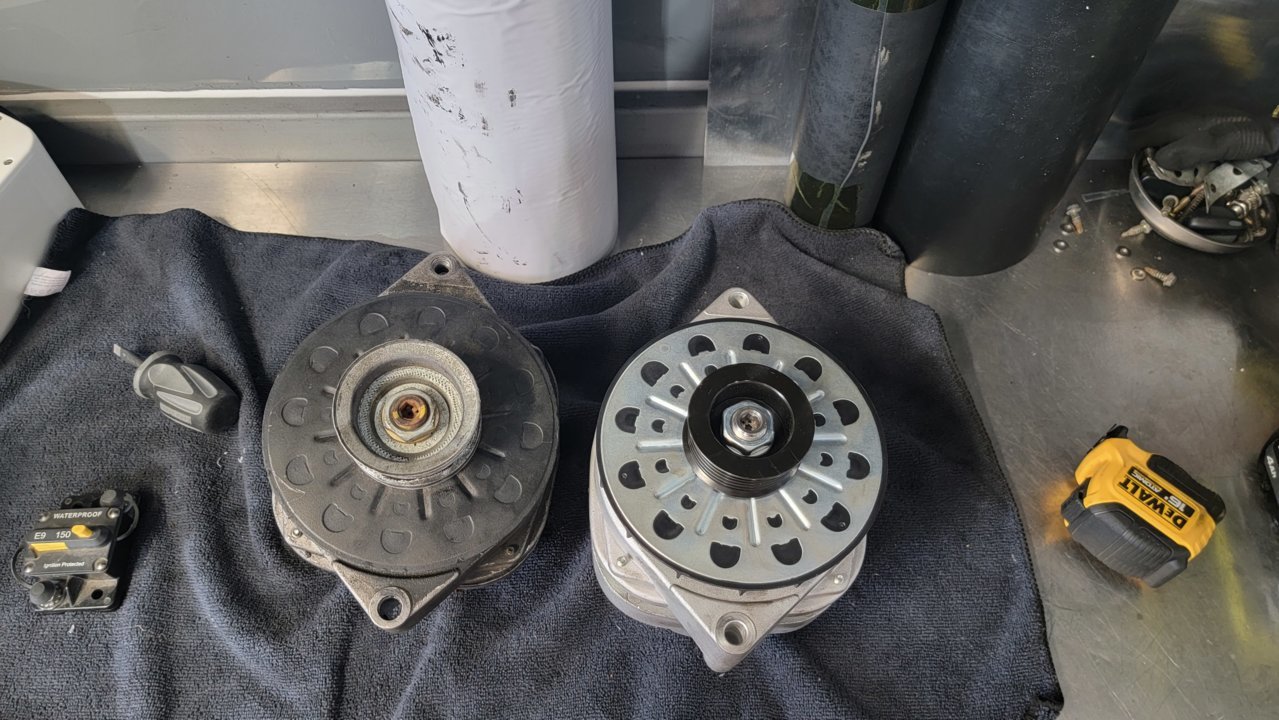

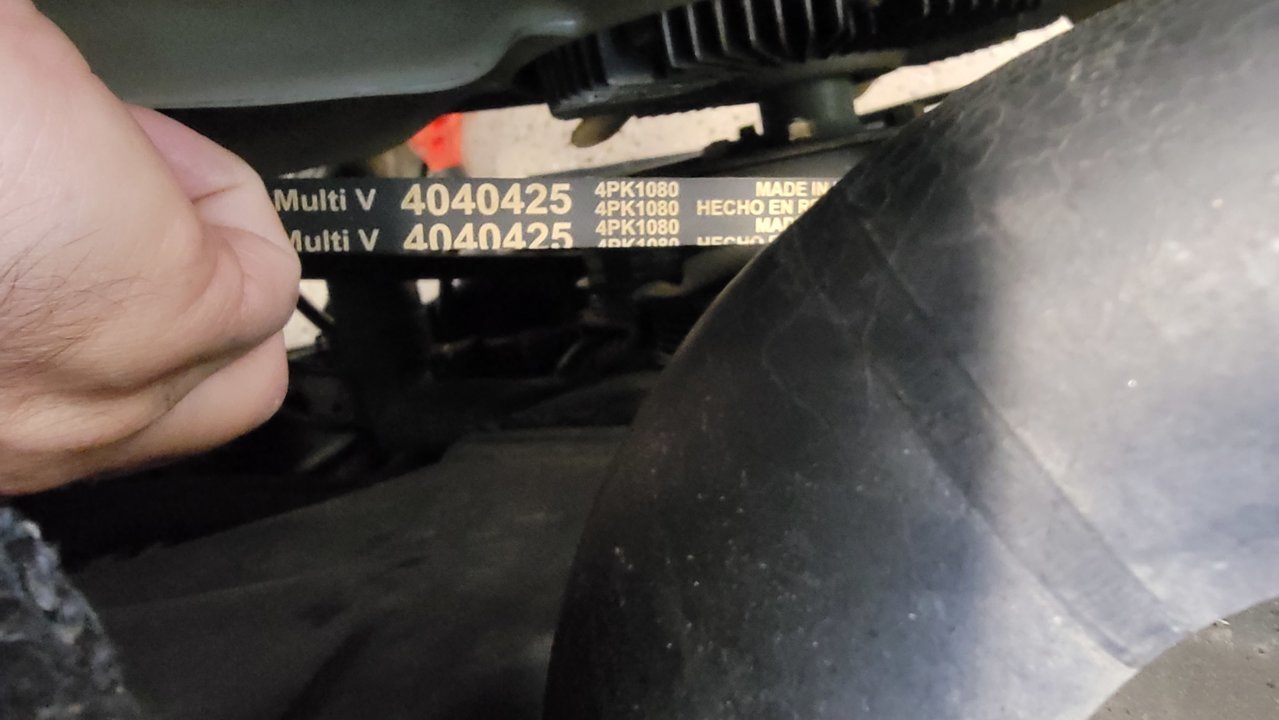

    Also I'm worried about the smaller 2" pulley on my new alternator as I could barely fit the old one in with my tower gussets. And I mean barely. I know the smaller pulley will be better probably what I should have in the first place to keep good idle voltage.
    Wondering if I should get a smidge smaller belt so its not so close to the gusset. I have a 4040425 belt on now. Thoughts?

    That is fine. I explain this in that post:
    The red wire is the sense wire which technically goes to the white wire in the Toyota harness. It's not 100% needed which is why I just tied it right to the alt so it is "sensing" its own voltage

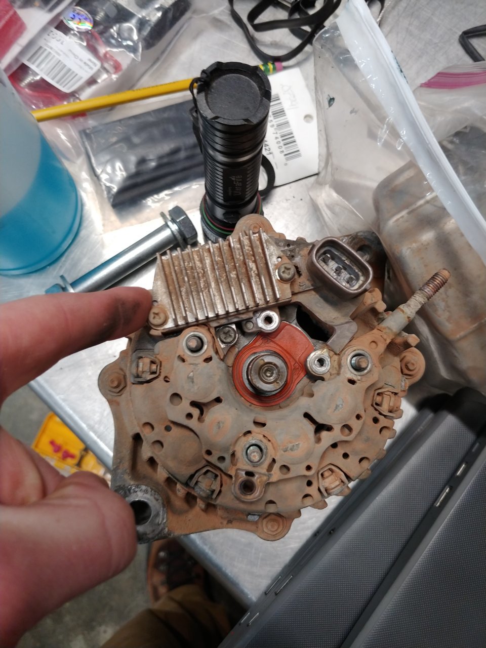

    Speaking of alternators, I've had an intermittent overvoltage situation going on recently.
    :annoyed:
    It's not so persistant that I'm worried yet, but I'm betting alternator service is in my near future. I've heard rebuilding isn't worth it, and also that reman units are a waste of space. Not sure which direction I'll go yet. Haven't done too much research on it.

    Check the wiring to your plug first, one of the wiring making poor contact will do that. But you can also just order and change the voltage regulator, it's very easy, just screwed in. I have mine apart right now for a new brush set but you can see the voltage reg isn't held in by much.

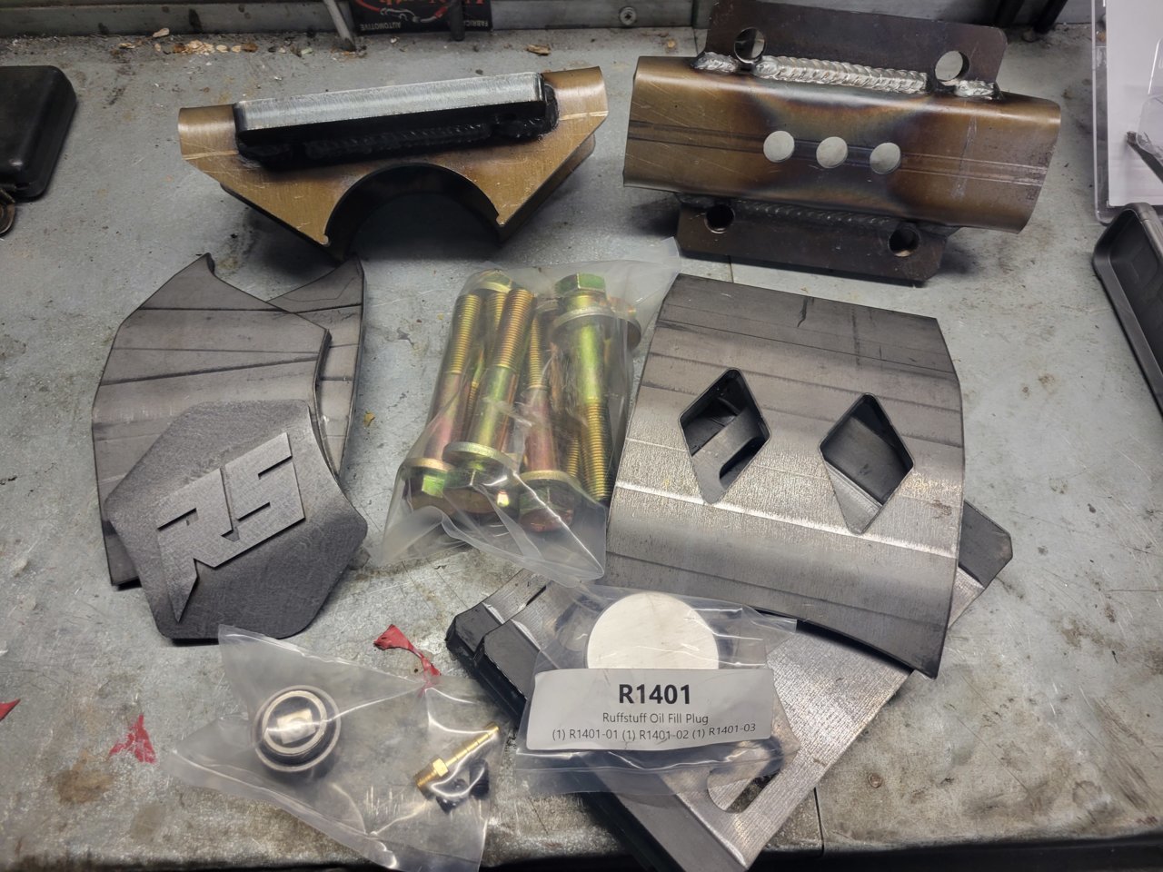

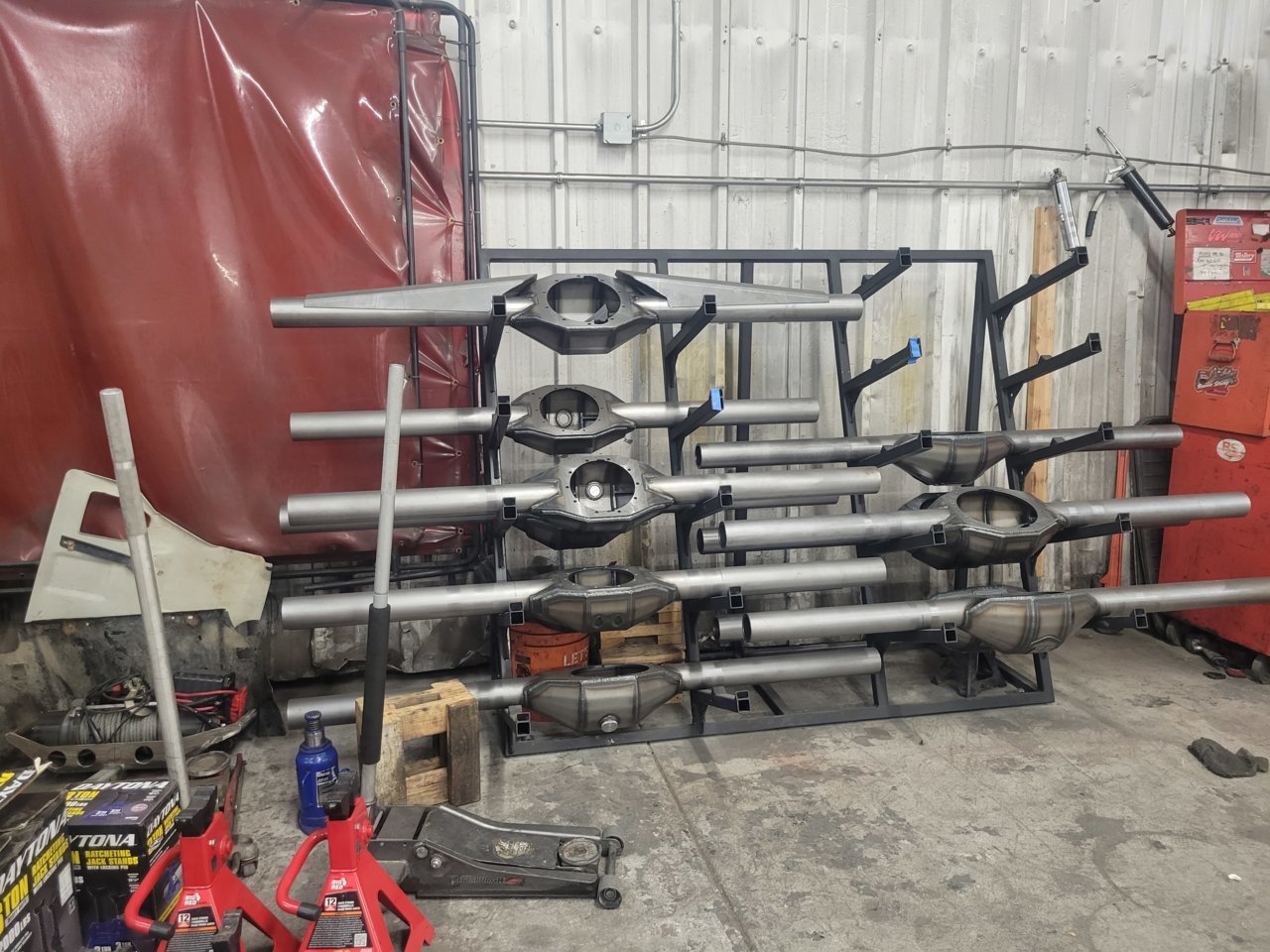

    Made a parts run today.
    Mine is top left :cool: (those trusses are just sitting on the housing, I asked them to leave everything off)
    Winter project pile is getting bigger.
    No, I'm not leaving it standing. It rained on me all the way home. Letting all the water dry off. Then I'll shoot a little WD40 on it. (3/8 wall tube isn't really going to care if it stands there though)

    Interesting, so ruffstuff housing with the 9.5 chunk? Easy to get equal sized shafts made I guess? does running this setup make it cheaper to setup the spindles to something cheaper than toyota parts?

    I'll go with RCV shafts here, but Longfield and others make shafts, basically to length for builder axles.
    I wouldn't necessarily say this is a cheaper way to go by any means. LOL... It's actually A LOT more expensive than getting an FZJ axle assembly and making it fit. But this will be a lot stronger than an FZJ housing. The diff is centered. And the brake assembly I'll be using is better.
    I think I've narrowed it down to using the D-rotor kit from Front Range, that uses a 4th Gen 4 Runner disc with E-brake drum inside. The 4th Gen brakes are better than the FZJ brakes.
