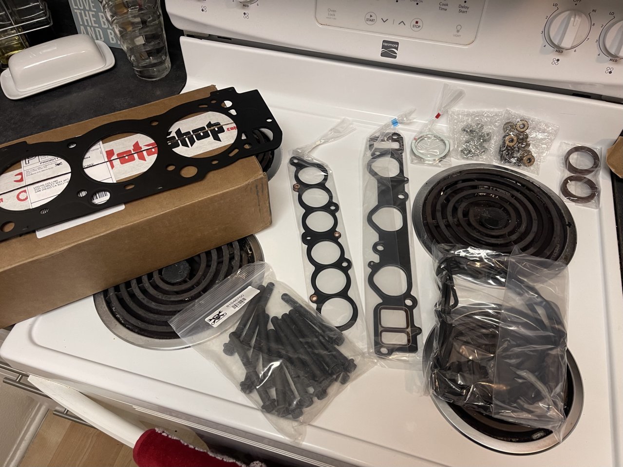

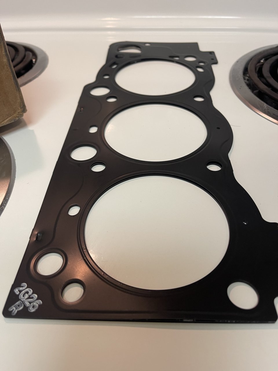

    Head gasket kit came in from YotaShop. Everything looks to be in order so far.

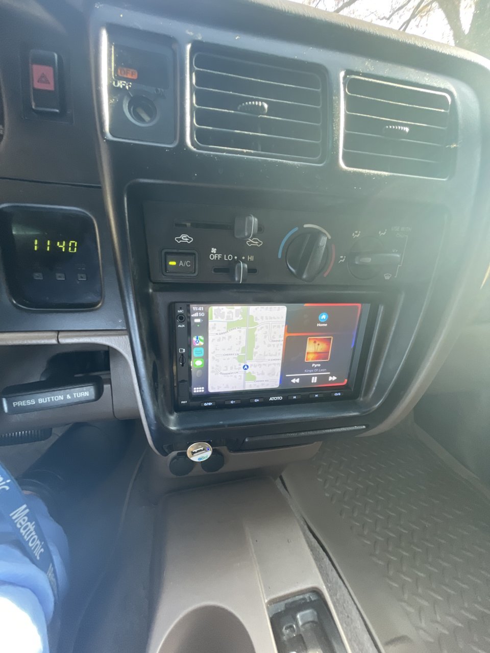

    New radio and speakers. Easy couple hours while at work

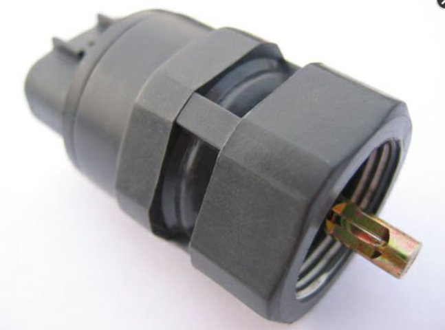

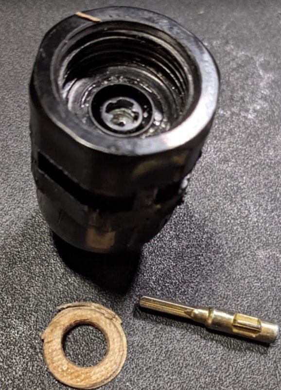

    Quick update to my speedo issues... tossed that trailgear/AP mechanical to electric VSS adapter since it a POS (internally locking up) and is what killed my speedo.
    Ordered the Marlin Crawler version and you can tell immediately the difference in quality.
    The 'pin' that inserts into the mechanical VSS gear base is fixed to the adapter.
    The gasket is also afixed inside the adapter. I didn't try to remove it.
    The TG/AP version, the pin is loose and can be removed simply by tilting the adapter - falls right out. The gasket is loose as well and can be chewed up by the pin.
    If you're doing a PreRunner to 4WD conversion and have a mechanical VSS, you'll need an adapter. Don't waste time, go with the Marlin Crawler adapter.
    MC adapter -
    TG -
    I'm also working on testing the 02-04 OEM electronic VSS to bypass this adapter business and will update later on that.

    Good catch. That will help a lot of folks. Unfortunately for me, I've said I'll never give Marlin a dollar and that is a promise I intend to keep.
    I'll keep throwing good money after bad by buying the TG adapter... which IS a piece of shit.
    Here's hoping you figure out a way to eliminate the adapter. :cheers:

    These VSS options are good, i tried the TG one on my LC and surprisingly it works right outta the box in place of the factory one. But it fell apart, luckily i found the OEM one, and was gonna use another LC OEM one on my Taco for the Haltech. But I might try the Marlin one rather than shelling out $200 for another LC OEM sensor.
    Area51Runner[QUOTED] likes this.

    Both of those adapters are roughly 40 bucks+ a piece. With the TG crapping out on me near immediately after installing I didn't want to risk having these things fall apart only to throw more money into them. Maybe I had a bad apple, maybe not judging by the feedback I've received from a few on here. With the MC one, been some good posts on it and it works fine as far as I can see. It certainly has better build quality.
    Still, I wanted to just switch to the electronic one and so I started digging into the partsouq site.
    Ordered this one and it's sitting on my desk awaiting a new speedo gear. The gear is like 12 bucks. It'll be another week since partsouq is coming off a National Holiday but once the gear arrives, I'll swap it in and see what happens. I would have used the gear from my 95 tcase but the mechanical gear is longer and does not fit this housing. Tested and it does fit the 95 tcase I have so I'm betting its going to work fine. If it does, my recommendation to anyone doing a conversion is to go this route vs those plastic adapters.

    I'm hoping the sensor replacement works out.
    If not, maybe I'll try somewhere other than TG. I went down a rabbit hole with that adapter the first time the TG adapter crapped out on me (it's already crapping out again). That adapter is actually available on Rock Auto, AutoZone, O'Reilly because it's actually an OEM part for a vehicle (can't remember which one) TG just gets the cheapest available adapter and puts it in their bag.
