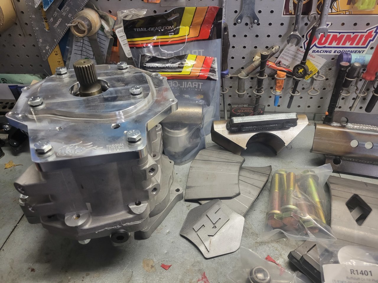

    Man that sucks! TG bought up inchworm and inchworm made a pretty sweet adapter for the speedo, sucks that TG does what TG does best which is takes good products and makes them cheap piles of shit.

    It's less Tacoma and more mod
    The Land Cruiser ones screw into the cable port like the TG ones, and they're cheaper in the generic forms on ebay, but here's an OEM one
    https://www.ebay.com/itm/323762713835
    Area51Runner[QUOTED] likes this.

    Considering the part in question is being used in a conversion from a 2wd vehicle to a 4wd vehicle, and converting a manual speedo to an electric speedo, and the only part that actually specifies that it does those conversions is Trail Gear or Marlin part... there's a reason why people use them.
    It's not like you can just look up an OEM part for that.
    Hopefully @Area51Runner figures it out and comes up with a better solution. But I've never seen anyone really drill into finding a best solution for it. It's just been one of those things you deal with on a swap with an older Tcase, on a newer truck.

    I did just show an OEM part that does that though, it's harder to look up maybe but you'd be surprised how much you can turn up from other models that will be compatible and solve the issue.

    That one definitely looks like its compatible. Smaller footprint as well. :thumbsup:
    I may order one of those copycats off Amazon just to check it out.
    My new gear from partsouq still hasn't shipped due to their national holiday. The MC adapter is on the truck now and doing what it's supposed to do.
    There aren't that many doing first gen conversions now but it would be nice to have some optional routes for the VSS for peeps to take instead of just relying on that chunk of plastic.
    Thx for pointing out the LC/Lexus sensor.

    No prob, it covers a wide range of toyotas cause they used that screw on speedo cable fitting since the 60s. Saw people use the LC sensor on old celicas when they put aftermarket fuel injection in em

    I don't think Trail Gear bought Inchworm... I think Marlin did.
    At least Marlin claims to be "the sole supplier of Inchworm products" all over their page.

    Someone with a 2002 Tacoma and a 1996 Transfer case will not come up with that item in a parts search for either of those vehicles is what I'm saying.
    I already know it comes up for OTHER vehicles... as a matter of fact I said that a couple days ago. In fact, the Trail Gear part cross references to a vehicle that isn't even Toyota where you'd effectively be able to get an OEM part from an entirely different manufacturer.
