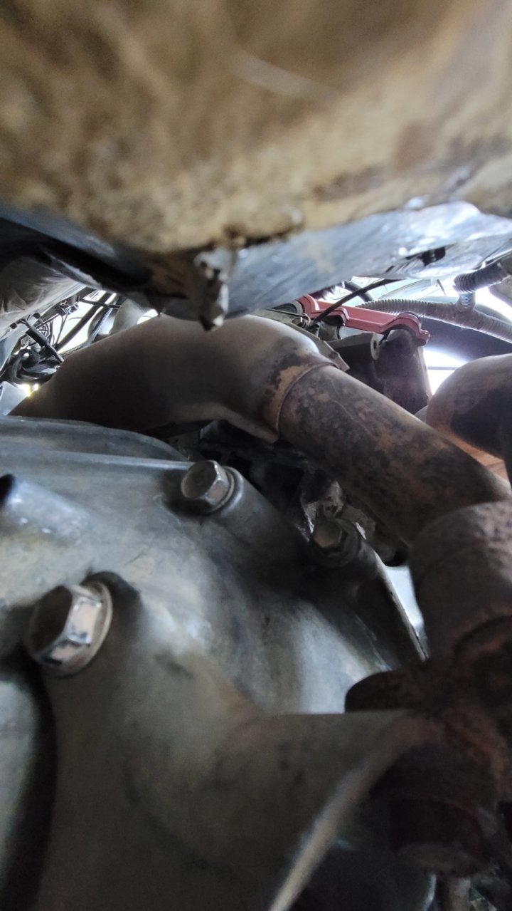

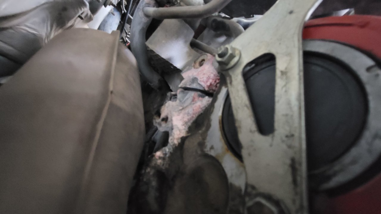

    looks like the lower intake manifold gasket is rusted out.

    Would that be a culprit of the coolant leak?

    It's less Tacoma and more mod
    It can be, easier fix than the valley pipe for sure

    Seeing the symptoms might align. Been getting some loss of power occasionally. Wish I went deeper and just did that when I did my cover gaskets. Hind sight.
    Just watched a video and some dude had pools of coolant there. Exposed that bypass pipe... guessing I would need to get to the back to remove it fully?
    If I pulled all that off again with new seals would I need to replace them again? Or would they be reusable? Want to make sure I'm doing things right.
    Going to try and find a better eye on where the leak is before tearing anything apart. Need my trusty spy mirror
    Edit: if this is indeed jacked, in going to replace them this weekend. I've taken the intake and most of this stuff off enough to be able to do it relatively confidently.
    Found them for 50/ea from toyota (looks like I need 2) P/n 17177-62060
    Anything else I should order while I'm in there?
    Can I reuse my fresh plenum gaskets or have they been crushed and are not reusable?
    Would really like to not do this again haha
    Tips, tricks? All advise appreciated

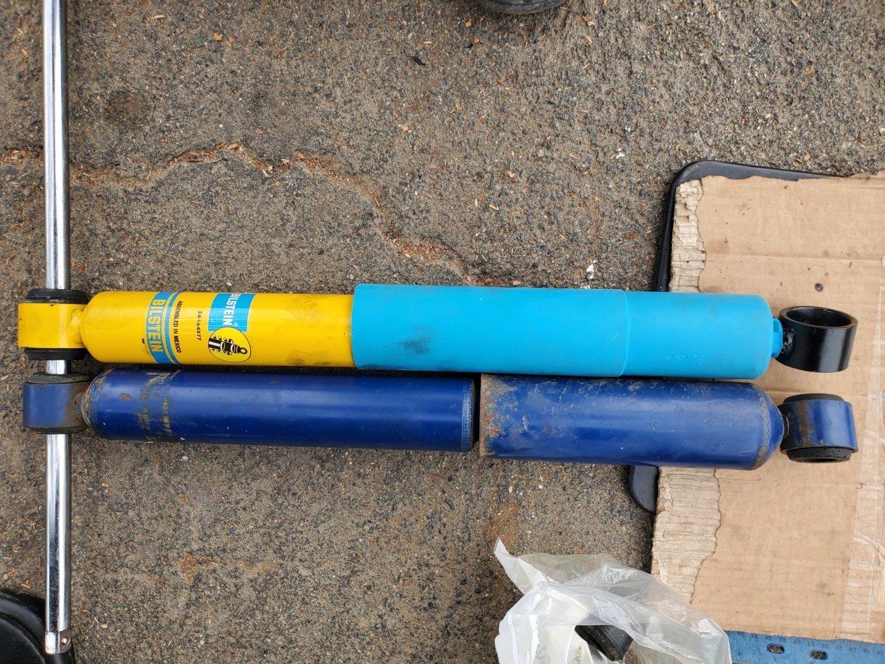

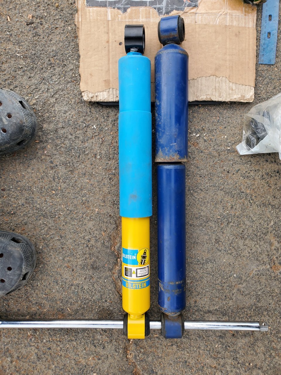

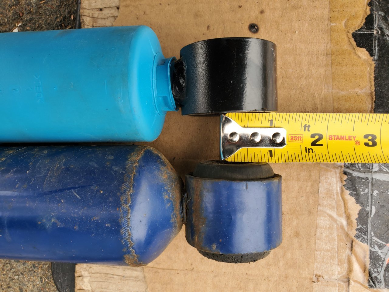

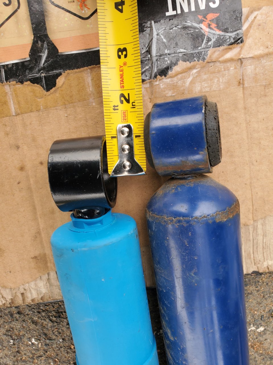

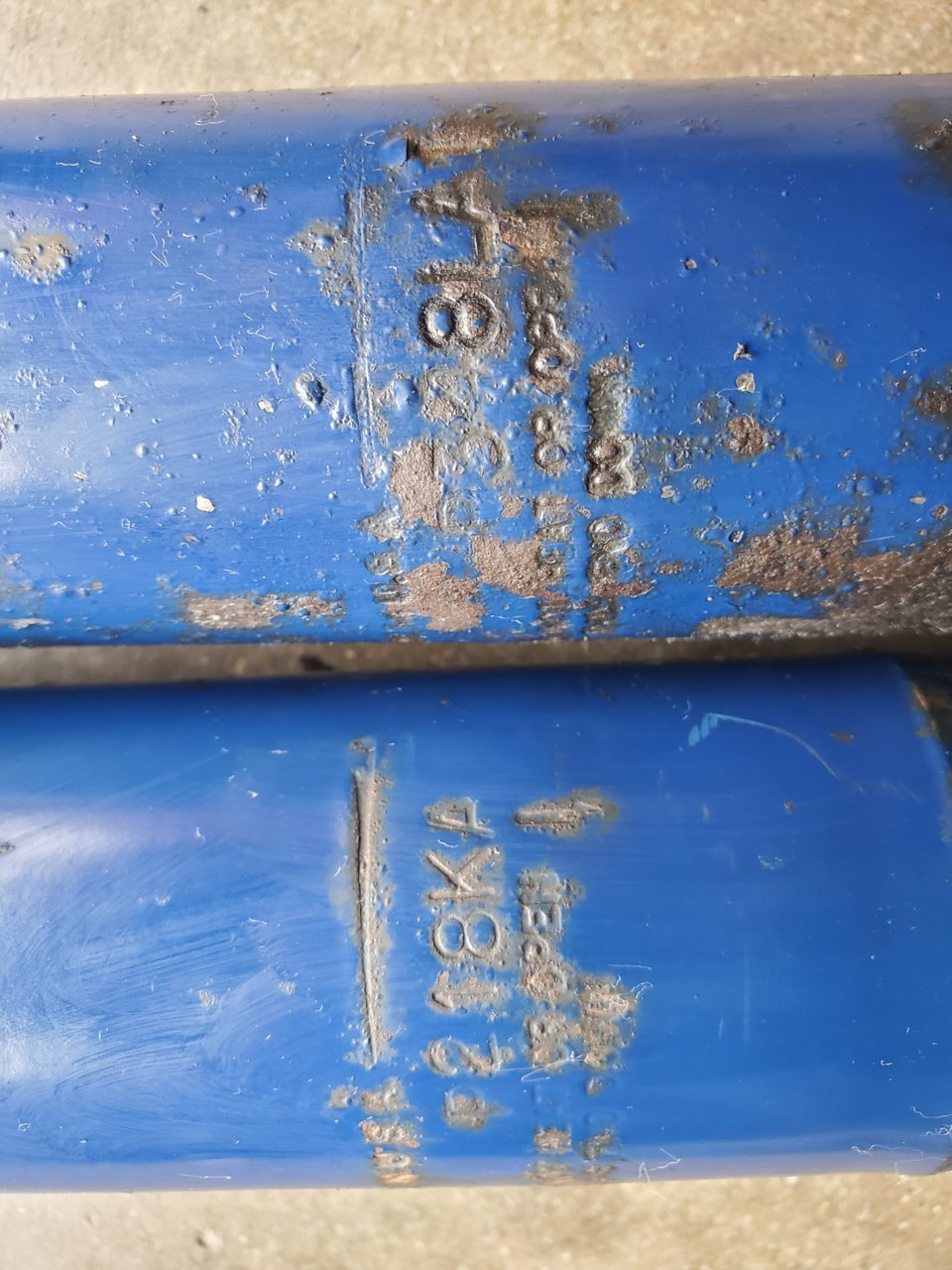

    Got tired of waiting for Bilstein to ship me coil seats for the front so I replaced my rear shocks. Not sure what these are (part #: P218KA and P348LA1), but I was surprised that the left had almost 5/8" more travel than the Bilstein. The right was basically identical, maybe 1/16" difference.

    Those most definitely are not stock, unless they changed the shade of blue and forgot the label :rofl:
    Drive side for first gen is longer shorter than passenger side if I'm not mistaken. At least the Billy's are. For the OME nitros, this didn't apply.

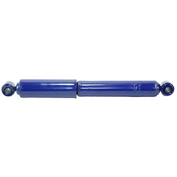

    Look like they're the base / low quality Monroe Matics. Same dark blue color.

    Hehe the only name I could find on them was on the bushings. I thought I remembered Tokiko, but I just checked again, it says Tenneco. My mistake.

    Longer one goes on the passenger side

    Most vendors ignore it anyway and send two of the same length, its only supposed to be like 3/4" difference. Best solution is to cut it all off :p

    My first thought was that the PO had installed 2 of the same, but left and right were different part #s. That manufacturer (whoever they are) does things differently, apparently :laugh:
