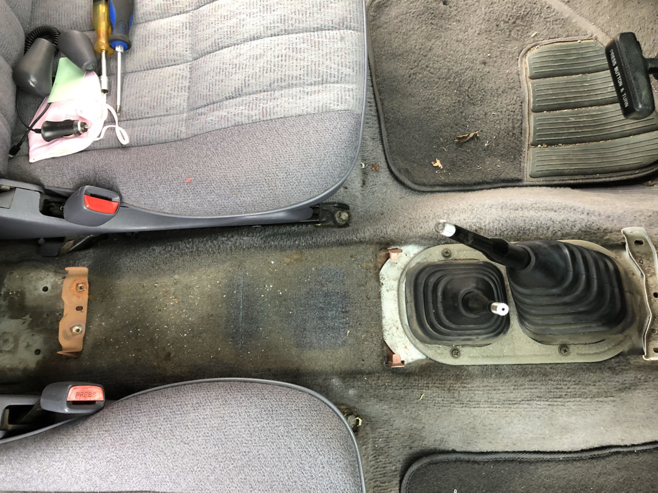

    update post:
    My reverse lights were not coming on, I noticed now that it gets darker at 5.
    I heard there was a switch that gets hit when you put the manual trans in R so I started at the top....
    While I was in there I decided to clean the carpet, smells better that is for sure. but no visible switch there under the rubber accordion looking thing. So I watched this great vid. (I did search here on TW but nothing useful found)
    https://www.youtube.com/watch?v=rhVIiXD1PsY
    Now I had bought this electric cleaner the other day for a different project and thought I would try it, and it worked!! my reverse lights are back to working after I cleaned and reinstalled. and when they stop working again, I will know either to clean them again or buy a new switch.

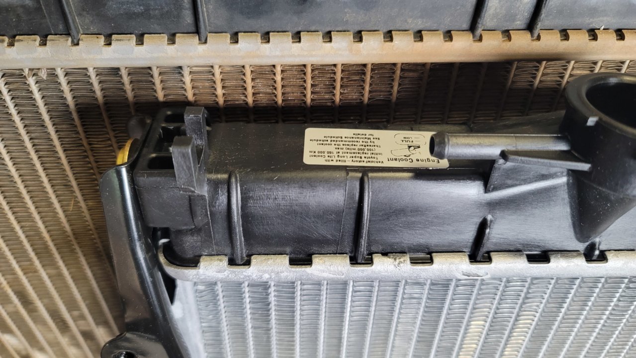

    Went with a factory rad since it was the same as the Napa. Got a manual specific one it seems since it has no extra ports to plug up on the bottom and it's shorter than the Denson the PO had installed. But... I only got a new top hose sooo... another trip to Toyota is happening tomorrow. So close to getting it working again, yet so far!
    Lots of little quality things from the Denson labeled one to the one from the stealership. Minus they are both plastic and aluminum, the factory seems to be better quality overall.
