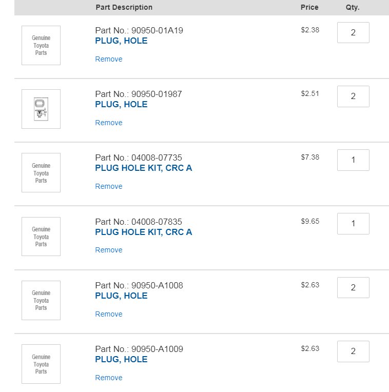

    Yea… not going to find an easy way to make this work kit wise. I got a lot covered though. All the bottom drainage holes are open. But sides and tops mostly all unused holes are covered.

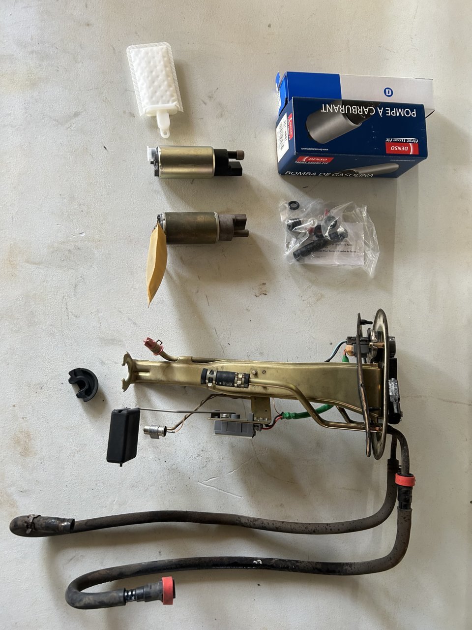

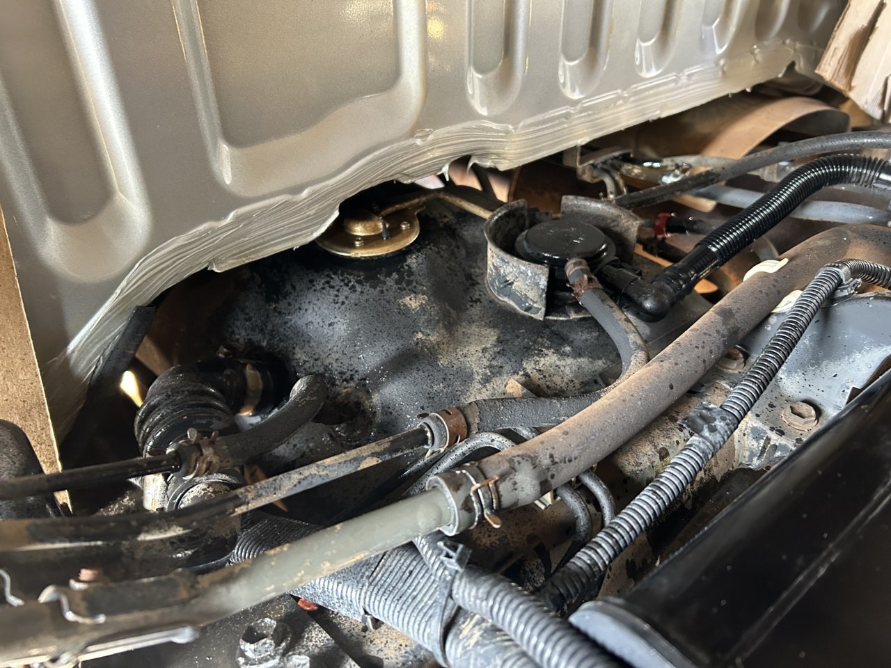

    6DE05021-E25B-4E4D-A855-E31B5A5C7FB7.jpg AA1909F1-C502-4DA9-A275-6D3E961D198A.jpg Swapped out the fuel pump after 250k on the original. Took about 2 hrs on a double cab. Started by removing the bed only to realize that double cabs need to have the tank dropped anyway. I would still remove the bed if I had to do it again. It made disconnecting/reconnecting the lines much easier.
