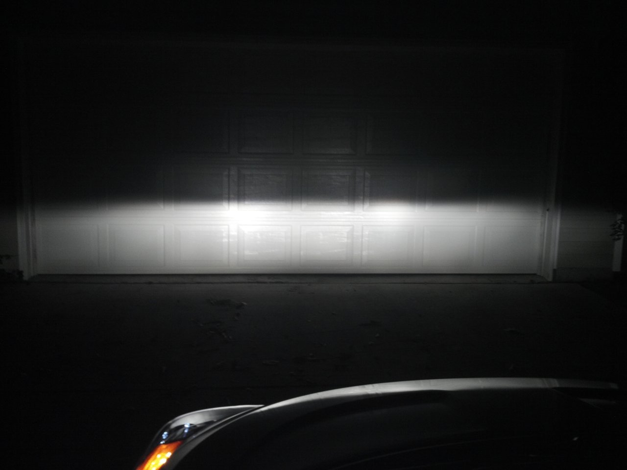

    Cutoff is the line where your lights no longer illuminate. If you park 25 feet or so away from a flat wall, there should be an obvious cutoff line roughly as high as the headlights (preferably slightly lower). Should look something like this...
    If you don't get a clean line, you'll be blinding other drivers. Too many people put LED's into vehicles that weren't designed for them and end up blinding everyone else.
